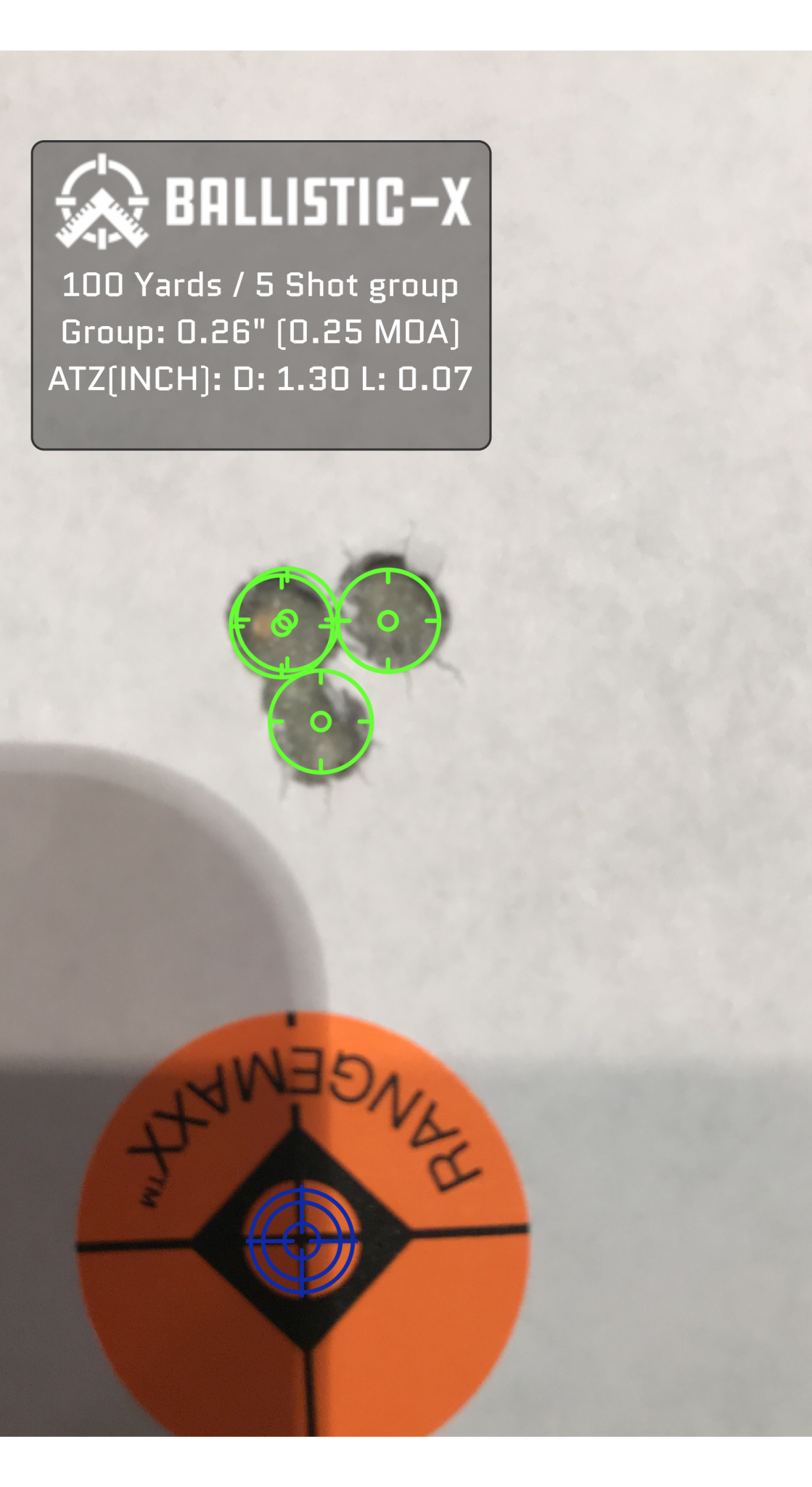

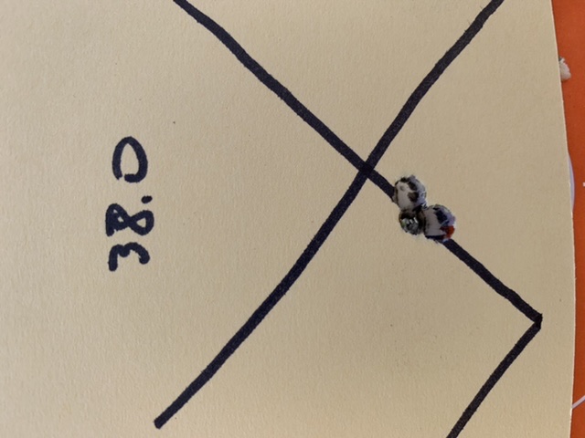

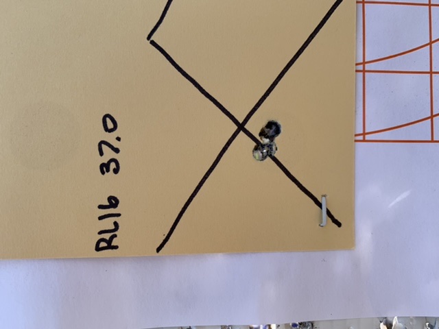

109 hybrids @ 3000 w/ RL16. 38.3gr. 6 shots in 2-4 mph left to right wind, 1.5” vertical. It stacked them up at 800. The 109s are for sure one of the most consistent bullets I’ve ever shot...

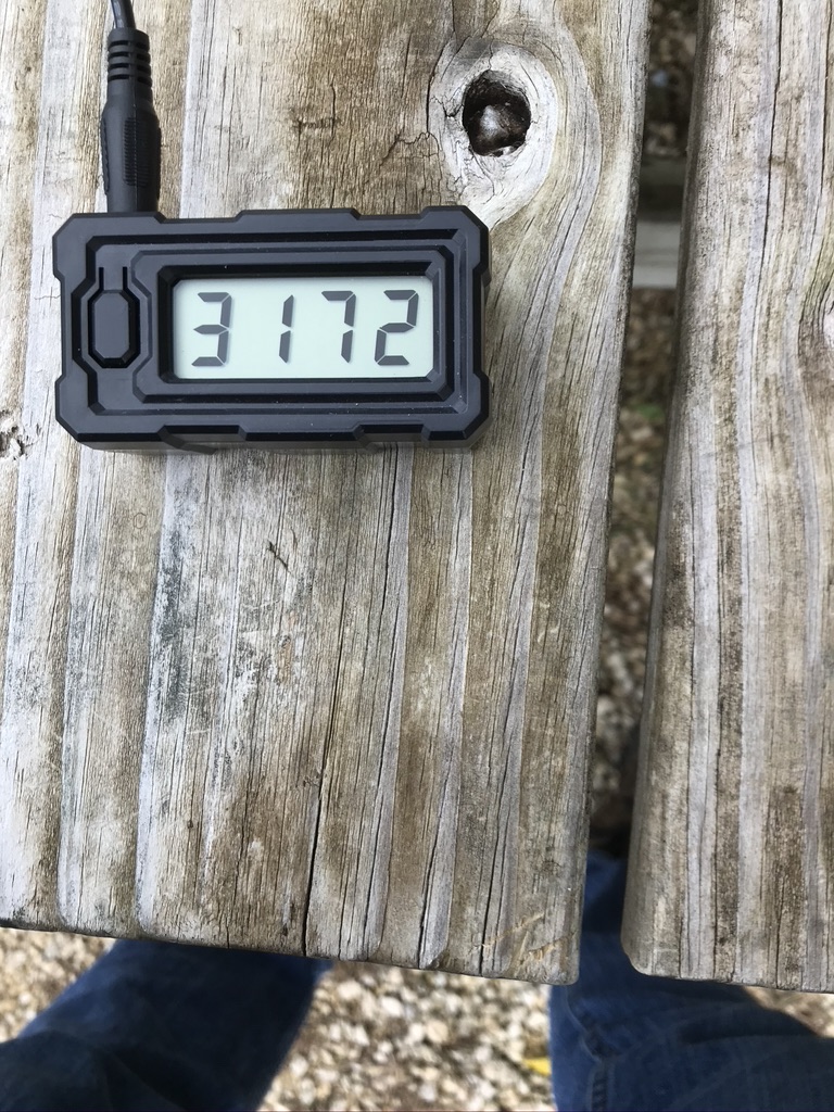

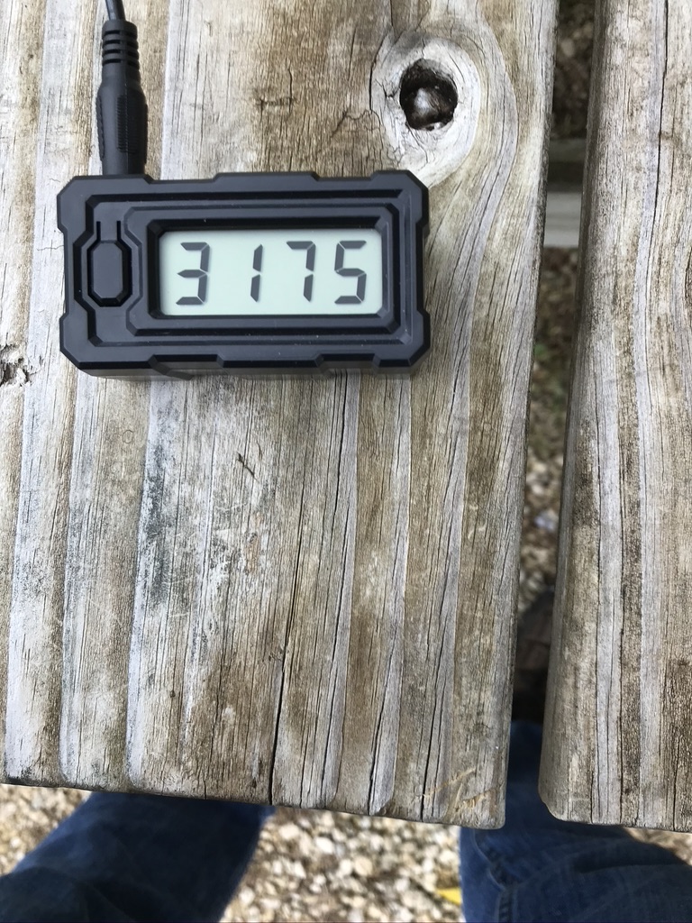

Ran them up to 3100 without pressure in my 29” Brux over RL16. I ended up at 3040 but it was only one of multiple nodes. Super easy to tune.

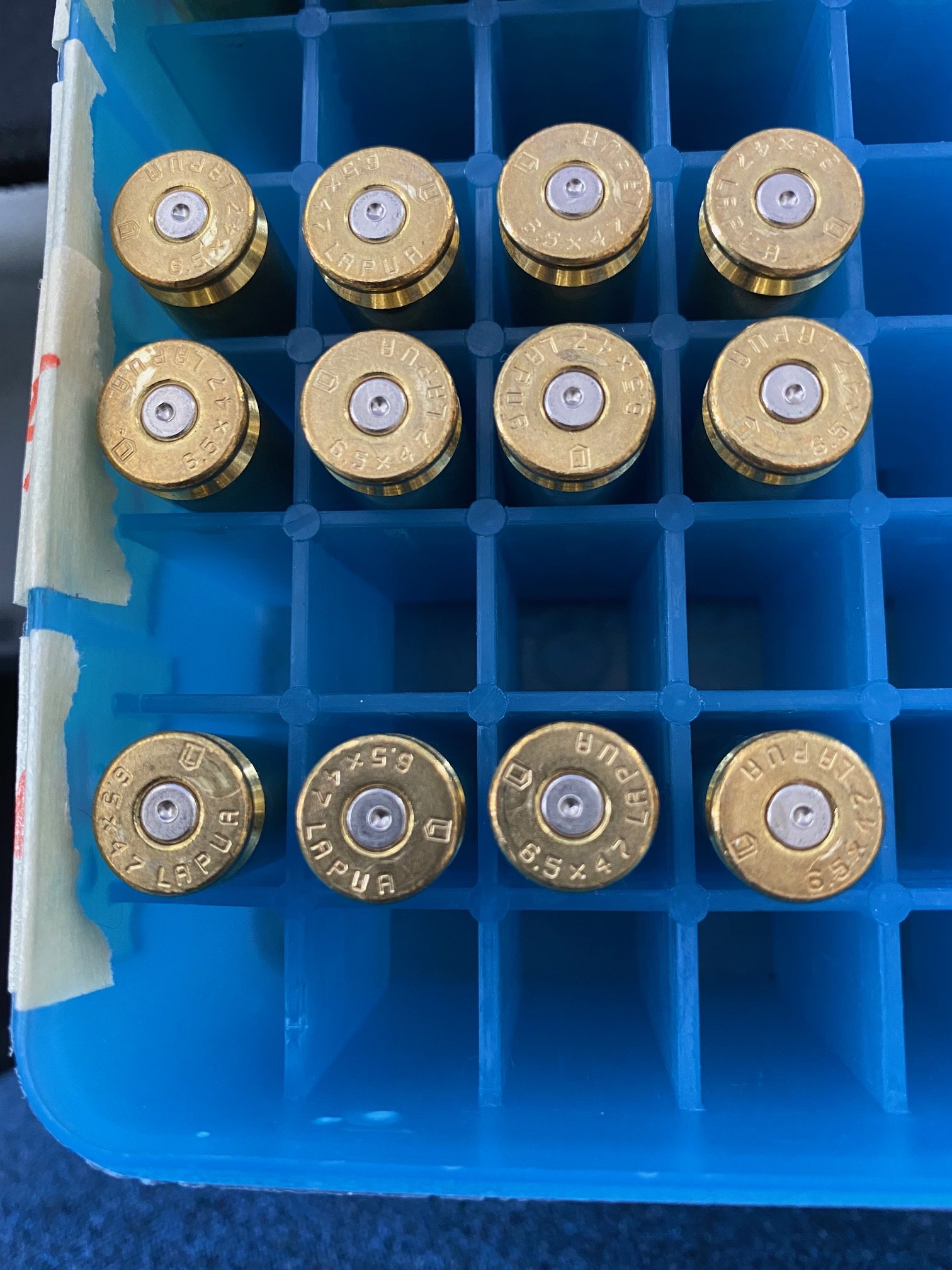

Anybody with new brass have REALLY thick necks? I'm measuring 0.015" wall thickness and a loaded neck diameter of 0.273". Even with a normal 0.275" chamber I'm going to have to neck turn to have adequate clearance.
Also, virgin brass is measuring 0.450" dia at the shoulder, which I thought seemed a bit small.

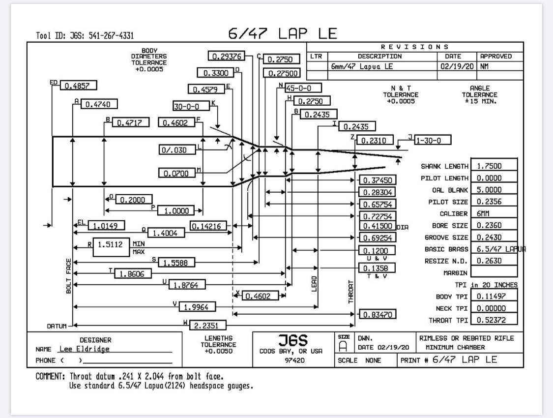

If you want, order this reamer from JGS. I designed it around Peterson brass & 109s but it would work fine for Lapua brass and most any 105-109gr bullet. No need to turn necks at all with it.

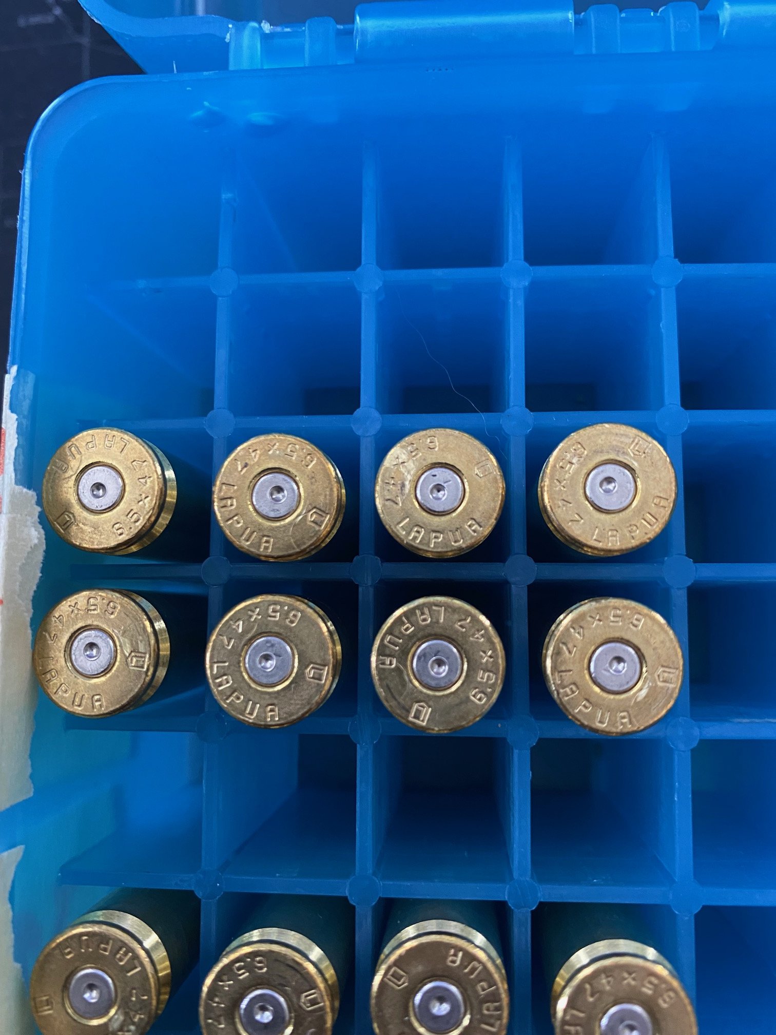

I don’t know what’s going on with Peterson, but I bought a new box of 50 from EuroOptic to measure and the neck thickness is 0.015” measured with a mic. Loaded round is 0.2730”. Stupid thick.
I did a .2750 neck to accommodate a .272 loaded round (which is what mine measures), but to also not be too crazy for lapua either. My lot of brass is a year old, sounds like the newer lots are in fact thicker.
I prefer 0.004 - 0.005” neck clearance, so I’d either need a custom 0.278” neck that would only work for this thick Peterson, or Id have to neck turn to 0.0135”. Ugh.

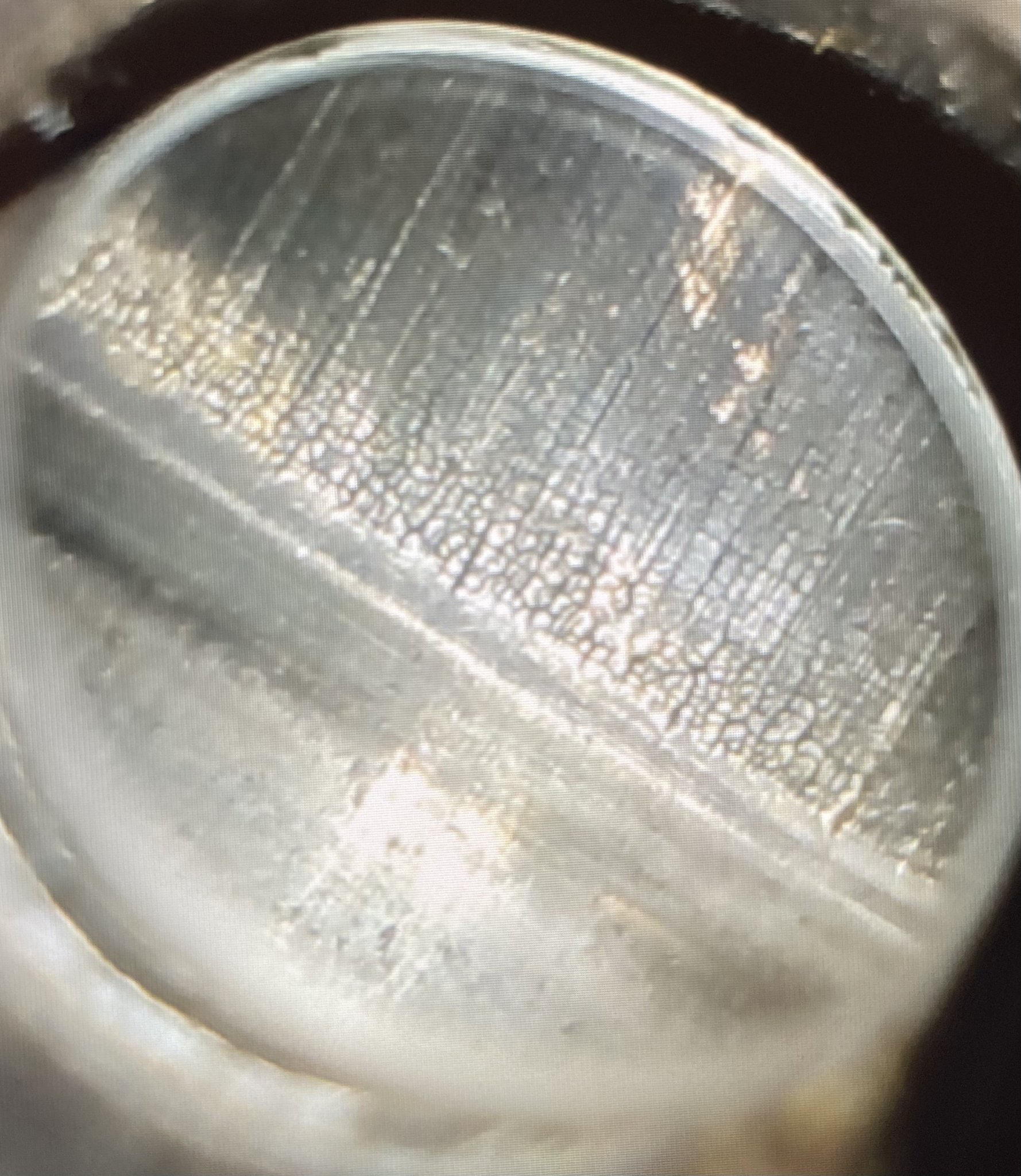

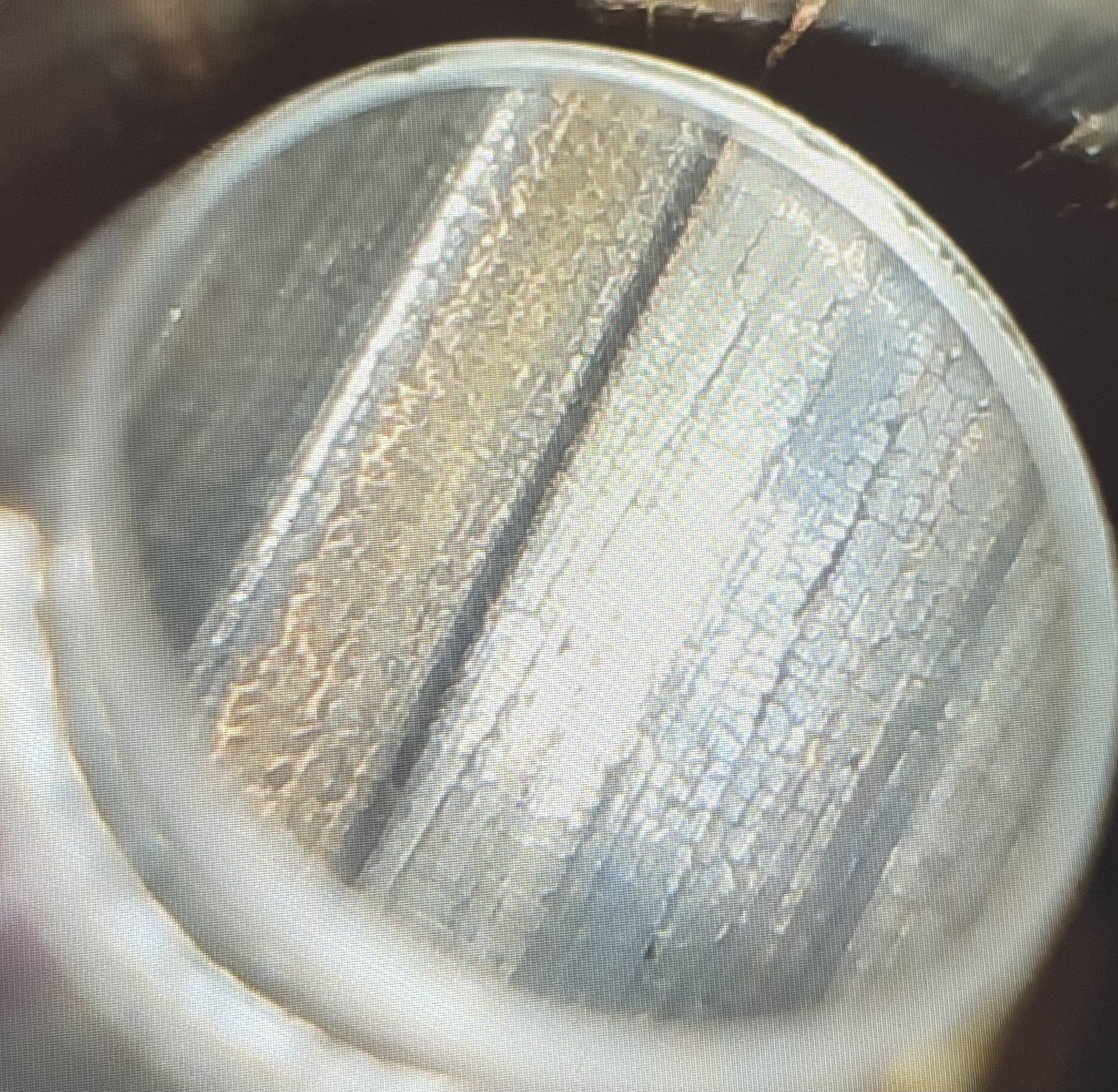

So far the barrel has ~1500 rounds and has not lost any speed and accuracy is still great. Judging by the lack of erosion I think it will go 2500+. I switched barrels this spring just to be safe but will see if I can shoot it out this winter.
Reactions: steve123

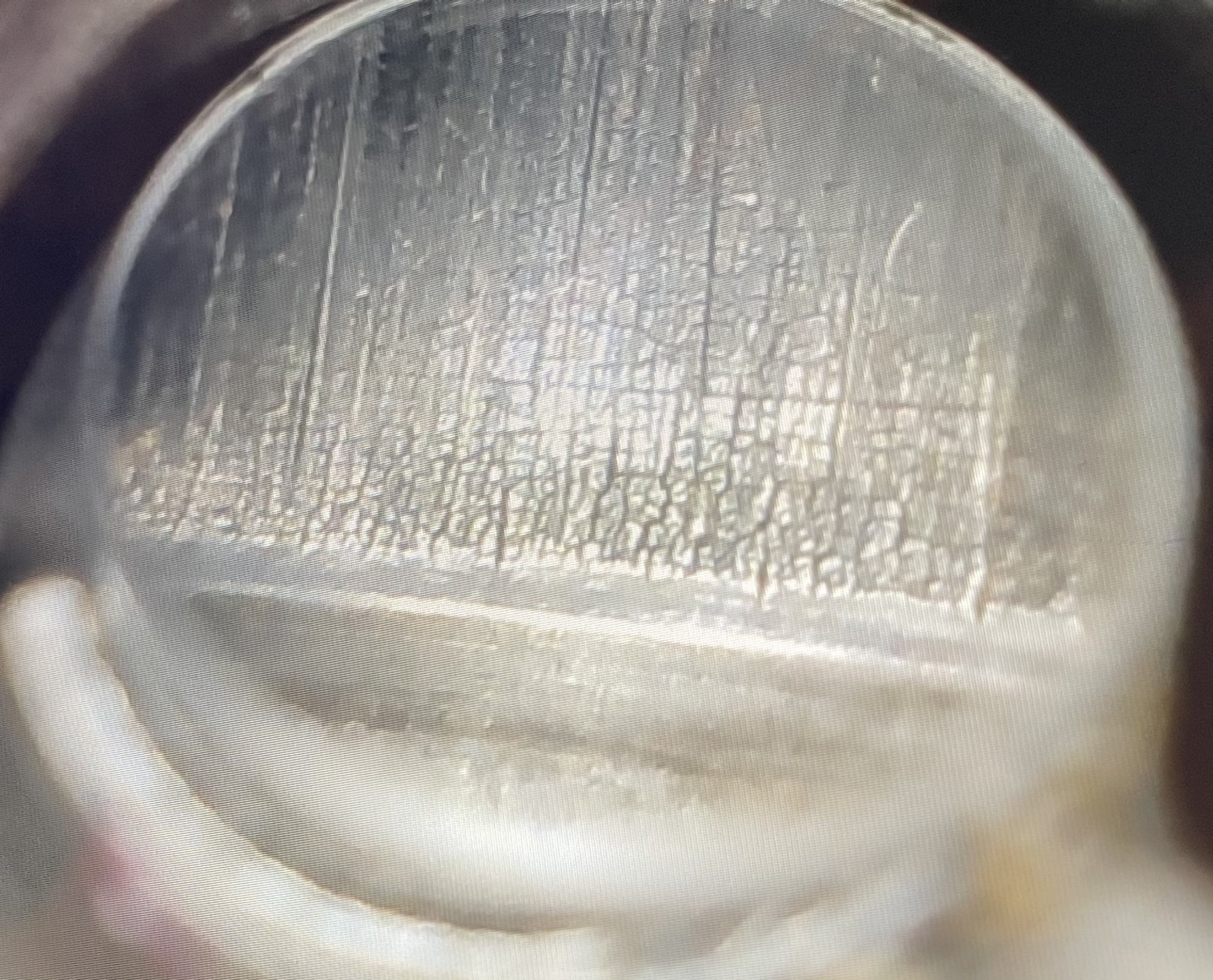

I have one at 1200. Been running 2950.
I’ll borescope it this week and see what it looks like.
Here is 6x47 with 1200 rounds. There’s mild fire cracking up to 2” past throat. Rest of barrel not showing much else.
Pics are of throat and barrel just after throat.

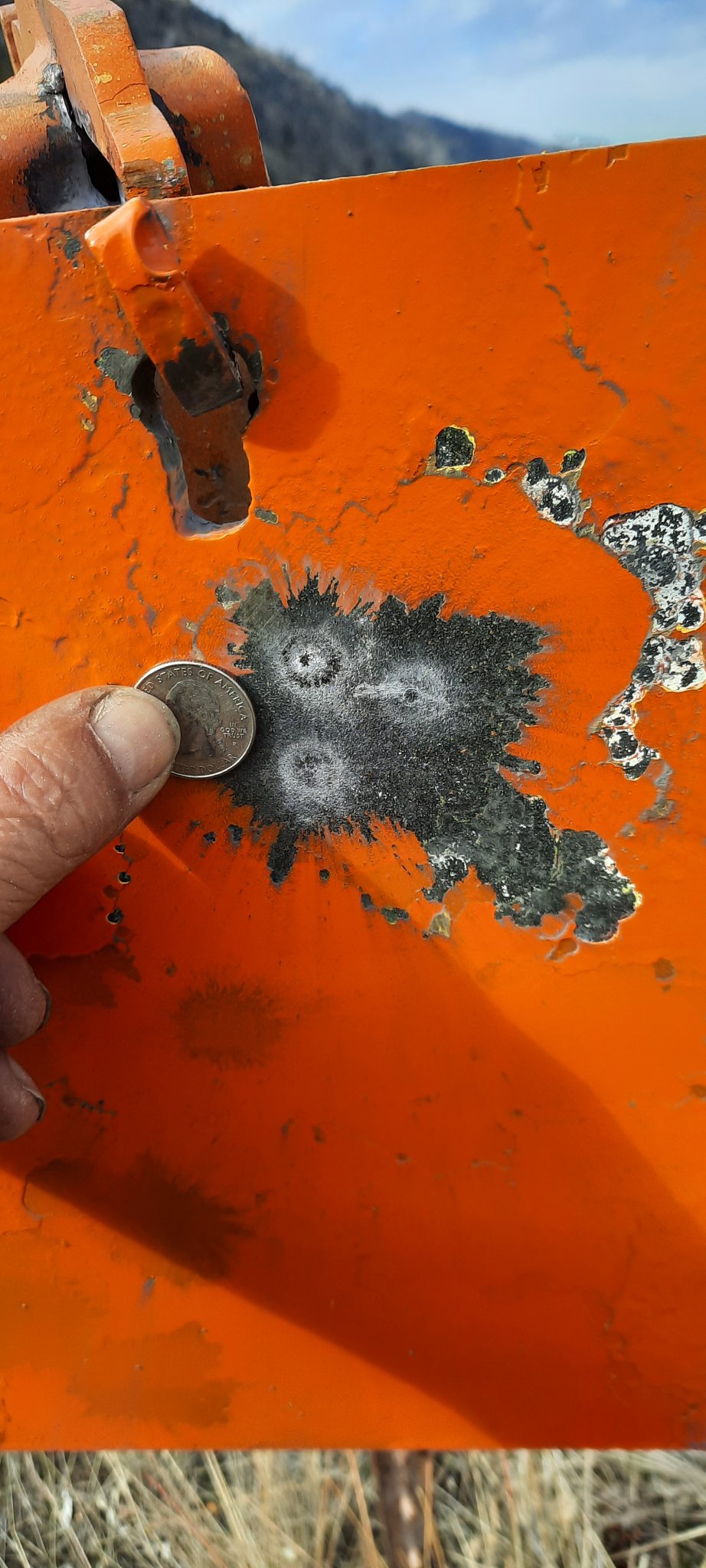

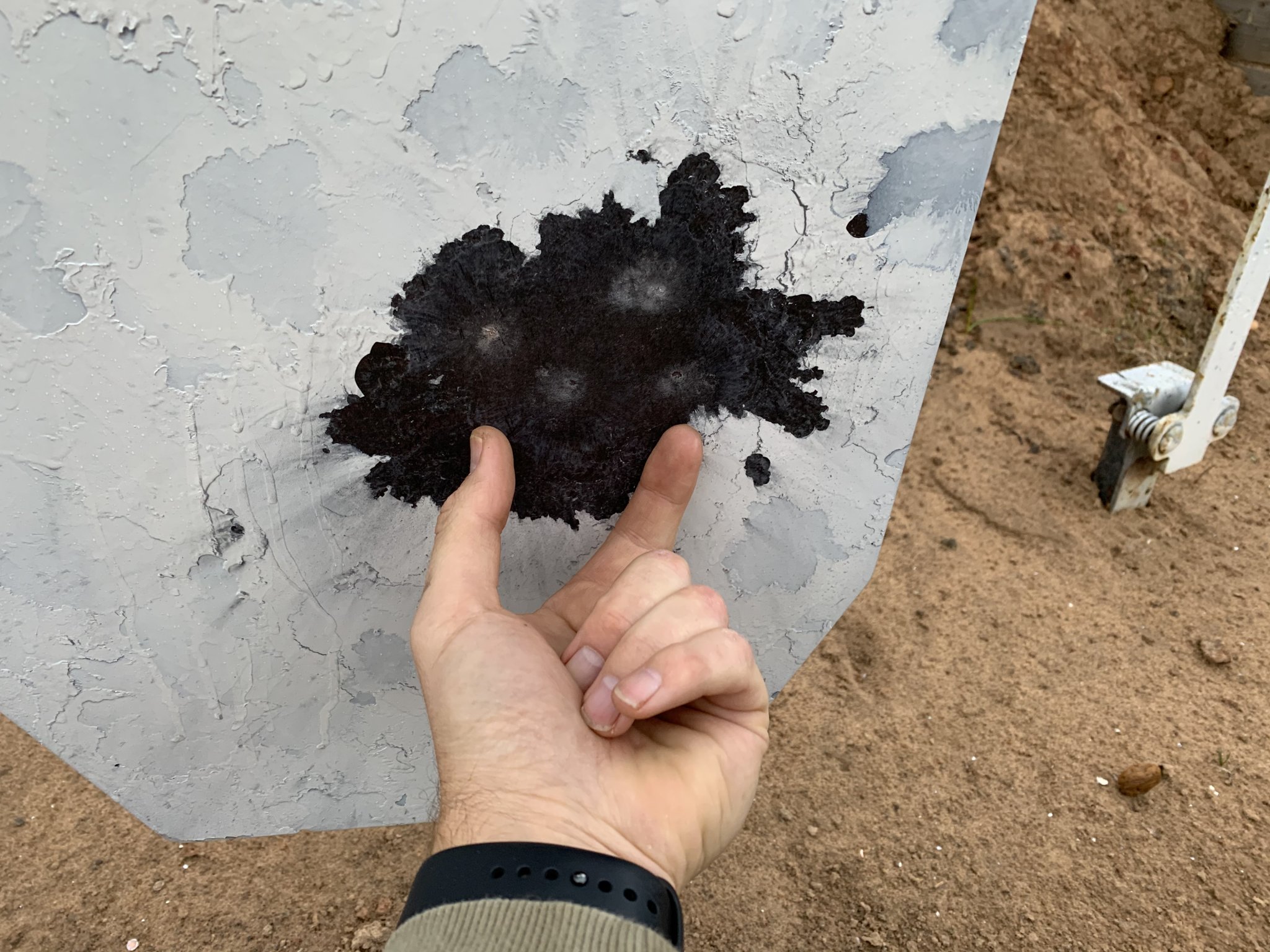

600/700/1000 yards with the latest lot of dtacs that just sold out. 700 yards was the size of a paint can lid. 1000 yard vertical for the best load was 3”. Worst was 6-7”. Trued up to .310 G7 in a 7 twist. This was shooting through the wind so the groups definitely have some room to shrink. This lot of dtacs is .038 shorter base to ogive than the last lot I got in 2017-2018, with about the same BC. Works fine in a .120 freebore chamber.
