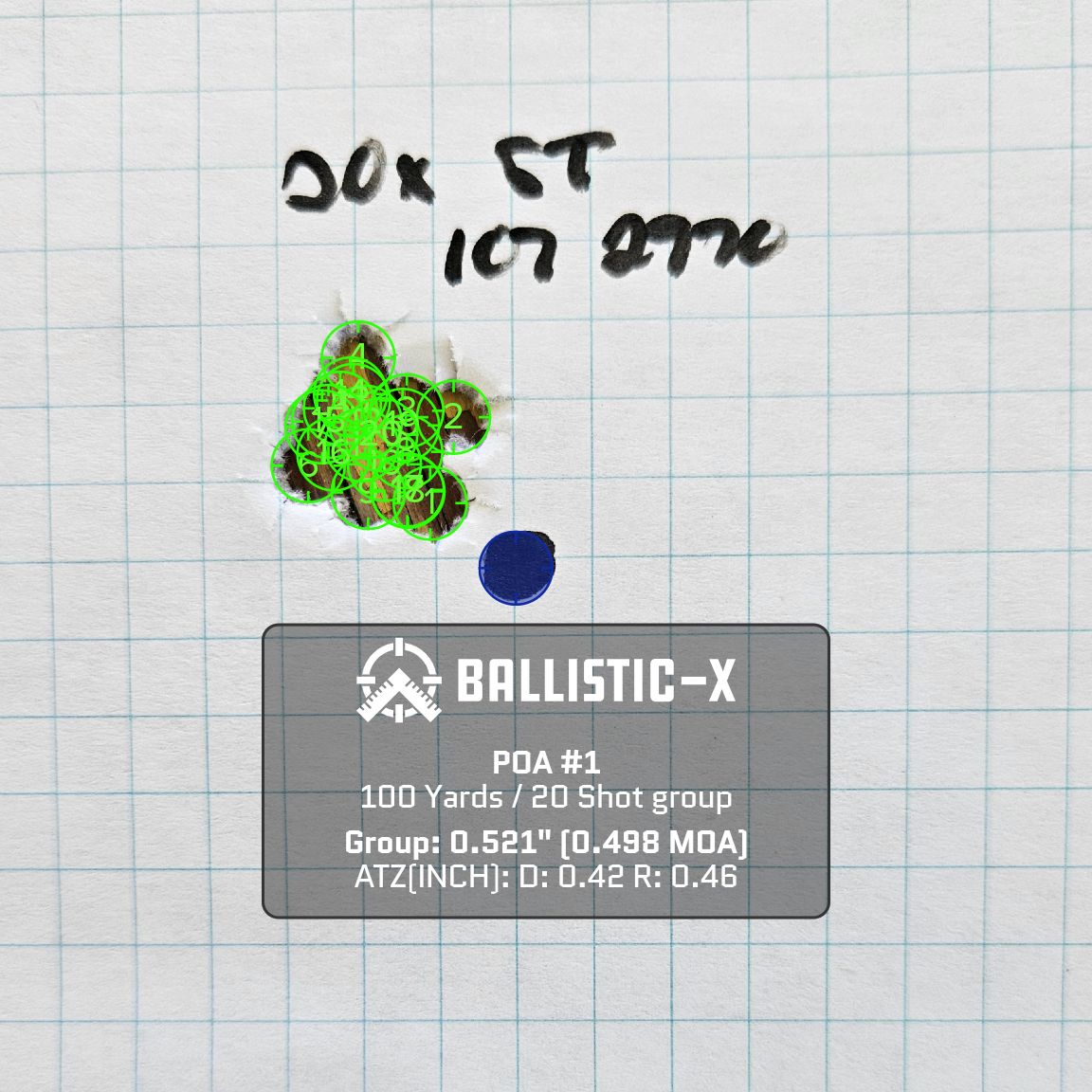

I feel that it can. This is a 20shot zero check on my ladies 6gt, 107smk with 33.4gr varget, jumping 40k, running 2970 from a 26" 7.5tw. A 20 shot group from a dasher or bra isn't likely going to be much better. Maybe? My 6bra would shoot some tiny groups, but if you overlayed multiple groups it likely shot in the 4s. I've never run the dahser, but a lot friends do. Their 10 shot groups are usually in the 3s and 4s. Likely slightly bigger if you add another 10. The difference between a 0.4 moa and 0.5 Mao rifle isn't gonna help a guy hit more targets.
I could honestly care less if my rifles capable of tiny 5 shot groups. I want long shot strings to hold a half min or less cone of fire. I'm not a benchrest shooter, just more of a practical marksman, do prs and field matches. Practice from a lot of weird positions on an 8" plate that I have at 660y. I consider the 8" target a small vital zone of most medium/large game animals. I shoot to be a better marksman, to be a better more efficient killer in the field hunting
