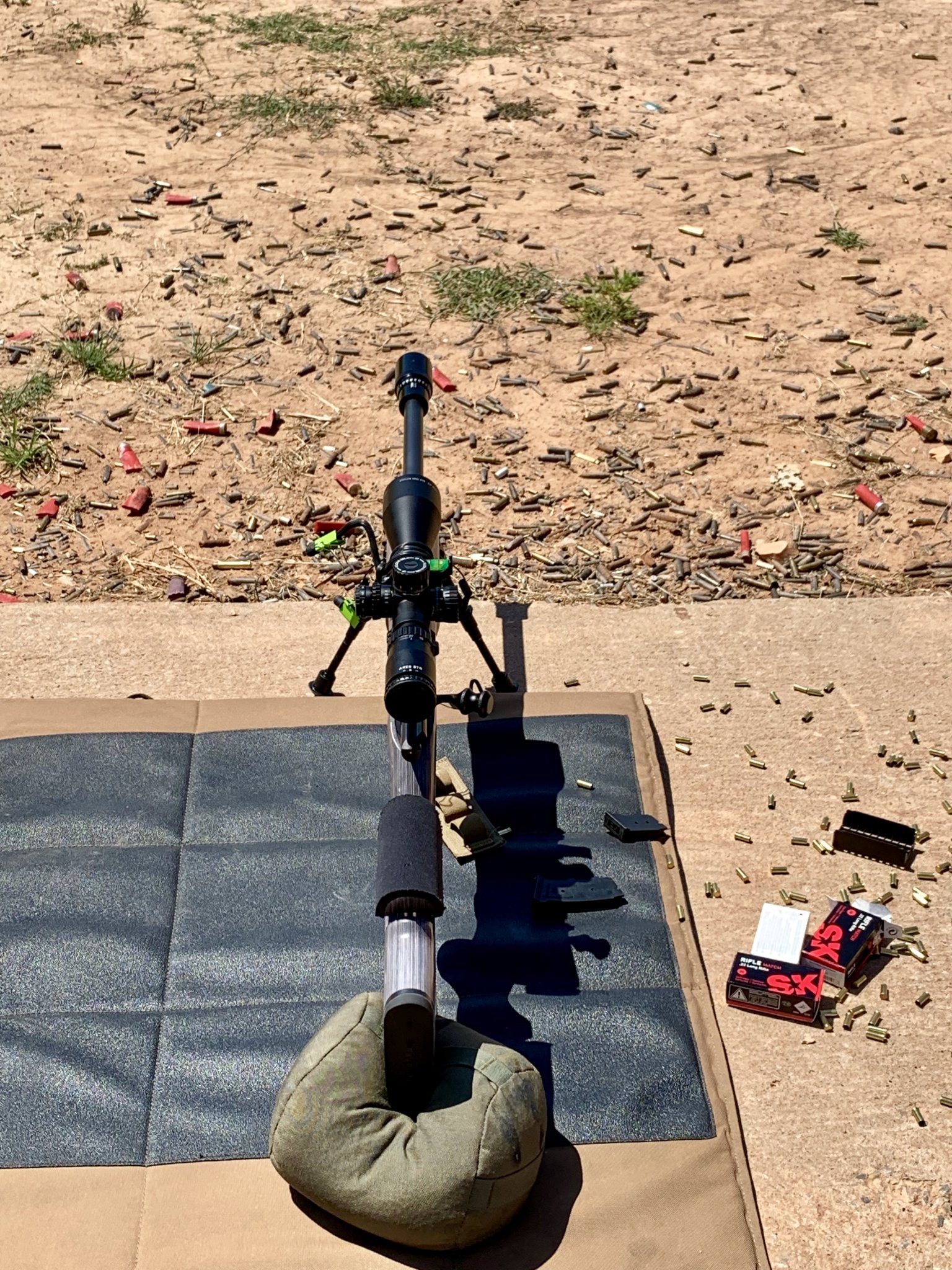

When doing bipod/bag like Rainier's picture, is your body touching the rifle or are you just lining it up and pulling the trigger? I guess if I want to rule out the shooter, I should just stick the rifle in a sled to see how well ammo/gun performs?
HAHA, yeah, when I shoot I put the butt of the stock against my shoulder put the bag under the grip part of the stock. In this test I’m seeing more what the gun can do, not me. I had a Ruger Precision Rimfire that couldn’t even come close to groups like this when shooting this same way.

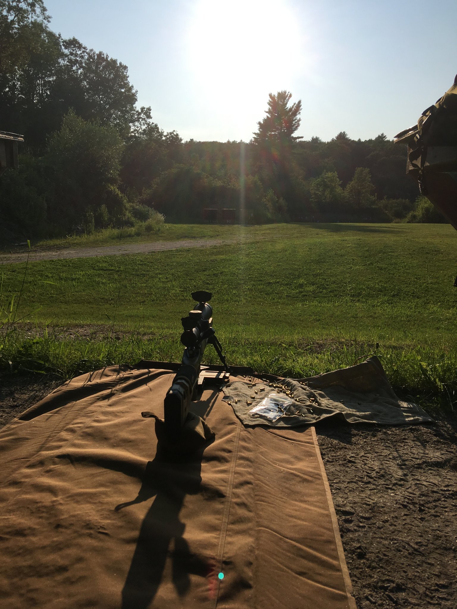

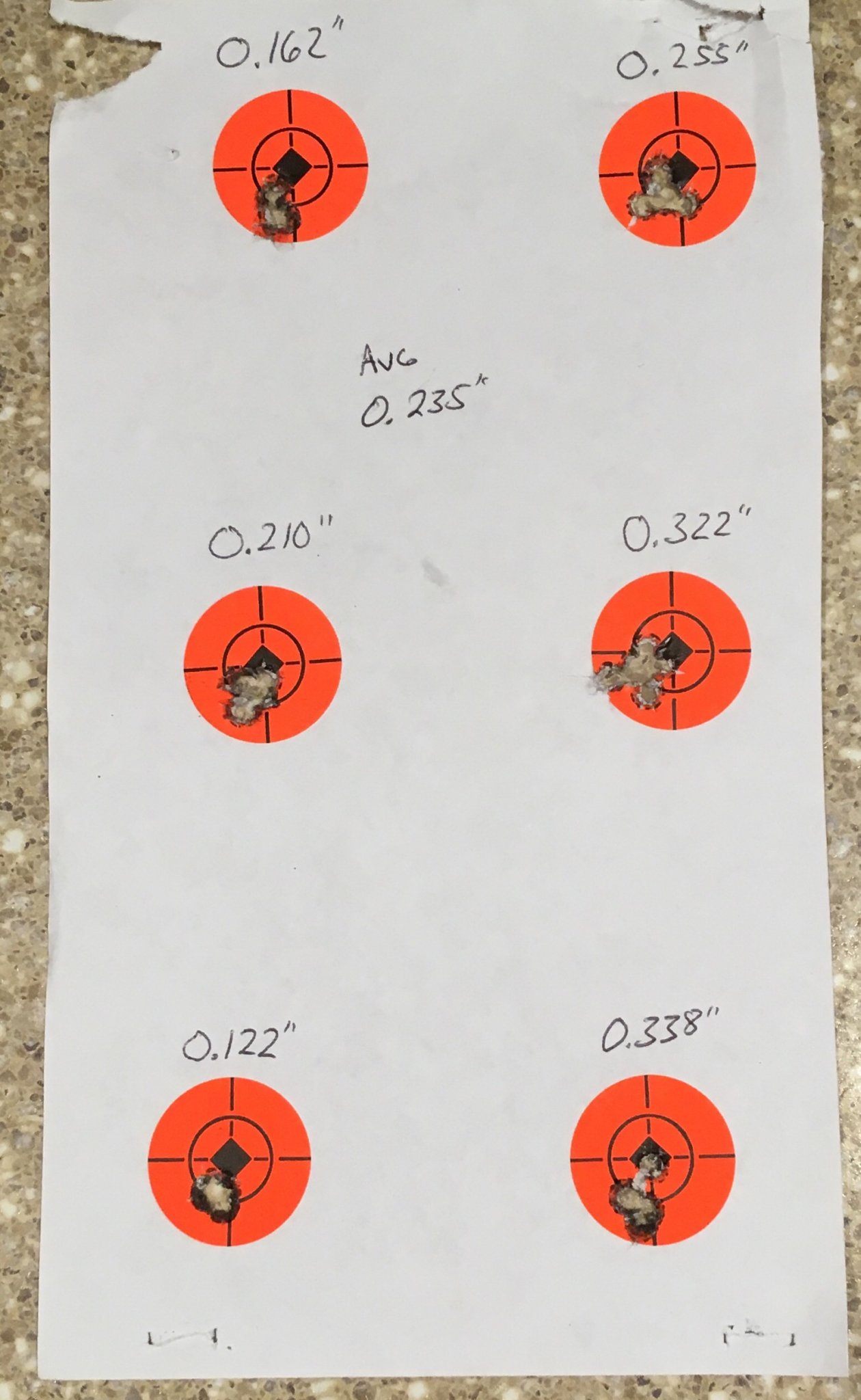

I got out to the range this afternoon and got my ass kicked by the sun. On this range in the summer your looking right into the setting sun. I need to remember to bring a sunshade or just put it on the scope and leave it. But I got a 50 yard target in barely, you can see the effects of the sun on the last 2 targets (I shoot the left row first then the right top to bottom. I only got 2 groups at 100 yards then gave up the sun was killing me, could not hold a consistent image in the scope.
7106529
7106530
Thank you Transinator! Yes, my range only goes to 200; that’s next. It’s hard to find anything longer in the Seattle area. However, I think Littlepod is implying i’m cheating HAHA! The rules state: “lets keep this a bipod/rear bag or shooting off a ruck challenge”, right?
Oh I never knew there were rules, nor did I imply you were cheating. I was wondering how I could test out the maximum precision of the ammo/gun, and not me as a new shooter. Those vudoos sure can shoot. I have a lot of work to do as a shooter, and finding the right ammo fit for the rifle. Looks like midas+ is a great shooter through the vudoo and you are a great shooter too! On my 308 I only can put in at 0.7 moa @ 100, when the person with me on the same rifle will put in < 0.5.

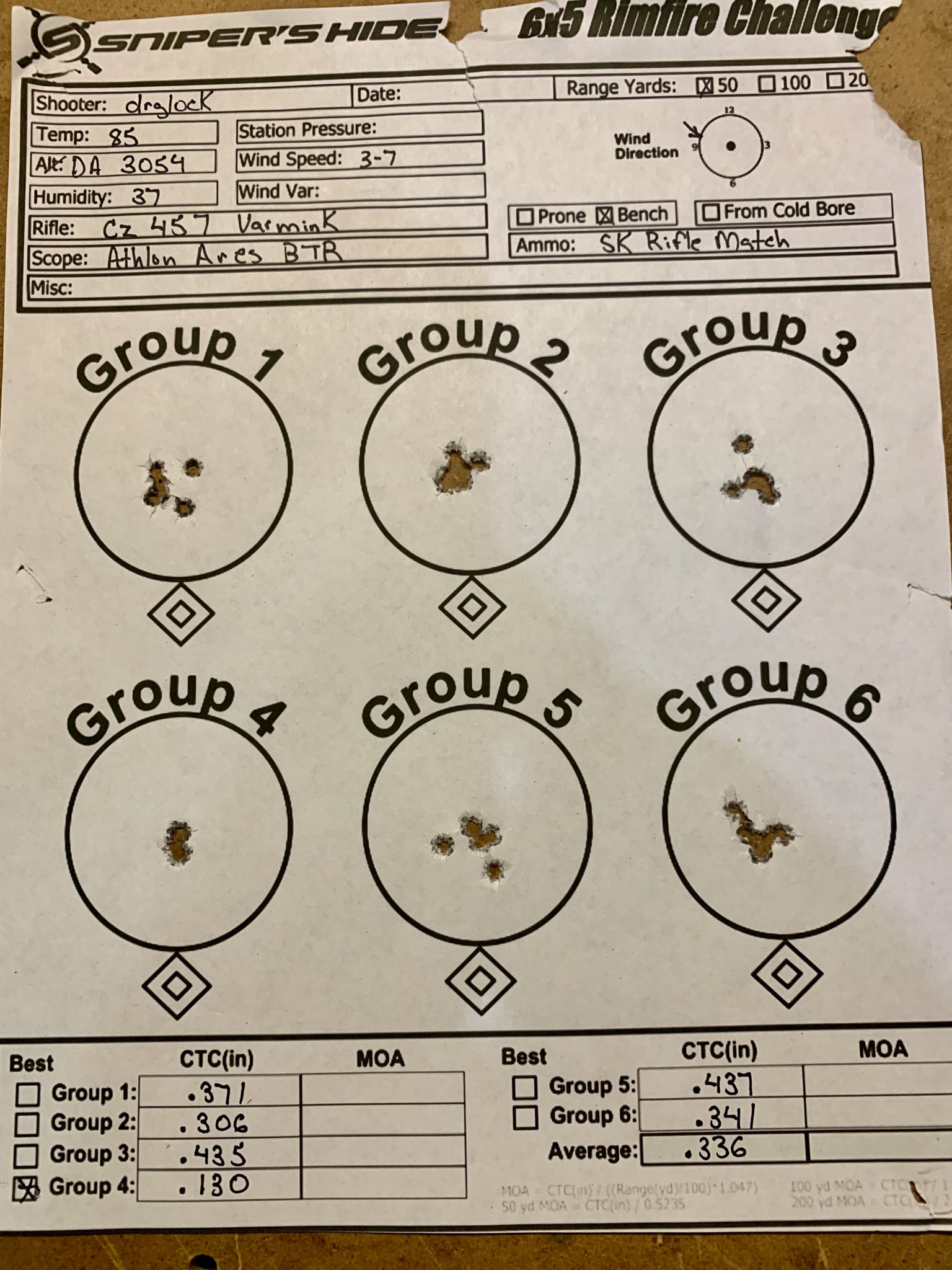

It was actually a benchrest match. Gun was shooting better then, or atleast the shooter. Hung shot for shot with a Anschutz. Finished top of factory class and middle of custom class
Cz 457 Varmint
Athlon Ares BTR 4.5-27x50
SK Rifle Match
6x5 at 50yds
Not quite at the limitations of the gun but I think I’m getting close, more of the limitations of the shooter. The groups that are opened up are mostly when I lose focus on my fundamentals.
Did you measure furthest edge to edge then subtract the .222? Just wondering
I always find discrepancy with caliper measuring, versus using software. .222 is a pretty lenient measurement. If I set my calipers to .222 it usually is a good decent size spacing from the edge of the grease marks. So like if I looked at the black marks, the outer edge and giving it the most miniscule of white space, to the other outer edge giving it miniscule white space is around .222.
Usually I take a picture of the paper with rangebuddy, set the paper as 11" tall for the ruler setting, and then it'll do all the internal measurements.

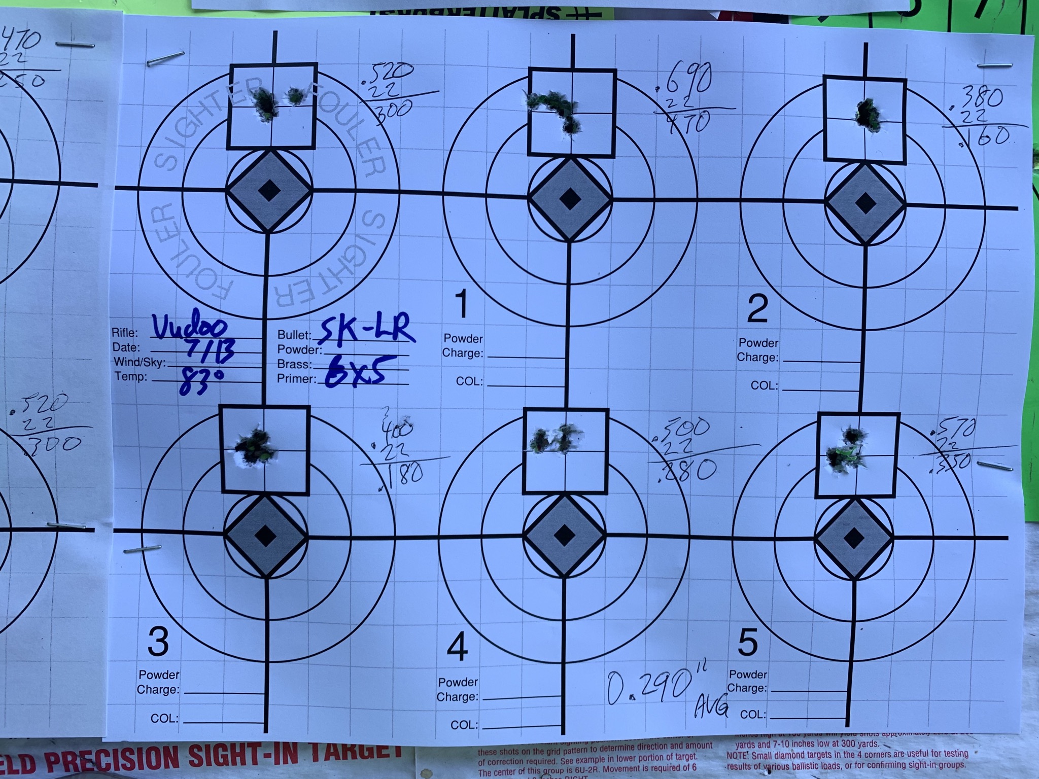

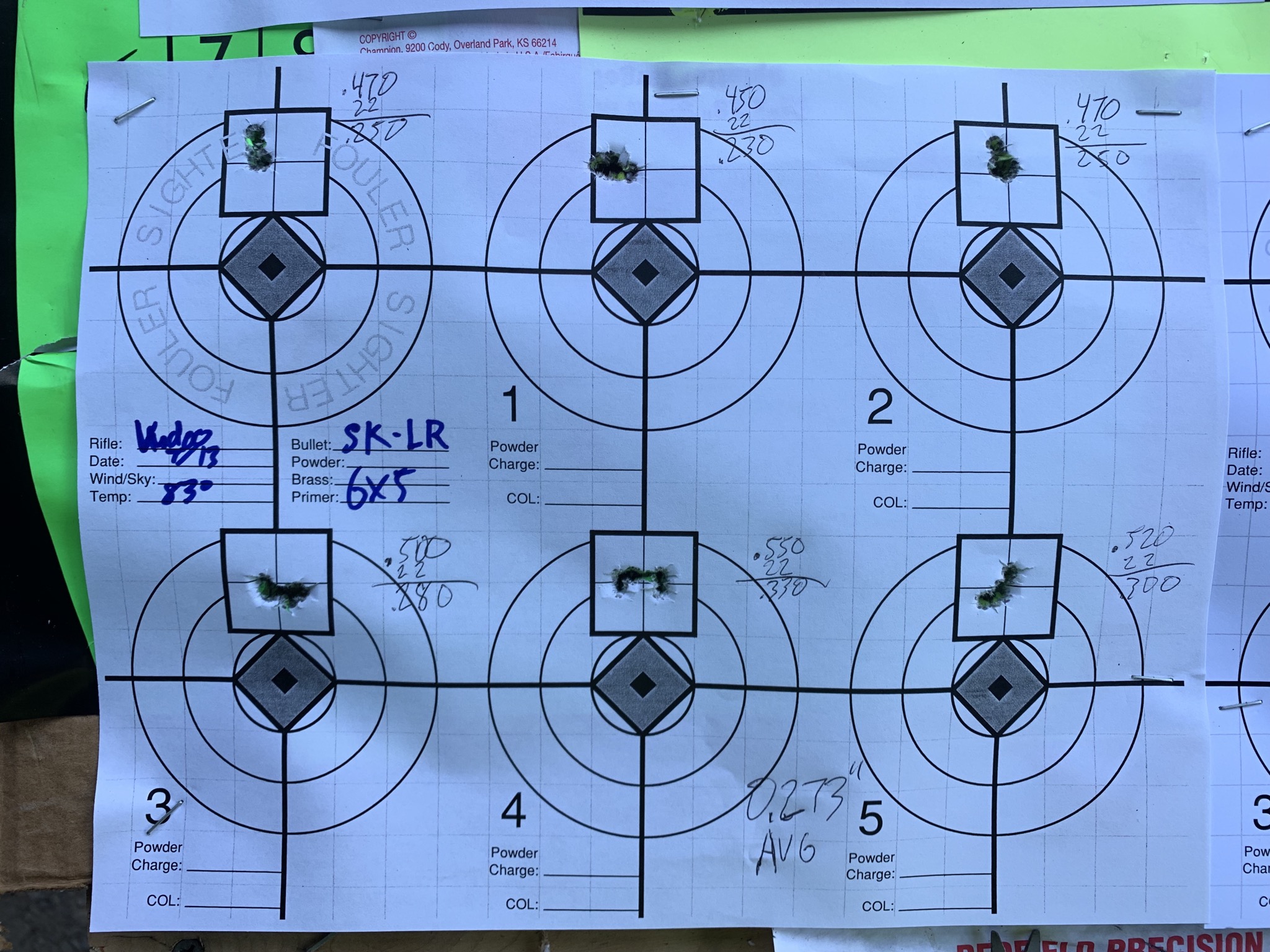

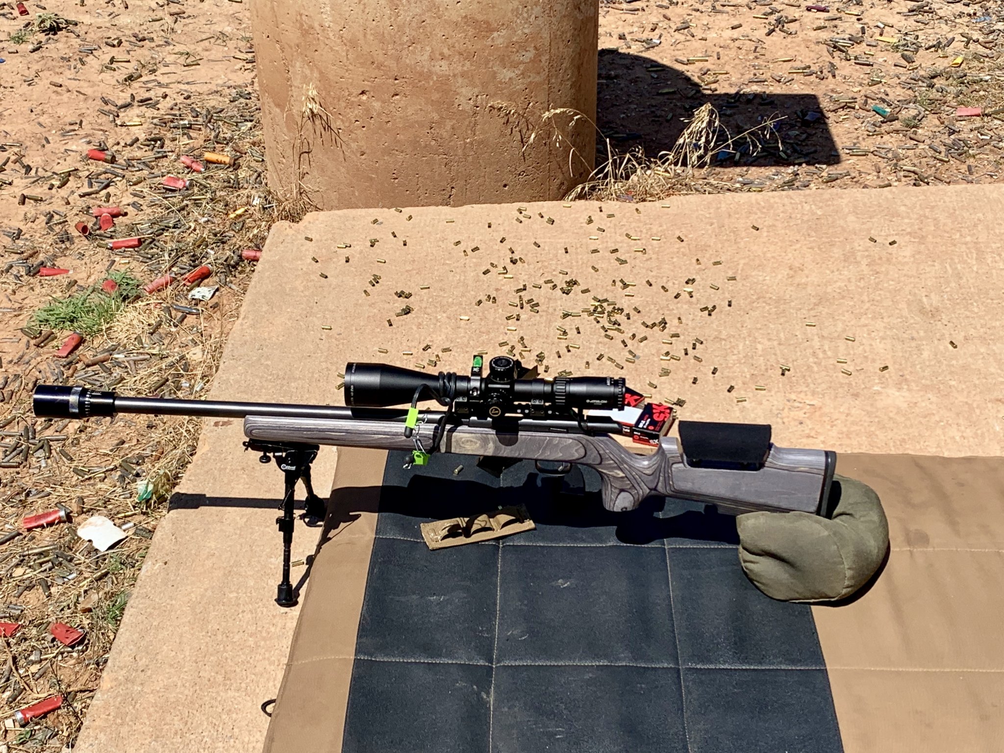

Finally got out and did some proper 6x5s with my new vudoo and some sk long range
Shot at 50 yards 82degrees with a 2-4mph from 3oclock
Left hand V22, 20” Bartlein mtu , mpa hybrid chassis, tt diamond at 1lb, athlon ares etr 4.5-30
.273 and .290 avg I just read the comment about using .222 to subtract and will do so moving forward but these were measured with my dial caliper to the hundredth anyway

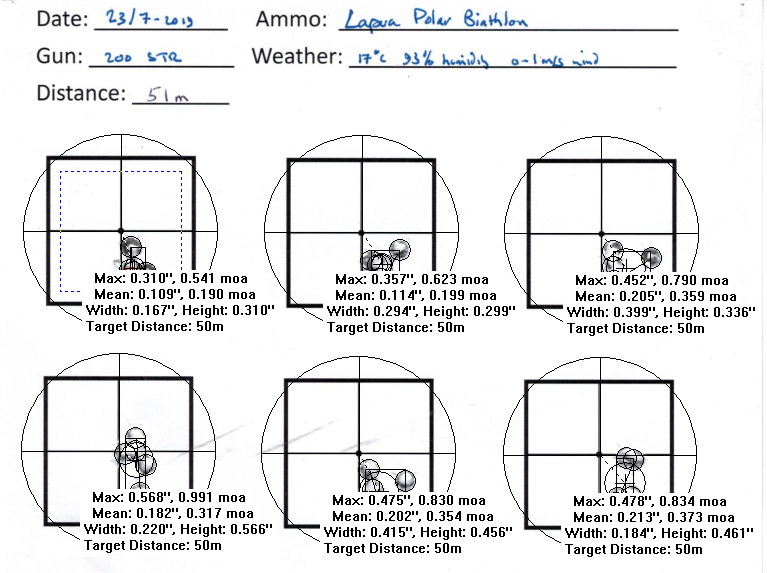

Sig Sauer 200 STR, Delta 5-50x56
bipod prone
51m c. 56 yards
17degC little wind.
I'm still trying to learn what fundamentals suit me so consistency is ... somewhat missing ;-)

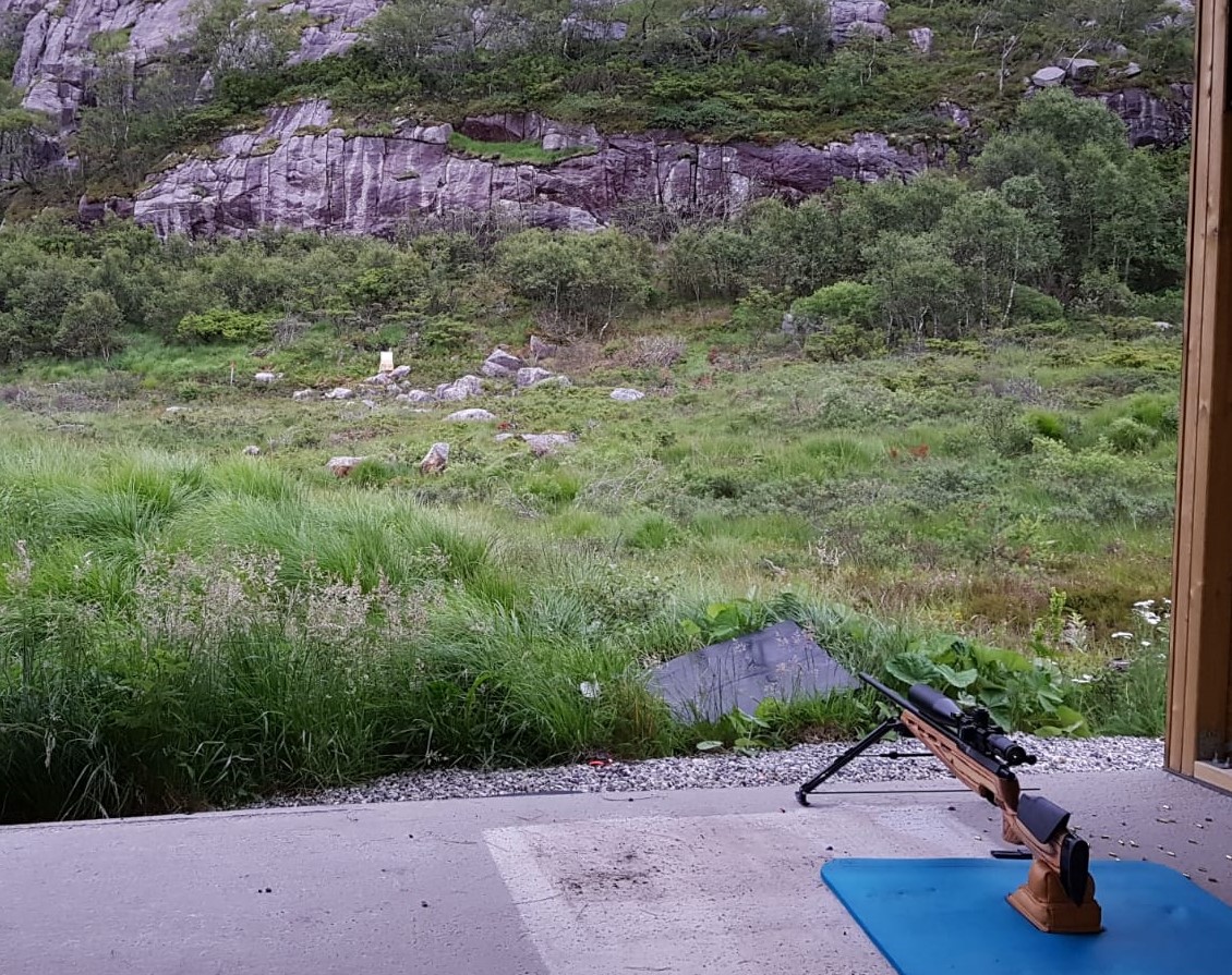

I was using a clay pigeon range today and there wasn't anything to put the targets on at 50m - hence the 51m :)

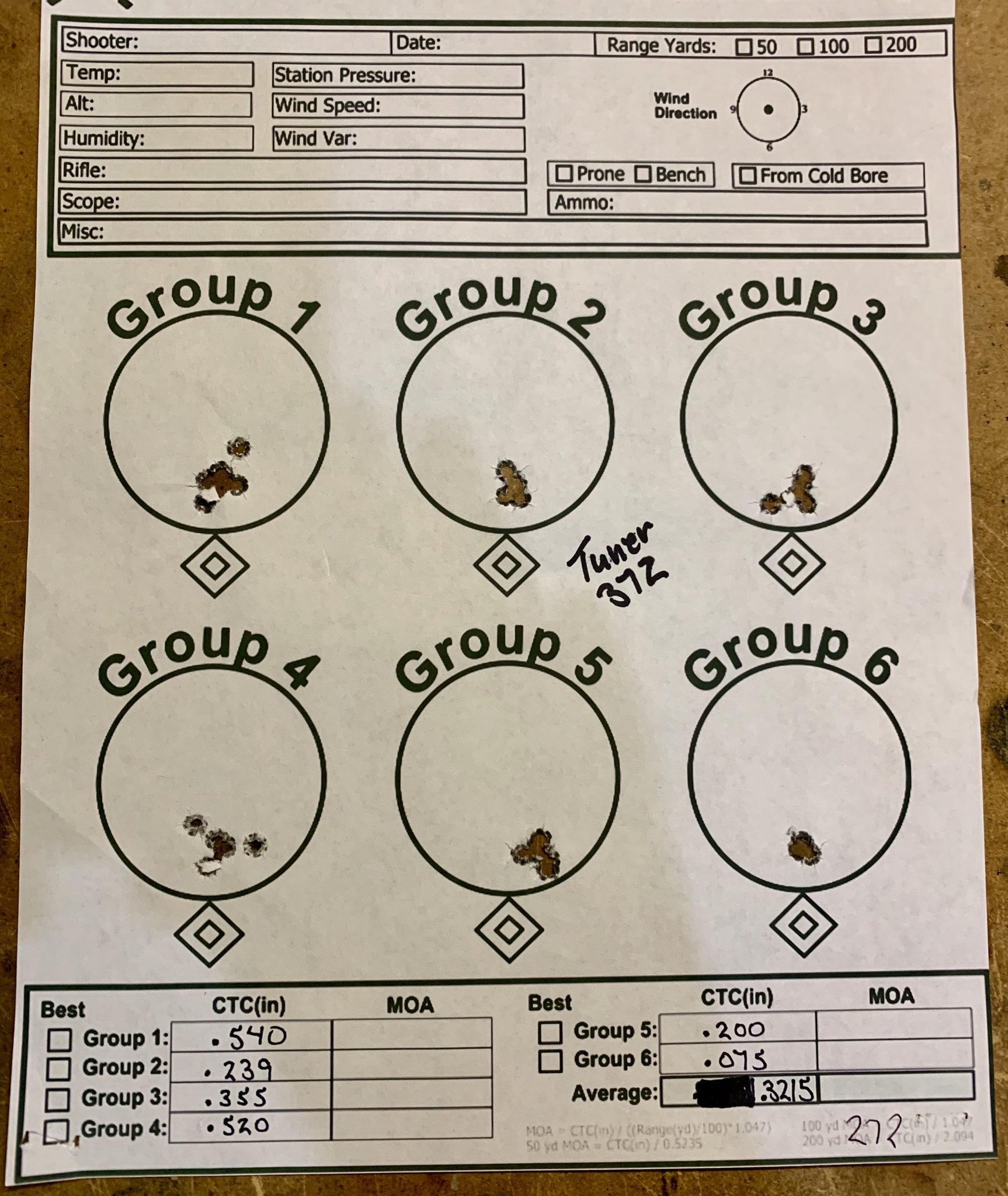

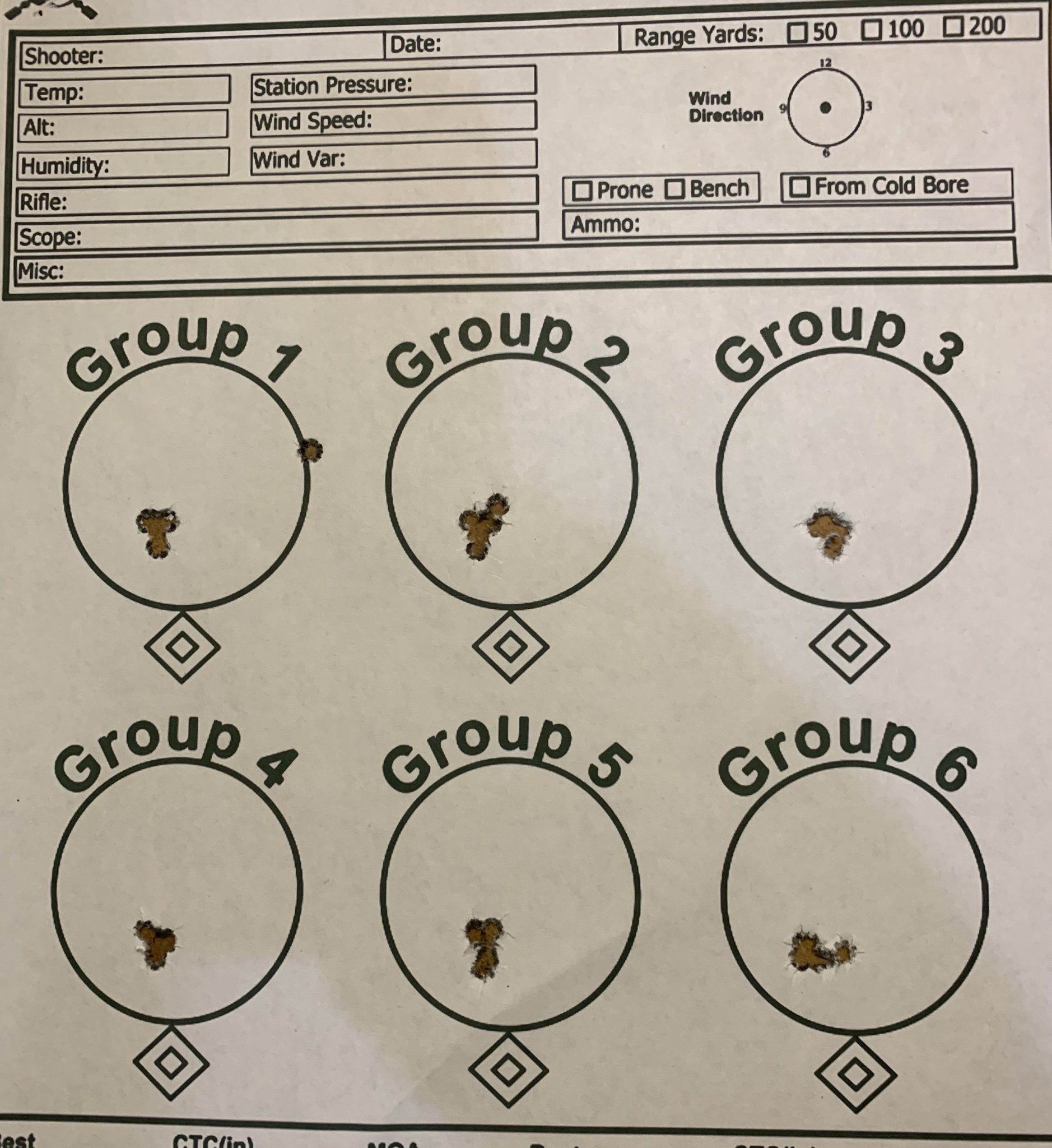

I know I’m learning more every time I go out and a lot good things happened today. Wind was almost nonexistent this morning and that’s a rarity here in Oklahoma. I’ve installed a trigger spring and got my trigger down to 10oz and this is a pretty good lot of SKRM. What I’ve noticed since playing with the tuner is my groups are more consistent now .
I shot this 6x5 right after I shot the one I turned in . The first shot in group 1 is the one that’s way high and right. I’m positive it wasn’t me but maybe a deformed round that I didn’t notice when I loaded it. But as you can see every shot after that was right on.

I hate to say it, but that’s rimfire. I see that stuff from time to time and only can assume it is the ammo. Even with the very “best” ammo you see it, just with the expensive stuff the distance it is out is usually less and they occur less frequently. What I look for in an accurate rifle / ammo combo is exactly what your targets are starting to show, neatly arranged round tightly packed groups that are on the same POI every time (minus the winds effect). Once you have that you can then start working on reducing total group size with lot selection, or refining your processes to minimize the human effect.
Reactions: drglock
That right there, is what I've learned over the past year, sending 50 shots of rimfire at 200 yards.
Vertical can be explained with mv spread and a crosswind will show as lateral spread
but on those calm mornings when the chronograph shows tight mv's and I'm holding steady on center
those odd strays still keep showing up. It wasn't until I started inspecting every cartridge before chambering
that the pattern made sense. It wasn't wind, or mv shift, or me failing to follow through, it was cartridge defects.
If your cartridges aren't all exactly the same shape, then aerodynamics will spin those rounds off on random flights.
I can predict just how bad my results will be, by taking a close look at the cartridge before chambering it.
zSGZtHT-1fsuDoSIy4pcebTdhWA9uTjOfXCixk3jN_HZQIVRcLhPjCY5Da8xn9CZiendrxKx4B0WfAS2cf4AsYEg2zlWsAR_FVOQ5SHXxGjdEP4TS3hLj5LrZiWg3bqmfLAFSBSCUBeUQRFQtZtvEOvyctodAX9Li_HZ6KGIRgndstmwVdm_V3Ieux9L9DKvbjI2mc9XH9NPl2z7TWN_uqMddYEmuobFRyyr5ey7QGzw7QRmH8vj2xN5Fi5IX0B_o7PUakvc8CUHOV2FGFlHAVnkp8_W1WaVBIyFSYKY0rAQ7YjCuA2h05Y08Y1W-934jQnmAJpHiXSk2LglRsH_UYSDfUUVEsnBx04fcxDzws-k8XCqIUGYpBW8DLU-woKxpXgdNiEtPbHiOd6Q53gp4_HfHMTaR3efobi5uvqfZLwWu6Qf-clpc8KS7jBHs66HmnaLfBnWRPdYMU5LJzUb5-uJlWivUFgldczmgSI5S-QaVyOoWX0DpxVYaikEC4vrgknti4F9vsu0CW4F1GtN8hqpEW67YV3e2n0k91CCGMwhsinJ8laNDBNAHmOInqaZT8GG74SAy-xMzw3gBM8XRQPzAvGoG-OG8hY9mM6VoghKwkfBOCc1fqIsImtGfK1x3Y9bM15dhJvrR9ZAtQJUw8FVphxVNeOi0aIvML126JLTgDMPfCKEEJDLeI4Pf3-FXZoC8tC0RcW8qdHQeShS7M4U=w809-h567-no
Zoom in on those 22lr cartridges, count the defects that are visible.
Look at the dents, dings, scratches, distorted/inclined drive bands.
If the nose and sides are beat to hell, what do you think the bullet heel looks like?
Do you really think those rounds will fly the same trajectory?
Crappy ammo produces crappy results.
The further the crap flies, the wider the spread when it hits. ;)
That is some impressive shooting. I have also had good luck with a tuner in the past. That wild flyer in group 1 could be anything. Was it a cold bore shot? They are often high to the right. You said it was a calm day. I have a BR expert friend who is older and very experienced with rimfire precision shooting who claims that when there is zero wind some guns and ammo combos will throw weird flyers for no reason. He says the 22lr needs a little wind to help stabilize the projectile. Is he right? I dunno. I have not seen it result in a flyer quite that bad. Your CZ is a repeater, it may have shaved a little lead off of one side of the bullet which caused it to veer off course. 22 kind of wobbles down range on a good day.

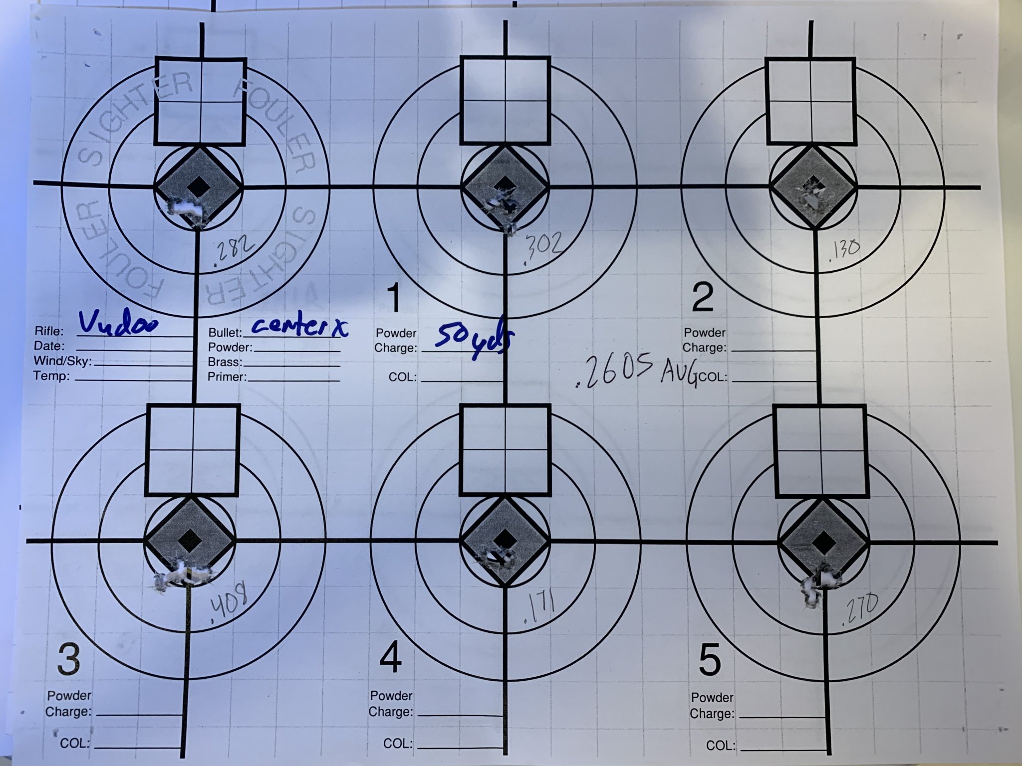

Center x is definitely an improvement in my gun over the sk long range it feels like it would shoot everything into .1xx if I was not involved

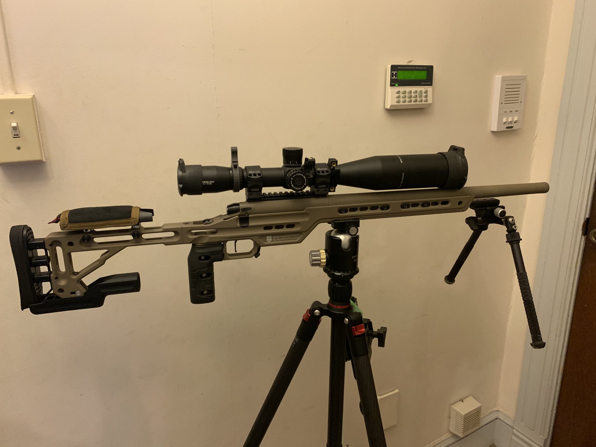

Included a pic of the rifle this time it’s quickly become my most used rifle by a long shot. I would like to shoot it out of a rest or a good set of bags at some point and see what it can do at 100 I really feel like I’m holding the rifle back at 100
