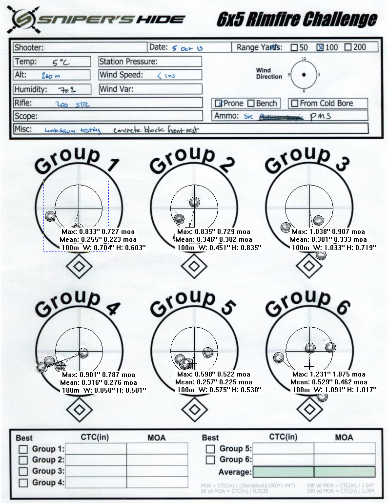

Well, i was so inspired by @jbell and @JG26_Irish that i had to make use of the windless conditions today. I started by trying to discard everything that i thought i knew about how to hold my gun - and start from the basics again. Damm good advice they gave. I can see that when i manage to remember most of the basics (npoa, trigger hand pressure, right elbow position, etc, etc ) i get better groups (best today was 0.424 at 100m ). however i still invariably forget one thing or another on at least one shot in a group :rolleyes:
i also learnt that a waterproof shooting mat in 47 F rain isn't necessarily a good thing ! Even though i was keen I gave up when my balls got tired of swimming. :eek:
Forcast is for another 6+ days of rain :cry::cry::cry:
Anyway, thanks folks for taking time to give me pointers !

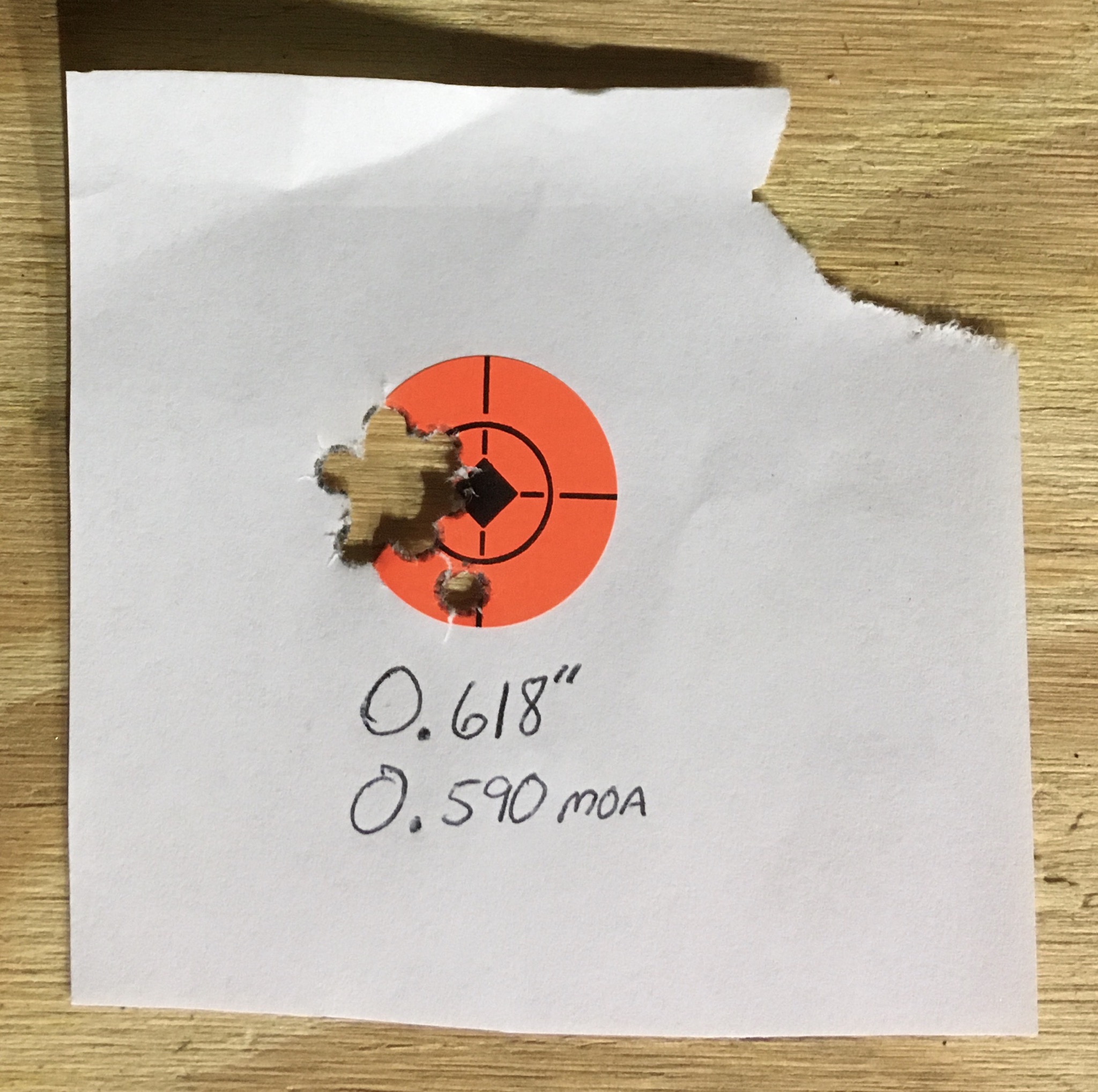

I thought I would circle back around to this in relation to the ammo’s capabilities. I went out for a quick trip to zero a scope I just put on a rifle last Saturday. I was shooting my Anschutz that I had specifically built for longer range stuff and chambered for Eley, it prefers Eley Match (black box) over Tenex for some reason. I have shot many great 100 yard 5 round groups with this rifle (down to just under 1/4 MOA). I shot a few groups at 100 on this trip that were pretty much on par for the rifle around 1/2 MOA, or just a fuzz over. I know Eley uses 10 round groups for their lot analysis so I decided on my last target I would see if the accuracy I was seeing in my 5 round groups would hold up for 10 rounds.
This is a random lot of Eley Match, nothing special as far as that goes. I am NOT saying I can repeat this with any regularity. My intent is to show what quality ammo is capable of.
That one round that dropped low may very well have been me, but who knows...

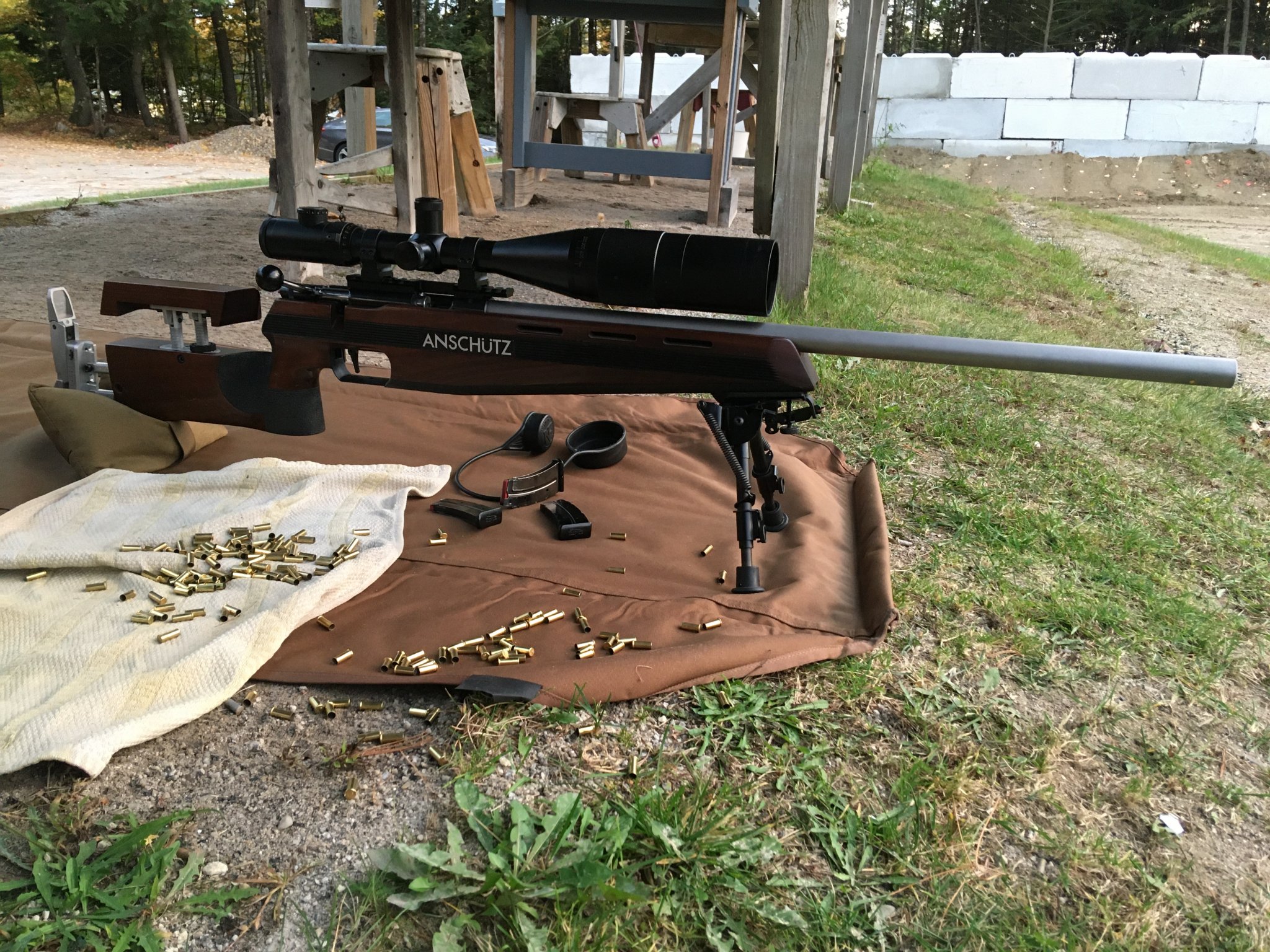

Here is the rifle with the new scope and my shooting setup, not exactly the most stable.
@jbell very nice group ! i admire that consistency - some day i'll be able to post a similar group !
Assuming the target is a 1" disk i see one of the differences that confuses me at times - i obviously use a different method of measuring groups. i get a ctc of 0.67" and 0.64 MOA ?
Hmm... good question, I measured it pretty quick at the range and the light was almost gone. I went and re measured in better light here in the house and is supposed to be a 1” target, but the target measures 0.987” and as best as I can tell the group is around 0.828” at the extreme edges so I was somewhere around 0.010” too small (0.622” ish group). But not really what I was getting at, I was just trying to illustrate what good ammo is capable of. I know that 1 group doesn’t prove anything by any means, and when I get home later in the week I’ll try and get back out to the range and repeat this with the Anschutz and my Vudoo. It’s an interesting conversation for sure, and really what I have always felt this thread is about (what can we do with these little 22’s).

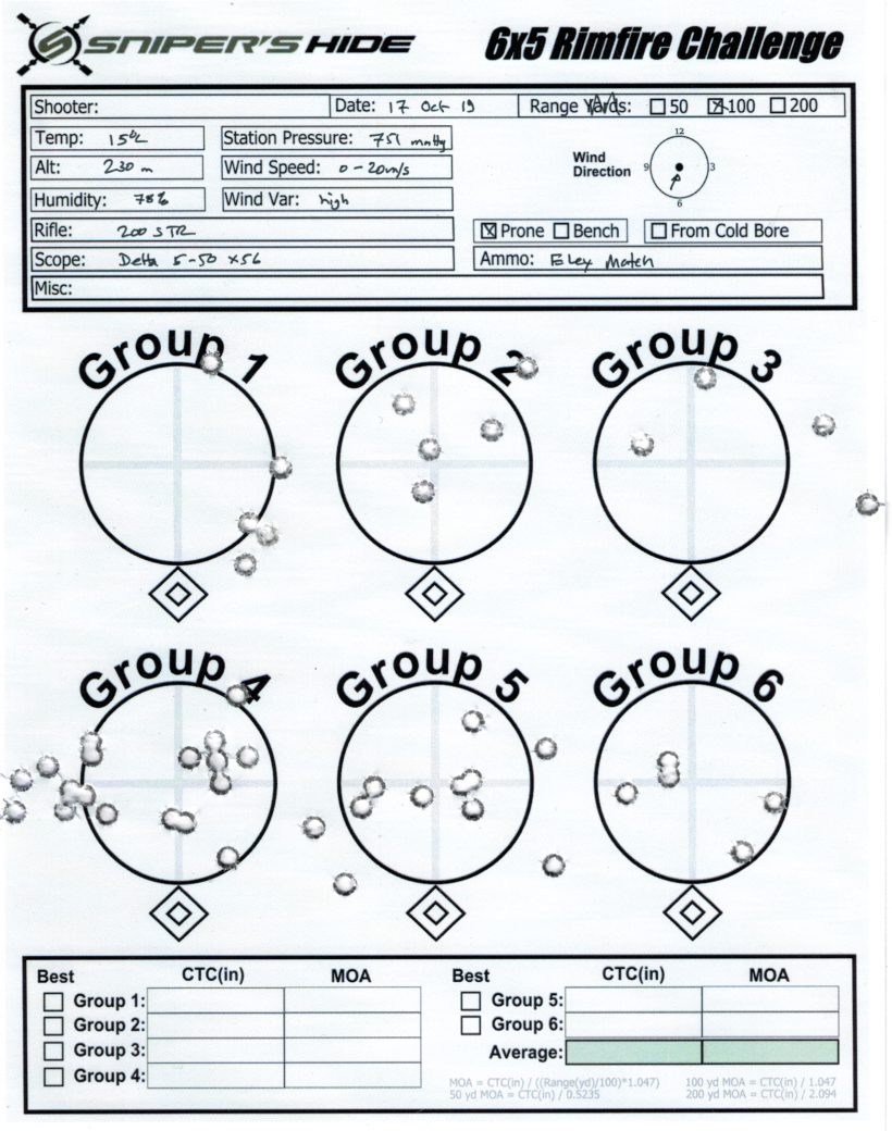

and now for some light entertainment .... ;)
it finally stopped raining and i was really impatient to see if i'd learnt anything with all my dry fire training ...
this was the result:
in my defence, my gun was blown over between group 3 and 4 ! I could watch 2 shots fired at group 6 get blown over into group 4 !
For some reason i haven't measured the group sizes :ROFLMAO: :ROFLMAO:
