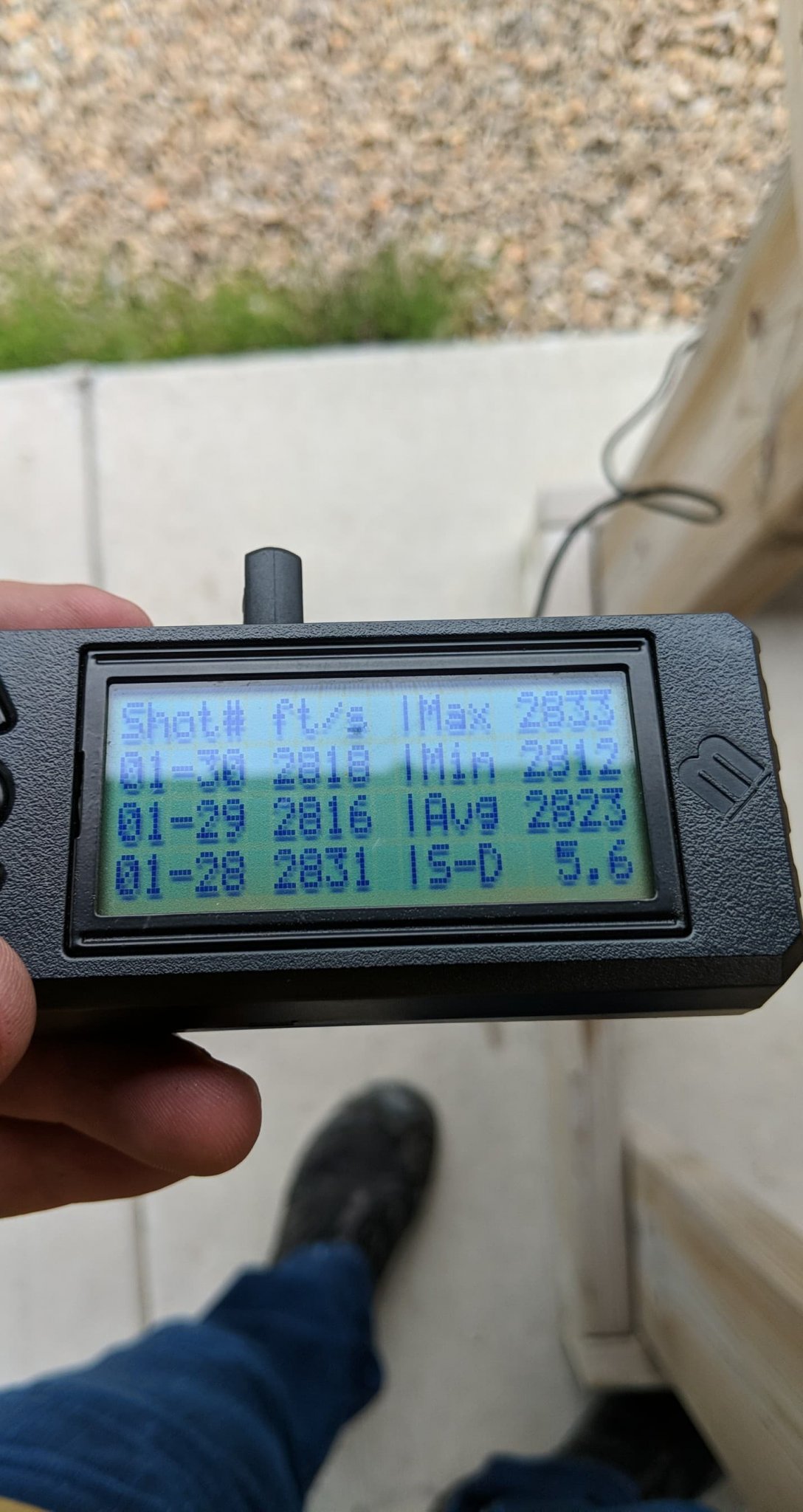

Loaded up some A-Tips today to find a node. I was specifically looking for something a bit slower based of some of the recommendations Jake Vibbert has made in his podcast in regards to shooting slower loads.
Found a nice one at around 2830 with 37.0-37.4 grains of RL16. Going to try getting out this weekend to narrow down the charge weight even further.
37.1, 37.3 and 37.5 of RL16 with a COAL of 2.750 and 2.760. Hopefully have everything locked down by the end of the day on Tuesday.
I did a little bit larger test than I normally. But I have the last two matches of the season, in the next two weekends so I wanted some good numbers.
1 String, 30 Rounds
Brass:. Alpha 6XC SRP
Primers: Federal Gold Medal Match
Powder: RL16
Charge: 38.3
Bullet: Hornady A-Tips
Jump: 0.025"
ES: 21
SD: 5.6
Average: 2823
I know it's slow but I'll be damned if it doesn't work really well.
I might be following your lead on the lower nodes. I am gonna slow down my 115DTACs to about 2850-2900.
I really wanna try a more dillion powder thrower friendly powder to get that speed.
