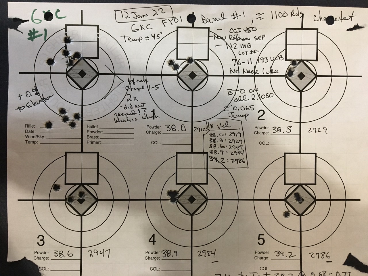

I just got a 6xc rifle with a bunch of Peterson LRP brass and 112 Barnes match burners.
Does the Peterson brass need to be loaded down compared to other brass? What are some H4350 loads you've used with 112-115 bullets?
Trying to work up the exact same load this week with 112s, H4350and CCI 450s. Only slight twist is I am going to try a bit more jump than I usually use;0.0650-0.0750.
Also new brass so not quite ideal. Amd apparently some “not ideal” lots of 112s.
I will try to make time and post some rests.
ZY
Just some initial testing 112MB, CCI 450, H4350 from 38.0 - 39.2. Seated about 0.0650 off lands. Mainly to get some basic 112MB data; had not shot them before.
-Just a single shot for vel to get some ballpark info
- 26” Bartlein with about 1k rounds on it
- 1st target was 1 of each of the 5 charge weight, two separate groups, O.4 mil offset—surprising consistent group “shape”…. Was clean barrel.
- New Peterson SRP brass. Forgot to graphite the necks---usually do for new brass--and it was a bit grabby seating bullets. For initial outing, shows promise
Expect I will work the 38.1-38.3 range—good velocity for me—and work seating depth to tune more. Expect I will try 65-80 off range.
Just some of my info FWIW.

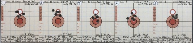

Figured I would keep the tread going.
This is a new barrel with only 75 rounds on it now. Broke it in with 25 shots using Sierra 110 MK’s and a mild load of 37.50 grs. Then ran another 25 with 110 A-Tips, with another mild load of 37.70. Cleaned barrel all the way down to prep for the DTAC 115 HBN’s. Ran 25 shots today.
It took 20 rounds from absolute clean bore for it to settle in, but it sure did that nicely with the last 5 shot group printing a .256
6mm XC (Tubb’s) 28” Bartlein 5R tube
DTAC 115 HBN - Seated at BTO=2.1835/COAL=2.7900
H-4350 - 39.38 gr.
CCI 450 Primers
Peterson SRP Brass
Vel: 2,942 fps
ES: 10 fps
SD: 4.2
The above load was a little stout, so I will back it down to 38.84 grains for the next range trip. This should put me on the harmonic node at 2,910 fps with the DTAC HBN 115’s.
