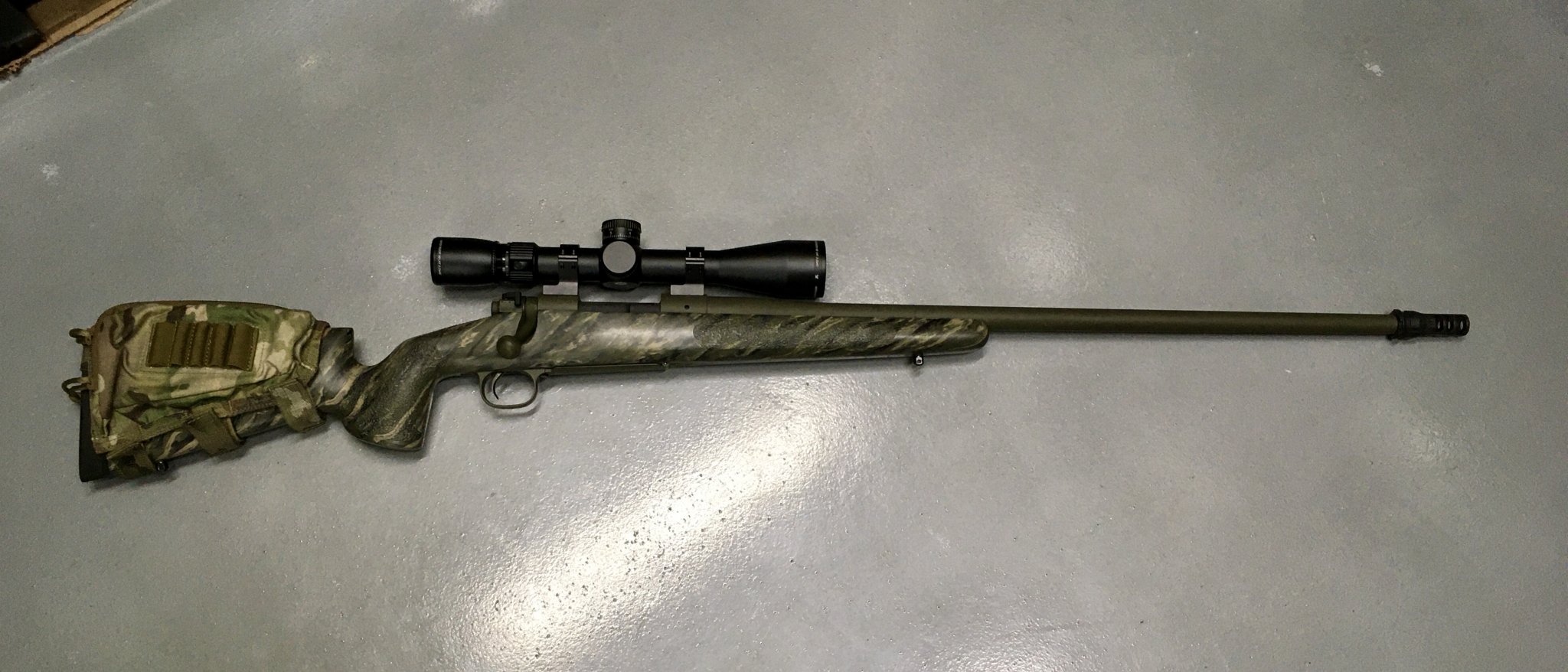

I’m using a .314 bushing with ADG brass and a 21st .284 expander mandrel.
I got my rifle back from PCR about a week ago so should hopefully get some data soon.
I have several bullets but probably shoot mostly Berger 180s with N565 or R26.
Win M70 WSM action
Brux #5 @26”
McM Game Scout
Talley LW rings
Vortex HD LH-T
Throated for a Berger 180 @ 3.0”
Right at 10 lbs
I hit in the improved SAUM 26"
Cci #200 or fed 210m’s
Not without possibly having a Kentucky ballistics moment.
2880 is doable without wrecking brass in my 28”tube.
My new 30” maybe will do 2910ish???

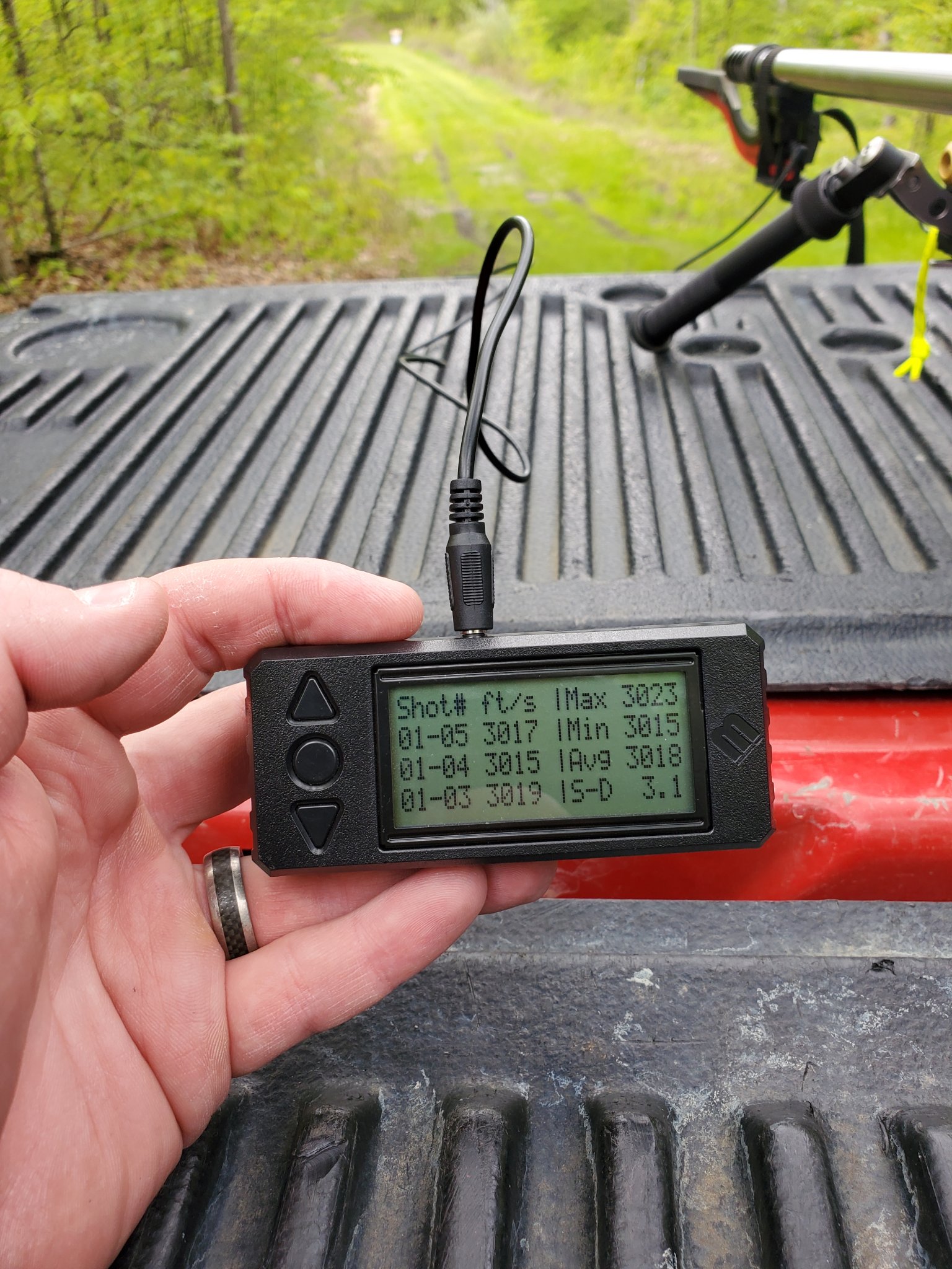

190 a tip with rl26 long action. 32 inch bartlein. Just a steel banger. Really impressed with the speed so far. 40 rounds on the tube
Reactions: Aussieusa
R26?
If so you’re about 72k
Yup rl26. Gonna try h1000 also. Dont see any pressure signs so far with rl26. I went another grain above this load and still no pressure. Rather run h1000. Seems to b mlre stable powder
If you don’t push R26 it’s about as stable as H1000.

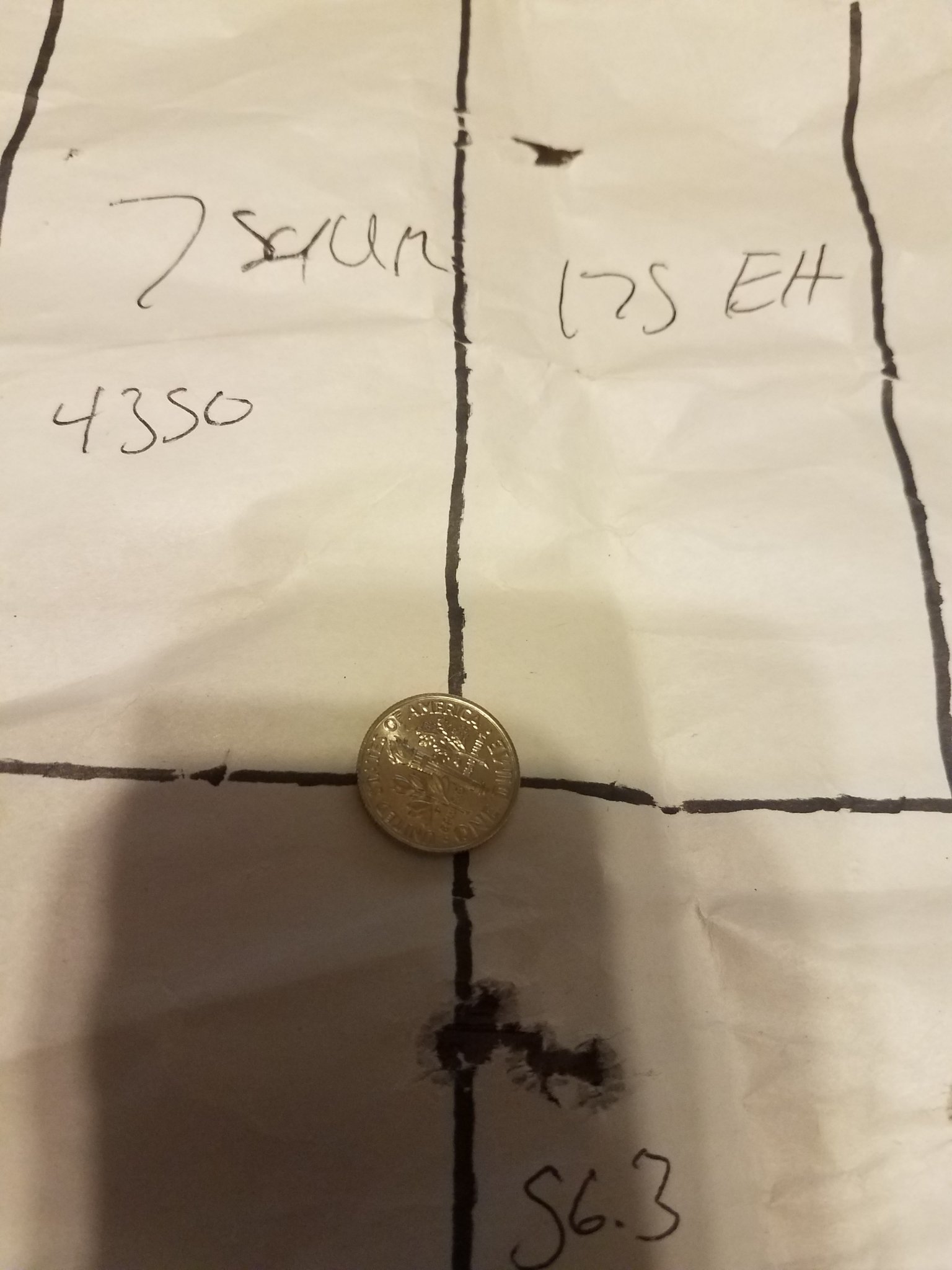

Ran some 175 elite hunters through my saum awhile back.
56.3 grains of 4350 got me 2950. Adg brass, 24" barrel , absolutely no pressure.
My buddy runs 175s at 2950 with a 26" barrel with 55.8 grains 4350. Group size is almost the same in both guns , Both r hunting rifles . Not one hole groups, this is 5shots in my saum. Es under 10 for 5 shots. For a hunting rifle I have no problem with this. If I was shooting at 2000 yards all the time I would definitely want better
My buddy runs 175s at 2950 with a 26" barrel with 55.8 grains 4350. Group size is almost the same in both guns , Both r hunting rifles . Not one hole groups, this is 5shots in my saum. Es under 10 for 5 shots. For a hunting rifle I have no problem with this. If I was shooting at 2000 yards all the time I would definitely want better View attachment 7632694

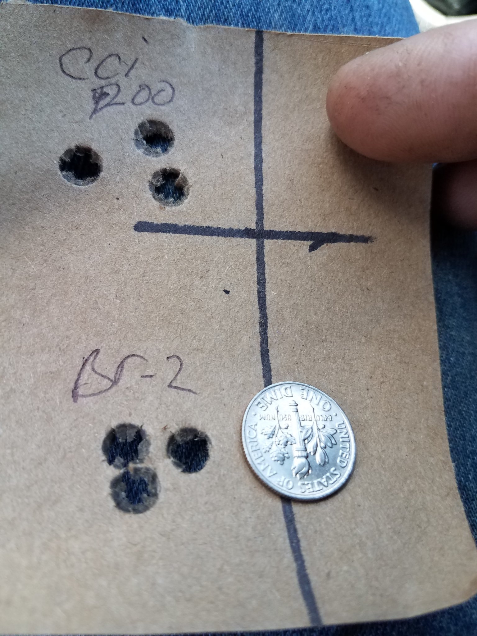

Jabot what primers are you using? I have been playing with ELD X 175@ mag length, Fed 210M, Norma 7 SAUM brass. I started getting heavy bolt lift consistently on 56.6 of H4350. I was struggling to push 2900 running a 24" proof carbon. I also have RL23 to play with and I'm switching to CCI 200s to see what that does. Barrel has 156 rounds on it so it should be leveling out if it hasn't already.
Funny u post this ,went and did primer test this morning. Don't bother with federal 215s. Br-2 3 shot es 5. Sd 2.9.
I know that's not a huge sample, but it will work for me.
I know that's not a huge sample, but it will work for me. View attachment 7637604
