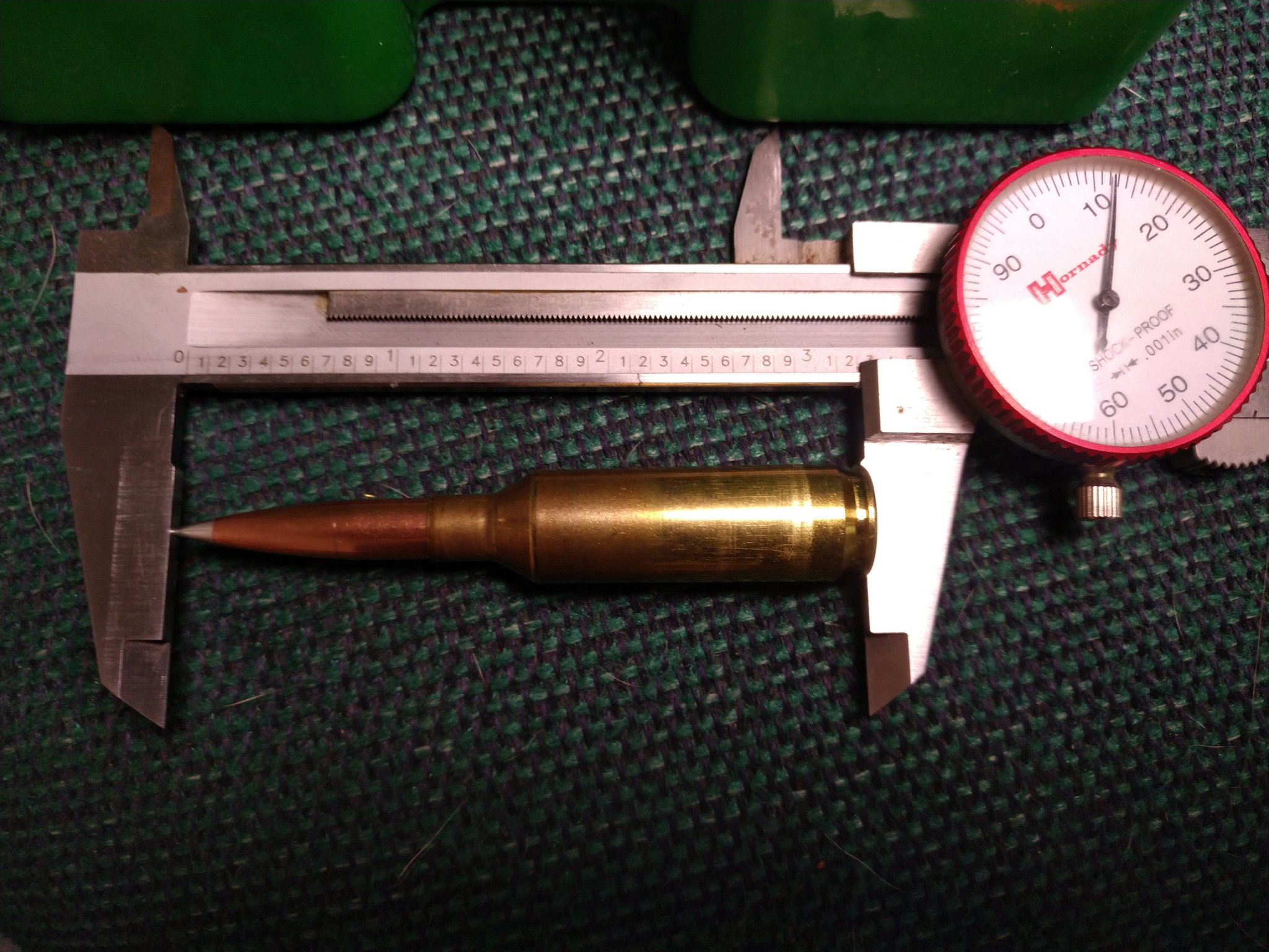

Got my 7 SAUM DTA barrel back last week. It's a 8.3 twist 24" Hawk Hill with a long throat (.200 I believe). I only have 190gr Atips and H1000 at the moment.
190gr Atip
Hornady 6.5 SAUM brass necked up
H1000
Fed 210m
Loaded .020" off the lands
Hit my pressure at 63grs/2755fps with mild ejector swipes but no other signs so it maybe the brass. I'm going to do more load development once I get some 190gr Berger LRHTs to try.

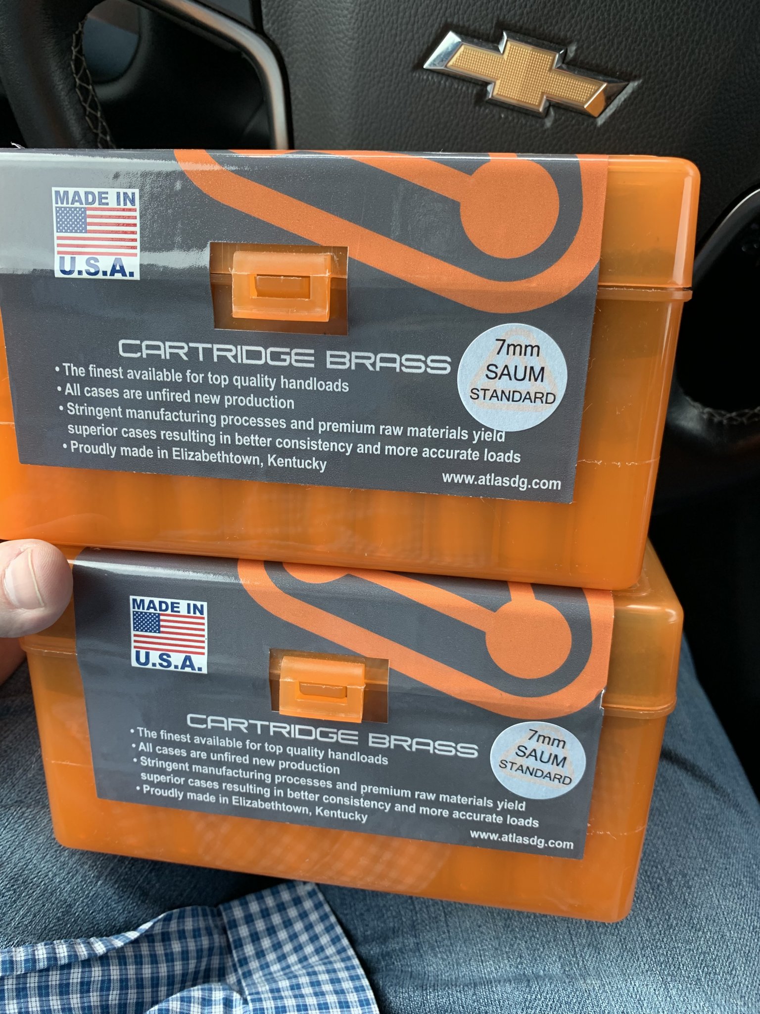

Awesome thanks, how many reloads are guys getting out of ADG brass with a moderate load?
I'm at 14 reload cycles on my ADG and primer pockets are starting to open up. Likely won't get more than a couple more cycles out of them, but no complaints. I run a fairly stout load just short of heavy bolt lift/ejector swipe.
I sure hope so! I have a brand new build and no brass:(
I wouldn't hold your breath for ADG brass I've been waiting forever and seen lots of guys waiting for well over 6 months. Personally I've been buying Norma / Nosler anytime I can find it where I realize that ADG is prob the best If I cant buy it then it being the best really doesn't matter...

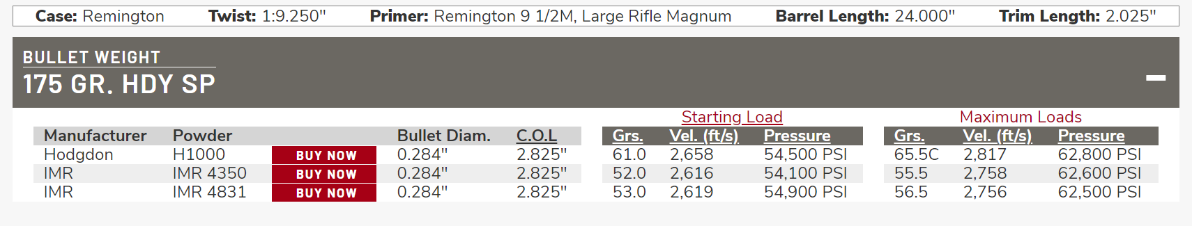

I scored some IMR 4955 and was wondering if anyone has data for this in 7saum? I've found some data for it for 7 mag, was going to drop a grain from their min load and build up from that sending Berger 168gr VLDH.
Drop down a grain from 7 mag minimum? Or 7 saum minimum. The burn rate chart put imr 4599 between rl-26 and 4350. Dont know anything about this powder, but if your going a grain below 7 mag charge wieght, might be a problem in the saum
I ran 57gr of 4955. My notes say, Heavy bolt lift "reduce charge and reduce CBTO". No speeds.
162 ELDX new Nosler 300 SAUM brass CCI 200. I did not try it in ADG or Gunwerks brass I moved on to other powders.
