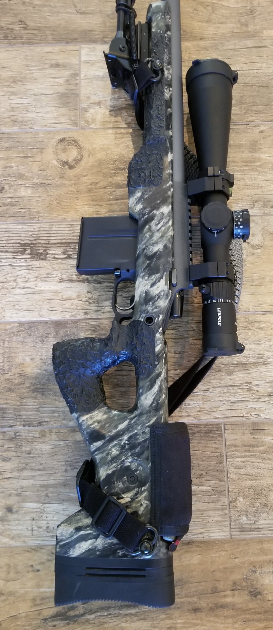

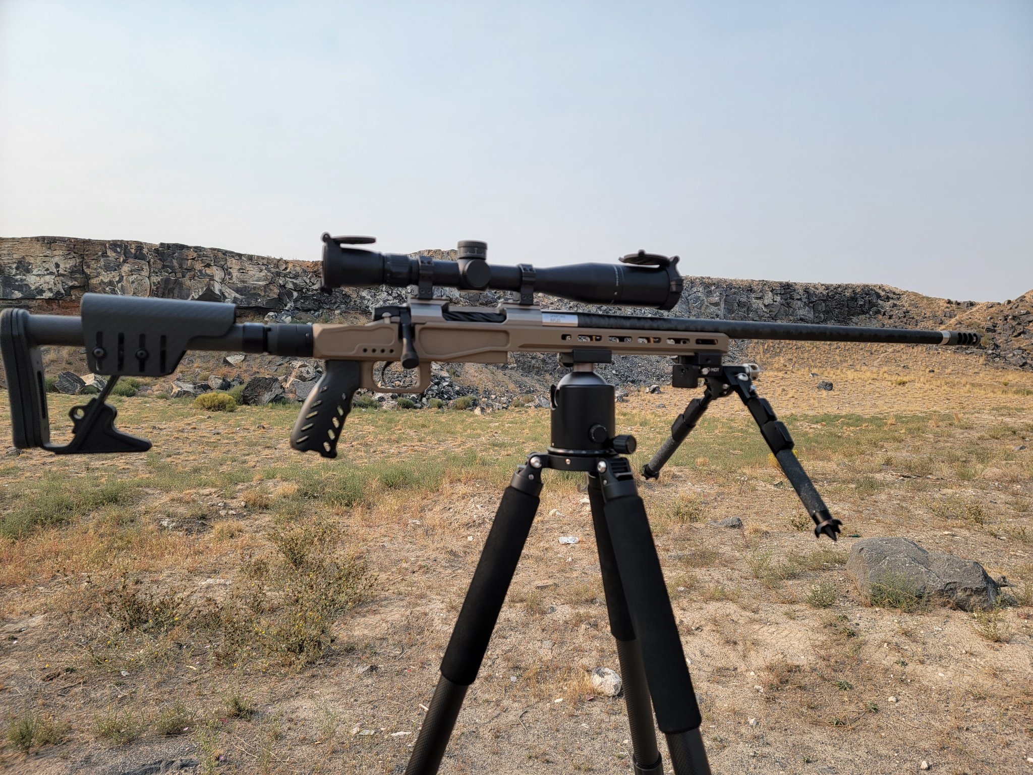

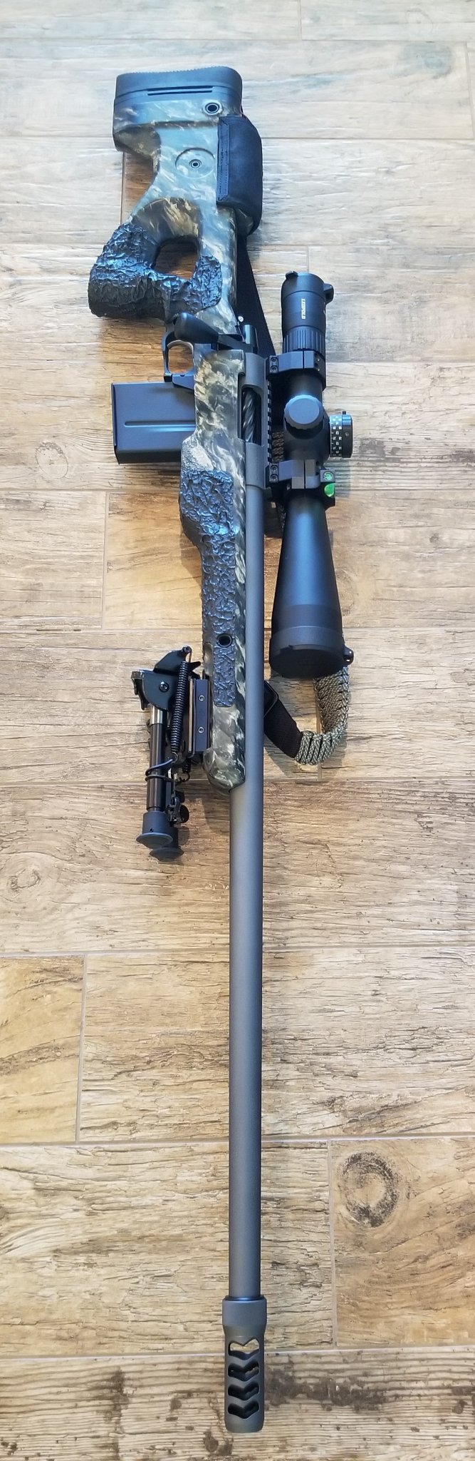

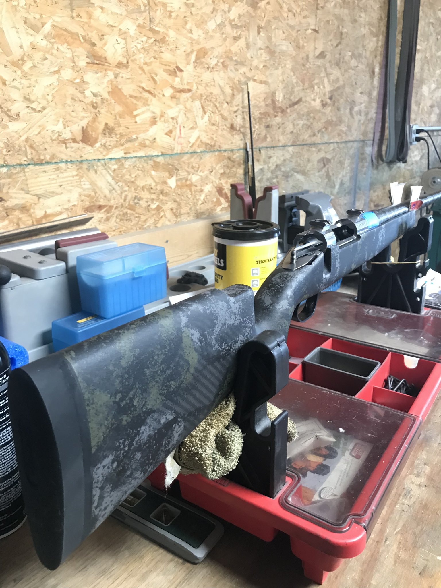

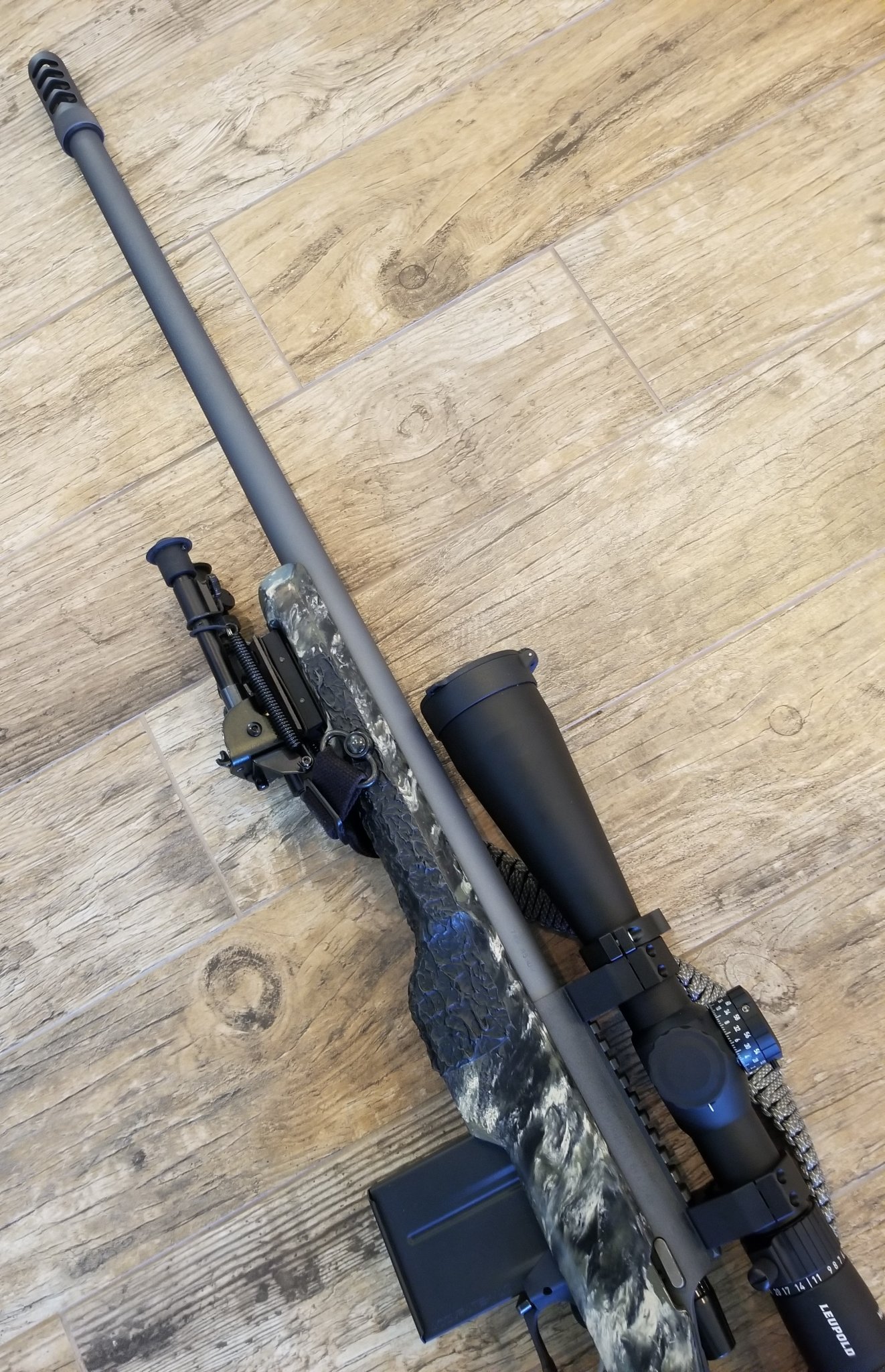

Finally got everything back from the smith swapping from 260 Rem to 7 SAUM... Magnum Bolt from BAT Machine, 28" Benchmark 1-8.5T barrel, Accurate WSM Mags, Area 419 Sidewinder Brake. Had my smith trim feedramp to mag feed 2.970 from a short action. Not sure if I was more excited to get my rifle back or the fact my smith had 10lbs of IMR 7977 he let me have for $275 that I'd been searching for. Load develop coming ASAP with IMR 7977 and Berger 190 Hybrids hoping to get around 2800fps

Load development with IMR 7977, Berger 190 Hybrids, Winchester Large Rifle Primers, Norma Brass, 28" Benchmark 1-8.5T Barrel. This was the first 30rds down the new build I haven't messed with seating depth yet. Loaded everything 2.970" OAL. Shot at 82D Fahrenheit, Zero pressure signs throughout all the charges. Didn't try to get extremely tight groups yet as build is brand new. Thanks to @Steel head for getting me a great starting point with everything.
60.5g = 2741, 2748, 2740 = AVG 2743fps = Group Size .99"
61.0g = 2767, 2764, 2763 = AVG 2764fps = Group Size 1.65"
61.5g = 2768, 2764, 2801 = AVG 2777fps = Group Size 1.55"
62.0g = 2827, 2833, 2825 = AVG 2828fps = Group Size 2.25" Compressed Load
62.5g = 2842, 2821, 2856 = AVG 2840fps = Group Size 1.37" Compressed Load

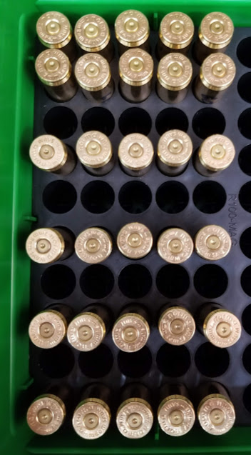

Need some guidance on what you guys would try next, did another small ladder test with IMR 7977 and IMR 4831 with speeds and groups below. Im not getting the groups Id like to have with IMR 7977 before I start fine tuning in on something. Im thinking I might try Magnum primers with the IMR 7977 to see if it does anything to group size and to verify its burning all the powder. Usually I try to dial a load in based on its running the speeds I want and under 1" group. Im trying to get around 2850 - 2900 and 1" group then start tweaking the load, obviously the IMR 4831 is too fast of a burn rate for Berger 190's dont think the speeds are ever gonna get there. Berger 190 Hybrids, Winchester Large Rifle Primers, Norma Brass, 28" Benchmark 1-8.5T Barrel loaded 2.965" OAL, Build has 60rds on it currently. Thoughts...?

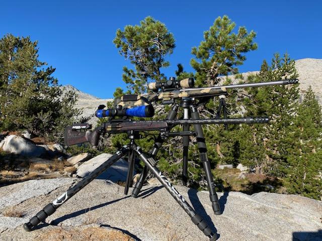

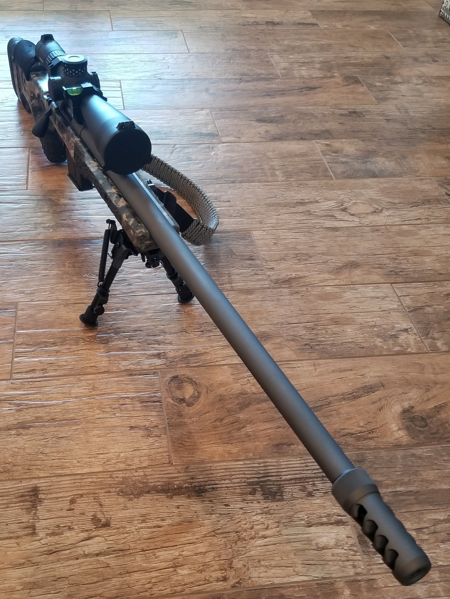

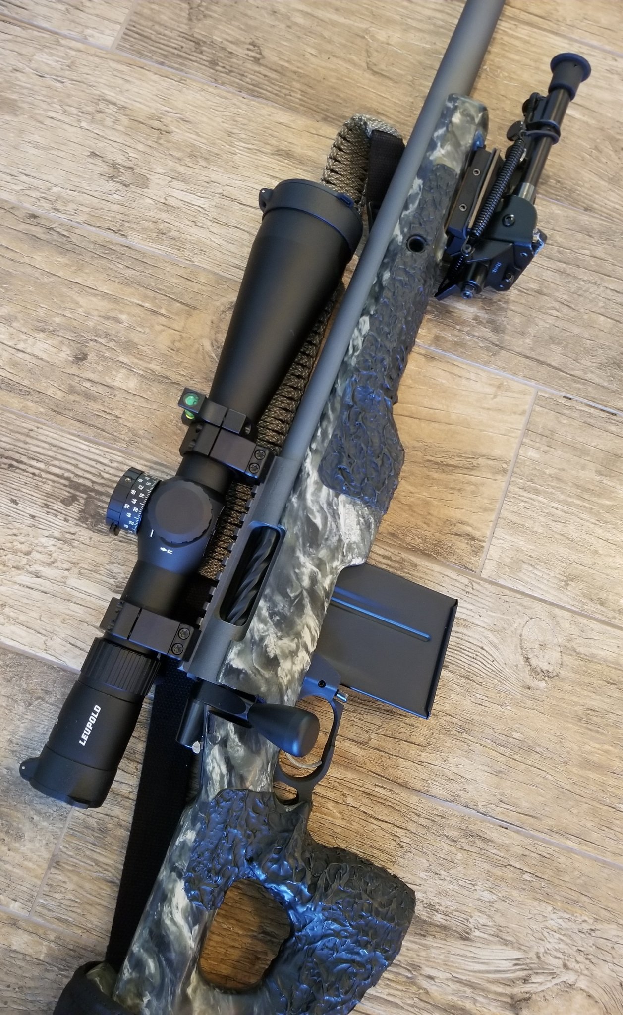

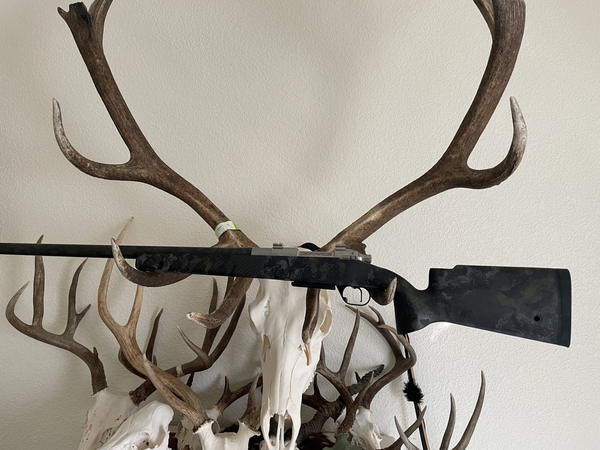

Here's my 7 SAUM hunting rig. Lone Peak Fuzion Ti XM Length, Bartlein 26in Carbon, XLR Magnesium 4.0 chassis topped off with a Vortex Razor HD LHT 3X15. Load is 180 ELDM, ADG brass, RL26 at 61.5 grains going 2858 FPS. I had the chamber throated for the ELDM by Spartan Precision.

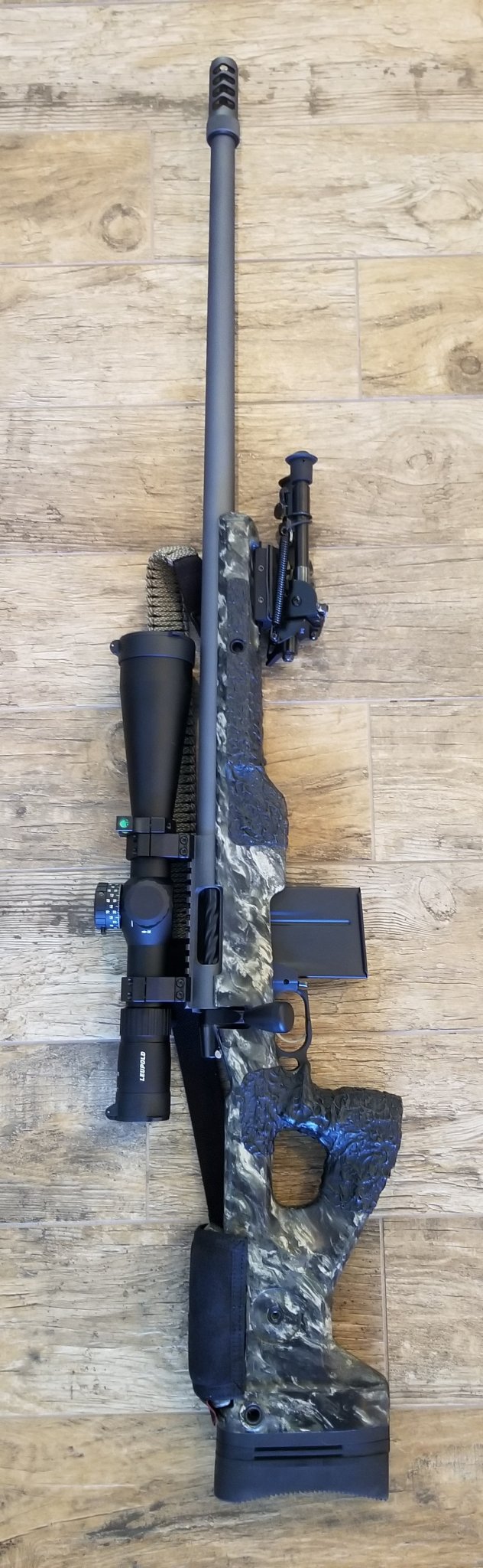

Love my 7 saum, it's the gun on top . Buddies 300 prc bottom
Origin action
Pva prefit 24"
Manners t2a
Mark 5 3x18 tmr
Warren mtn tech rings
Shooting 175 elite hunters 2900
Took a shot at a rock 1240 yards, first rnd impact dead center, elevation 9300 ft. Its good to know the system u are using works.

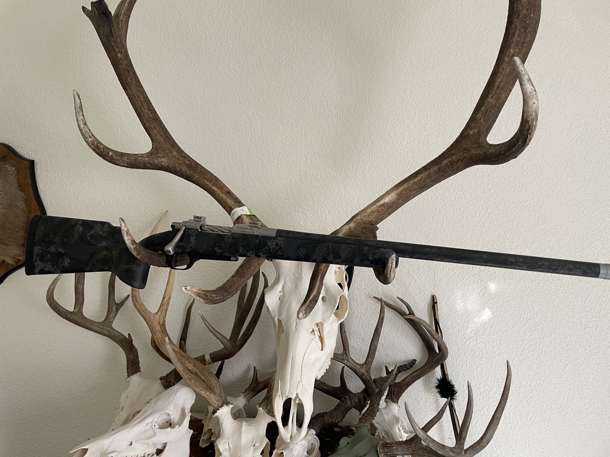

Worked up to 61 grains of RL26 behind the 175gr eldx. Good for 2860 FPS in a 24” barrel out of a short action. Will do some more fine tuning after hunting season but no pressure signs at all and the barrel should speed up a bit.

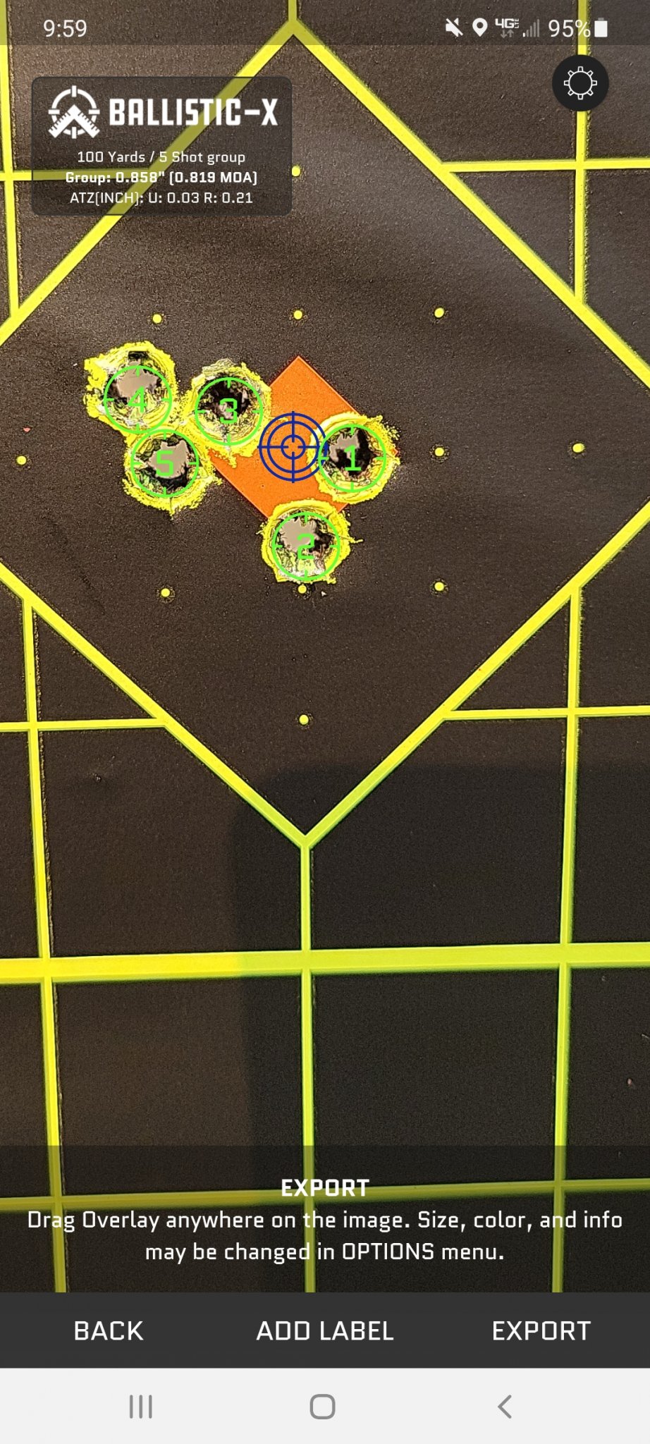

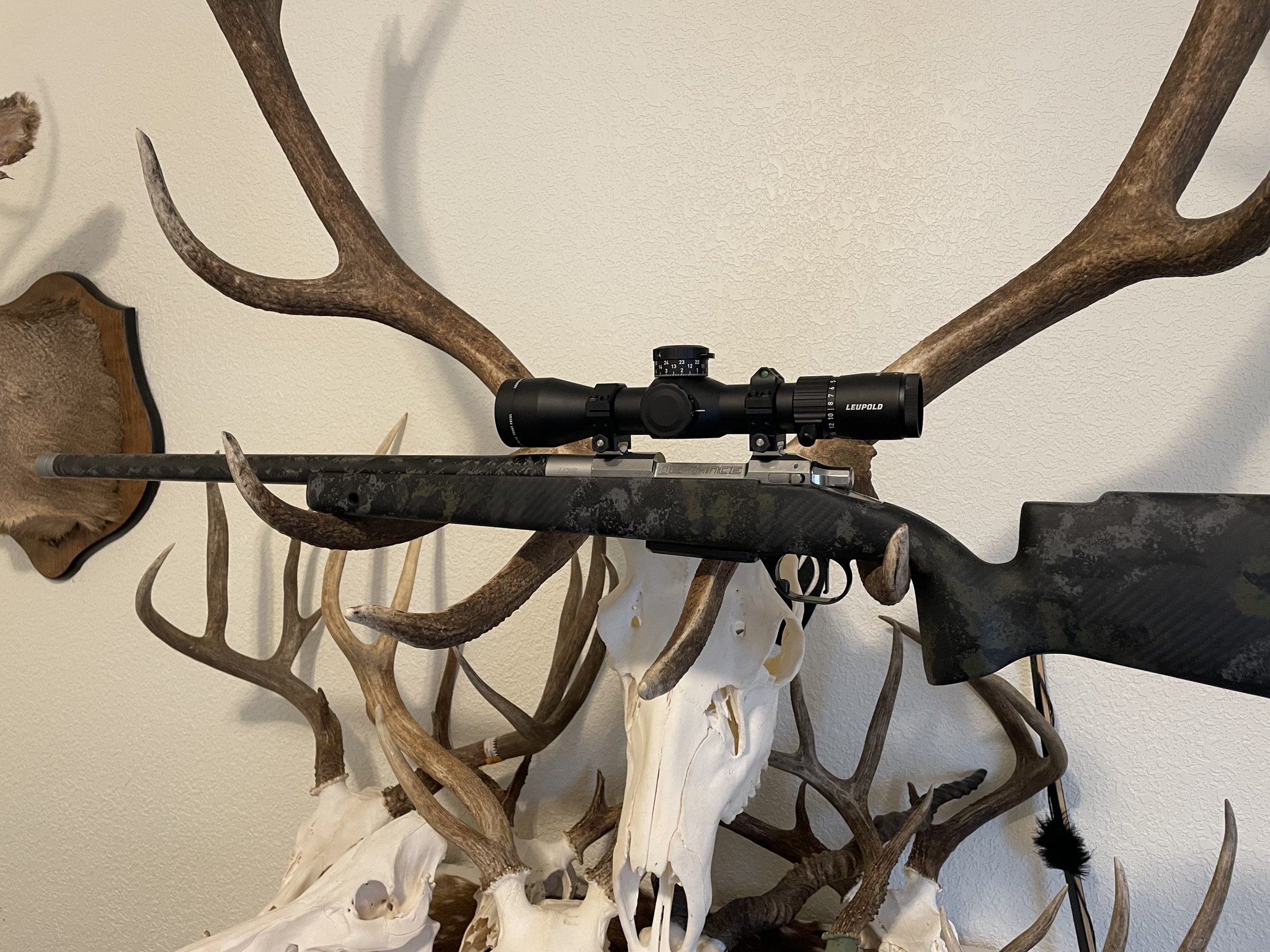

So I know it might not be to everyone’s standards on here but here is my recipe.
APR built. Thanks if you’re on here!!
24” 1-9” barrel rem700 w/wyatts box
7saum
Leupold VX6HD 3-18x44 fire dot
I’ve only shot the rifle about 60times. Hopefully with tweaking it will get better. Tried H1000 and didn’t get velocity before pressure started to show.
reloader23
Berger 175 elite hunter
2.200 BtO
ADG brass
Fed215M
2880fps
5 shot .494
4 shots minus the last shot that nicked the bull .323
