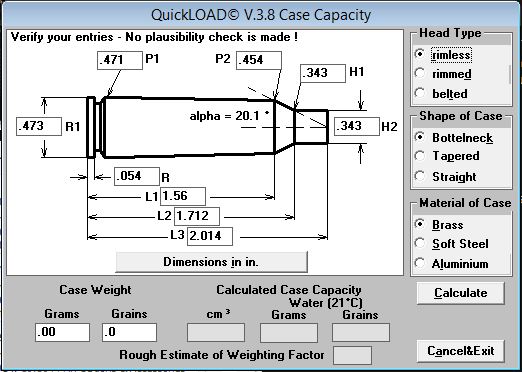

    Greg,
    You don't happen to have the information needed to add this case into quickload do you? I like to use the optimal barrel time method for loading and that means spending some quality time in quickload prior to building any rounds.

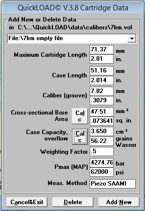

    Greg, if i did this properly included should be the screen shots from quickload on what data is needed to build the case to run some numbers.
    the numbers already in are just what quick load put in. so give them zero weight.
    I hope someone can provide this info. I don't know how to take a lot of these measurements or else I'd do it.
    Thanks Greg, do you by chance know the pmax? I think that's the only info not on your drawings
    Also need maximum cartridge length if you have that available.
    and caliber groove, and bore, number of grooves
    ok i should have figured out everything i needed before posting, but also case weight, i think that will finish it out and then i will have all the data, once i get that i will post the quickload file if i can.

    The case weights I had were all over the map - there was easily a 10-15 gr spread between the 400 cases I ordered. I'll post my numbers in a few days.
    I figure that the grooves of the barrel are probably the same as any other 7mm, and all 7mm in quickload had the same info for that so I just used that. So a good oal, pmax and case weight is all I need to start running numbers.

    OAL with a 175gr ABLR is 3.375" and an average case weight is about 260gr.
    No idea on where to start with pressure. However, as a modern magnum cartridge, I would bet it would be close to others with similar capacity.

    https://drive.google.com/file/d/0B4EFWY3aPaRORWFhbkJacGR5c2s/edit?usp=sharing
    If i did this properly this should be the file to the quickload file i made for this...if someone who uses quickload could sanity check it for me that would be great. The other 7mm magnums all had pmaxes between about 60000 and 64000 so i used 62000. When i put everything and adjusted the burn rate to match your muzzle velocity Im getting a pmas of 61460 with 72 grs, so under that max pressure, 73 gr give 64498 which is over, but not by a lot, and 74 is showing 67698 so over pretty significantly (this was with the 168 berger load in the first post.)
    the burn rate factor i used was 0.39. if i used the defaul 0.366 it did not show any overpressure until 75 gr and was 100fps slower. so for your lot of h1000 at least it looks like it has a little higher burn rate.
