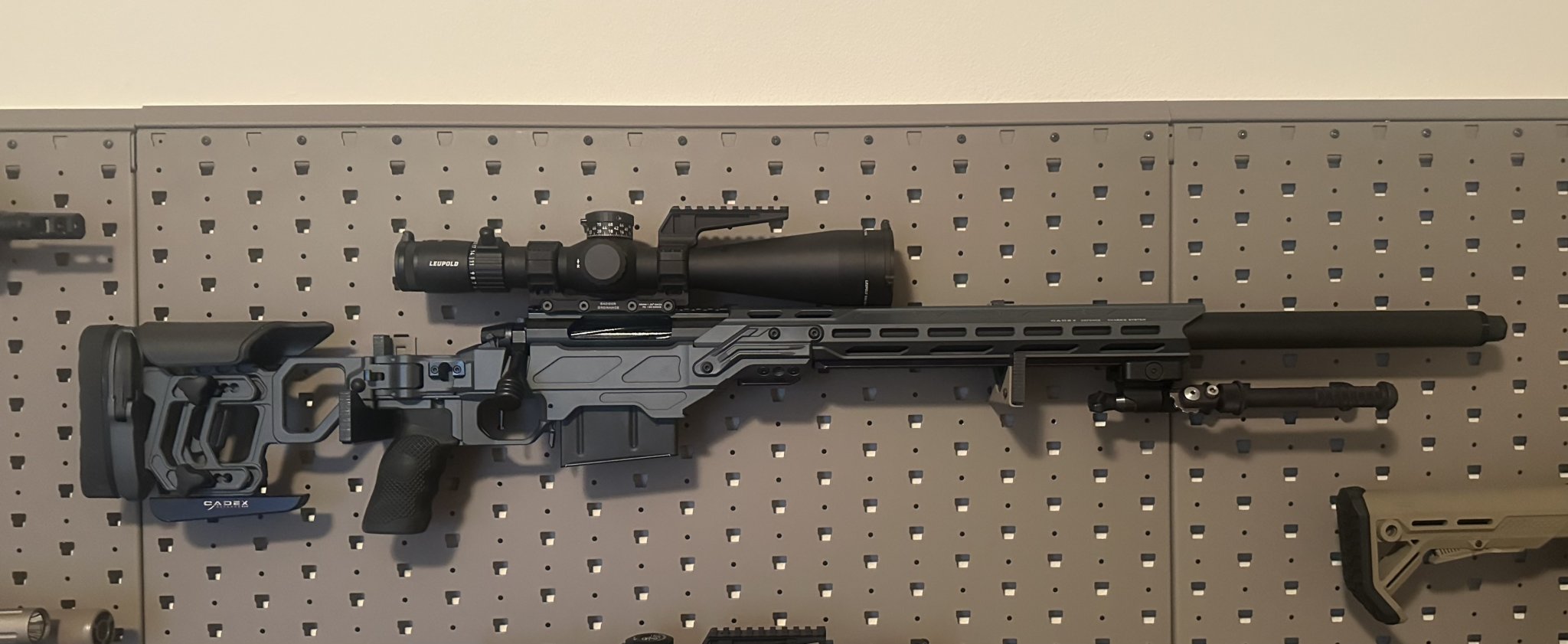

Most of my rifles are v heavy "crew served weapons". This is my very first "lightweight" hunting rig.

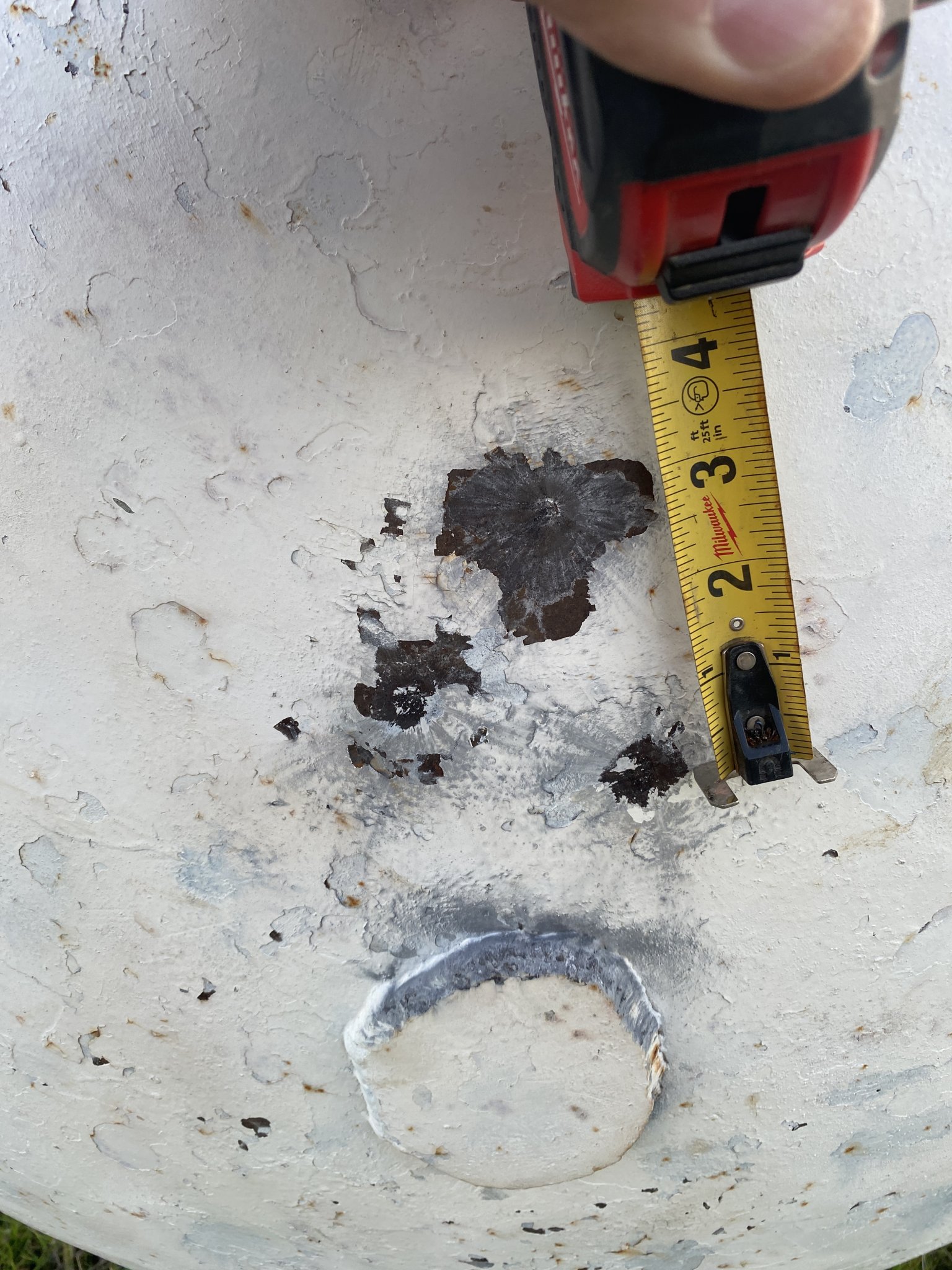

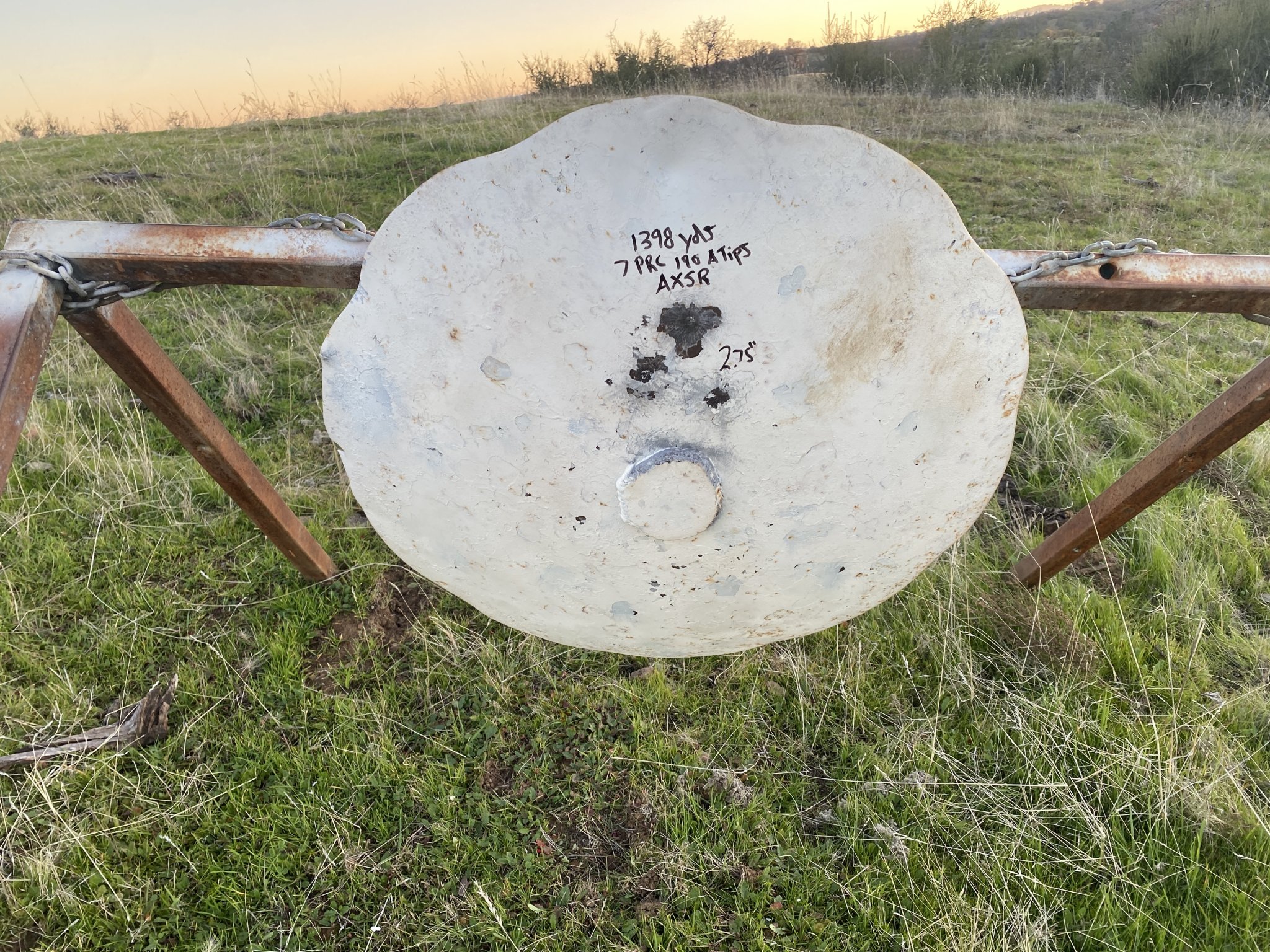

190 A Tips over N570 just work….

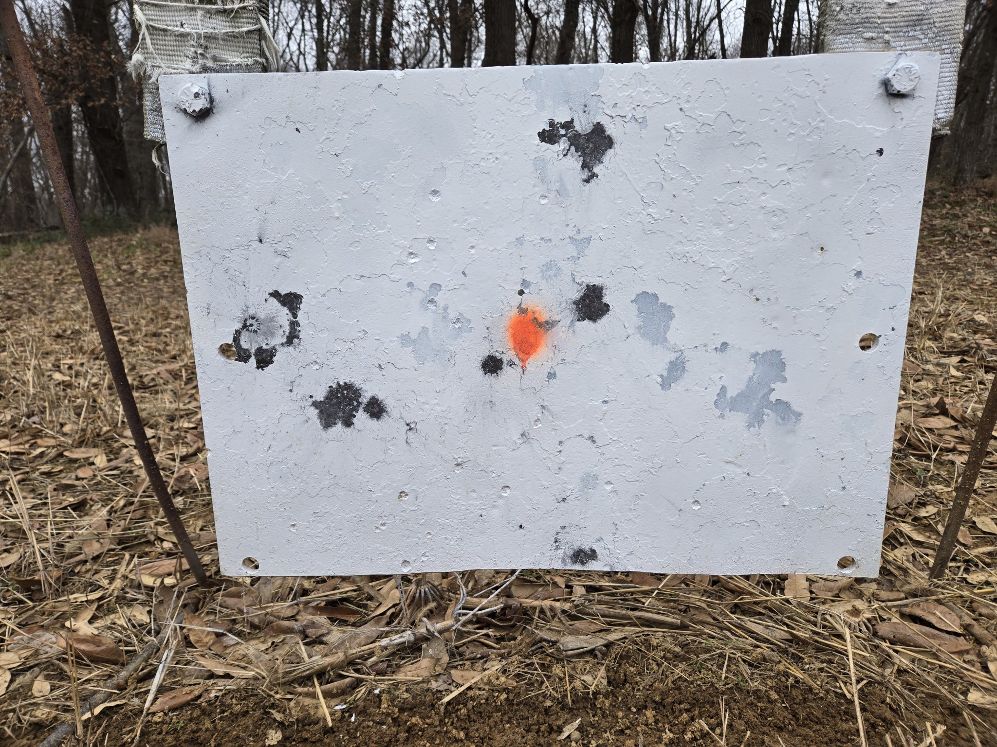

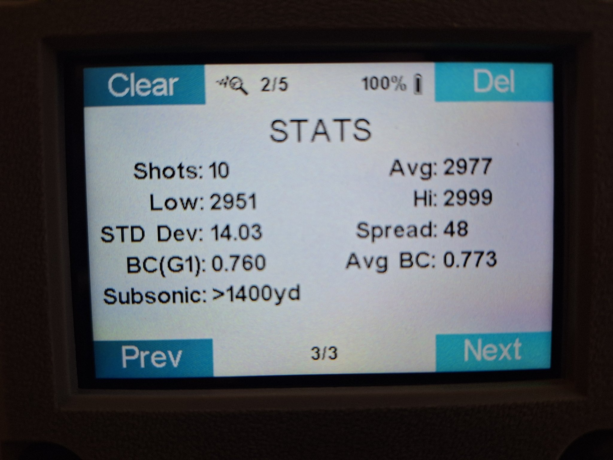

Took my Defiance AnTi-X (pictured above) to the indoor 100 yard tunnel range tonight in SLC. Specs are long action, 24" proof 1-8.4 twist, Leupold 3-15x44 scope XLR Element 4.0 magnesium, Hellfire 3 port brake, Harris bipod, unfired till tonight. Spun up by Eric Smith at ES-Tactical, and he always does phenomenal work. Took 3 rounds to get centered then I fired the following loads in the chart below. I would not pay attention to the SD, there are several reasons I won't elaborate upon, why they are all over the place (part of it is the tunnel itself messes with the radar). Also, the first group of 4 was right at 0.5", one ragged hole. They deteriorated after that, I thought it was me getting my cage rattled in the tunnel, then I realized I never torqued down the side bolts to the rings beyond finger tight! And the scope was loose, and my crescent wrench was missing from my range bag, so I called it quits after that discovery. Anyway, I'm posting this data for velocity and pressure information. Only the last one of the 69.0 grains of H1000 in Hornady brass had just slight increase bolt lift, and an ejector mark. I usually back down from that a grain, so I think I'm going to settle on 68 grains. (QL thinks 68 grains is 106.7% full [not even close!], gets 62342 PSI, and produces 2886 fps - so close to my results and almost max velocity/pressure on QL, FWIW.) All cci 250 (as if that matters). COAL is 3.310, which is .025" off the lands. The 69 grain one is 99+% full - I can barely hear it rattle and there is no crunch. QL thinks this should be 108% full for some reason that is beyond me - this is not a compressed load AT ALL. The case capacity is just shy of 82.0 grains H20. Ambient temperature was about 65 degrees in the tunnel, but the ammo started at about 40 degrees and I warmed the rounds up (a little) in my pocket before firing. Powder humidity was 48.5%RH at the time of reloading and at 60 degrees F. Also, I never shot more than 3 rounds before cooling the barrel with my Ryobi inflator gizmo - this is my first time with a Proof and they do indeed heat up and require some real air movement or time to cool off!
Final analysis: 2900-2950 fps is definitely possible with 180 ELD-M and H1000 in some guns, even with Hornady brass (gasp!). Assuming this barrel will "speed up" as they are rumored to do, 2950-3000 fps is possible. These velocities may change as I transition to Lapua brass later this year (hopefully). Wheeler or Ackley or one of the wildcat guys said on the forums about 10+ years back that you should do load development in weak brass as a worst case test - if you're at/under pressure there, you should have a good margin of error for strong brass, which can hide excessive pressure because it's so strong. I like that idea, because I like to have a good margin of error for temperature changes, lot-to-lot changes, powder humidity changes, etc. Hence, I will be using these same 50 pieces of Hornady brass and see where things settle out, rather than chase speed and blame the brass as I have seen others tempted to do. I have not checked the primer pockets on the 69 grain loads yet - but they are neither flat nor cratered.

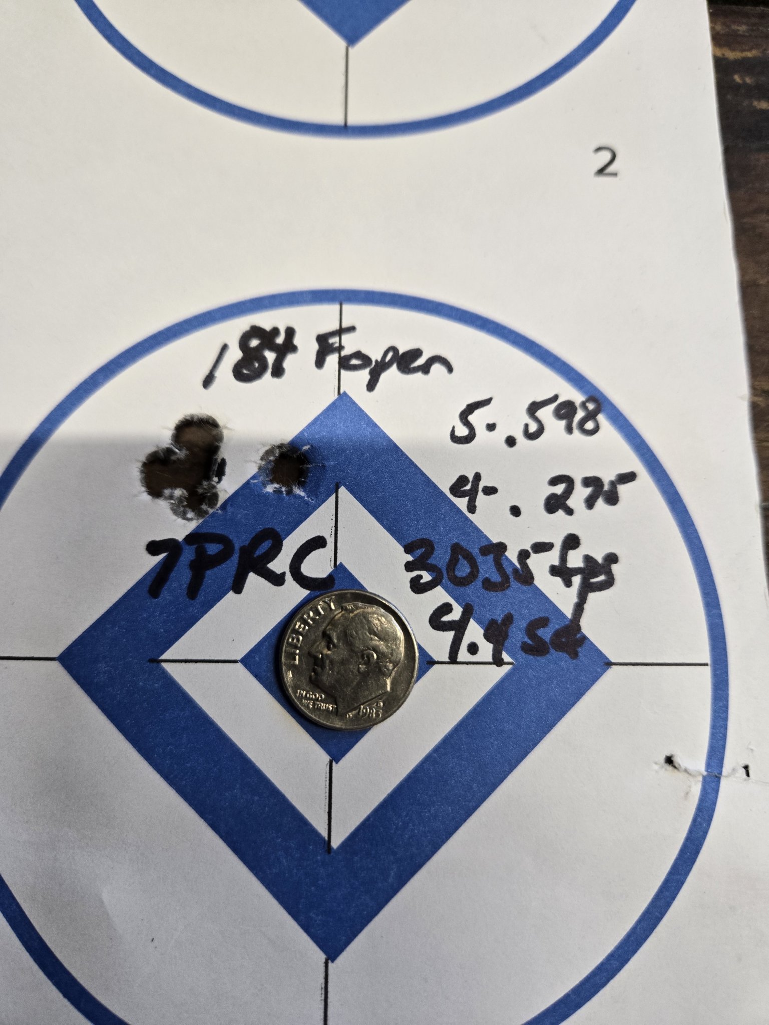

I've been using adg brass, cci 200 and 70gr h1000 with 183smk and 184 f open. Smk are running 2998 and the f opens are running 3025. I quit the 183smk due to bullet inconsistencies, as much as .025 diff in length. When I watermarked the loads at 950 and 1400, the smk had 3x as much vert. Shot without windflags. Smk@950, felt great and didnt have any called off-shots
184 bergers@950
Can't seem to find the 184group at 1400, but here's the 183smk:
They are about 75% consistent, but the variation on the outliers are ugly. Here's the rifle, cdg long action with 26" pva m24 contour in a bedded a5.
The 183 group was the last of those i had loaded up, they shot way better when doing loadwork. They shot so bad i fired a 3rd group of 184s to check that something wasn't wrong with the rifle, lol.

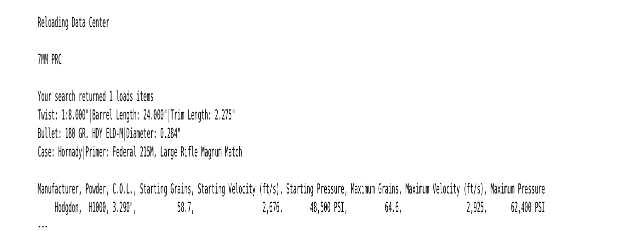

Shot my 7 prc for the first time today. The speed was significantly slower than hodgdon data but I think others are seeing similar.
Hodgdon had me at 2950 with 64.5g h1000
Barrel: 26” kreiger
Brass: ADG
Primer: 215m
Powder: 64.5gn H1000
Bullet: Berger 180 hybrid
Actual speed: 2770 (15 shot group)
Sd: 8.3
Es: 25
This was very inline with what Hawkins write up had. I just have never seen the book that far off

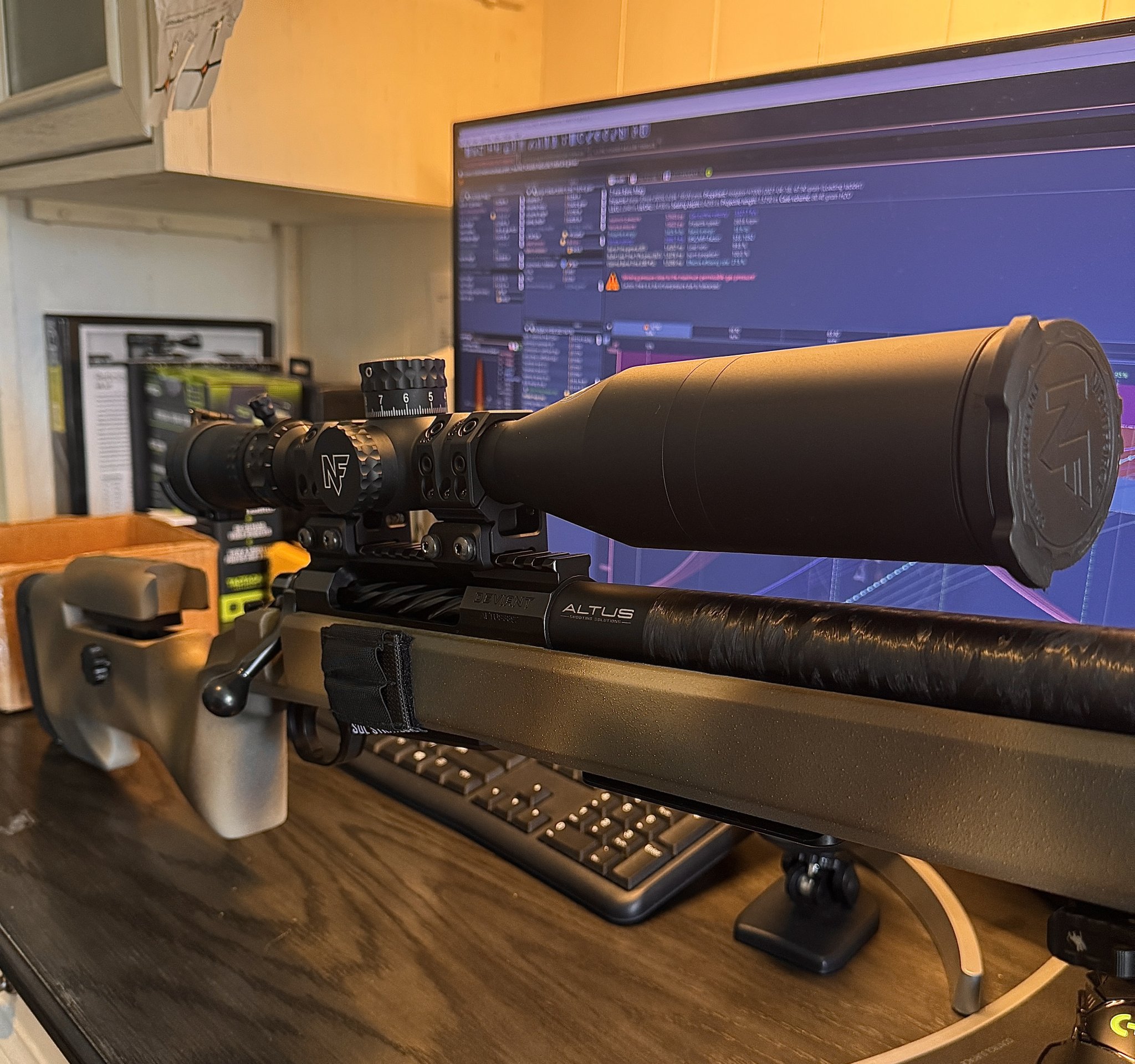

Fixing to begin loading my custom 7 PRC hunting rifle. All brass (ADG) has been fire formed, and barrel has officially speeded up. This rifle seems to have great ES/SD across many powder charges with H1000 in my 1:8 Bartlein CW 26” M24/M40 barrel. Gonna experiment with the Berger 190g LRHT, 184g Hybrids, & 180g Hybrids. Will share data as I progress with finding a repeatable load for the rifle, picture posted below:
Specifications:
Builder: Altus Shooting Solutions
Defiance Deviant Tactical (DLC) “Bedded”
TriggerTech Diamond single/pro curve
26” Bartlein CW M24/M40 1:8
APA Gen III little bastard .30 Cal
Hawkins Precision Hunter DBM
Carbon McMillan U10 w/4” ARCA & 2” picatinny
Spuhr 1.35” Rings
Nightforce NX8 4-32x50mm F1

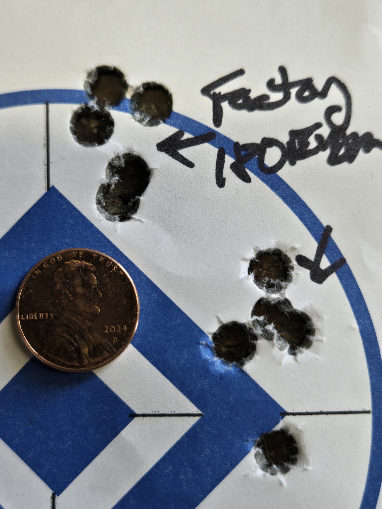

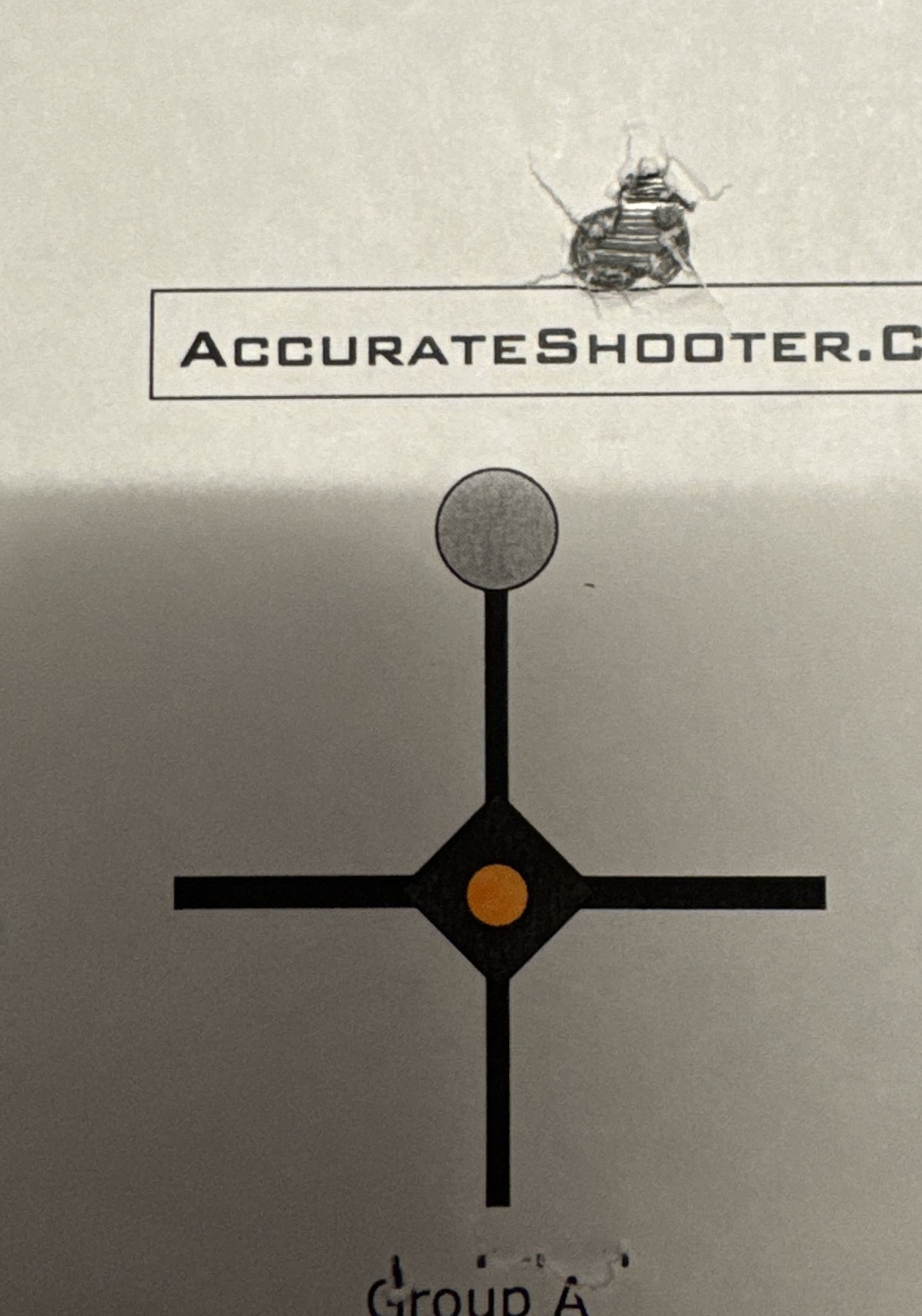

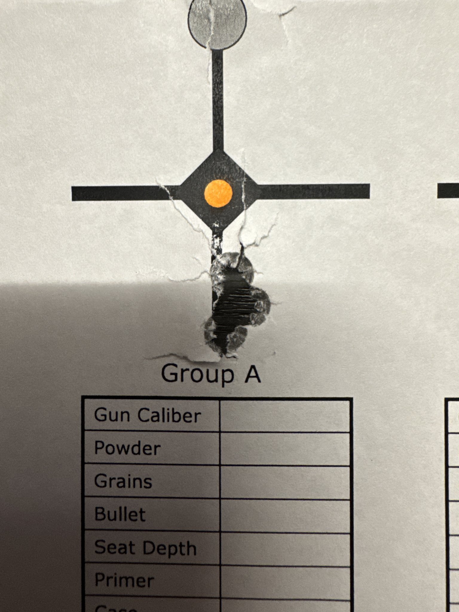

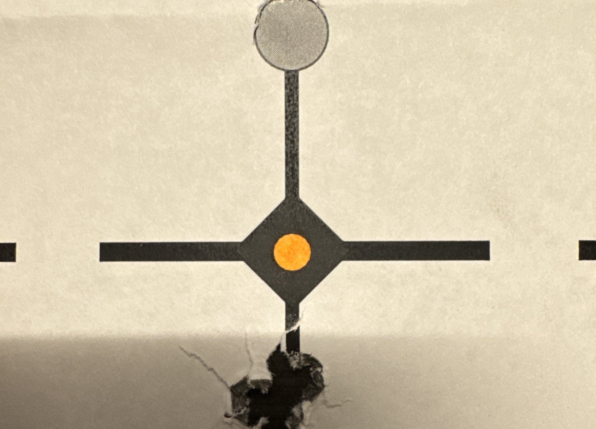

Range report from today:
Started with a clean barrel, followed by 3 fouling shots. Starting charge weights: 67g H1000, 67.5g H1000, & 68g H1000. Running 184g Berger Hybrid, Gunwerks Brass, Fed 215 Match Primer, & 0.015 thou off lands. All groups were acceptable with single digit SD’s and ES of less than 18. Note these are all 3 shot groups, & nothing has been confirmed yet.
No pressure at 68 grains?
I had none in my barrel, and I don’t plan to try to push higher since the muzzle velocities for all charges were 3000fps -0+30fps. My original goal was to be at 3000fps so a node around this is fine for me.
Also, the first group with 67g H1000 was the best group I’ve shot in my entire life. I literally had to stop and run down to 100 yards cause I couldn’t believe it lol!

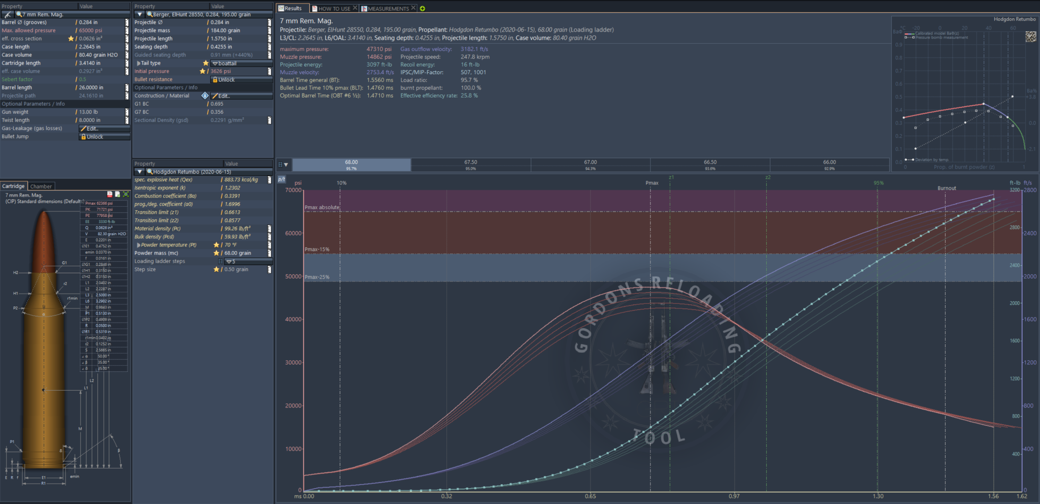

I did run it through GRT (Gordons Reloading Tool), and it gave me this:

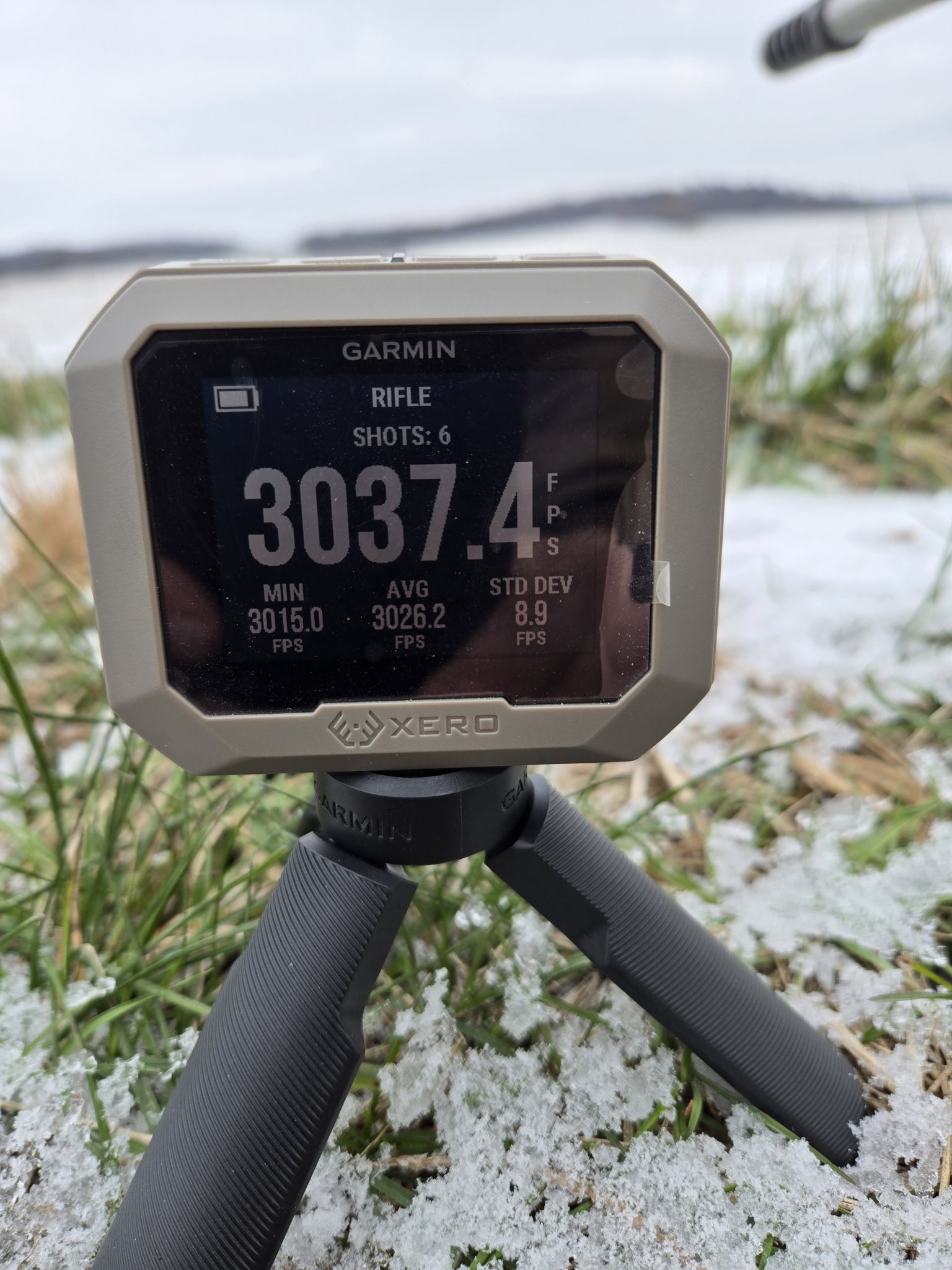

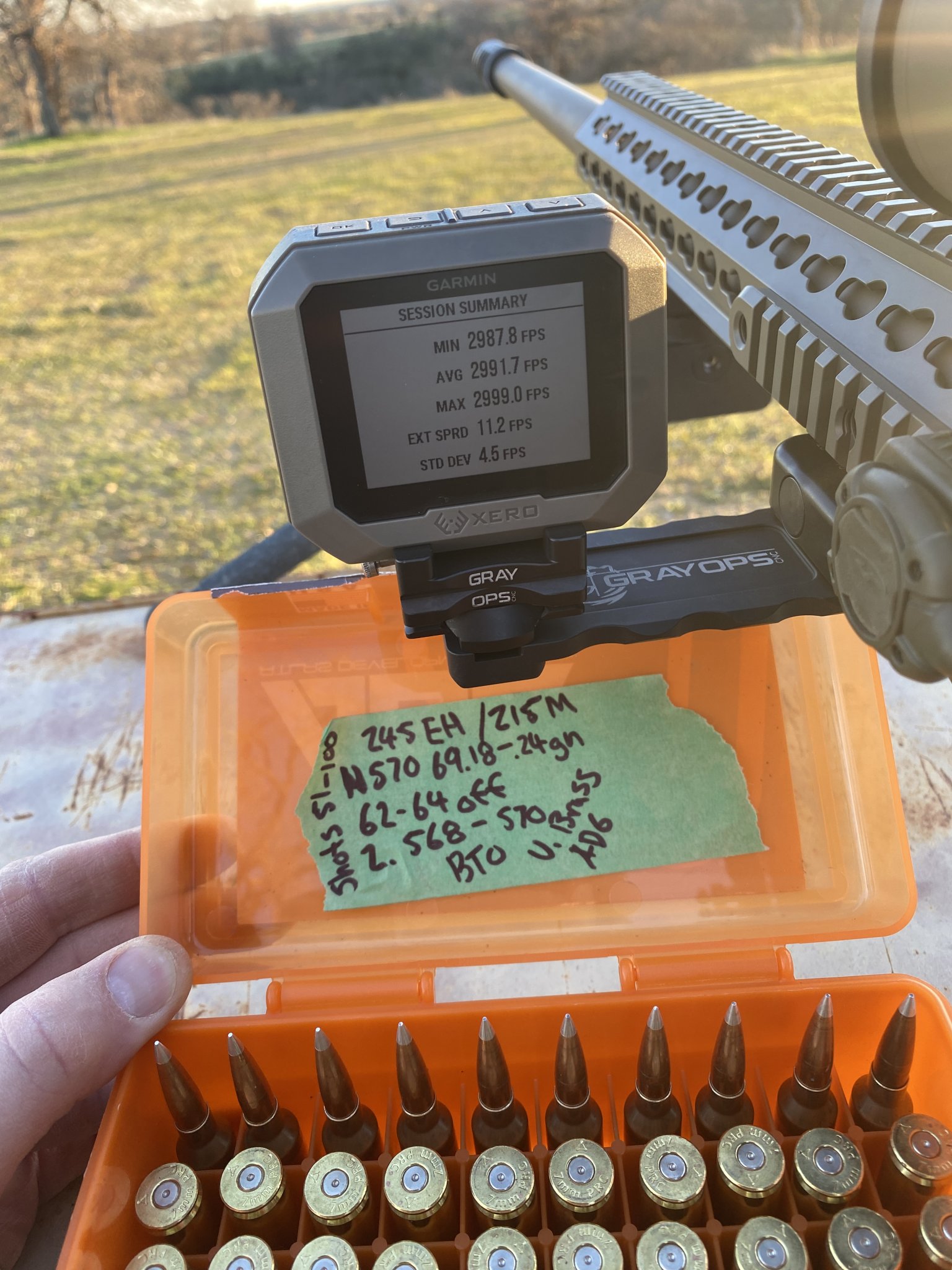

22” Carbon Six. 80-85 degrees outside. 900 ft altitude.
Peterson, GM215M, Berger 175 EH, N570
5 shot group - 73.7gr - 3107 avg , 6.5 SD, 18.4 ES
For comparison, I got 2871 fps avg from factory Hornady ELD-X on the same day.
For some reason the published VV load data is waaaay conservative in this caliber.
Reactions: hseII and Bevo
Berger's load data states a max of 75.1 gr of N570 using Hornady brass.
That’s wild. VV load data says max 66.5 and that’s its compressed at that charge which clearly isn’t. Those are almost 7Saum numbers.
QL also shows their max load at barely 50K psi.
Not sure how VV came to their loads and I wonder if someone used a different case capacity.

Those are are x3 shot groups I shot only once, and after retesting them they did not repeat, nor have acceptable ES & SD. You can't assume these are loads based off of these groups / small sample sizes.
Also as to your statement about not saving components, using Quickload / GRT would definitely help anyone save components if you understand, and know how to use it. My statement about "savings components" was directed towards this, not about switching powders.
Reactions: 6brshooter and lash
So, what was different in your reloading between first and 2nd rd of testing? Or are we gonna chalk it up to barrel? On 2nd rd, did you do more than 3 rd groups/velocity strings?
You kind of conflated those. Initial load work showed promise, even bragged on best group youd ever shot. Wandered about retumbo and QL prediction and opined about saving components. Sorry you weren't clear about that. If you would have said "computer predictions can be useful if you don't know where to start," I'd have agreed with you. It just sounded weird with your initial load work and best group ever comment.
