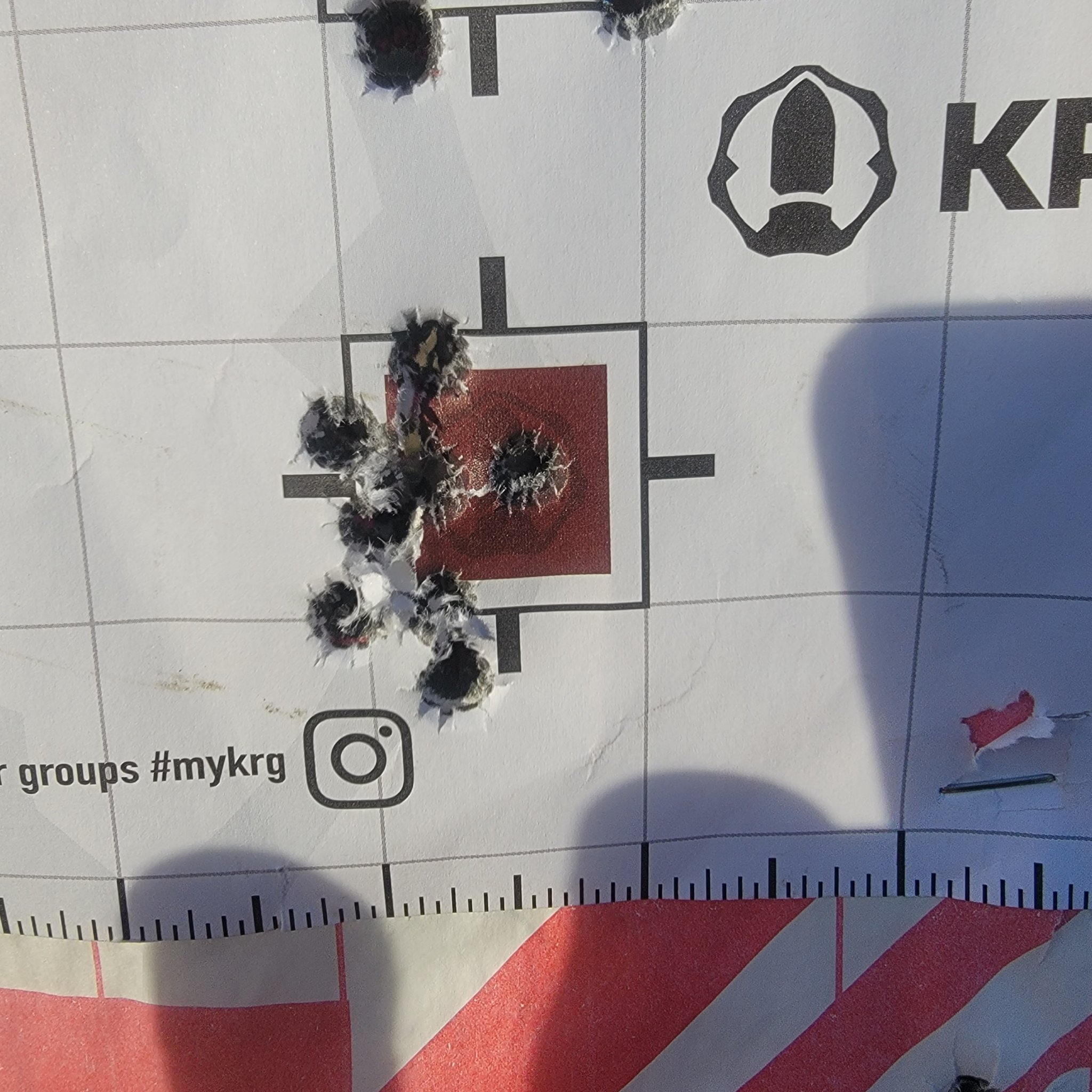

First shots in the new 7 prc factory ammo 180 eldm. Avg speed was 2957 26 inch barrel. That group was 14 plus shots suppressed and a few with the brake. Pretty happy with the PVA prefit so far. Put 40 rounds down barrel today going to play with some handloads with n565 and 190 berger. I did resize some and primer a few wasn't to thrilled how the primer felt already. At the .200 line measured these are just the last numbers number 31 to 315 fired and sized 305 worried it might not be enough but we will see

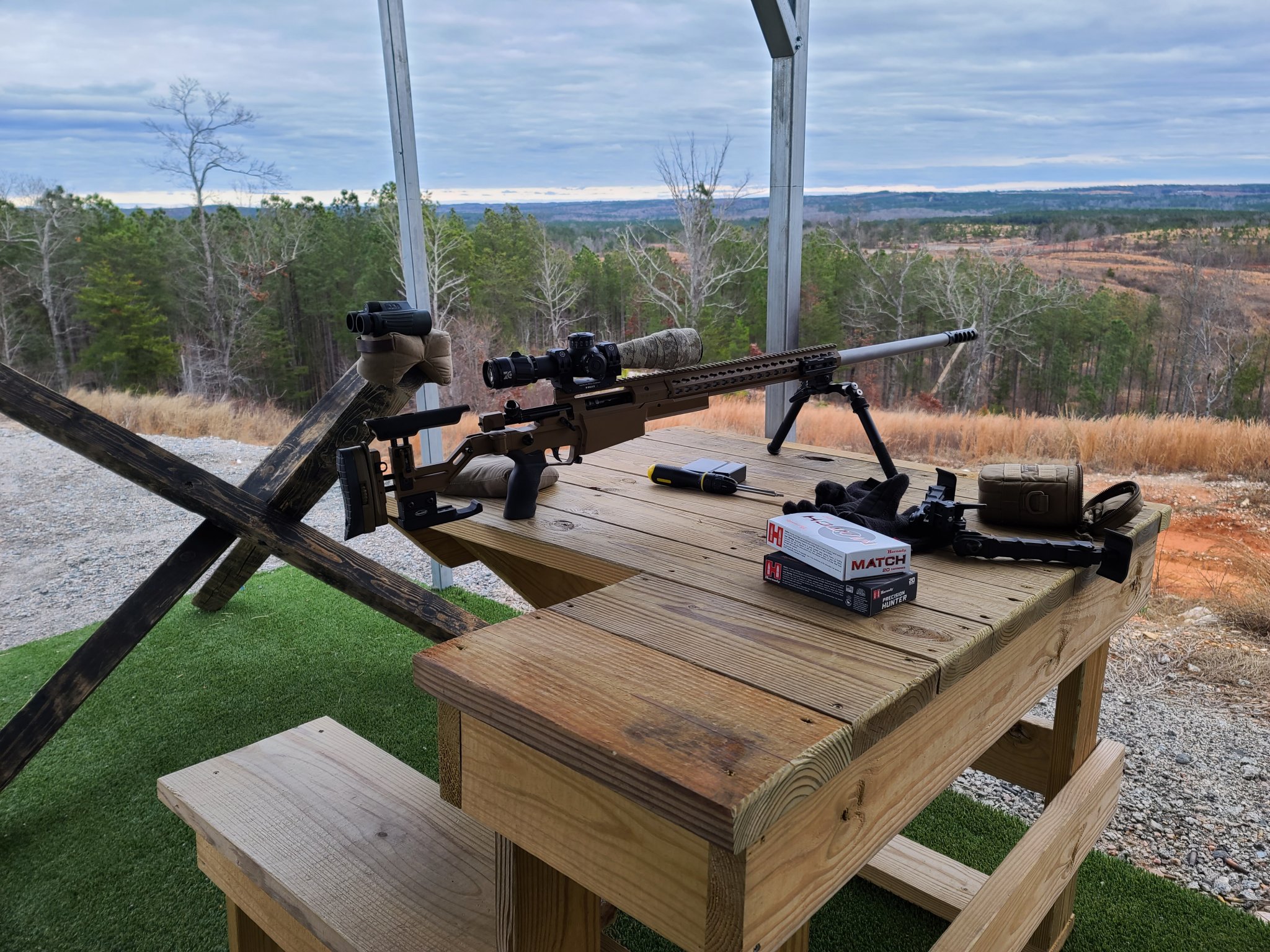

Finally got out with the prc today, super happy with it even with factory ammo.
Didn't shoot for groups, did 10 rounds to get a zero and velocity. The 180 ELD Match averaged out at 3030fps over the 10 rounds. SD and ES were acceptable, nothing to write home about, labradar is still in the truck so don't have exact numbers. Seems like ES was 20 ish and SD was low teens.
Off to the 1-mile range, hits to 1000 were child's play. It was quite windy, 10-15, switchy for about half the session but then luckily settled at about 150-170.
Not going to lie, I knocked the snot out of the 1 mile target. I didn't keep count, but I'd estimate I put over 80% on target, even with the switchy winds. It's a 2 moa target so not super challenging, but still was very happy with the first outing and factory ammo.
Recoil was tame with an APA Fat Bastard.

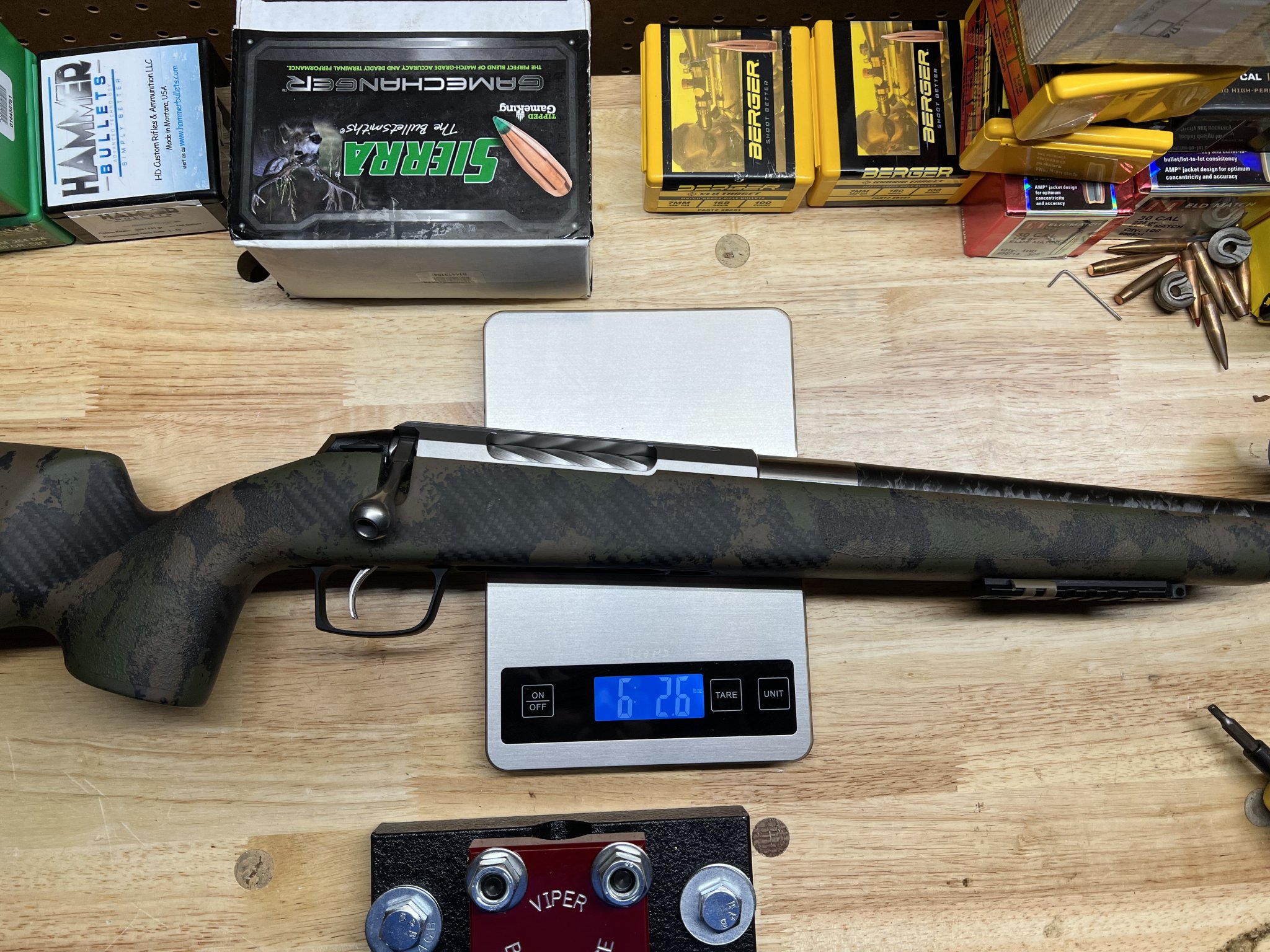

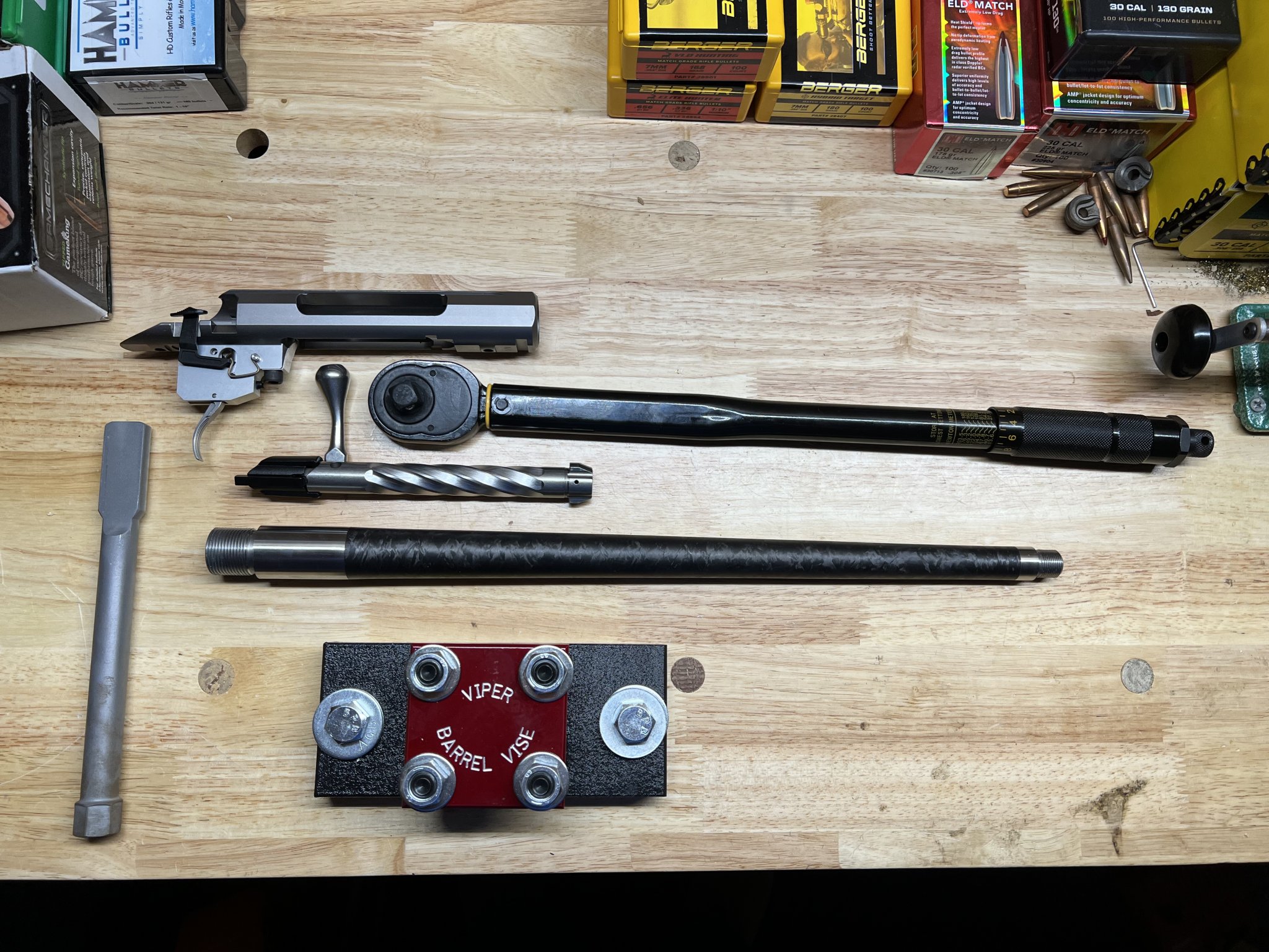

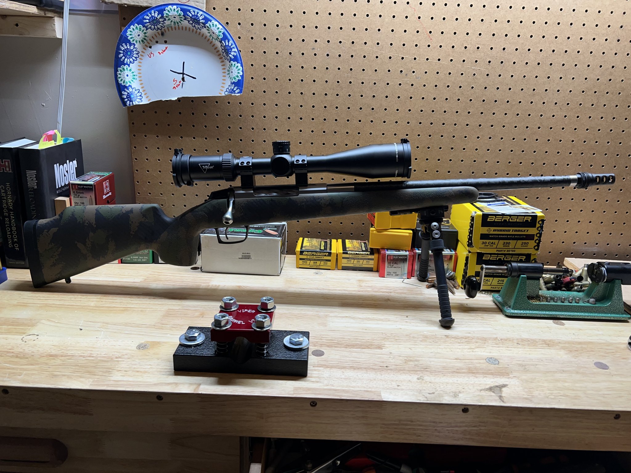

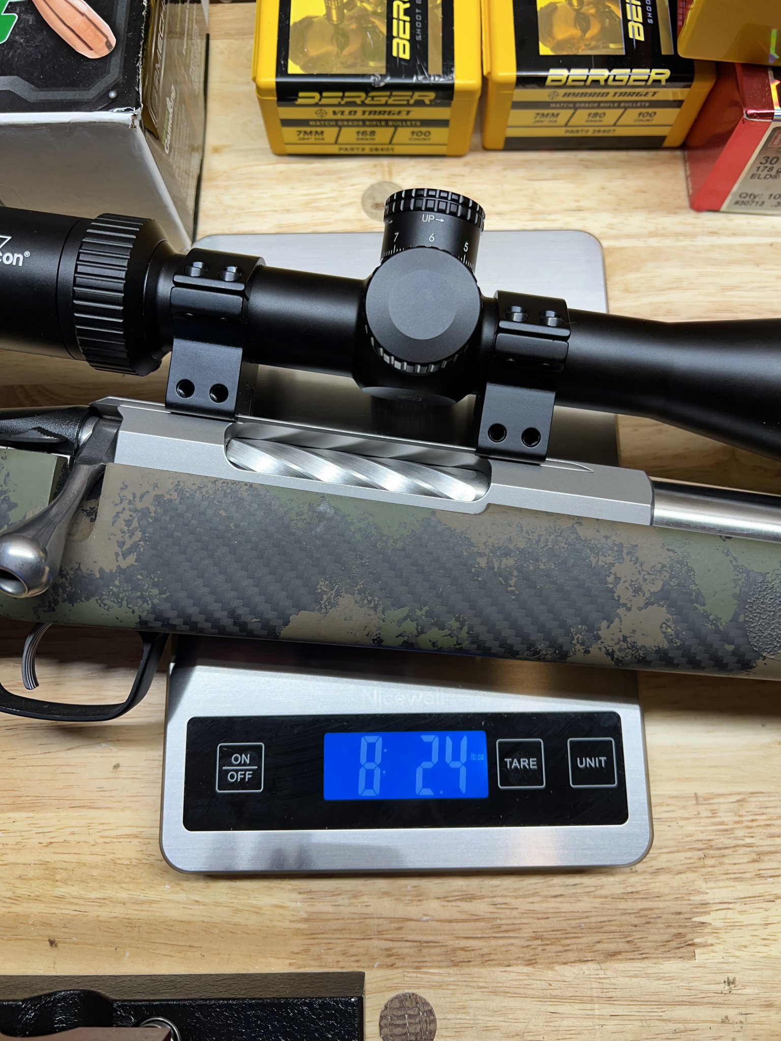

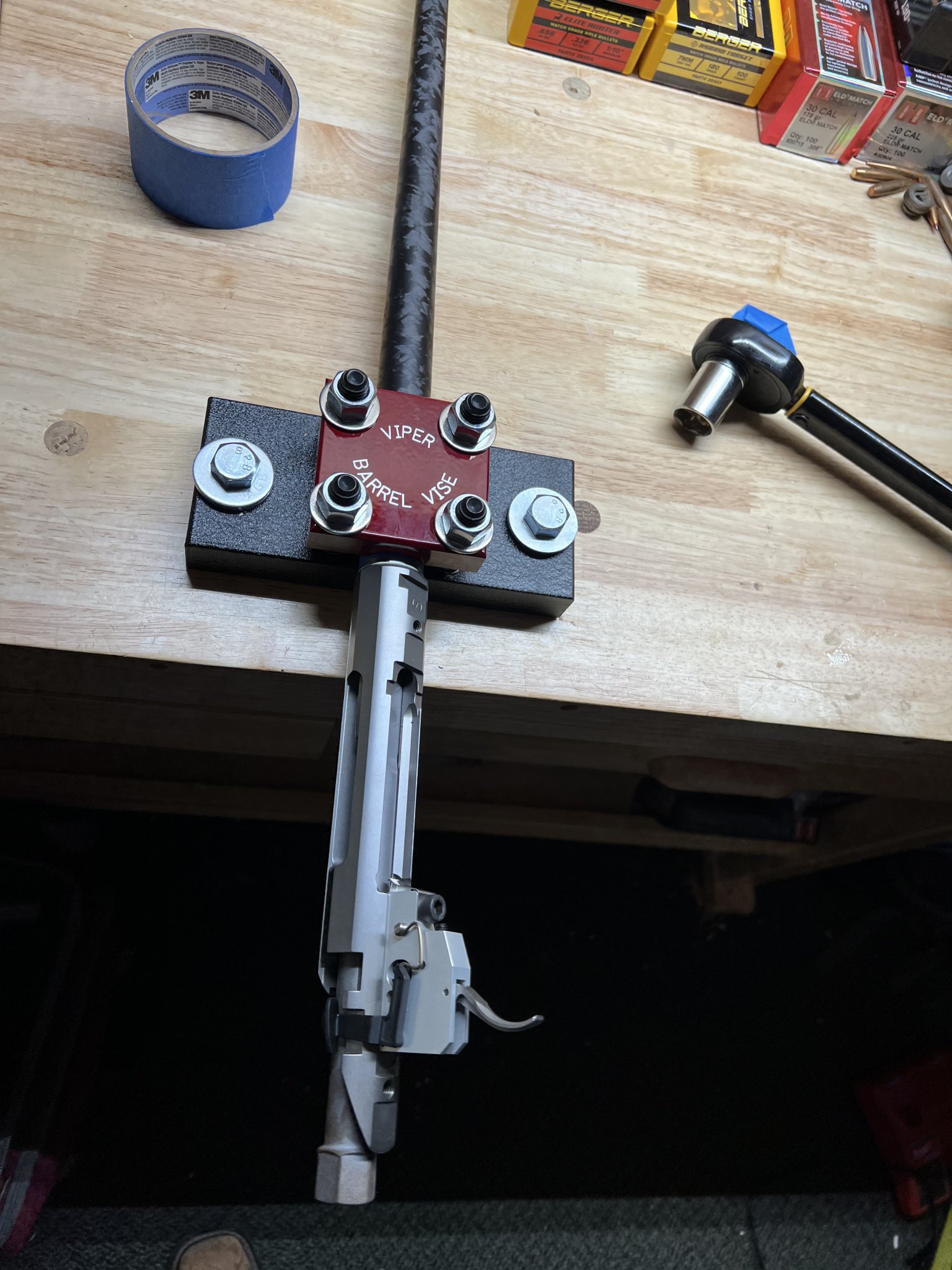

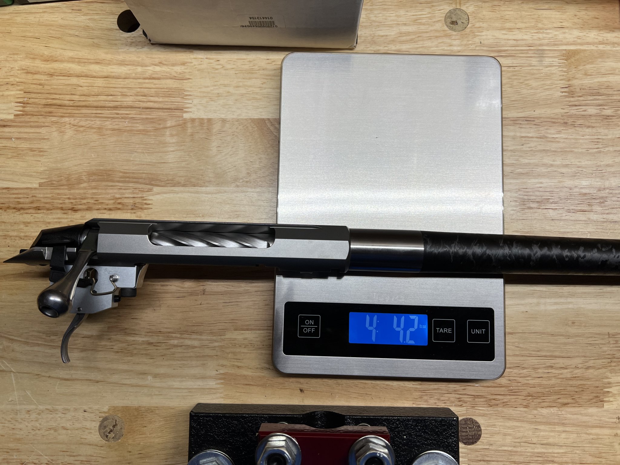

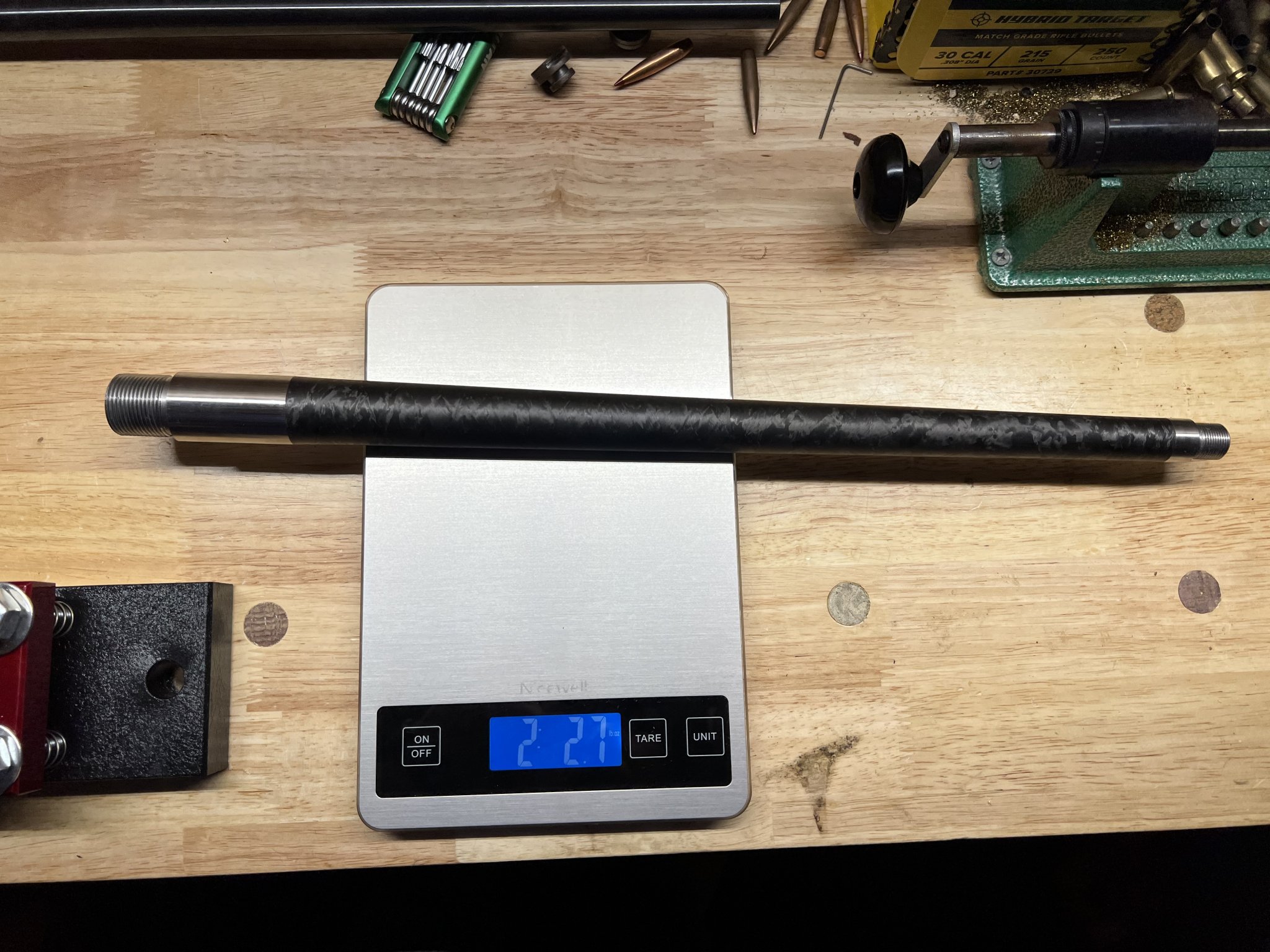

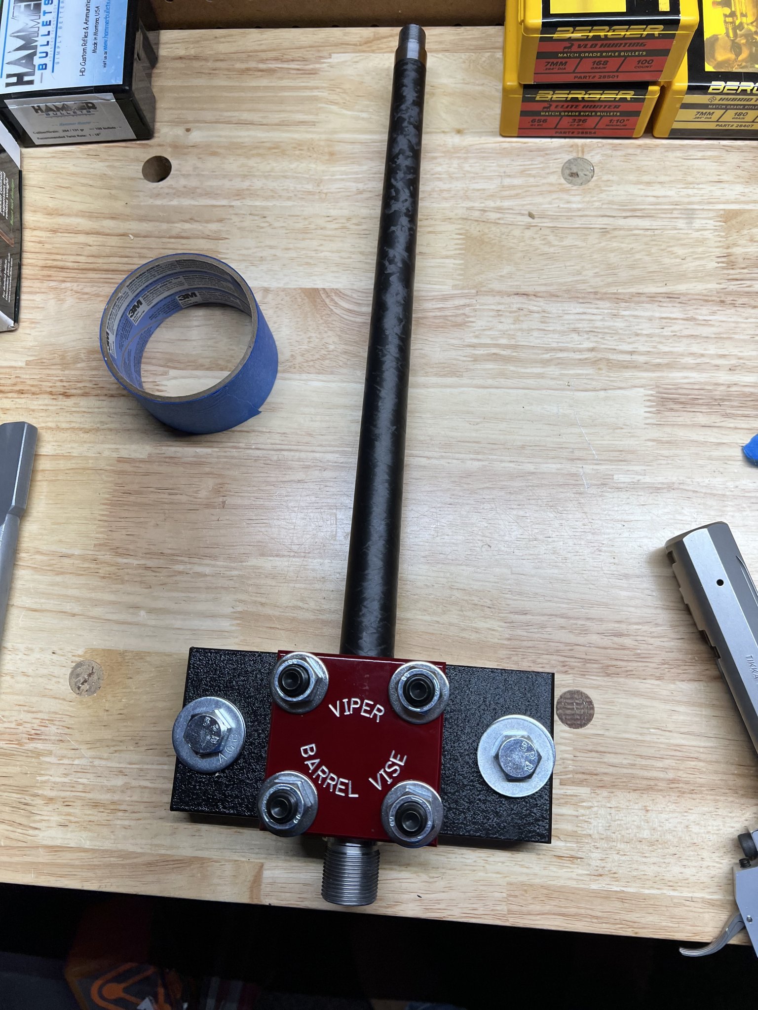

Barrel came in today. Ready to see what it’s all about. 18” Carbonsix.

Looking forward to your velocity. My barrels are in transit to get deep fluted and cut/threaded to length. My original plan was an 18" and 20" but I'm half tempted to cut one of them 16.5" and the other 18". My barrels are obviously steel and the contour is 1.200" full length straight. Getting Murder Hornet type fluting.
That will end up looking great. I’ll definitely post up velocities and groups when I get some time squared away to shoot it.

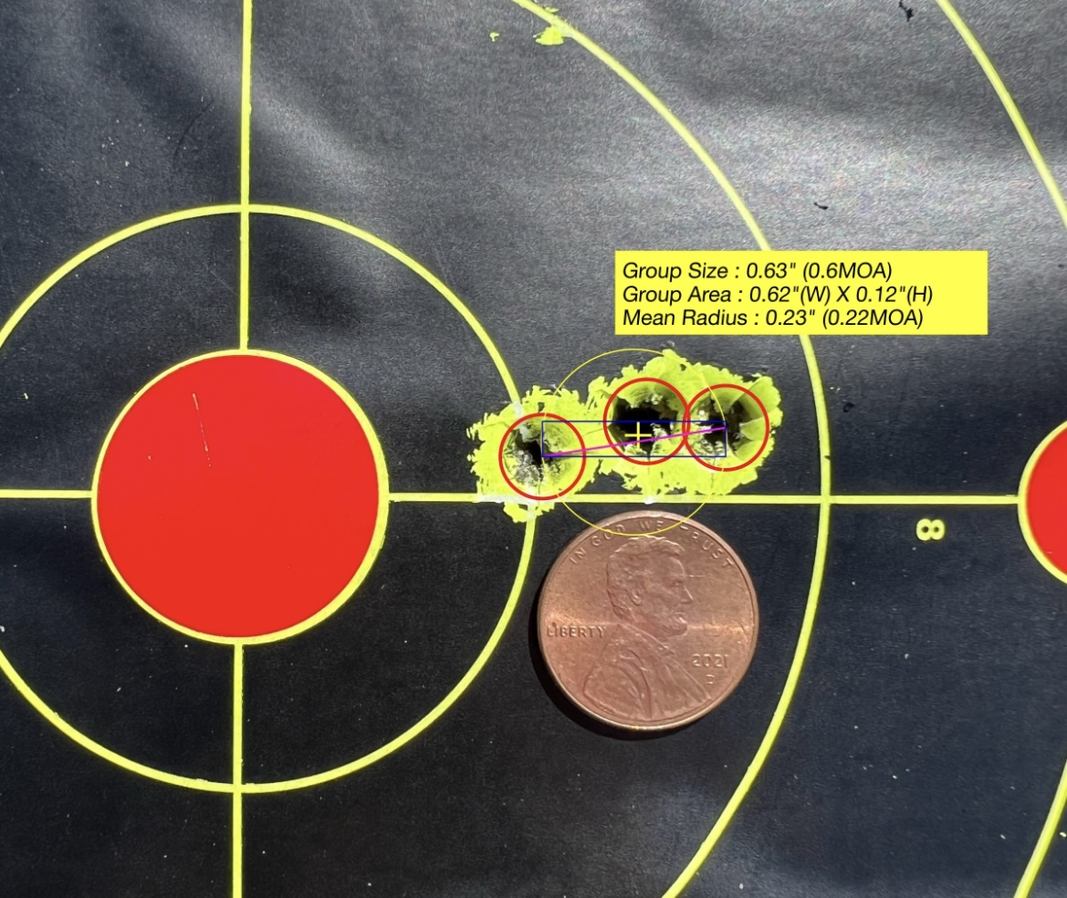

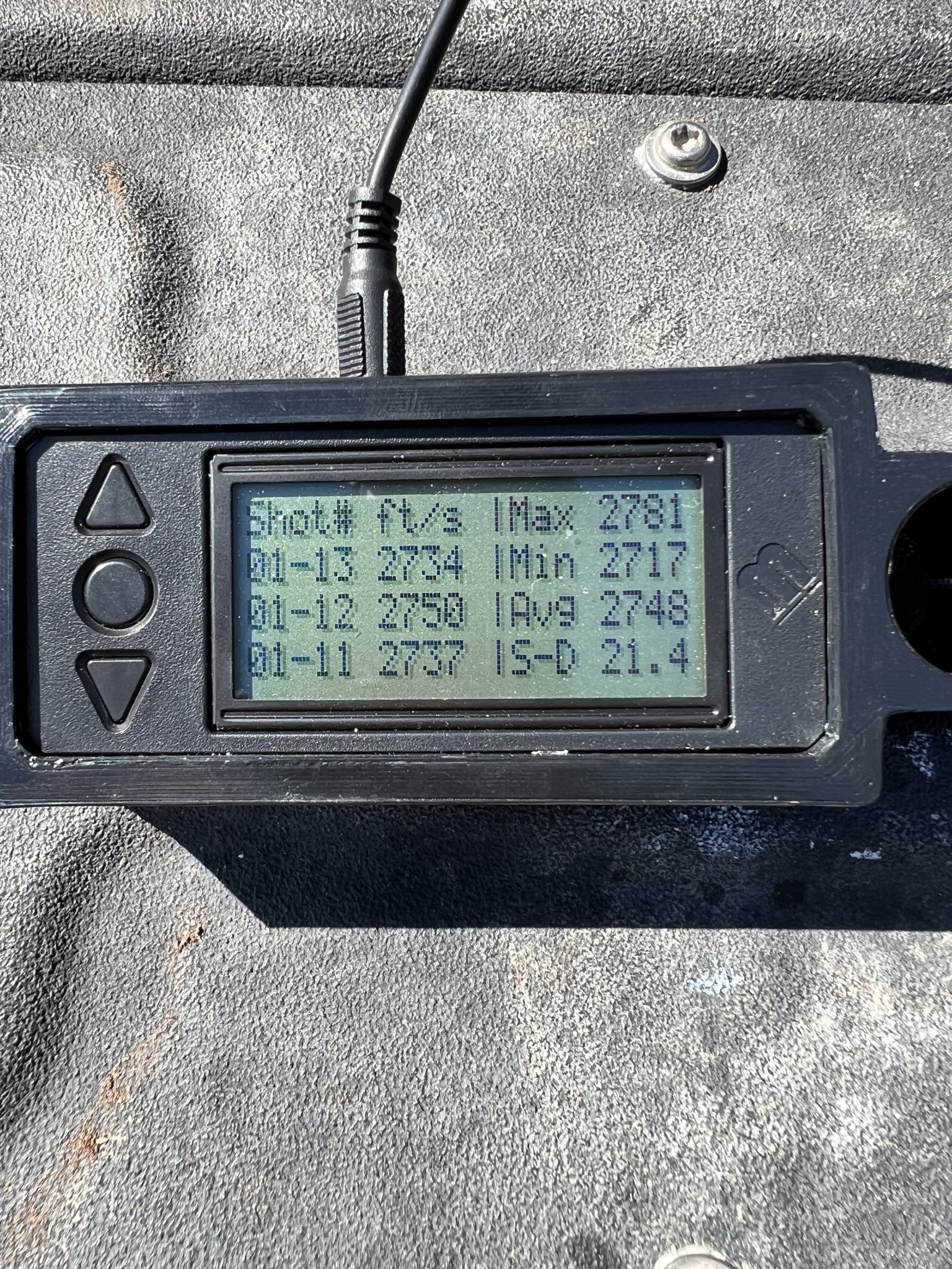

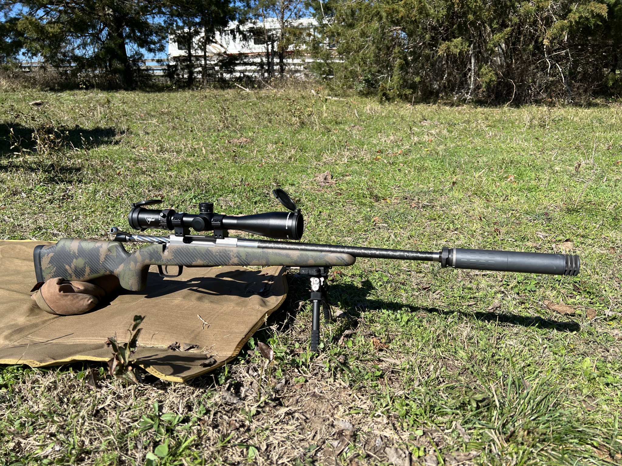

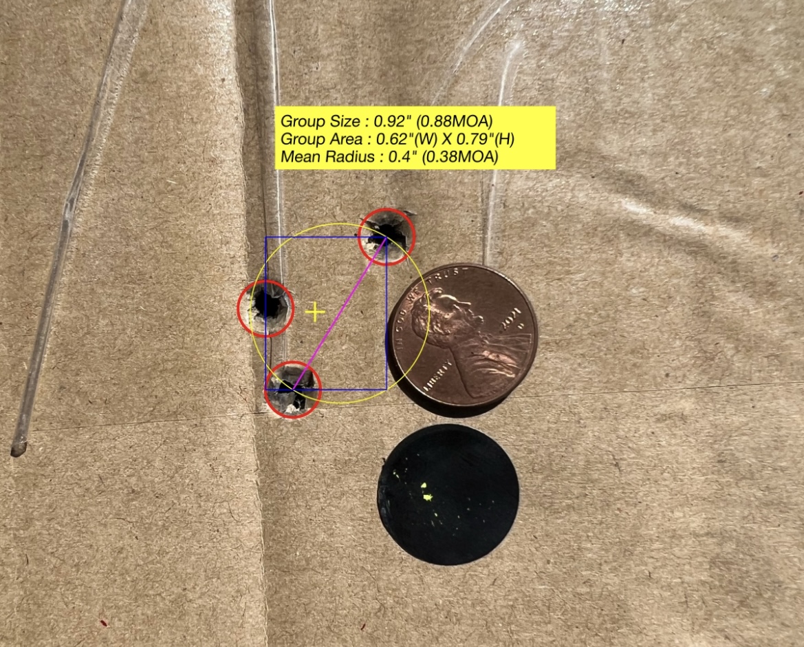

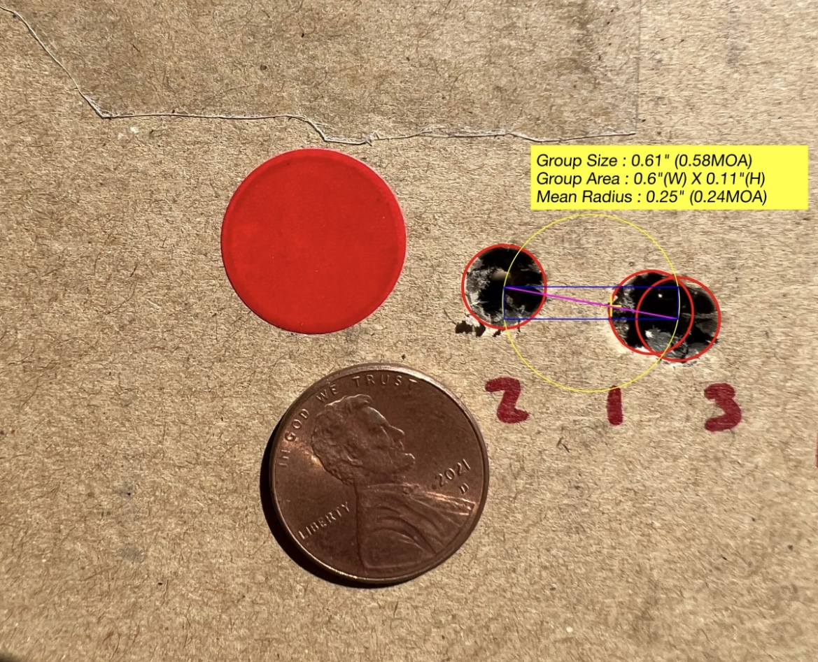

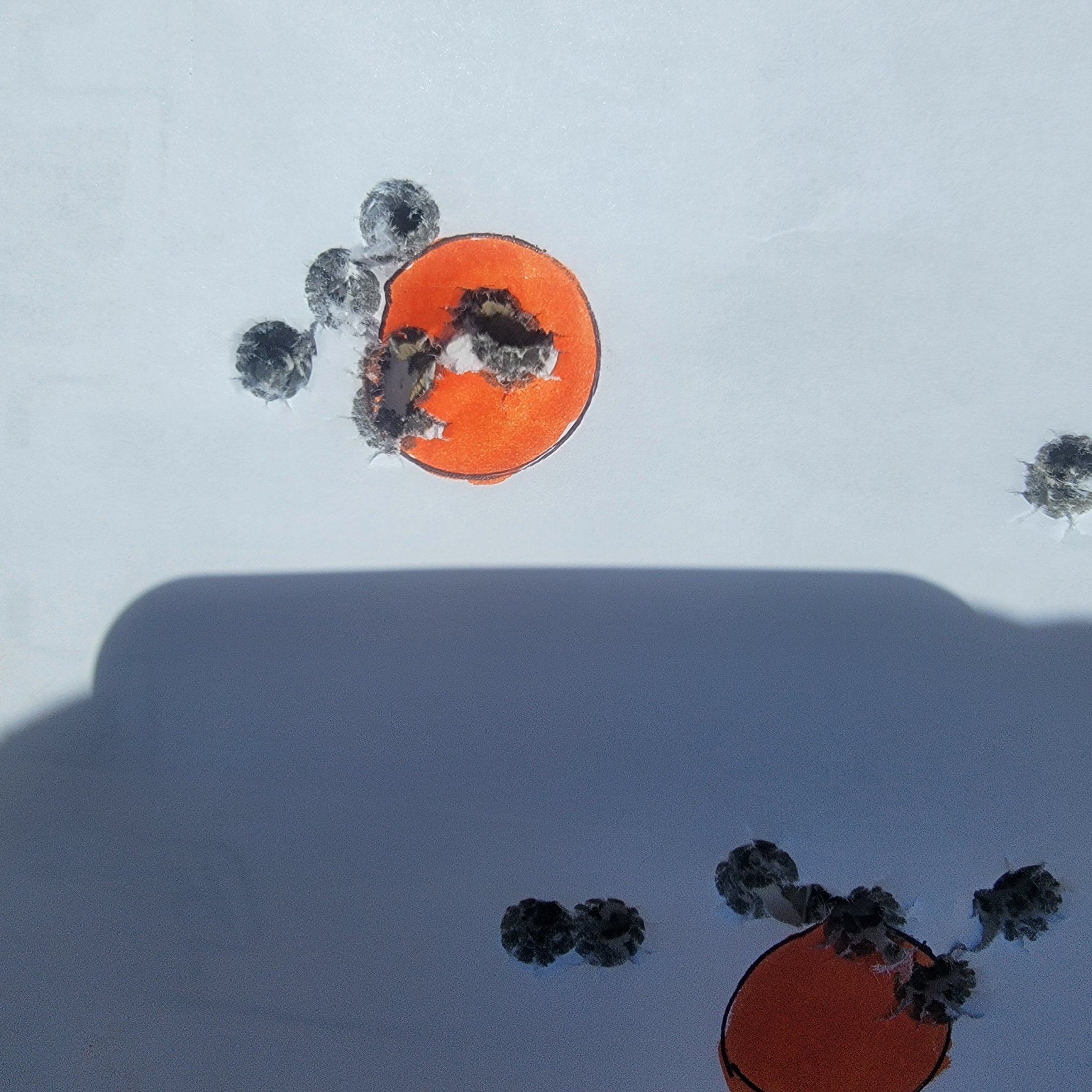

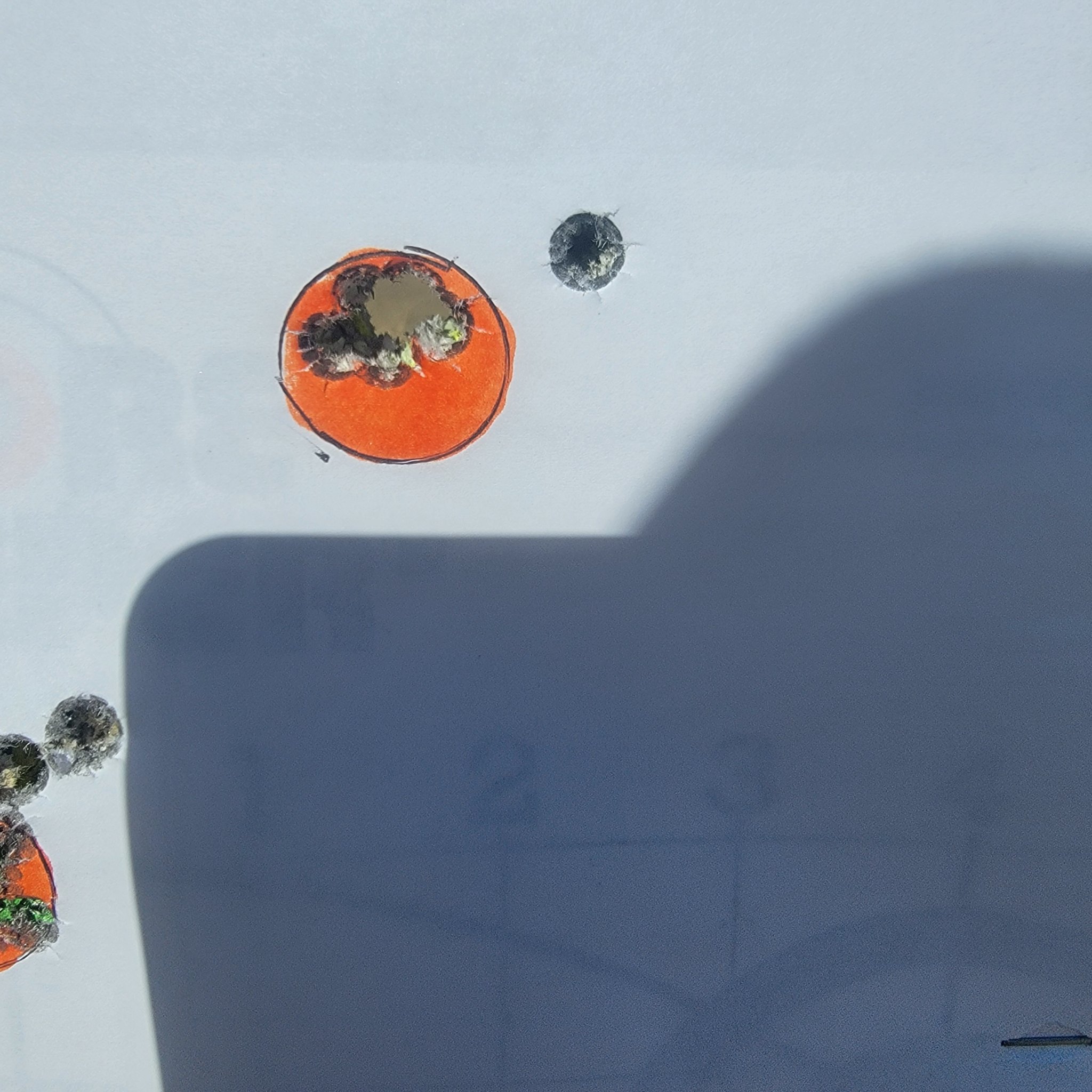

Made it to the range today. 50 degrees out, 10mph wind. Magnetospeed was having issues but managed to record 13 shots. Average velocity with the 18” barrel was 2748 with factory 175 ELDX Precision Hunter, which is about where I expected to be. I did notice stiff bolt lift on some of the shots. Groups were great and I suspect with some handloads this rifle will be a great shooter. Recoil wasn’t bad either. Overall very happy with the rifle.

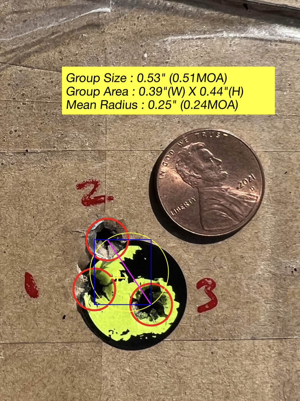

Shots 1,2,3 out of the barrel

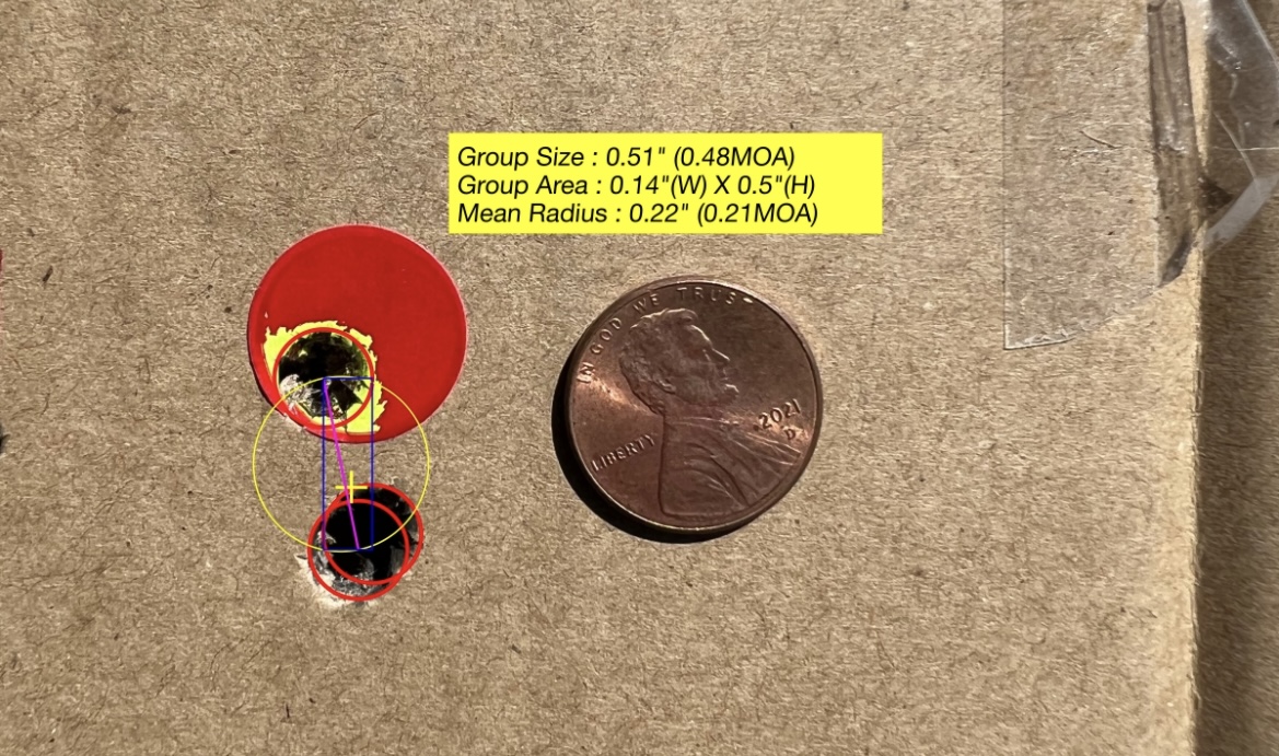

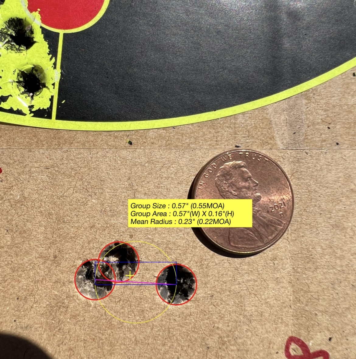

Some additional groups from today

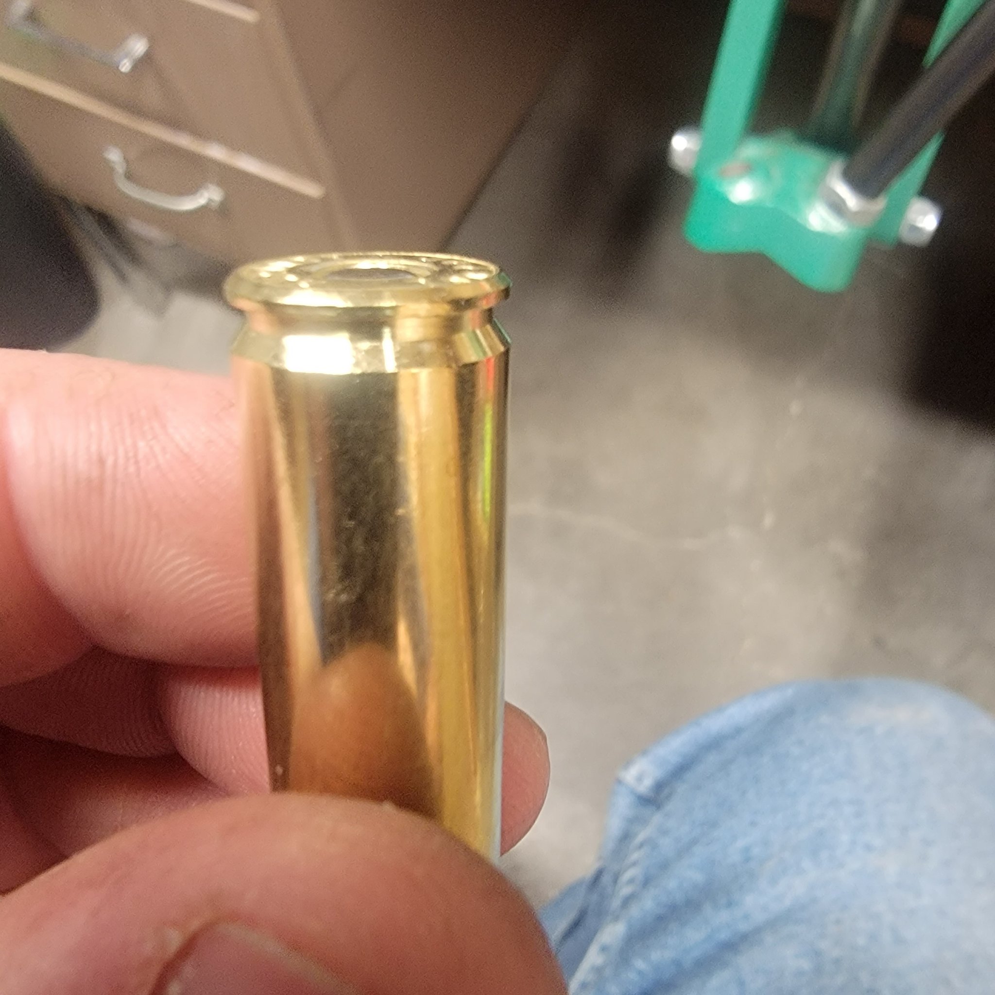

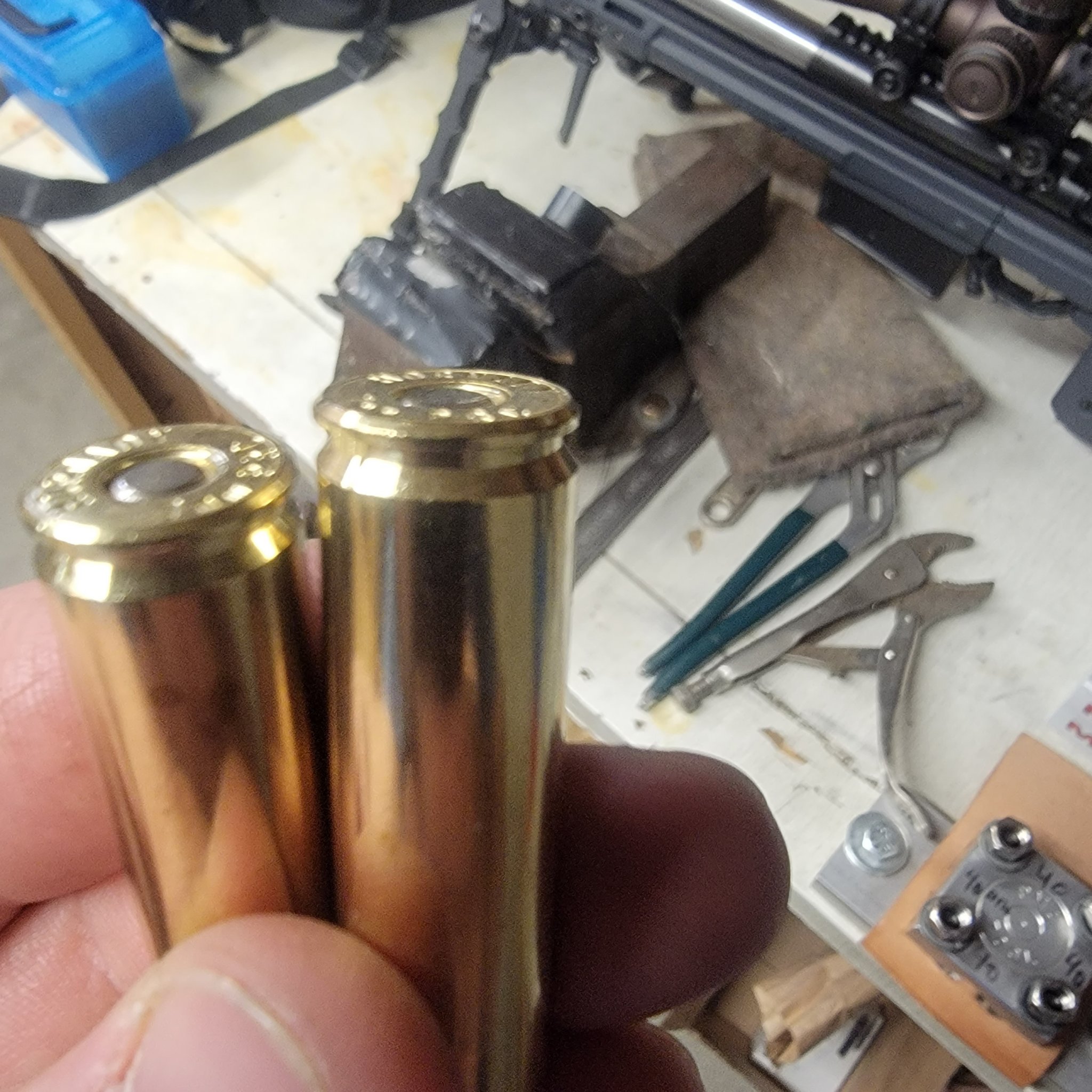

I contacted hornady they wanted me to send them in but after calling them back I decided not to waste my time because he said we will see of they chamber fine and fire with no issues if so then not effecting anything. Other guys sent some in waiting to hear what they get told
Nice. Hope they don't blow up on me.
