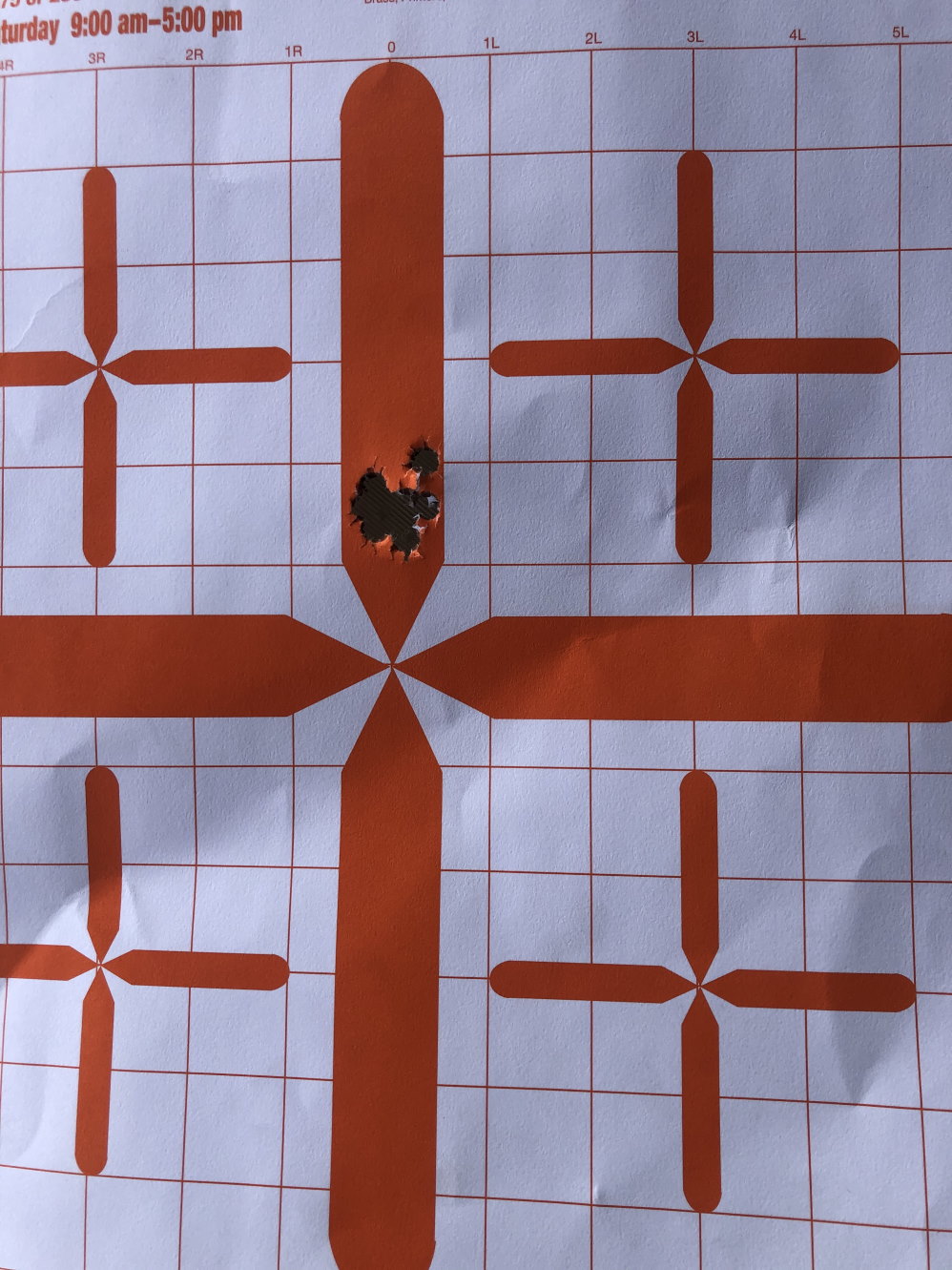

Just came back from the range.
Wow was an easy caliber to load for. So glad I went with it rather than straight 7mm-08
I did varget for PVA151, Lapua 150, 162 ELD-M and RL17 for 162 ELD-M. All loaded with Alpha SRP brass. Still waiting for my Manners LRH so I put the barreled action in the ARC Xylo which is a great chassis to shoot tiny groups.
I had to use my 7mm-08 seating die since I'm still waiting for my Redding kit.
I loaded the PVA 151 at 2.875 to make them fit the Hawkins 4rnd hunter flush magazine. Best was 1/2 moa at 42.5 ES 12 2815 FPS AVG. I will retest this load this week before I ship the barrel for cerakote.
Scenar 150 I did a varget ladder from 42.0 to 43 and it was pretty bad at 42->42.5 but started grouping at 43.0. So I might do another 42.8->43.5 ladder. They were also seated at 2.875 but I'll load them longer when I get the dies but it does seems like it wanted to tighten up at the end of the ladder.
Best ones of the day were the 162 ELD-M. Ran a ladder 41.5-> 43.0. Accuracy node was at 42.5 which gave 2760 FPS with a ES of 11. Pretty forgiving node as I was shooting 42.3-> 42.8 + a 5 shot group that were all 42.5 and they all had the same poi. That gave me a 2/3moa 10 shot group. Can't really complain out of a 22 3/4in 3B sporter barrel with a bipod and rear bag.
RL17 gave awesome speed and low pressure. It's not temp stable like varget and the POI is way off from the varget loads but could be a good backup if I run out of varget. 46.5 was the flat node and also did +/- 1/2 in group but gave 2820 fps, an extra 60 fps over the varget at about the same pressure.
42.9 started to get sticky bolt for varget and 47.0 for RL17 also getting there. 47gr gave me 2875 fps (!!!) which is crazy out of a short barrel like that, that's straight AI territory but obviously it's not something I would shoot in 100deg weather.

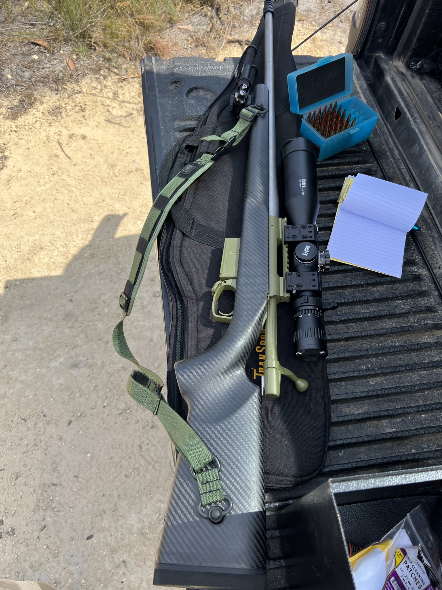

A mate and I recently had a 7mm SAW built each here in Australia, mine is on a Howa/Vanguard action his is on a Tikka with a switch lug both with the long throat, my rifle has a custom bottom metal to take the no binderplate mags
We are shooting 162 ELDM’s and I have tried 165 Sierra Game Changers
My velocities are a bit down on the advised load data from WTO by about 75fps but my barrel is still pretty fresh might speed up a bit yet, my accuracy is a little off what I was hoping, going to try another seating depth test, getting SD around 8 with 46.6gr of ADI 2209 getting an average of 0.5-0.4 MOA, Adam’s rifle seems to be shooting a bit better he has velocities that are closer to the advertised load data and his groups are a bit tighter
I am using a 0.308” neck bushing, and then running a undersize neck mandrel to set neck tension at 0.004”, I was using the 0.311” neck bushing and found the neck tension was to light and the compressed load was causing dramas with maintaining a consistent COAL
I would like to try out the Atip bullet as well

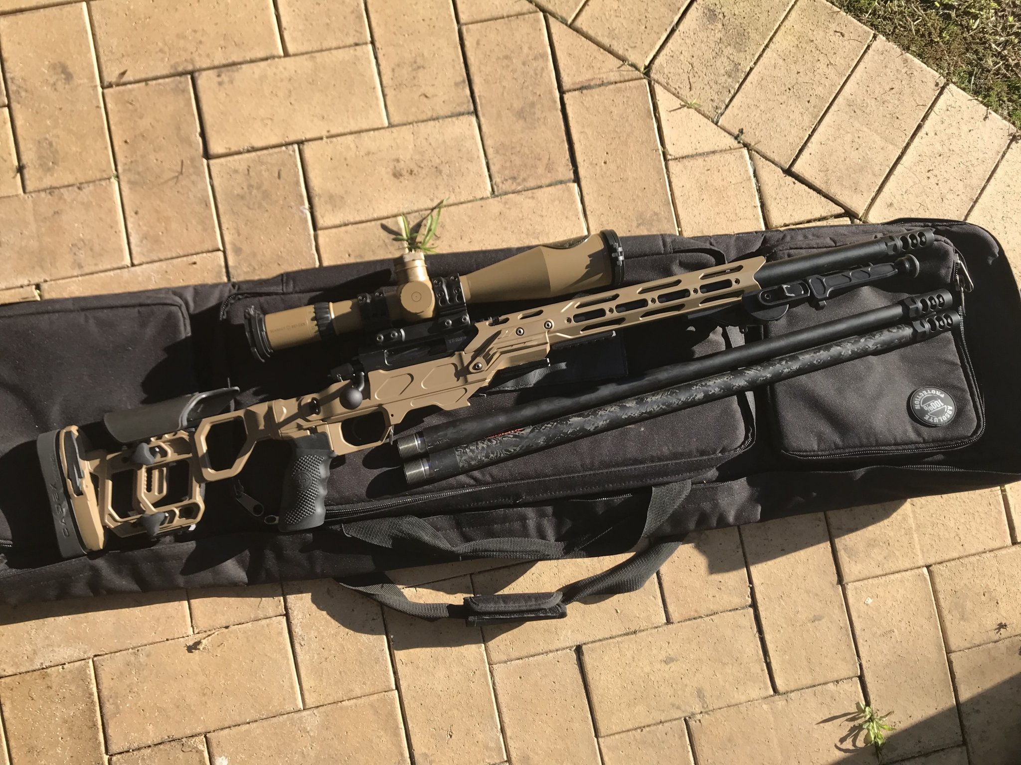

Rob is a good bloke. He is also bloody reliable. I had my switchlug installed by Jeff Borg on my tempest. @beetroot, a mate just had a switchlug installed on his LA tikka by Jeff as well, they're obtainable. @Hill Top try some RL16 I'm getting good velocities with it. This is the tempest with switchlug and 2x 7mmSAW barrels (and a clapper 6.5CM)
Jeff built our rifles as well
Both him and Rob are great fellas, they have done a few rifles for me now.
Fun cartridge to load and shoot, I had it built to give my big rifles a break, so I can shoot some volume with a bit of economy

I am using the Alpha small primer brass, with 46.6gr of ADI Ar2209 (your H4530) I am getting 2840 fps with a 26” barrel, that load had the smallest SD of 8, I can’t hit the advertised 2900 with out obvious pressure signs
My mates Tikka is getting there though, same reamer, same builder same length barrels, same load, my barrel must be a slow barrel
