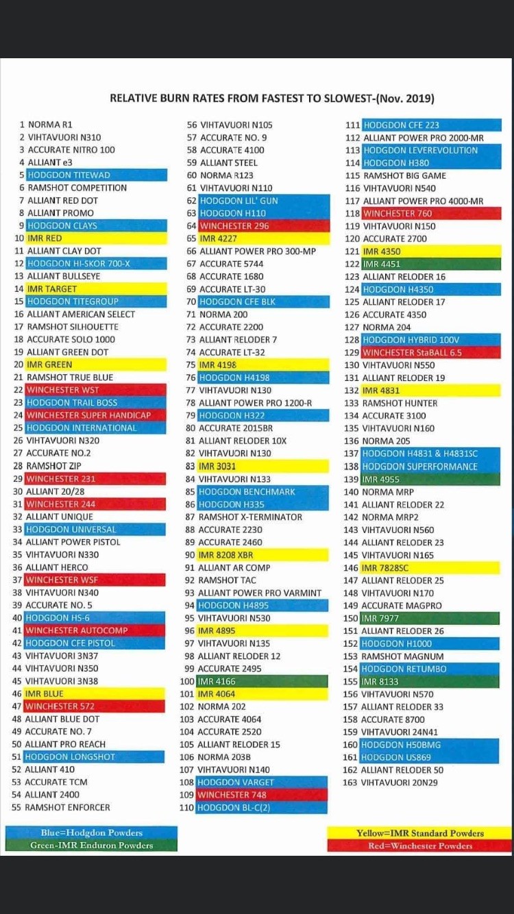

There's a few options to try between varget and RL16.

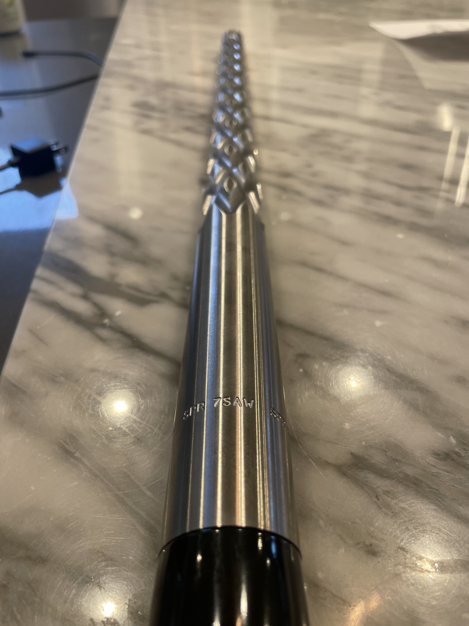

Finally got my Bartlein in. 24” fluted from Greg at Southern Precision. I now have a type 2 reamer if anyone needs to borrow one to send work their way.
