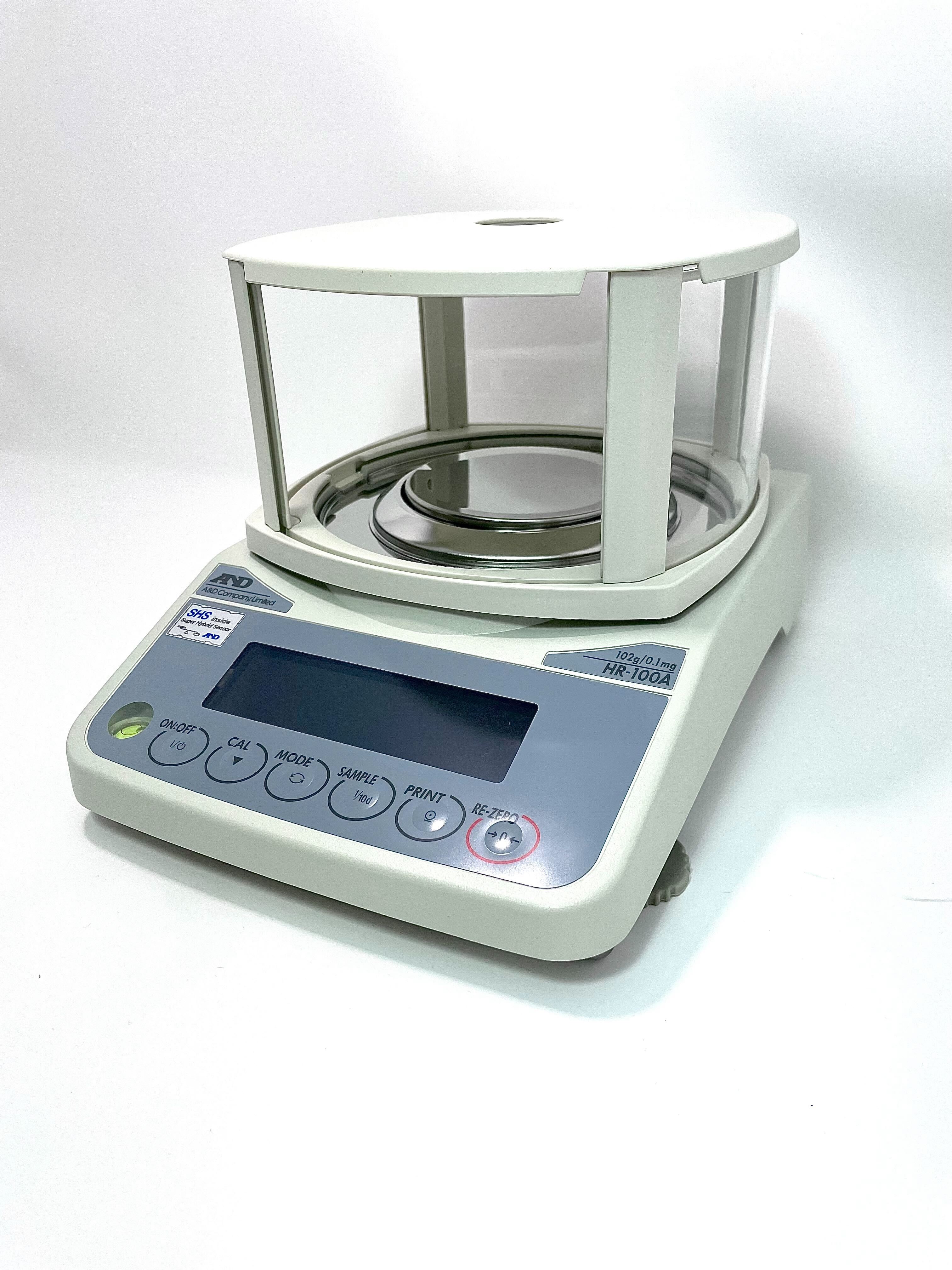

A&D HR-100A- Anyone using or know anything about this scale

    and how well it might work for a V3/V4 set up? It's pretty pricey but it would be nowhere near the cost of a Promethiues. Not sure if it would be as consistent but with my amature understanding , it appears that it would be pretty good.
    It also looks like it's a plug and play with the V3/V4 too, just like the 120.
    I know we have some guys on here that really know a lot about these scales and their potential for consistency amd/or their potential issues, so I was hoping one or more would give us all a little run down of how well this scale might perform. Anyone else is welcome to add to the discussion as well.

    "Compact Super Hybrid Sensor (C-SHS) for fast 2-second stabilization." Not sure how this sensor would work with loading and all or what it might be susceptible to ect.... I was hoping someone here could enlighten us on that part
    What do you think the benefit is of that level of resolution to your handloads?
    Mainly to limit the drift issues. My thinking was if you reduce the resolution, you reduce the amount of drift and thus have more accurate charges. .02 is one thing, and not impactful , but when you start getting into .06 and .08 it gets more effected. The brass prep and bullet itself is likely a bigger factor but getting into the brass turning and all is a lot of crap I don't want to do if I could just buy a scale that would take one of those little variations out of the equation. I was also just curious and read about the wind screens being done differently to work with the AT, which lead me to looking into that scale. I figured if it was great and wonderful, someone here was already using it.
    I heard back from Adam, who said that scale is too slow, and basically said the fx120 is plenty for long range shooting. I'm sure he's extremely well versed in the scales and how they work ect.
