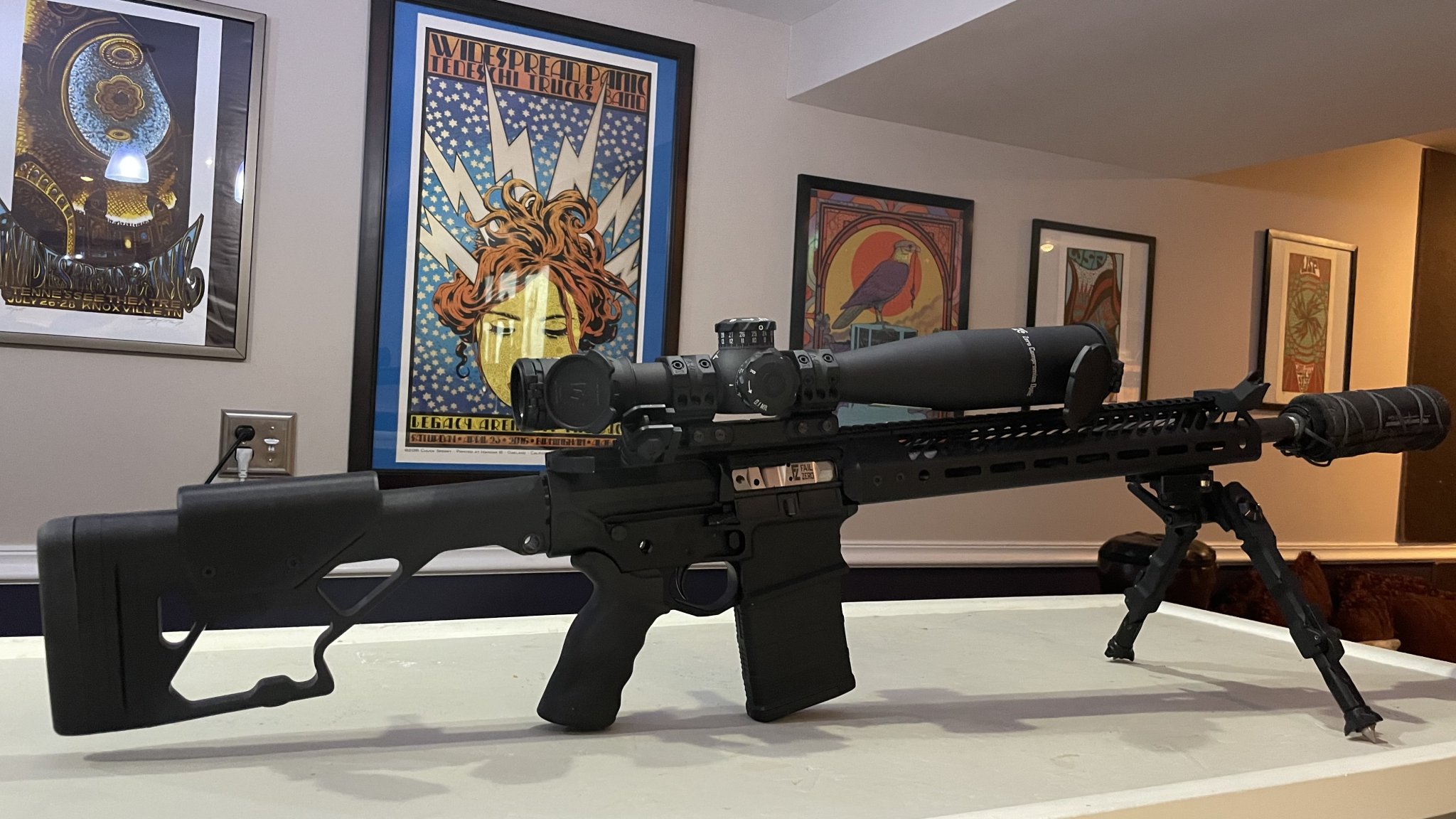

Find a used one and you may be ok with a 16” barrel but it’d be cutting it close if you’re gonna attach a suppressor otherwise probably ok. If you get a proof talk to 360 Precision on here. Get a JP high pressure bolt because they’re headspaced for Proof barrels. I used Seekins XRay stock so not sure about the buffer tube. This is an 18” barrel fyi.

That's a sweet rifle you've got there! I've no intention of running a can on it, for now anyway, so it looks like a 16" would fit. Gotta get ahold of one first, though, otherwise it's all academic.
That’s nice man. What size scope mount did you use for that?? Looks perfect
