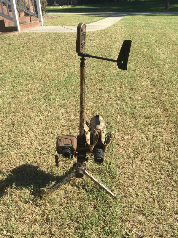

Close. The kestrel link app displays but the actual holds come from the kestrel. Here is my setup and how I use my kestrel. As you can see I use my iPad or my iPhone to display what is showing on the kestrel.
That’s a nice collection of gear, Tac.
Its overkill. I like toys. But my duaghter helps me spot and call the ranges so it helps that way.

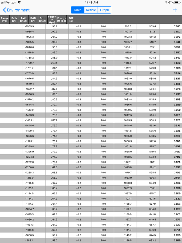

I have been using this BC for over a year now but once I installed the latest update the text size is about 1/2 of what it was and now the RANGE column is overlapped onto the TOF making is illegible, screenshot is attached and not sure how to get this resolved?
The iPad issue is a known issue we are looking in to. It is in the development notes for the next round of updates.
