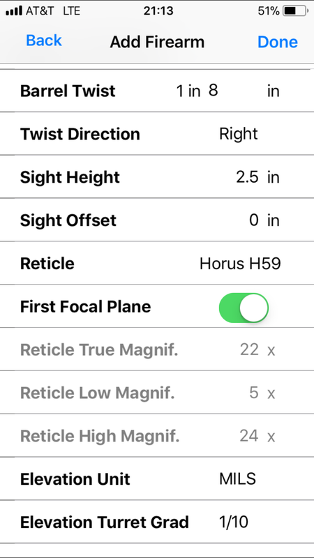

What the heck is going on with AB??/ I switched to an I-Phone 10 and of course lost all my data because it will not transfer. I re-entered all the data and the program is way off on elevation and windage. I have checked everything 5 times and it is way off....not just a little. It's showing 8.5MOA at 430 yards for my 6.5 creedmore with a 140 ELD-M as an example. I don't what is going on but I am about over this. My bullet Flight program is spot on and transfered data. Yes....I am pissed.
Usually when someone has this problem they messed up the barrel twist input.
Nope...same barrel twist as before. There is a major issue with AB and I even reloaded the App to make sure there was nothing skewed. All 11 rifles are way off in the trajectory as compared to other Apps. I will send them my dam phone if they don't believe it's an issue.
Your twist input looks like this right? I have no skin in the game, my AB is working fine but there was another guy with a similar issue and he had the twist entered as 1:1.8 instead of how I have it here. He fixed it and it worked after that. Just throwing up suggestions.
