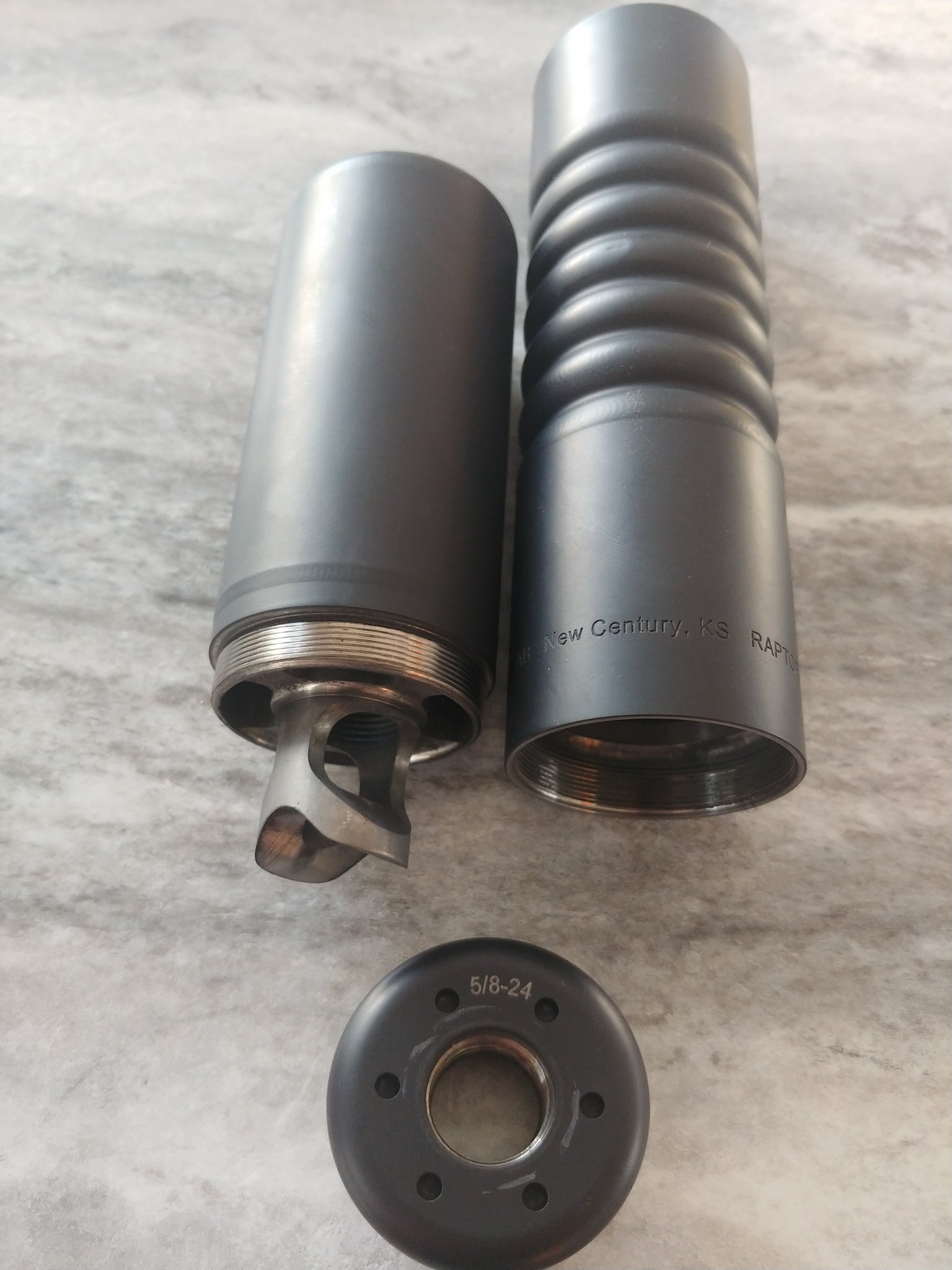

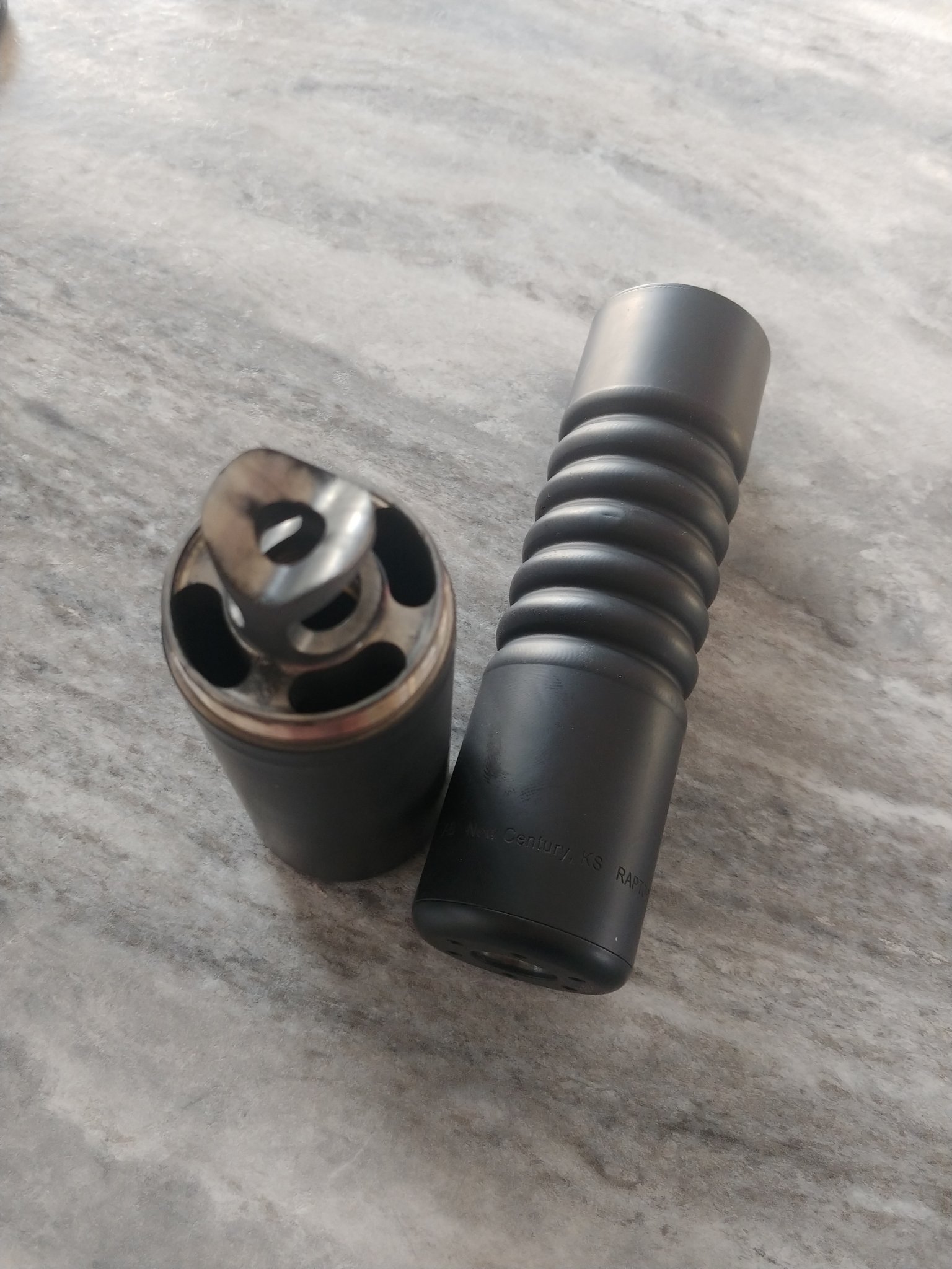

    I'll add some pics of the can itself here in a bit. It can be used as just the baffle stack itself via direct thread or with the reflex screwed into the can for more suppression.
    The cans baffles are welded together forming the tube, so it doesn't need an extra tube on the exterior to keep the baffle stack together, reducing weight and giving the can contour for cooling. The end caps can be unthreaded, if you were to have an end cap strike or for cleaning. I opted to have 5/8x24 threaded endcap and reflex. You could also get the same combination in 1/2x28.

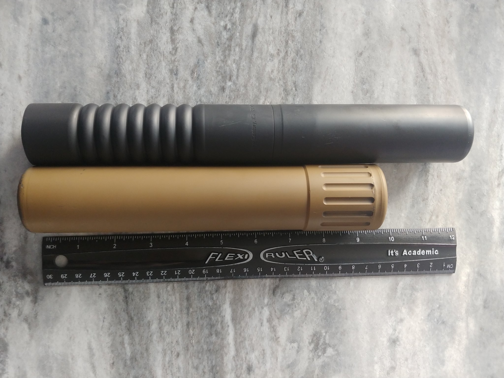

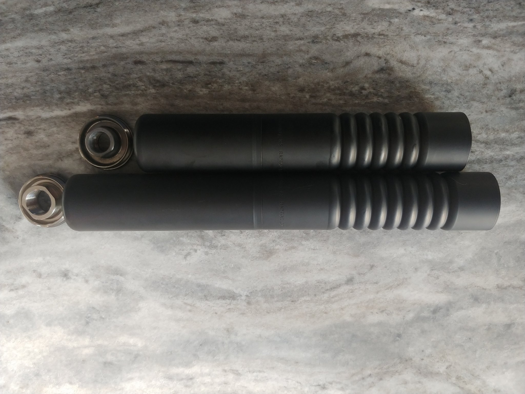

    This is the 22cal raptor next to another mfgs 30cal can. But giving a size comparison none the less. This is without the reflex attached, just the threaded endcap.

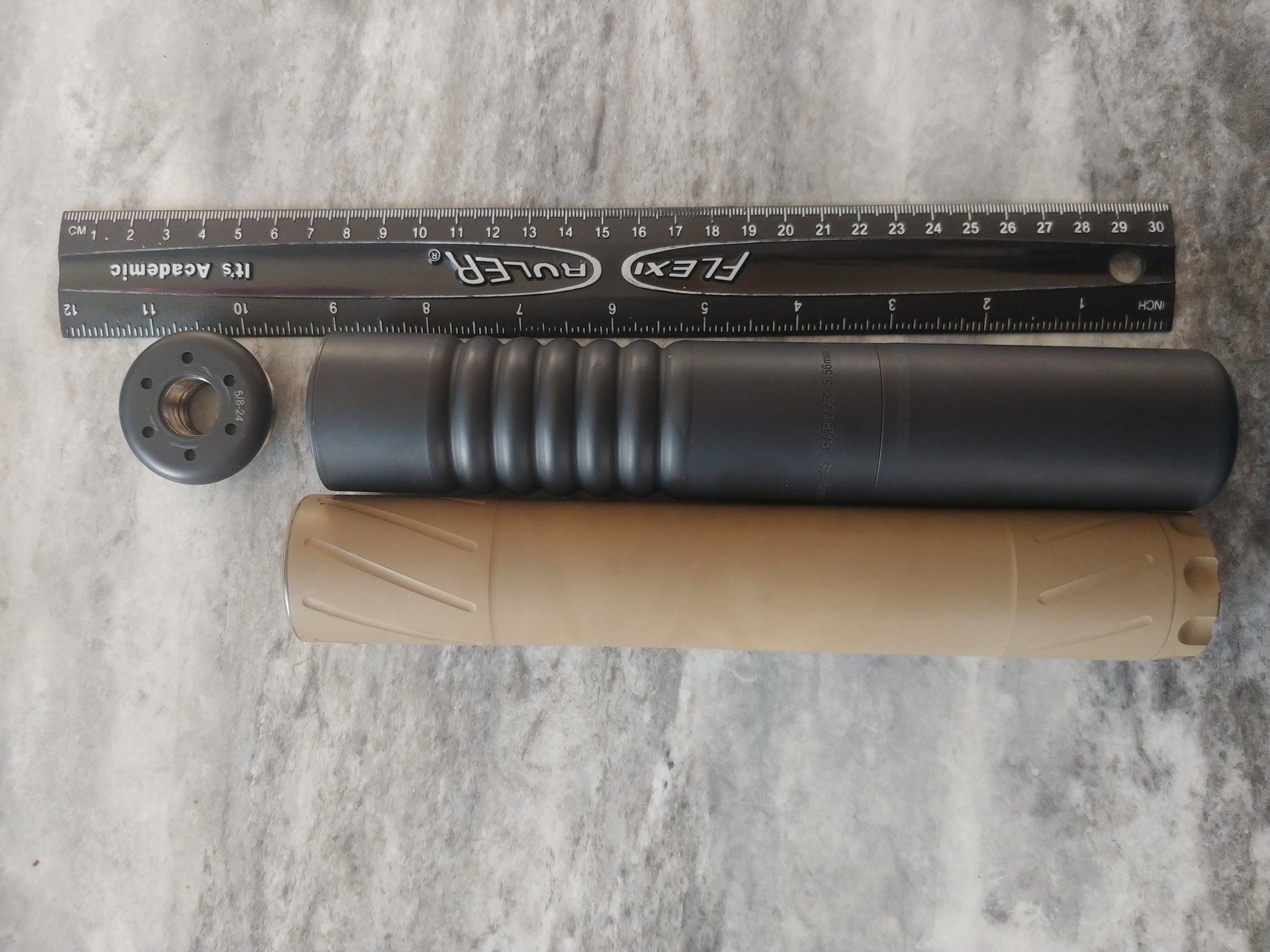

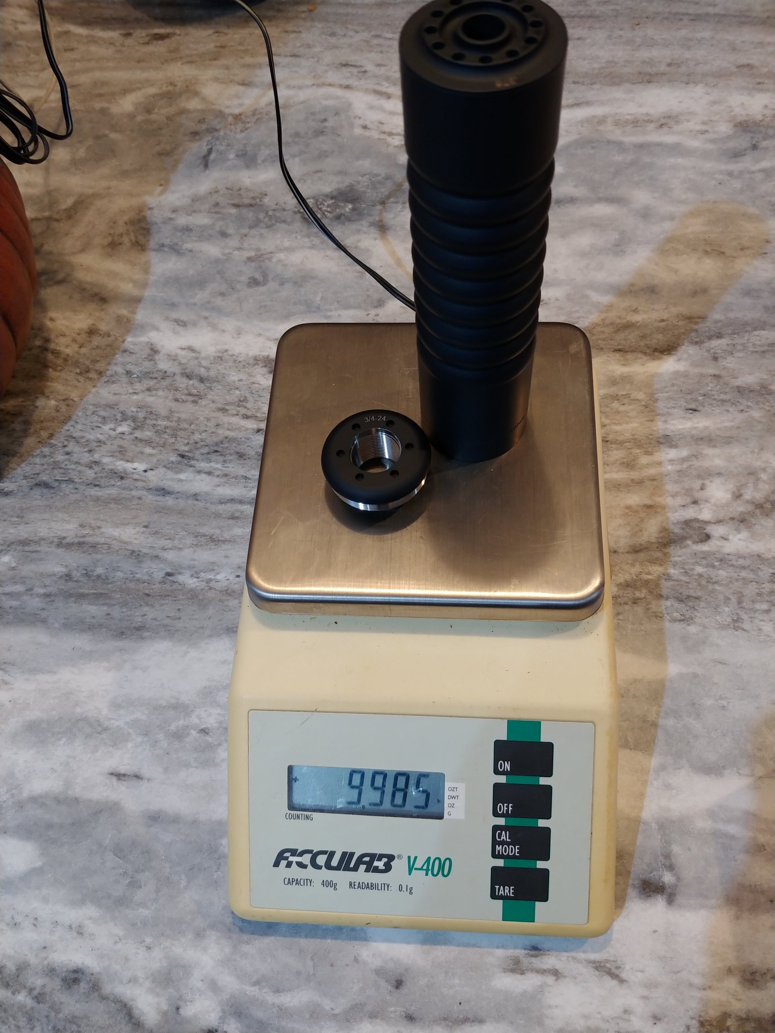

    So here are some weights on the 22cal Raptor
    Baffle stack with end caps 8.36oz
    Baffle stack with reflex 11.14oz
    The baffle stack alone without threaded endcap 6.835oz
    Reflex 4.345oz
    Endcap alone 1.525oz.
    So basically if you add either the baffle stack and an endcap to make the short suppressor, or the baffle stack and the reflex to get the longer suppressor.
    Xdeano

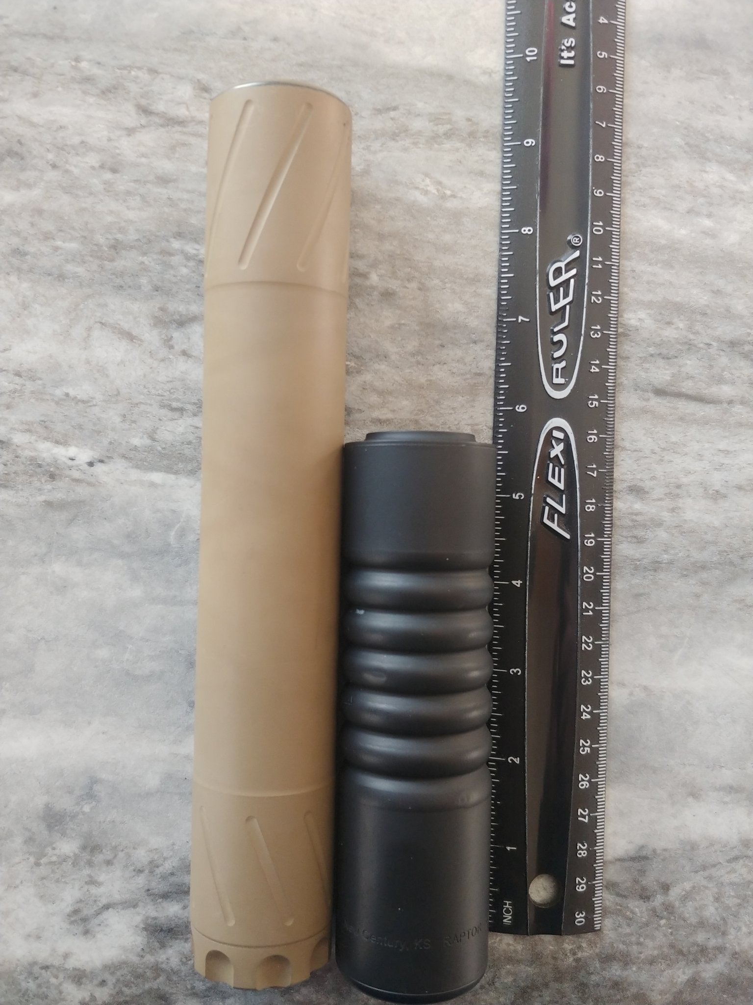

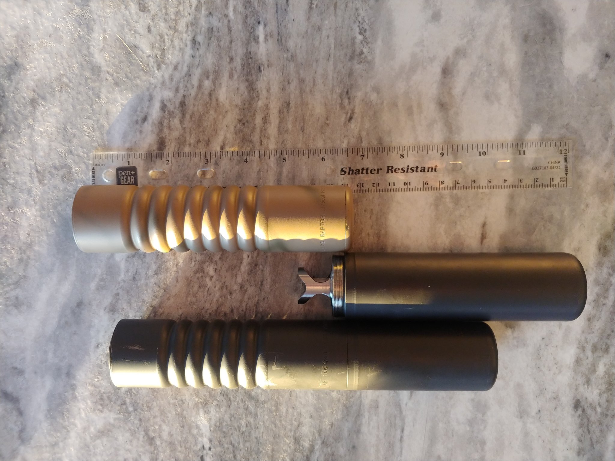

    The Larger AB is an 8 baffle Raptor, correct.
    I've got an old AAC Titan Ti in 338, it's heavier and larger in dia. than the AB is much lighter and is used on a MUCH larger round. The AB is just as quiet as the AAC without the length, weight and dia. It's without a doubt a better can.
    The Raptor on the Larger can is 5.25"
    The Raptor on the 22cal can is 3.25"

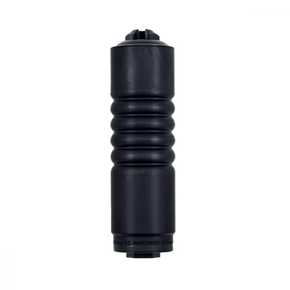

    The reflex will not fit on the Warthogs.
    A few reasons:
    The Warthogs are tapered at the mount end. The Reflex is the same diameter as the Raptor suppressor.
    Even if the diameter was the same, the threads are different. Warthog uses the “HUB” standard while the reflex/Raptor uses a proprietary threading.
    Look at the mount side:
    Above the taper is the same size as the Raptor.
    A few reasons:
