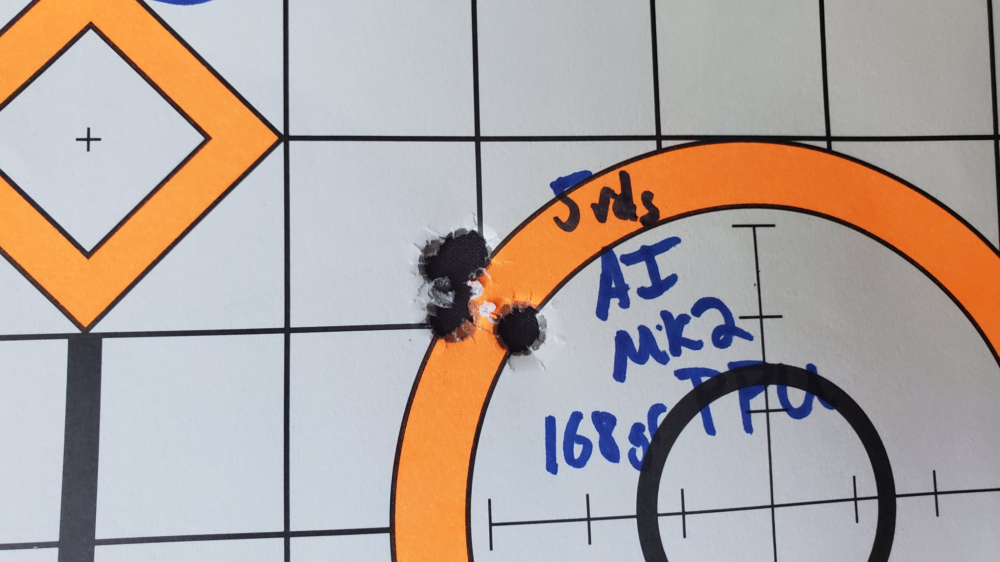

The mk2 showed up, I figured it would shoot ok, especially for no more than what I gave for it. It seems to like cheap ppu, hate to pull this bart off, but science requires it, lol.
Try 147gr or 155gr and see if you get better results.
I dont reload 308, just had some factory ppu 168 and nexus 168 laying around for a m1a. I've got a 20" proof steel 6.5creed barrel that rides on my at when the 243 bart isnt on it. I'm going to put proof barrel on mk2, after bolt is bushed at lri, and sell this 308 bart barrel. Hopefully the bushed ae bolt wont be a problem for trophy hunter to open up face?

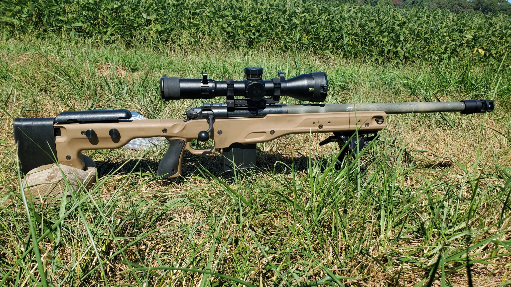

Just a quick update:
I just got one of the “demo” conversions. By demo I mean one of the early hand cut bolt heads and such. I paid for this conversion before anyone wonders if my opinion is biased.
I had 3 accurate mags tuned along with it. I loaded them all up with some random 62gr duty ammo I have laying around.
All 3 fees perfectly without hiccup.
I’ll post more once I have some range time. But I can tell you I’ve had issues with things like Valkyrie in a bolt rifle that didn’t feel good or feed well.
This is not the issue here. Feeds lawlessly so far.
Update/range report:
Only put about 60rnds through it as I spent all day working on a new dasher barrel.
All 3 mags fed perfectly without any hiccups. Loaded to max 10rnd and anything in between.
Also. One of the most awesome things is you can just toss a round in on top of the mag and chamber it (like an AI is known for). Usually single loading isn’t that easy with a .223.

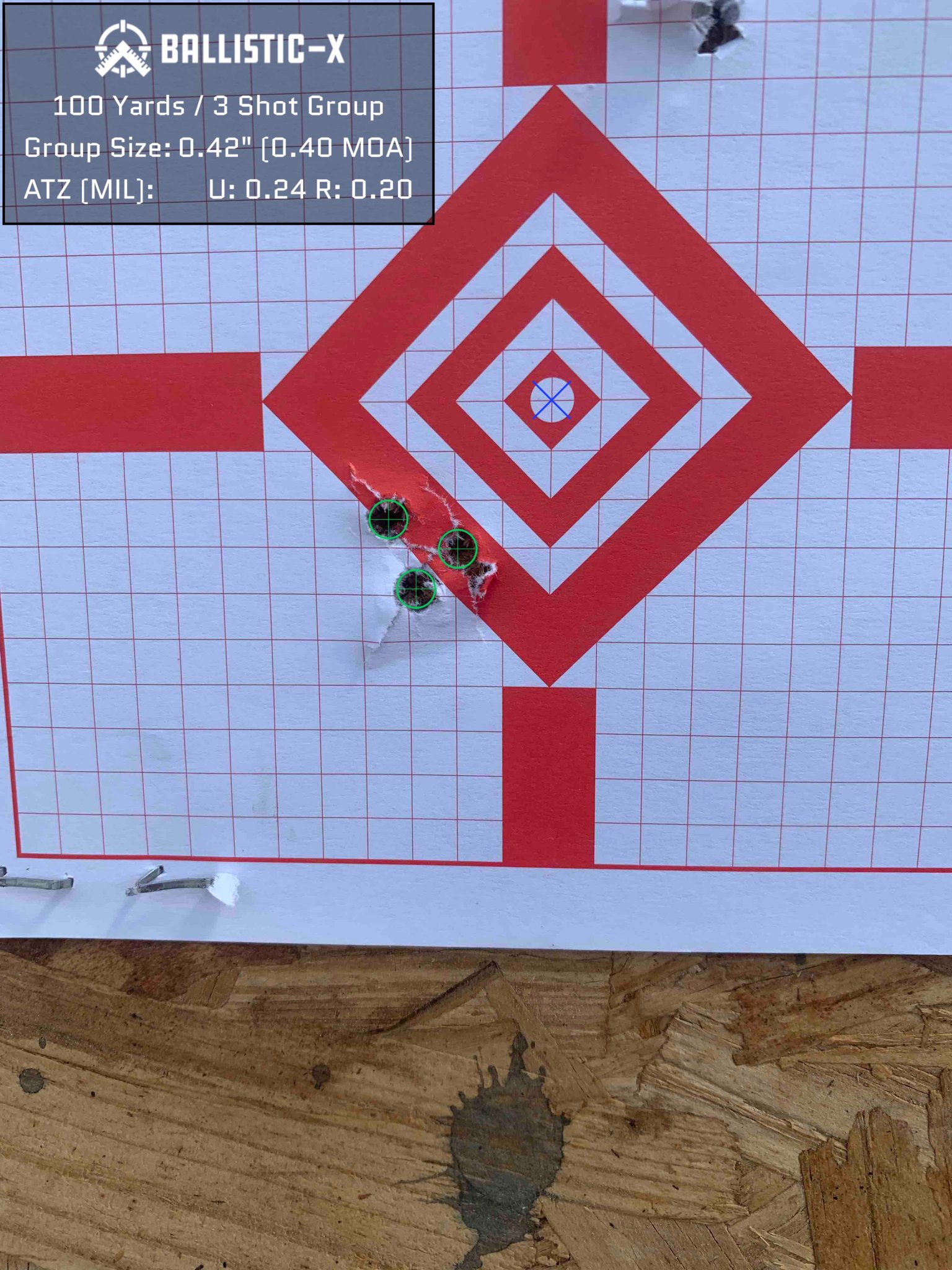

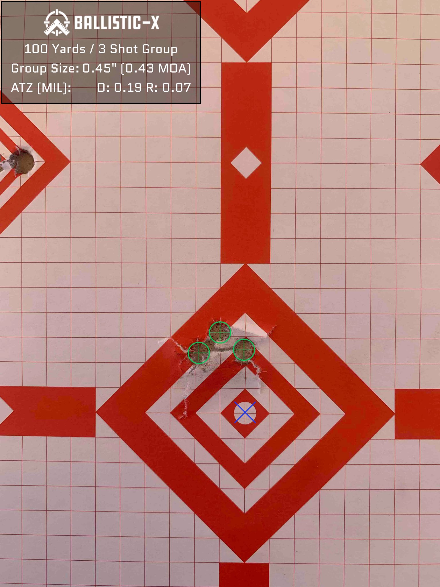

Here is a typical group I was getting with factory 77gr fgmm ammo. The grids are 1/4” and distance is 100yds. This was after shooting groups all day for dasher load development. So I’m not sure if I was tired or if I was in tune (so can’t tell you if this is a good or bad group for the rifle). I consider myself a .3 or .4moa shooter on my best days.
(Disclaimer: @trophyhunter is a buddy of mine. However we regularly tell the other if we thing an idea is stupid or something is a piece of shit. I also paid either retail or very close to retail for this. Nothing was given to me)
.40 moa seems to be about the common group size with factory ammo out of brand new barrel.
I’m sure handload will hammer in this thing
