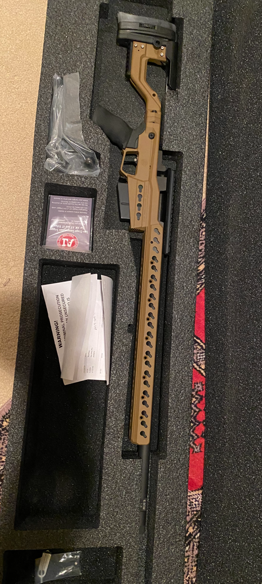

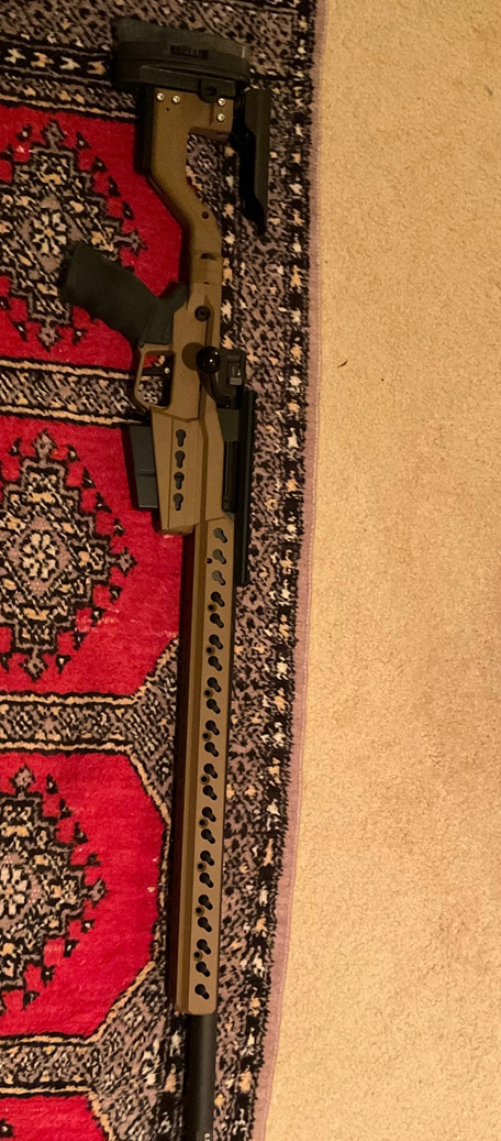

This is my first AI rifle and it's wonderful: fit, finish, feel, and accuracy. I have one issue though, why the hell is a 4mm hex included in the comb when it only adjusts the comb angle and offset when a 3mm actually adjusts the LOP/comb height? Also, why include the other hexes in the trigger pack but not the 2.5mm to adjust the damn shoe? Did this get overlooked on the manufacturing sprint to deliver the rifles 6 months late? :LOL:
I also have a stupid question: say someone was stupid enough to buy an AXSR AICS chassis for just the buttstock, I can just take the back end off and attach to the at-x right? If that's the case, why doesn't AI just split the damn things and sell them out?
Last thing, I talked to someone at EO, they said that they're hoping to get those bridges....before year end, no news on the hinge and stock.

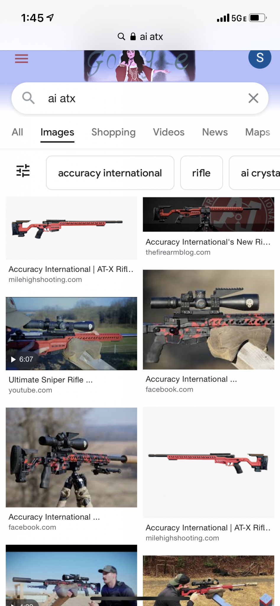

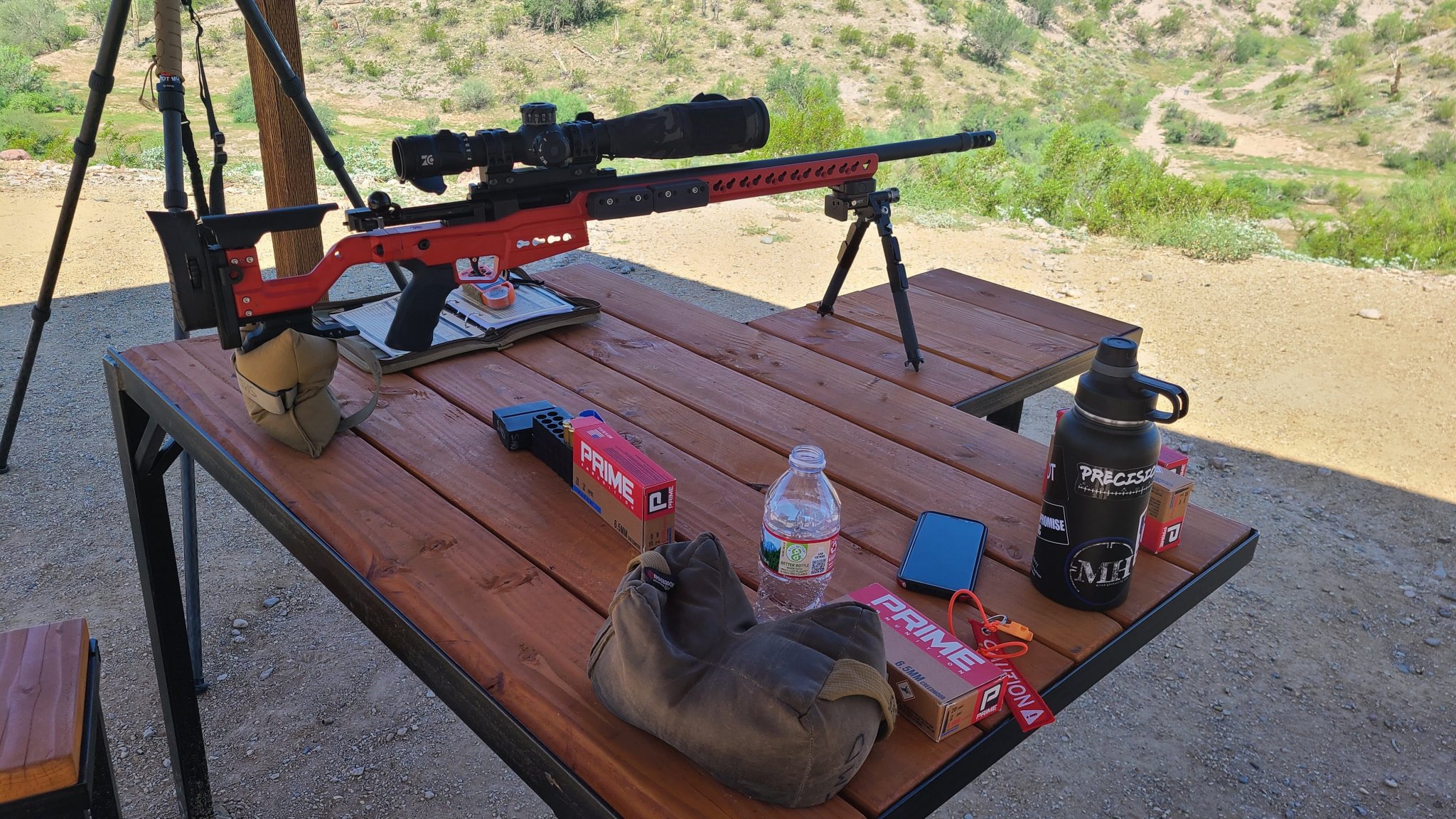

THIS IS ALL OF US. I feel like this is the understanding with AI. They want to charge like $84 for a qd socket on 3” of pic rail. Also they showed the gun with a bag rider in literally all the stock photos—but no bag rider.

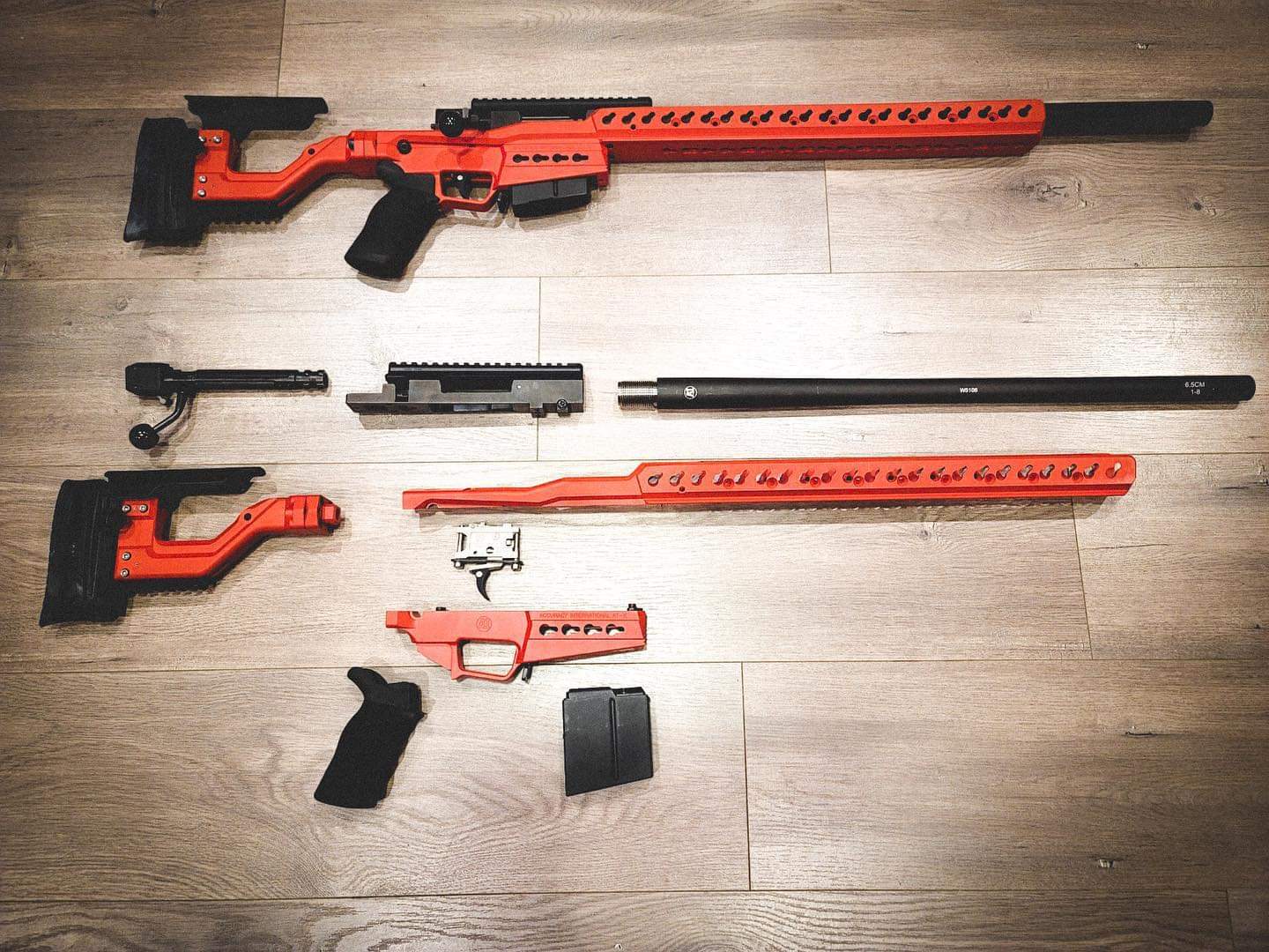

Yes you can. The Aussie's already did it with their PrePro AT-X
