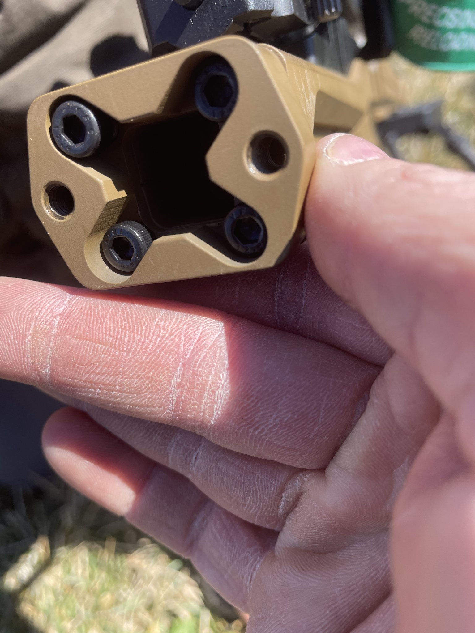

Get Access SubscribeDevconHad an associate in the Thermal Mafia relate that they had a ASR/AXSR/whatever. And it came with the action screws and scope rail screws loose.
I thought myself BS
Then this happened today at a match
WiTF AI.
Y’all better take your lego rifles apart and loctite/retorque everything.
Srsly wtff View attachment 7811380

@Scott Seigmund should us vintage AT-X owners take everything apart to loctite every screw?Had an associate in the Thermal Mafia relate that they had a ASR/AXSR/whatever. And it came with the action screws and scope rail screws loose.
I thought myself BS
WiTF AI.

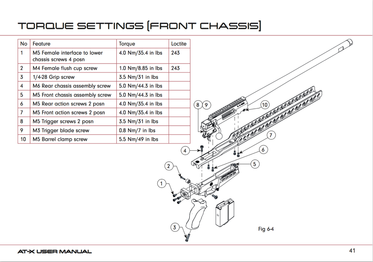

On that note, what are the torque values for everything?@Scott Seigmund should us vintage AT-X owners take everything apart to loctite every screw?

Dude your unhelpable. If it’s zero’ed and I disassemble it completely, reassemble it, and there is zero shift in zero…you can lead a horse to water.That doesn’t help. I want the official specs. If I measured the torque on my buttstoci mount it would have been 0.0 in/lb

My rifle held together until enough use / firings / etc made shit start to fall off.
Held zero to.

Right?That doesn’t help. I want the official specs. If I measured the torque on my buttstoci mount it would have been 0.0 in/lb

How the fuck are they giving you a rifle covered in various bolts but fail to put the torque specs in the manual? They put them in the AXSR’s manual so why wouldn’t they do it for the AT-X?

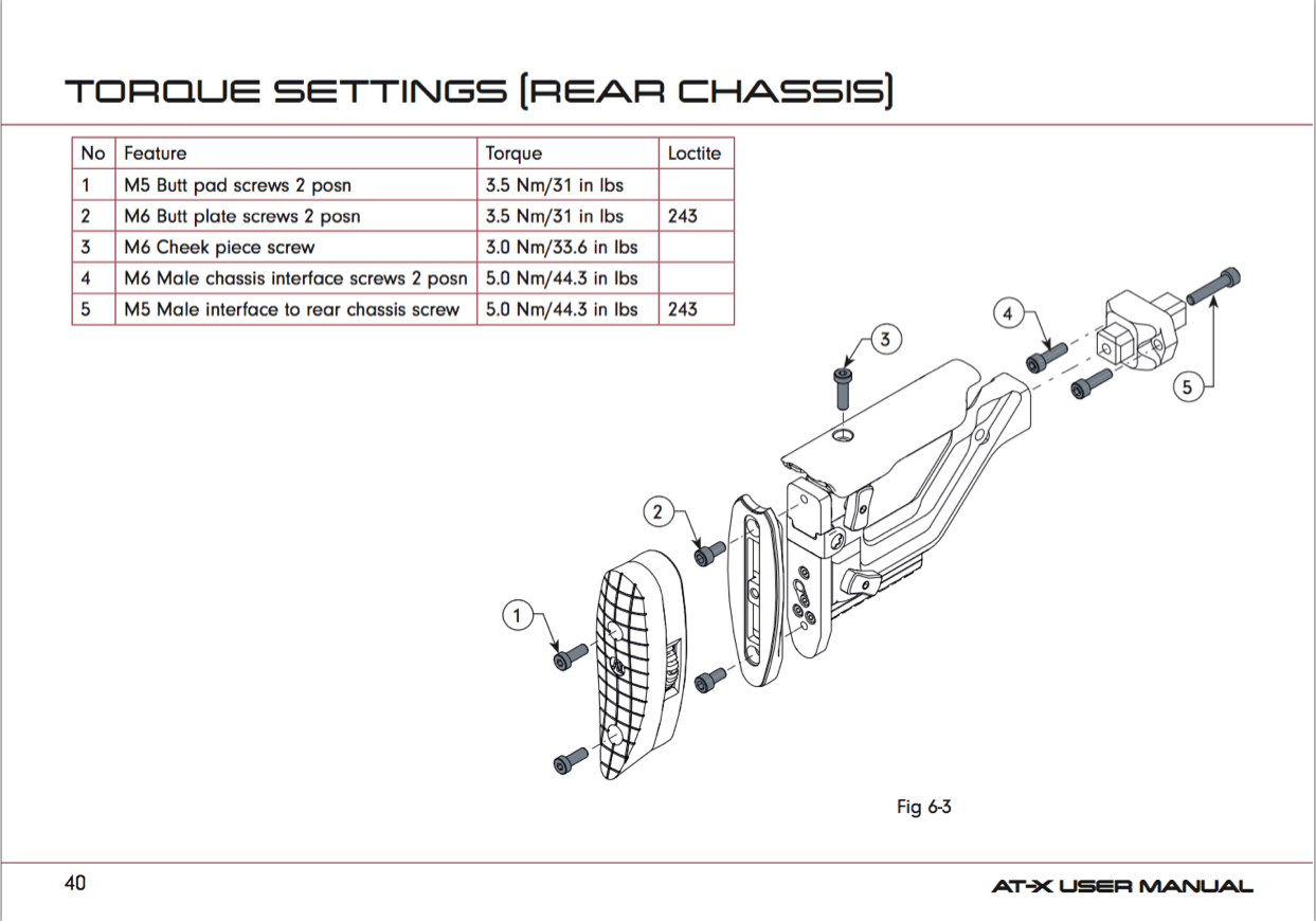

Here are the torque specs for the hinge/interface and butt.
View attachment 7813086View attachment 7813087
Tell me where I could find User Manual for AT-X (pdf file), please![]()
Is that version of the user manual available? It’s not the one I have.If the screws are properly torqued they won't come loose and don't need Loctite.

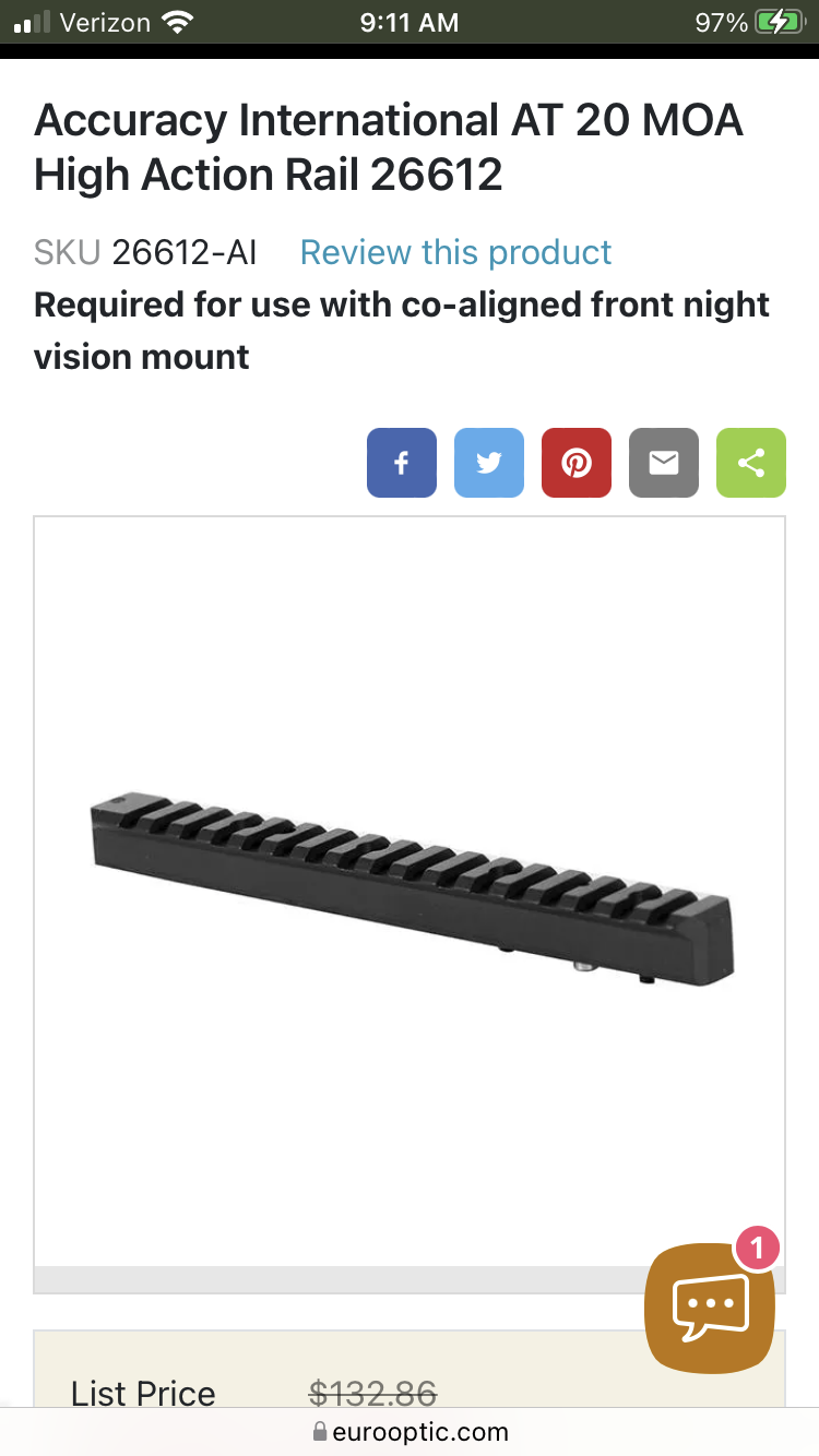

There is only one “high” action rail listed on EO. Which is the one you want.I never saw an answer for this. There are both AT and ATX high action rails on EO. What's the difference between the two, and will the AT rail fit?
Thank you!The torque specs were included in the latest revision of the AT-X user manual. I have attached a copy here for those with the early versions.
-Scott

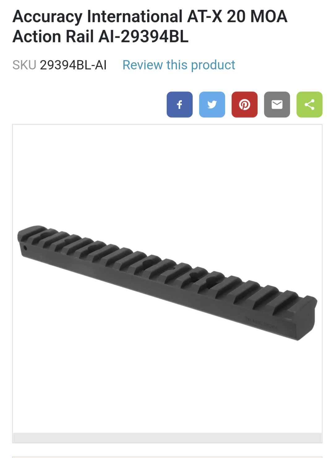

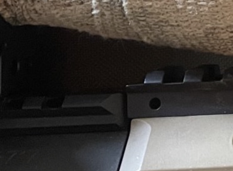

The AT-X "High Rail" is lower than the AT High Rail. The AT-X High Rail is designed to be coplanar with the full length forend rail.I never saw an answer for this. There are both AT and ATX high action rails on EO. What's the difference between the two, and will the AT rail fit?
About how much of a difference is there? I do plan on using my pvs30 on mine when I get it in.The AT-X "High Rail" is lower than the AT High Rail. The AT-X High Rail is designed to be coplanar with the full length forend rail.
The rails will fit either action, but be aware of the compatibilities.
-Scott

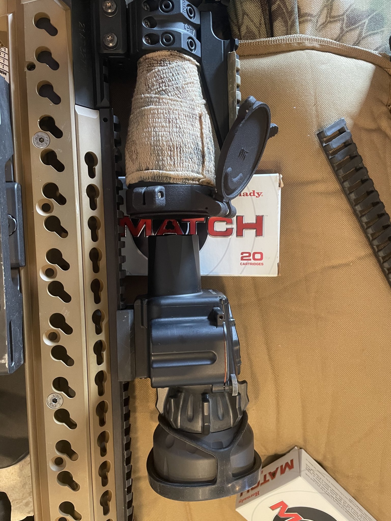

I didn’t realize there was a difference between atx and at high action rails. I got the atx high rail and my Pvs30 lines up perfectly with a tangent in 1.5 hight sphurAbout how much of a difference is there? I do plan on using my pvs30 on mine when I get it in.
The difference is approximately .050". It isn't going to be enough to mess with night vision performance, but it won't be perfectly coplanar.About how much of a difference is there? I do plan on using my pvs30 on mine when I get it in.
While my autism will flare, I'm just happy it will work well. Thanks!The difference is approximately .050". It isn't going to be enough to mess with night vision performance, but it won't be perfectly coplanar.
So what is the product SKU number for the AT-X high rail. I don’t see one on either EuroOptoc nor Mile High website. I think many were under the impression that this one was the one we needed and when I called EO to ask this is the one I was told.The AT-X "High Rail" is lower than the AT High Rail. The AT-X High Rail is designed to be coplanar with the full length forend rail.
-Scott
