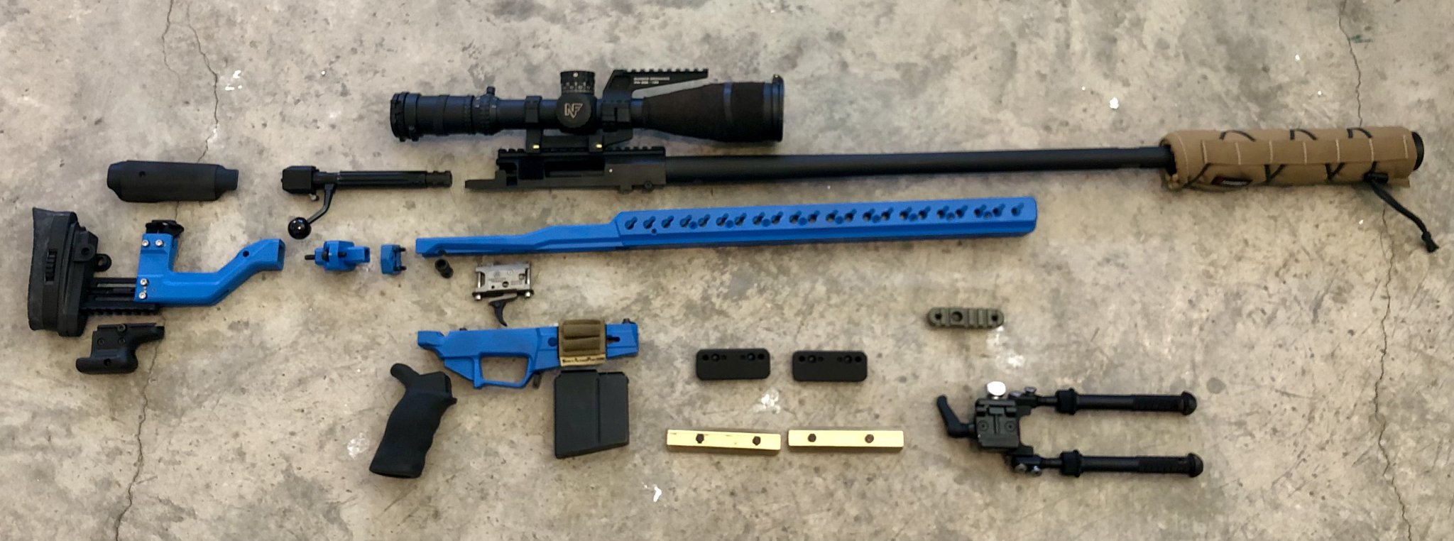

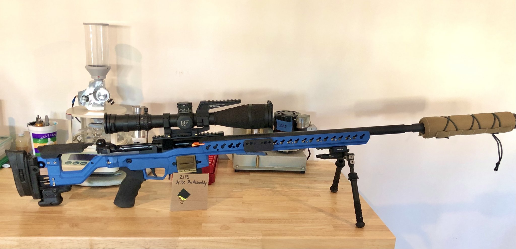

Since the manual does not have torque specs, before I disassembled the AT-X I made witness marks on everything I could. On reassembly I double confirmed torque with Fix-It Sticks AND a Craftsman Torque wrench. I went to the range this afternoon, and the first five rounds printed ~1/2” group with no shift in zero from disassembling the rifle. I debated posting this, but I figured the torque specs could help others. I do not work for AI, and these are just what my rifle toque values were. Anything that does not have witness marks was torqued to hand tight + 1/4 turn.
Stock to Rear interface
5mm
50 in lbs (no witness marks)
Stock to Chassis interface
4mm
45inlbs
Stock
5mm
50inlbs
Grip
3/16”
40inlbs (no witness marks)
Mag Catch
3mm
25 inlbs (no witness marks)
Bag rider
4mm
15inlbs
LOP /Comb Height
3mm
25inlbs
Lower Chassis screws
4mm
30 inlbs (no witness marks)
Flush cup
4mm & 2.5mm
10inlbs
Rear Action Screws
4mm
25inlbs
Front Action Screw
3mm
25inlbs
Trigger hanger
4mm
30inlbs
Keyslot
4mm
35inlbs

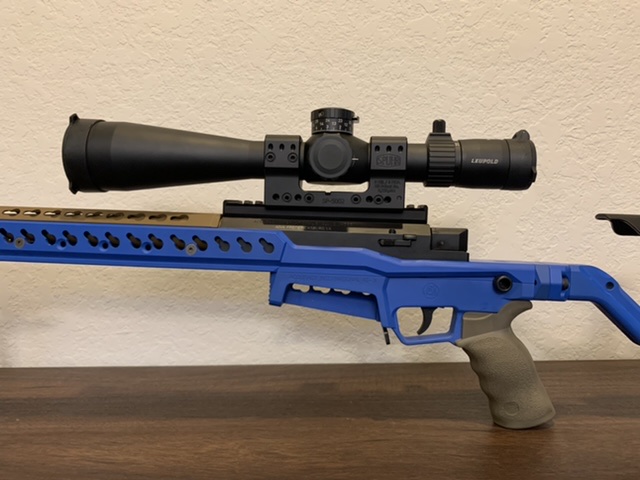

I’m not entirely sure if this mount is going to work out, but we’ll see. The cheekpiece is currently bottomed out with the 4601, so I’d suspect the 4602 might be necessary, especially if I can add the fore end bridge.
You guys may be getting NV bridges for a different reason, but for me the utility is to be able to attach a top rail (for NV clip-ons). In which case one also needs the tall action rail and a 1.5” mount to line up with most clip-ons. That should alleviate any cheekpiece height issues, but it does raise the optical axis height quite a bit (ala AX and AXMC/SR).

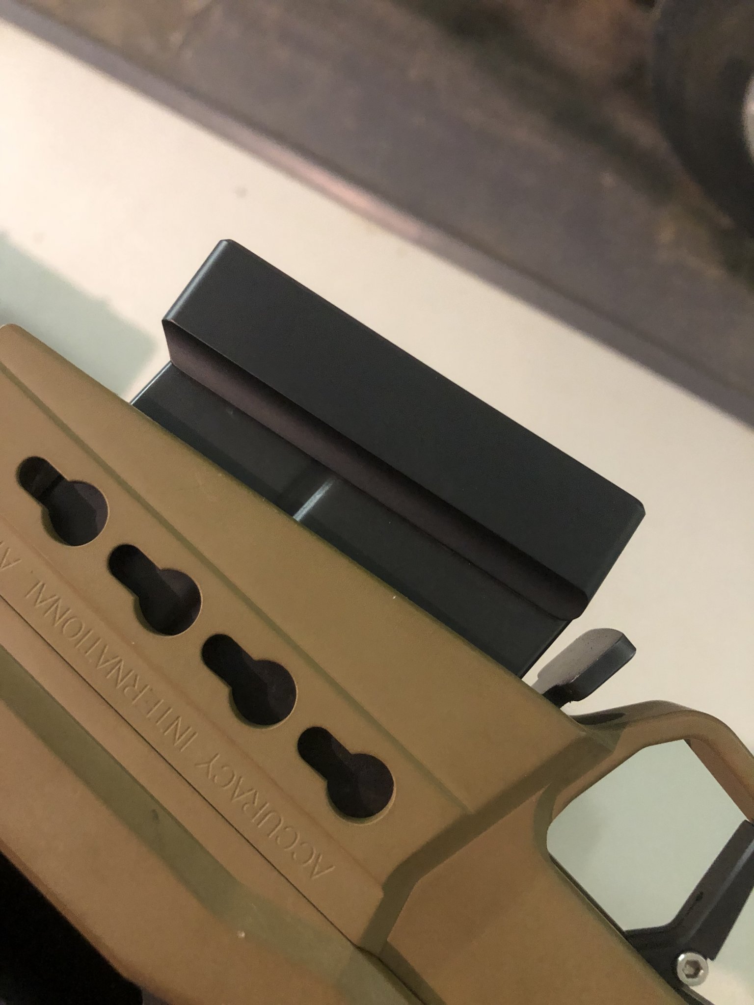

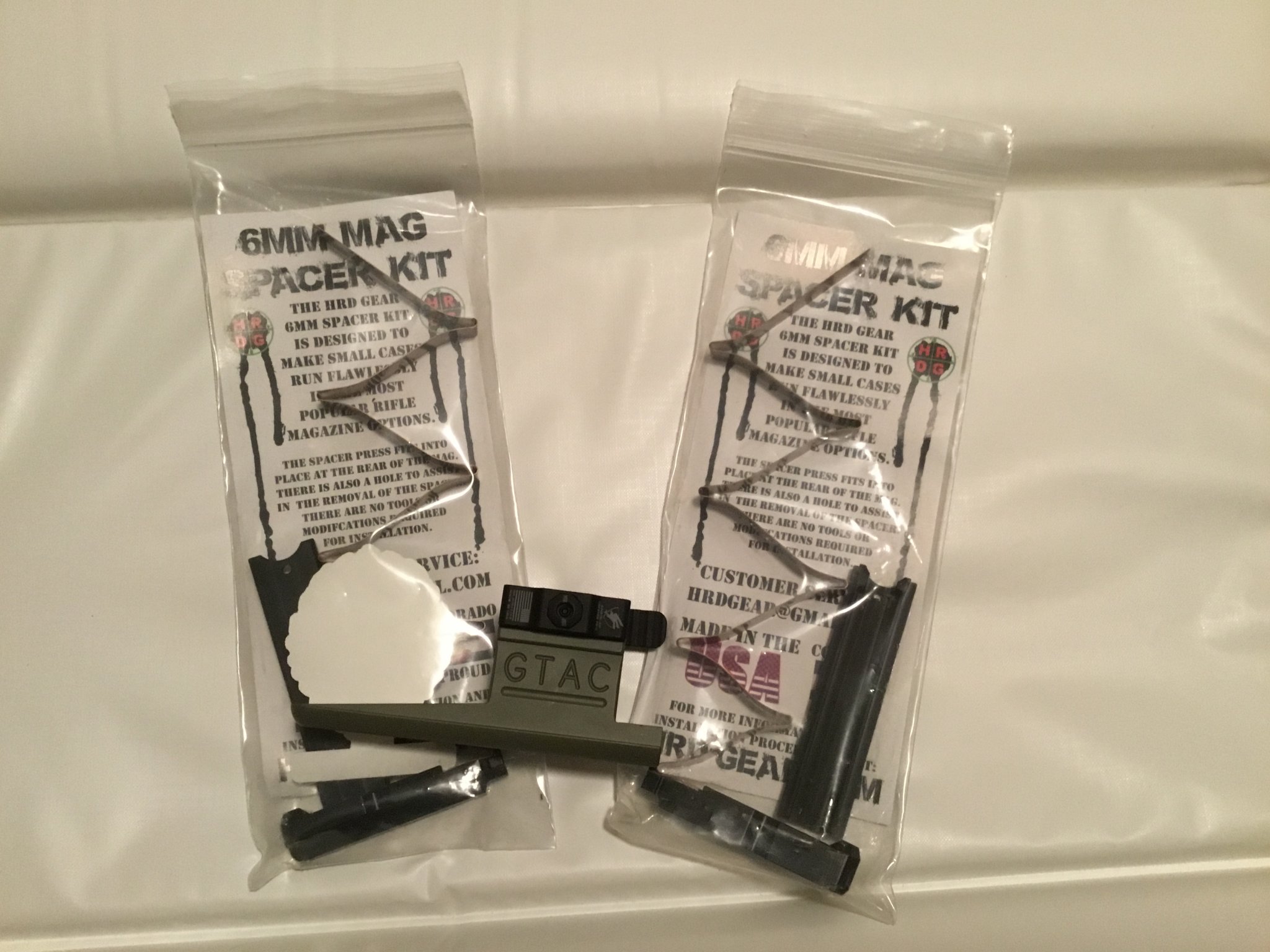

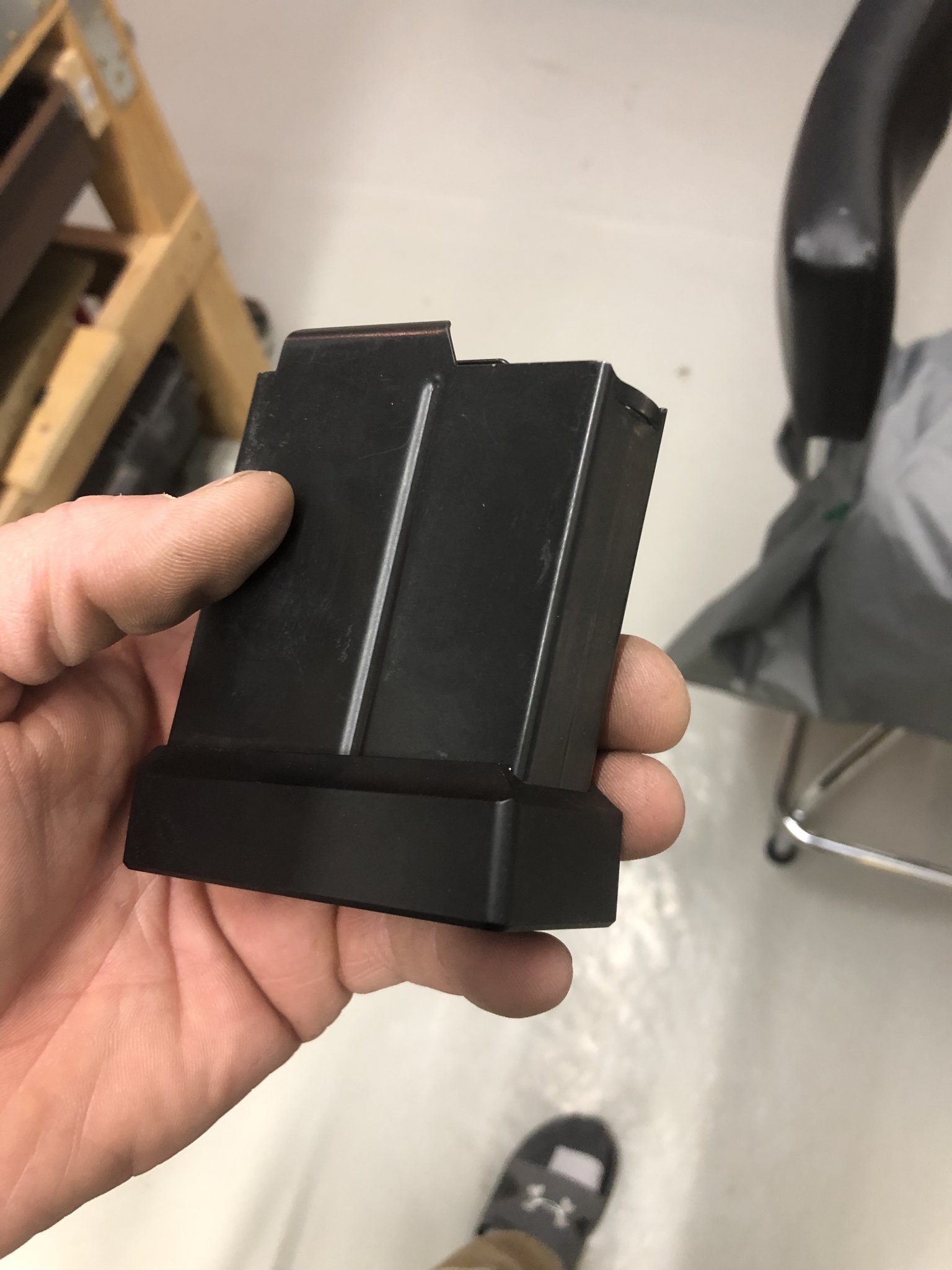

How much of a pain in the ass was it cutting off the bottom plate? Makes me a little nervous cutting off the bottom of a perfectly good magazine. Hahha
5 min of Dremel work and you're done. And u dont cut the bottom off, u basically cut out a hole a little bit bigger than the last follower spring leaf and put it back inside and make sure the spring goes down through the hole.
Reactions: Darkside-Six
I just cut the welds and took the whole plate off. Cut some slots to bend out two new tabs and then trimmed everything up flush. Doing it this way leaves everything inside the mag body flush and smooth. After doing this one I think if I made a couple jigs you could modify a mag in 10 minutes
Make a “how to” video on YouTube. 😂😂😂
Reactions: Krob95
I can't remember the last match where there wasn't a 12rnd stage. Ive got the 12rnd .308 based mag running good, but if im shooting dasher, im stuck to 10rnds and a +2 on the side.
I chambered a 6GT barrel just so I wouldn't have to butcher AW mags for kits. But lately I've been thinking about just consolidating all my various 6mm cartridges down to 6BR. And for some reason I want one in the AI
I'm running my BRA in AW mags with the hrd kit and out of 84 rounds through the two (small sample size I know) I haven't had a single one hang up yet. If I didn't already have the fancy SAC die for BRA, I would've went BR again for ease of loading. Do ittttttttt lol
