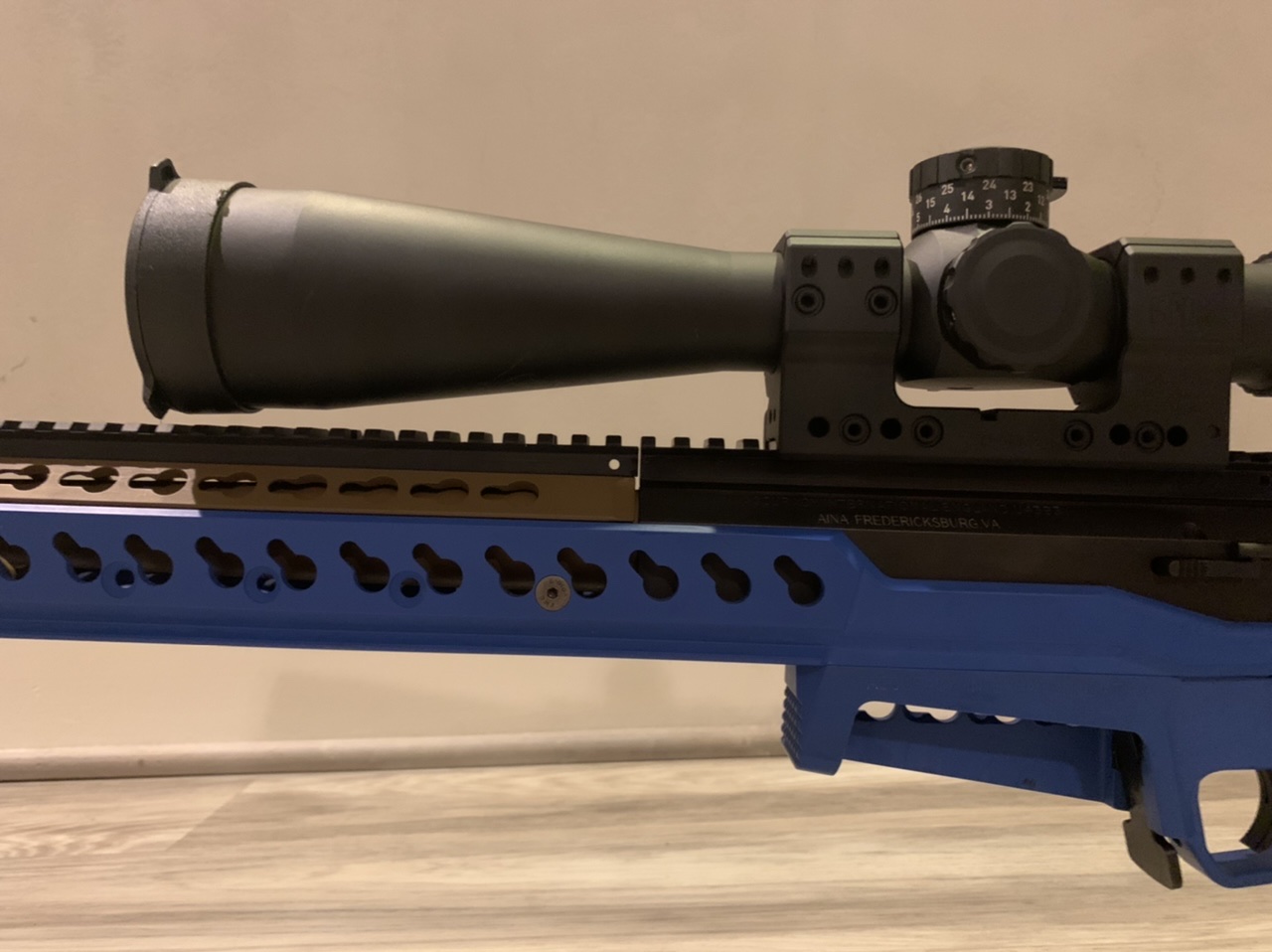

If your action rail and night vision rail are coplanar then it doesn't matter how high the rail is... If your day optic is 1.5 you should be using a 1.5 nvg mountDoes anyone know how much height the high rail adds over the stock low rail? I bought a bridge and have a TigOR-6z+ that comes with 36. 38 (1.5”), and 39mm (1.54”) height mounts. It also will accept some offset as long as it’s collimated.wondering if I could get away with the 36mm mount. I use a 1.5” spuhr 4002
Sorry should have been more clear. I have the stock low action rail. Trying to get away with not installing a high one. But I can get lower mounts for the TigIR to compensate for the low action rail. Hence my question of asking the height difference. I’d say the difference is 2mm then I can simply use the 36mm mount. If it’s 4mm I can buy a 34mm mounting plate etcIf your action rail and night vision rail are coplanar then it doesn't matter how high the rail is... If your day optic is 1.5 you should be using a 1.5 nvg mount
Lol it’s not about being poor. It’s about the PITA to break it apart and retain the factor bond and recoil lug for the rail. AI seemed to overtighten a lot of the screws on my Gun already to the point of stripping them.
@deersniper I'm pretty sure is running a low action rail npLol it’s not about being poor. It’s about the PITA to break it apart and retain the factor bond and recoil lug for the rail. AI seemed to overtighten a lot of the screws on my Gun already to the point of stripping them.
Also what’s the part number for a full length 20 moa rail for the full ATX bridge?
Edit: does AI make a short rail section that’s 20 moa to match the factory rail slope pitch? I don’t need and would prefer not to have unnecessary extra weight of a full length top rail
I heated the crap out of the hardware and broke the thread locker bond by using a cheap bit to lightly hammer the screws.Lol it’s not about being poor. It’s about the PITA to break it apart and retain the factor bond and recoil lug for the rail. AI seemed to overtighten a lot of the screws on my Gun already to the point of stripping them.
Do you know if the forend rail is the same height as the accessory rails?I heated the crap out of the hardware and broke the thread locker bond by using a cheap bit to lightly hammer the screws.

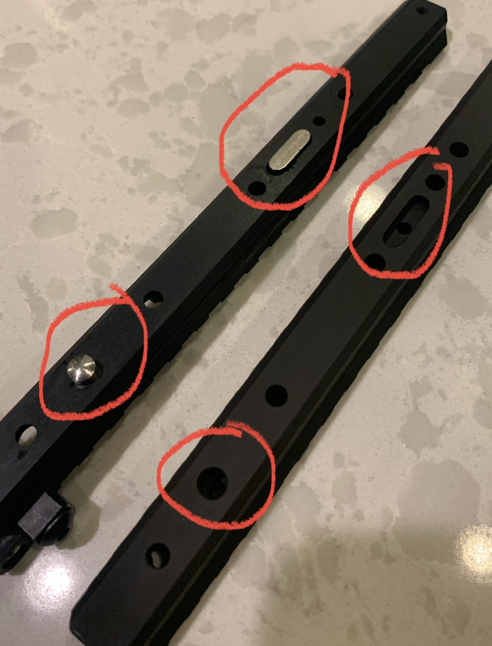

Purchasing this below will include the correct hardware and recoil lug/pin:
Accuracy International AT-X 20 MOA Action Rail Module Kit 29390BL For Sale - EuroOptic
Accuracy International AT-X 20 MOA Action Rail Module Kit 29390BL For Salewww.eurooptic.com
They appear just black oxide. Nothing crazy. The black oxide screws (carbon steel) are usually the hardest commonly available commercial grade small screws.Anyone know if the standard AI fasteners (quicklock barrel retention capscrew as an example) are just black oxide finish or something more fancy?
No, they do not make anything that matches the low action rail.Also what’s the part number for a full length 20 moa rail for the full ATX bridge?
The full length 20 MOA fore end rail is not the same height as the accessory railsDo you know if the forend rail is the same height as the accessory rails?
The accessory rails are about the same height as the AT 20moa nvg rail. The accessory rails are shorter than the ATX full length 20moa rail.Is the accessory rail taller than the NVG/forend rail? I assume the forend rail and AT NVG rails are the same thickness?
Good info thanks man! My clip on is pretty small so don’t need a lot of rail real estate. I’ve got some linger accessory rails that would work too but I’ve got a feeling that the 0moa of the accessory rail may cause issues with the clip on and the 20 moa factory action railThe accessory rails are about the same height as the AT 20moa nvg rail. The accessory rails are shorter than the ATX full length 20moa rail.
Not in my experience. My AT-X high action rail came with no recoil lugs and the attachment screws were way too long.Purchasing this below will include the correct hardware and recoil lug/pin:

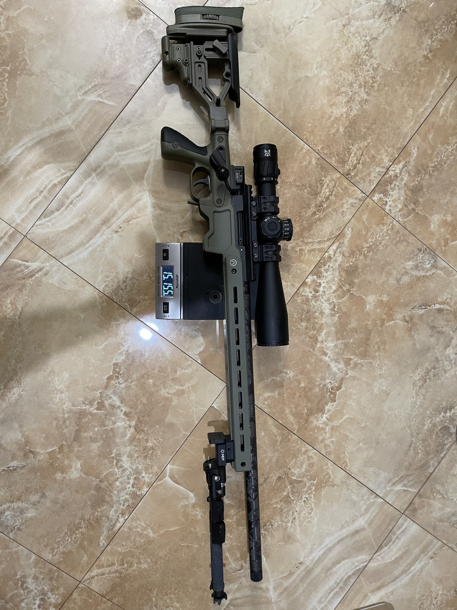

Yes.I know I saw it earlier in the thread, but I’m too lazy to look… what’s the lightest config y’all are getting out of these with a carbon barrels or similar?
Obviously dependent on scope, accessories, etc. but any hope for Open Heavy Hunter class?
Not an ATX but it’s possible. I’ve seen team AI guys run open heavy at the NRLH finale last year with an ATX. Nx8 4-32 and tbac bipod.I know I saw it earlier in the thread, but I’m too lazy to look… what’s the lightest config y’all are getting out of these with a carbon barrels or similar?
Yes, but it’d probably get a little squirrelly with a suppressor (since I’m civilized) and depending on chassis accoutrements (folder, NV bridge, etc.). I understand all of that is remedied by removing stuff, but was more interested to see if anyone had set one up one similarly and what it weighed in at.Atx Specs say 13 pounds? Should be plenty of budget fkr scope and bipod especially with a fiber barrel
Because you probably ordered AI-29394BL and not the one I linked.Not in my experience. My AT-X high action rail came with no recoil lugs and the attachment screws were way too long.
My recommendation is to still go with the AT-X high action rail, swap the recoil lugs over, and use the corresponding AT-X 20MOA NV rail. Doing anything else just increases the number of potential sources of error.
I know my rifle which has a zco420, heavy ass unimount, mirage shield, barrel tuner and supressor, Ckyepod weighs 20#. Remove the tuner/can in favor of a titanium brake, cuts a pound, run a carbon barrel, cut 2.5 more. That puts me a half # over open heavy. Switch to a sub 2# optic in lighter rings you'll make weight. The rifle will be very ass heavy. My rifle config at 20# with can tuner and Ckyepod oit front balances perfectly in front of mag well.I know I saw it earlier in the thread, but I’m too lazy to look… what’s the lightest config y’all are getting out of these with a carbon barrels or similar?

You are absolutely right, I checked my order and it was in fact AI-29394BL. I didn’t know there was a second option available, is this a new offering?Because you probably ordered AI-29394BL and not the one I linked.
Mines actually surprisingly light. Go with a 22” (with can) or 24” (without) carbon barrel in 6 creed or similar. Still nowhere near a manners and carbon barrel but it’s respectable. And the weights feels like it’s in the right places.I know I saw it earlier in the thread, but I’m too lazy to look… what’s the lightest config y’all are getting out of these with a carbon barrels or similar?

AT 20MOA NVG Rail (PN 25849)
0.2365” at the front
0.2685” at the rear
140mm/5.5” AI Accessory Rail (PN 25847BL)
0.2525”
80mm/3.15” AI Accessory Rail with Flush Cup (PN 25852GR)
0.2540”

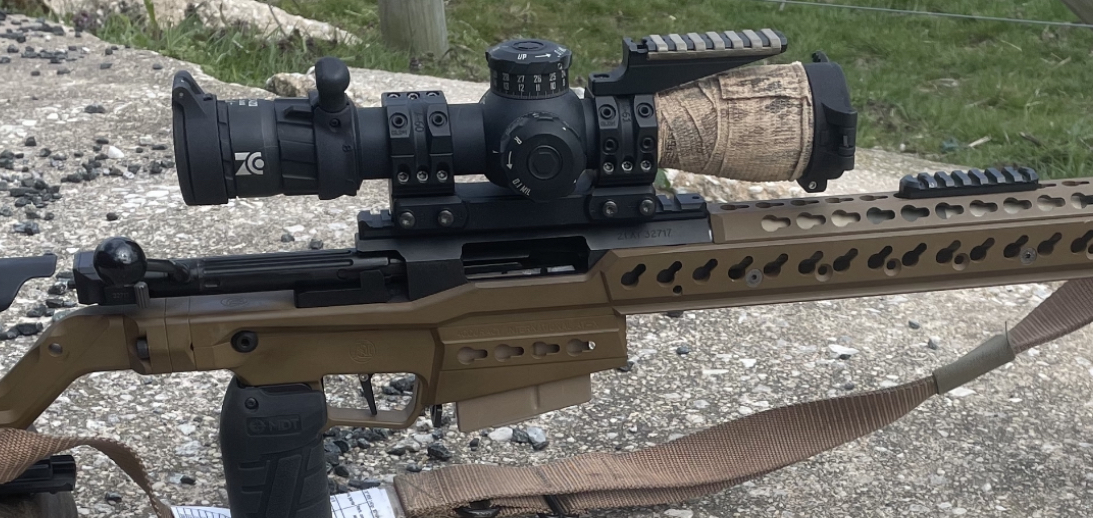

I noticed in your second pic you have a small accessory rail. I assume that’s the stock factory low 20 moa rail. Does your clip on work with the scope on 20 moa and the clip on on a 0moa rail in that’s configuration you have?

6cm for nrl hunter open heavy? Wont make the power factor.Mines actually surprisingly light. Go with a 22” (with can) or 24” (without) carbon barrel in 6 creed or similar. Still nowhere near a manners and carbon barrel but it’s respectable. And the weights feels like it’s in the right places.
True. With the weight of the rifle with carbon barrel, 6 creed is about as much recoil as the rifle could realistically handle IMO while allowing you to spot your shots shooting from more unstable positions. That’s why I chose this caliber but I don’t shoot NRL hunter. But this rifle kills everything at the ranch just fine.6cm for nrl hunter open heavy? Wont make the power factor.
Yes, yes, yesI noticed in your second pic you have a small accessory rail. I assume that’s the stock factory low 20 moa rail. Does your clip on work with the scope on 20 moa and the clip on on a 0moa rail in that’s configuration you have?
