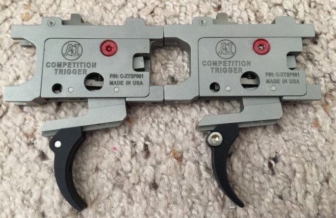

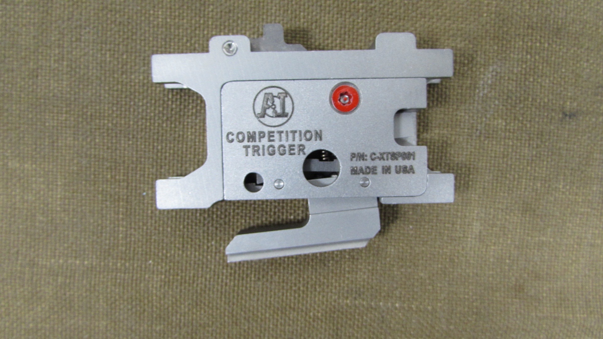

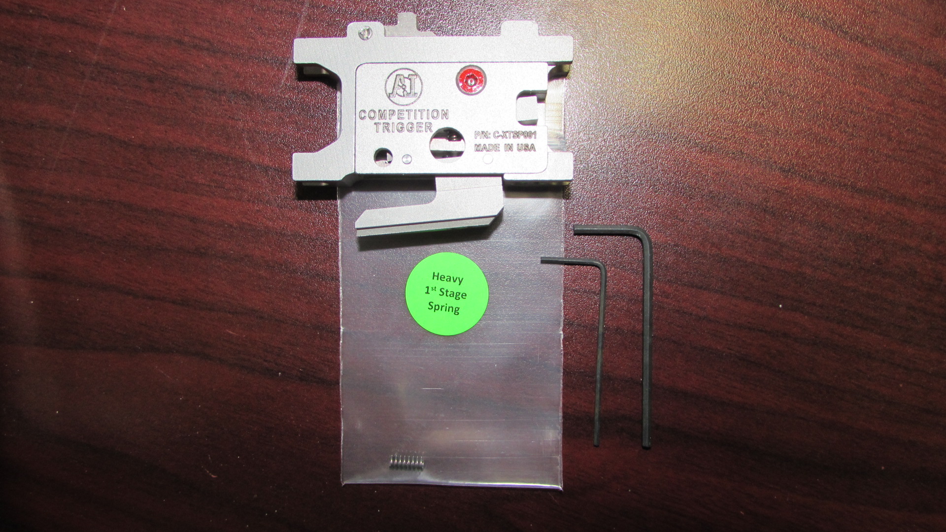

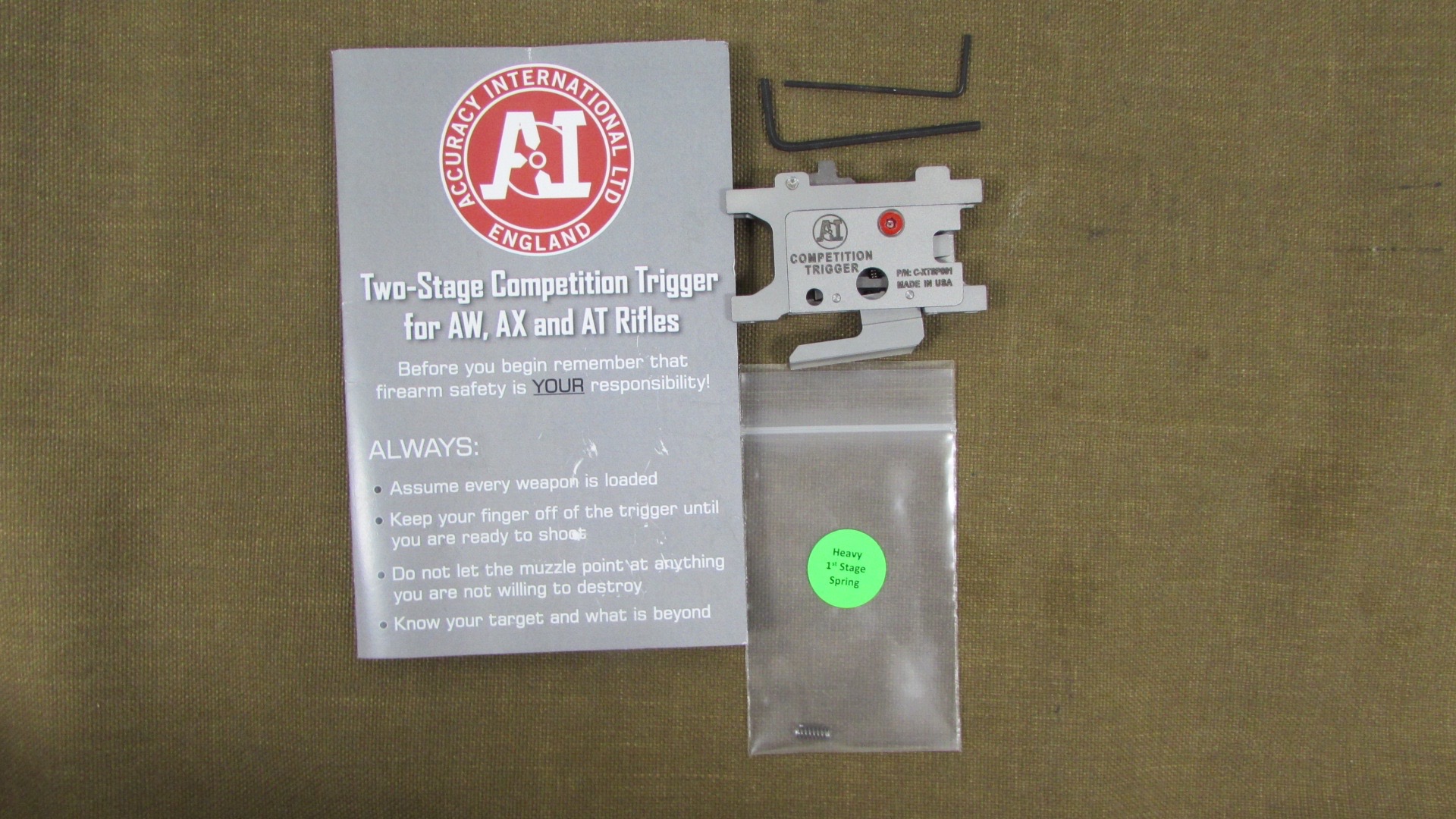

JUST CAME IN!
Came out of shoulder surgery and got emailed the MHSA link for the trigger from a buddy. My nurse thought the boner I was sporting was in her honor, I should have showed her the link and told her not to flatter herself ha. I can’t wait to get my hands on one, or be able to hold my junk with my dominant hand again, I imagine I’m looking forward to each event with an equal amount of enthusiasm.

These triggers do look good...

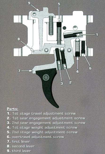

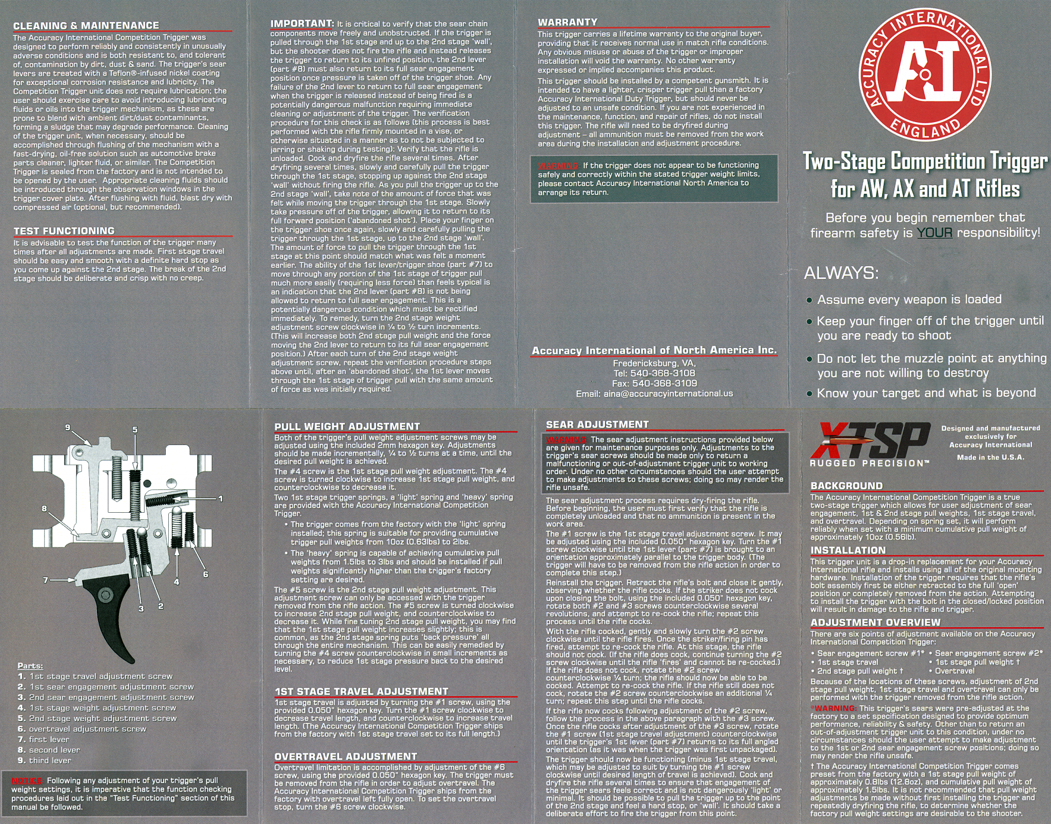

I also bought some curved trigger shoes, for the heck of it. Apparently there are left and right - handed trigger shoes, which suits my mirror - image AT308s!

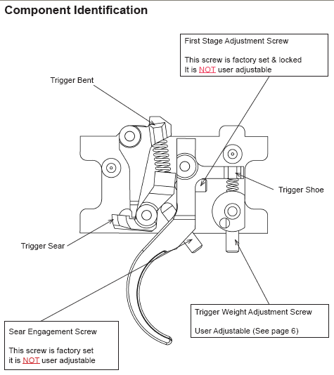

Accuracy International Competition Trigger Manual 1.pngAccuracy International Competition Trigger Manual 2.png

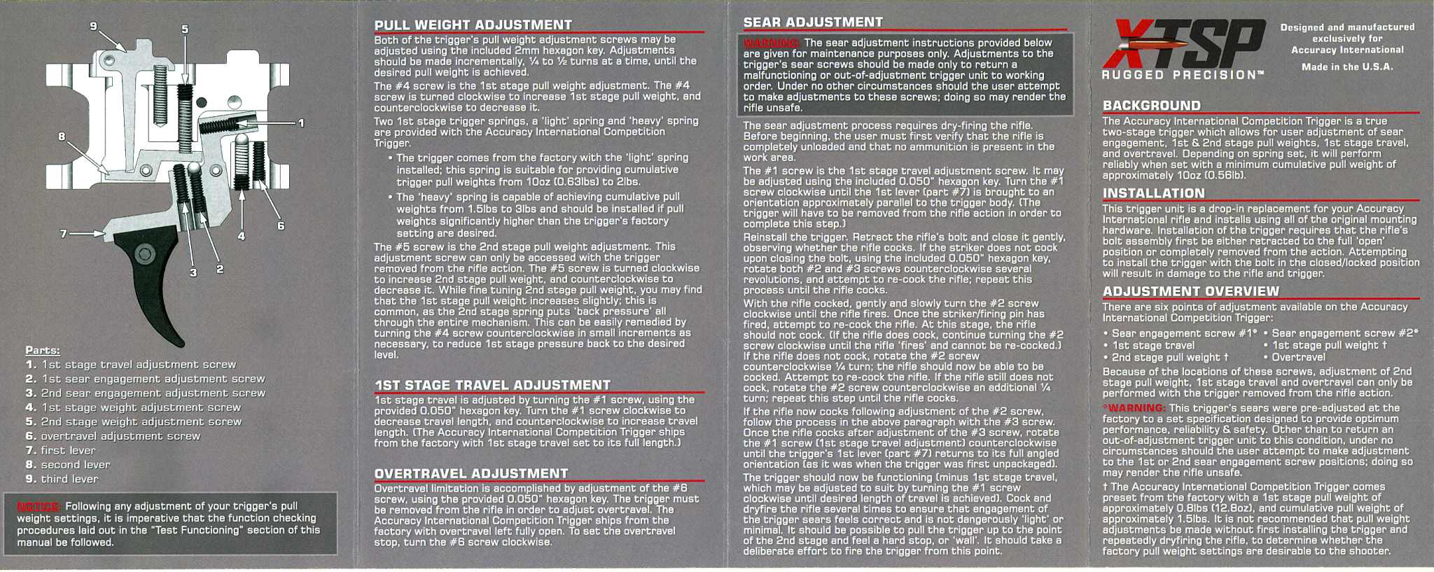

I don't have my Lyman Electronic Trigger Gauge yet, so I can't take any measurements. I do have a set of NRA weights and some washers (for weights less than 500 grams).
I have some questions on my methodology in adjusting the individual stage weights, and the overall pull weight.
Let's say I want to set the Total Trigger Pull Weight at 500 grams, and I want the two stages at 250 grams each (50/50).
To do so, do I:
1. REMOVE SCREW #4 + SPRING + BALL (1st Stage Pull Weight) to isolate 2nd Stage Pull Weight Tension (now a Single Stage Trigger dependent on SCREW #5)
2. ADJUST SCREW #5 (2nd Stage Pull Weight, but now in effect a 1 - stage trigger) to get a trigger break at 250 grams
3. REINSTALL AND ADJUST SCREW #4 + SPRING + BALL to get a trigger break 500 grams (back to being a 2 - stage trigger)
Or, instead, do I:
1. ADJUST SCREW #4 to get a trigger break at 500 grams
2. ADJUST SCREW #5 afterwards to find that 250 gram 2nd stage wall.
I suspect getting that 50/50 distribution isn't as easy, given what I assume are different spring tensions and different tension curves. It may not be a purely additive affair, and I'll have to fiddle with both screws numerous times to hit the sweet spot.
Lastly, what's the recommended way of setting this up as a 1 - stage trigger?
Any recommendations would be appreciated...
I haven't tested this but my guess would be that the easiest way to go about this is to adjust both the #4 and #5 screw together (with the trigger not installed into the chassis) and test until you reach your desired pull weight.

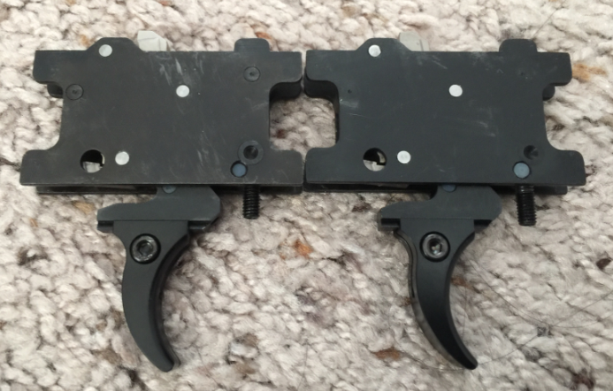

The standard triggers just feel so much more bombproof overall :eek:

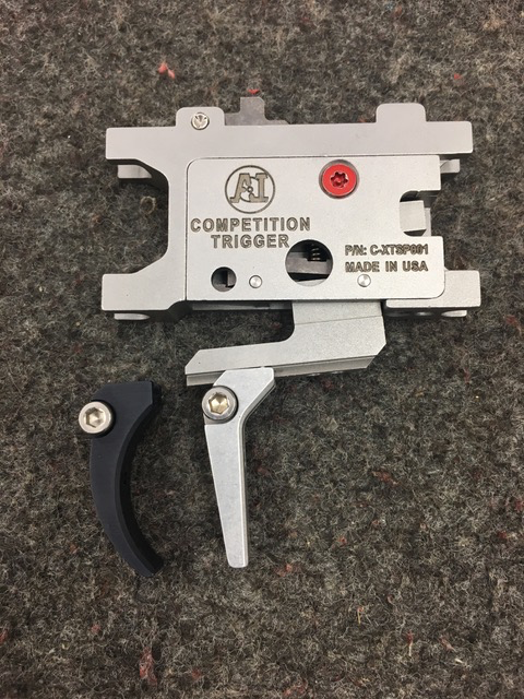

Love the new comp trigger... now for the flat faced trigger shoe.
Just got off of the phone with Mile high. Still no lead time or updates on the flat trigger shoes. Meh, I think it would be a novel thing to have when they are available.
