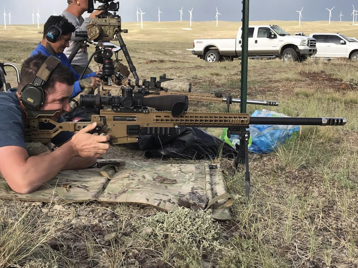

I'll have some rounds through mine this weekend and report back. 30" 33xc with 300gr lasers on the AXSR.
Few guys on here already running XC with good results.

@NoLegs24 I also have two questions about your AXSR ;-)
What colour is it? Dark Earth I presume?
And can you attach the Tenebraex kill flash when using the SP-4602 mount with your TT525P? I'm wondering whether it'll hit the rail or not.
Nice shooting!

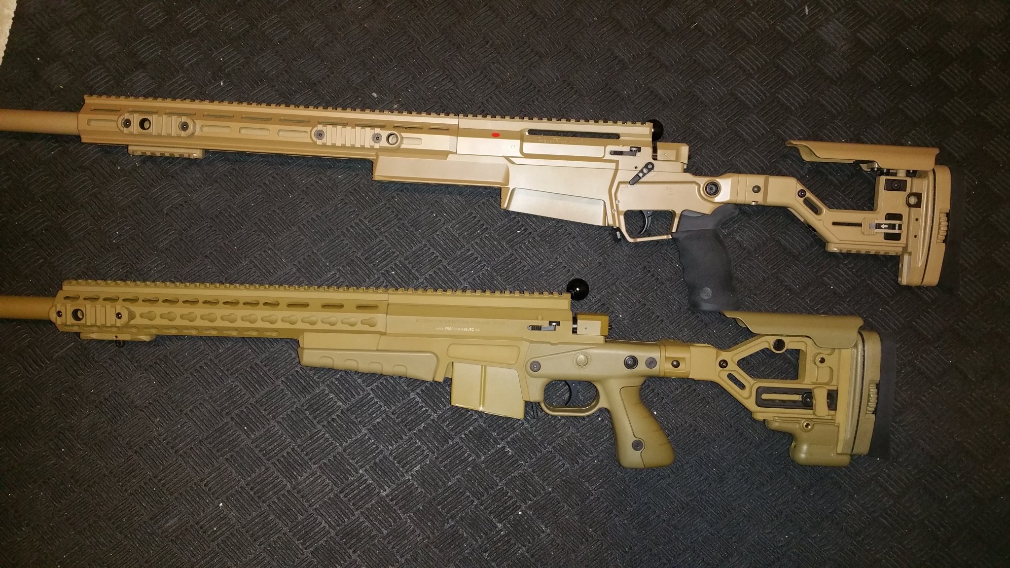

@M289
It's an ASR. Forgot what specific coating they used. It's different than the Dark Earth on the AXSR though.
I use the ARD that comes with the TT's. So plenty of clearance with the 1.5" height

@M289
Alright thanks, I had issues with a 1.5" height Spuhr with 44MOA cant on top of a SRS A1 0MOA rail.
There the ARD+flipcap touched the rail but this might be due to the large amount of cant in that mount.
For the AI AXMC/ASR/AXSR/AXMKIII a SP-4602 is enough due to the integral 20/30MOA rail.

@M289
I belive the ASR is Federal 20150 / Surge Brown that meets the contract requirement. This is the same as the TBAC 338 Ultra SR suppressor color.
Reactions: M289
@M289
Ah that makes sense. So it’ll be different from the Dark Earth colour that AI UK uses.
I was told it’s “Flat Dark Earth” but the AI brochure and data sheets refer to it as just “Dark Earth”. Not sure if that is also an official Cerakote colour or that it’s a custom mix from AI like their infamous AI Pale Brown.
We’ll see when I get my AI AXMKIII rifle 😁
That color for the ASR was specific to that solicitation. The AXSR and mk3 are not offered in that color. Fyi.
Reactions: M289

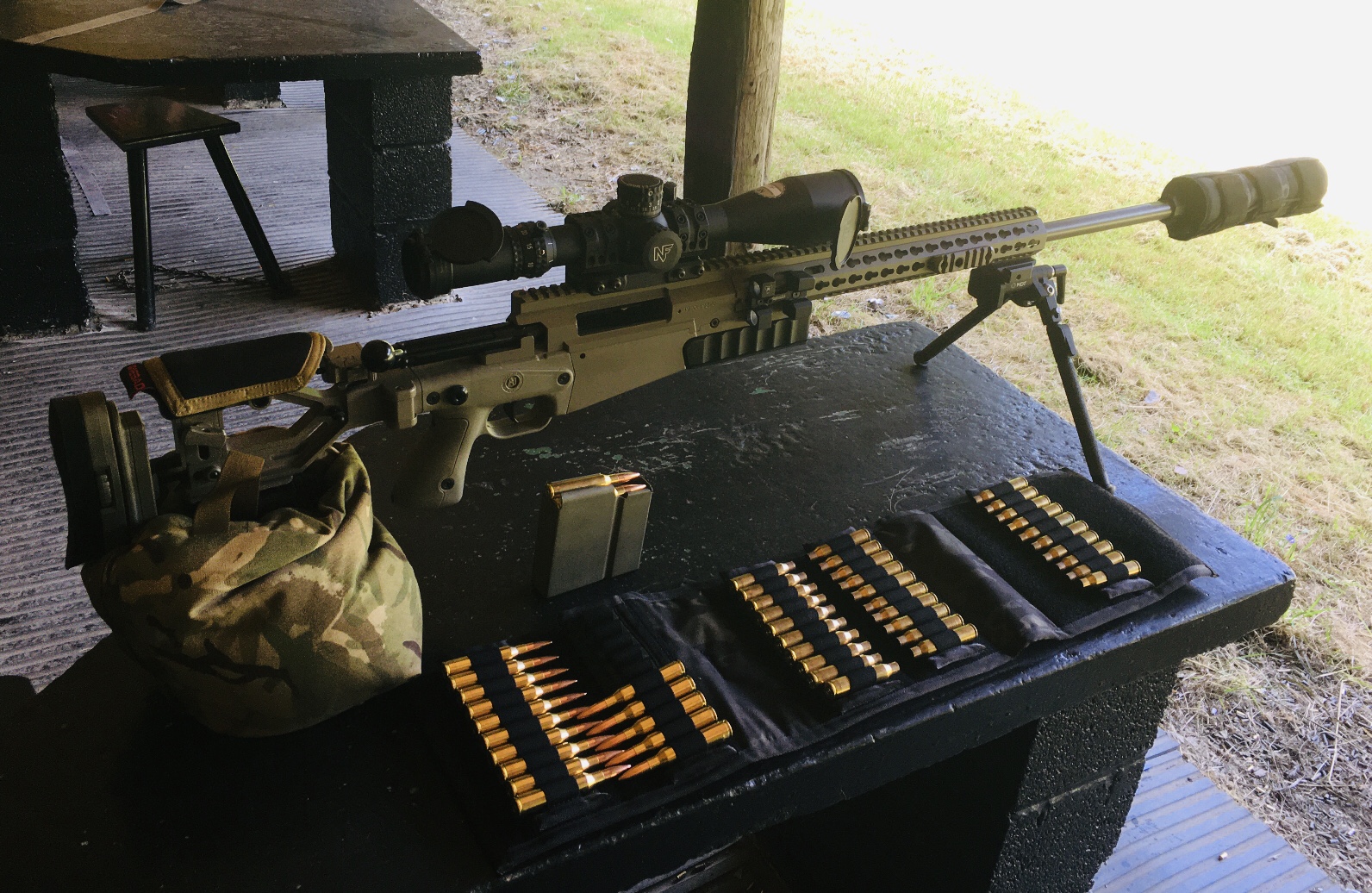

@Palmetto-Pride Nope
@Georgedubya It's a 4602 (20moa, ASR also has 20moa). I try to maximize the can't I can use on TT's to get as much external elevation I can get while still being able to zero at 100y, regardless of cartridge/ caliber. But not enough to cause an oval effect in using too much can't.
Super helpful and informative sir. You think 30 MOA of cant would be too much (50 total with the integral rail).

@Georgedubya I’m not as awesome as nolegs24 but I think 50 is too much. Mile high did 20 and 20 for a total of 40 on their demo set up.
what rifle have you got? ASR, AXSR, AIAX are all 20 MOA and the AXMC is 30 MOA in the rail.
I don’t have an AXSR yet but am about to buy one. I use 40 MOA of cant on my desert tech rifles, but haven’t pushed them to more than a mile and frankly haven’t needed it (7-35 ATACRs on em). Always curious. Will likely go with the 20 additional moa, as suggested.
With the TT you can only go 40 moa total. 50moa is too much with only 28 mils in the scope. The NF 7-35 and ZCO you can go 50moa and be fine. May be able to get away with a 60moa total pending your rifle and specific scope. I had a 7-35 with 60moa base/mount and still had 100yard zero.
I’m going to go 50 I think just because I like to play around with different calibers. But I think you could probably squeeze 60.

I wonder if you could get away with using the SP-4602 with 6 MIL instead of the SP-4302 with 3 MIL.
The TT525P has 30 MIL of internal adjustment, 28 MIL on the turrets.
Reasoning that the 30 MOA rail (8.7 MIL) + 20.6 MOA mount (6 MIL) would give you dead-on at the zero with 50,6 MOA /14.7 MIL.
Reasoning that the 30 MOA rail (8.89 MIL) + 20,6 MOA mount (6.00 MIL) would give you dead-on at the zero with 50,6 MOA /14.89 MIL.
Yea in a perfect world with everything working out...you would have 1 click left over but that shit doesn't always happen. Nobody knows how your barrel or load combo will shoot.
Nobody will know exactly where there barrel will release the bullet in relationship to the muzzle harmonics/whip. There are a ton of factors such as the what the muzzle brake will do to the zero or with a supressor on the end.

You could get lucky with your setup and have it work. Most likely it won't. And personally I wouldn't want to have the erector bottomed all the way out when shooting at 100. Just hold a few mils if needed instead for the few times your shooting and need more then 28 mils. And then buy a Charlie tarac if your needing more.
