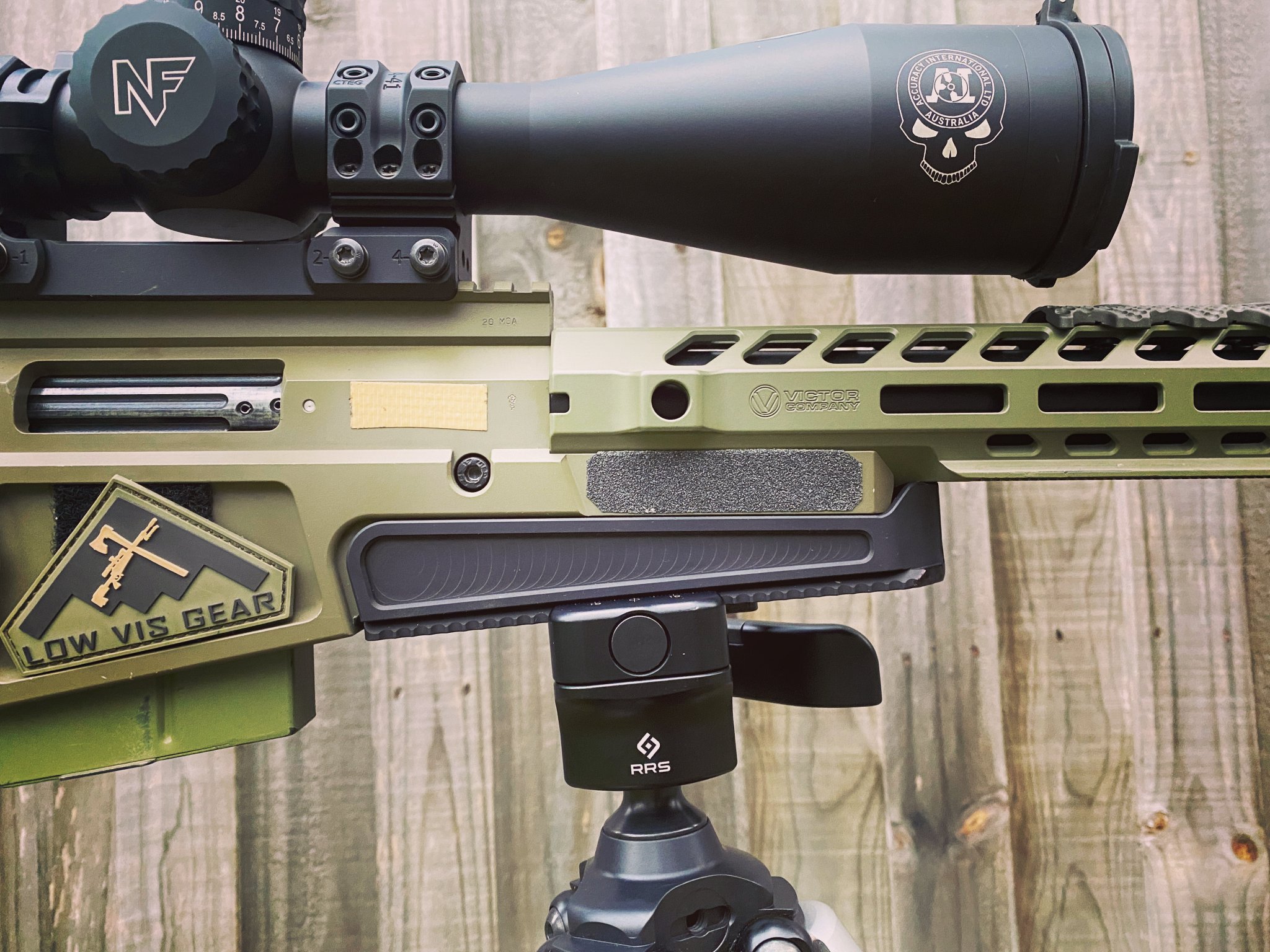

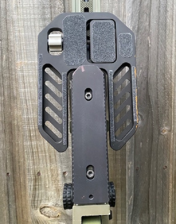

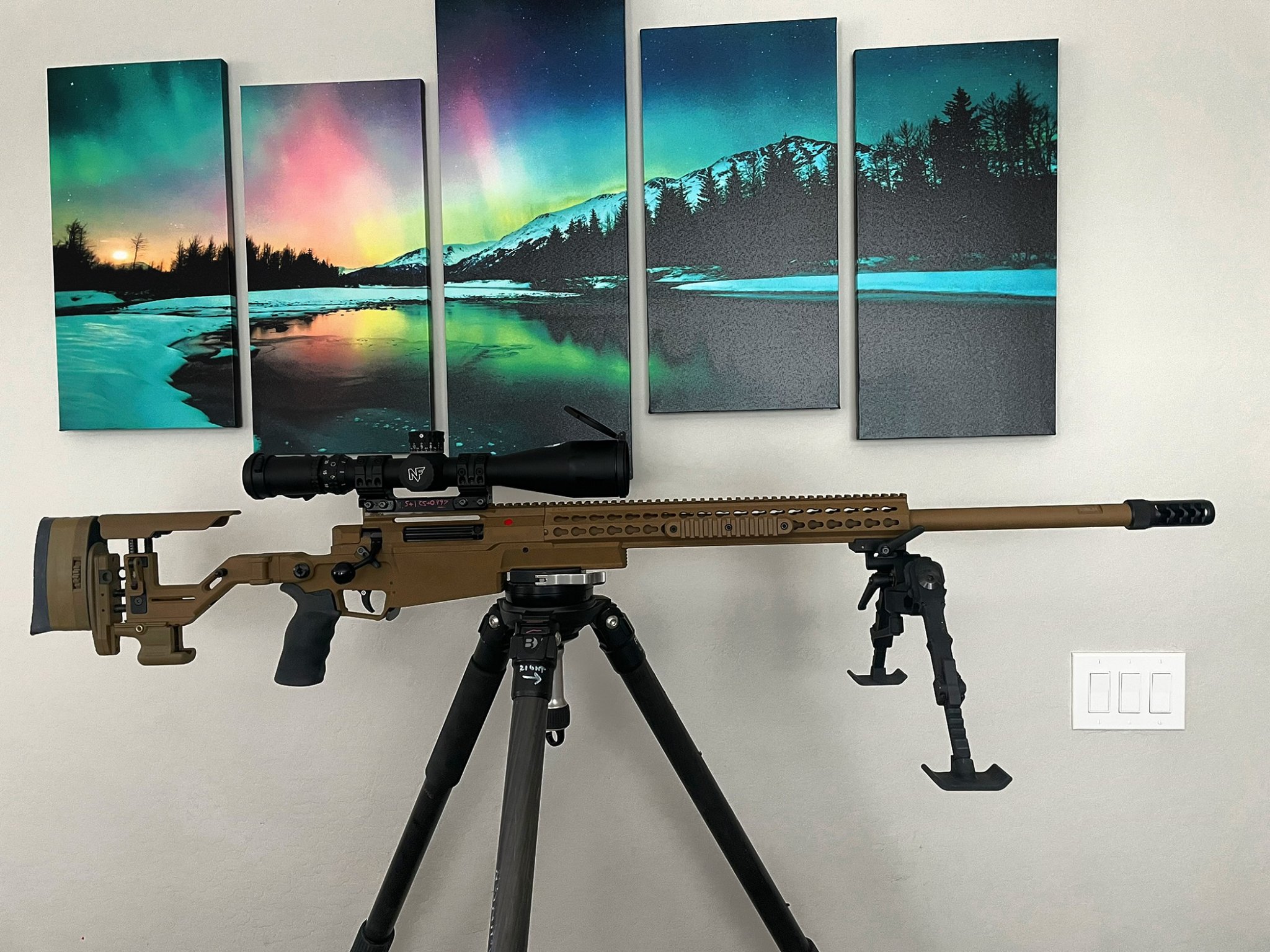

I cut an Area419 rail in half for my AX last night, the lowest profile fore end hand grip plate, while still being wide and having the aggressive edges for traction... This feels like a good combo.

Area419 Arcalock rail mod, cut in half. Lower profile than the RRS, wider and flatter than the factory plastic grip, more stable than nothing... So far, this is my pick of the bunch.
You beat me to it. I bought one planning to do the same exact thing. The only thing slowing me down is the fact that the rail wasn't machined enough and doesn't seat fully as I'm sure you can tell by the 1/8" gap near the back. Really pisses me off as I will have to machine and dremel a bit to get a seamless interface. Did you chuck it up in a mill to clean up the face after the chop? Looks gorgeous by the way.
You're right, it doesn't sit very well at the action end... There is quite a gap like you said.
To be honest; I threw it in the vice, eyeballed it, marked with a sharpie then used a hacksaw. Fine cut off grinding wheel on the Dremel to snip the corners back then a couple of the varying grit sanding wheels to smooth it off and radius the edges. I don't own a mill or band saw. It's definitely not perfect but it'll get beaten up on rocks / barricades / etc. anyway so not overly concerned.
This was never meant to be perfect (as you can see by the sharpie camouflage :ROFLMAO:), it's a team gun that gets used a lot.
I think you should do it, seems to be a good end product.
I asked them about doing a short version and was pretty much told there wasn't demand and that I should be excited about the long version. I waited till they went on sale and said f'it , I'm going to hack saw the thing. RRS makes one cheap but looks like a brick bolted on the thing and you lose the ergonomic angle for shooting offhand. Hopefully I can get around to cutting and fitting in the next couple weeks.
That’s funny, because I would think there would be more demand for a shorter version, like what RRS offers, than the long awkward angle full length rail that Area419 offers
