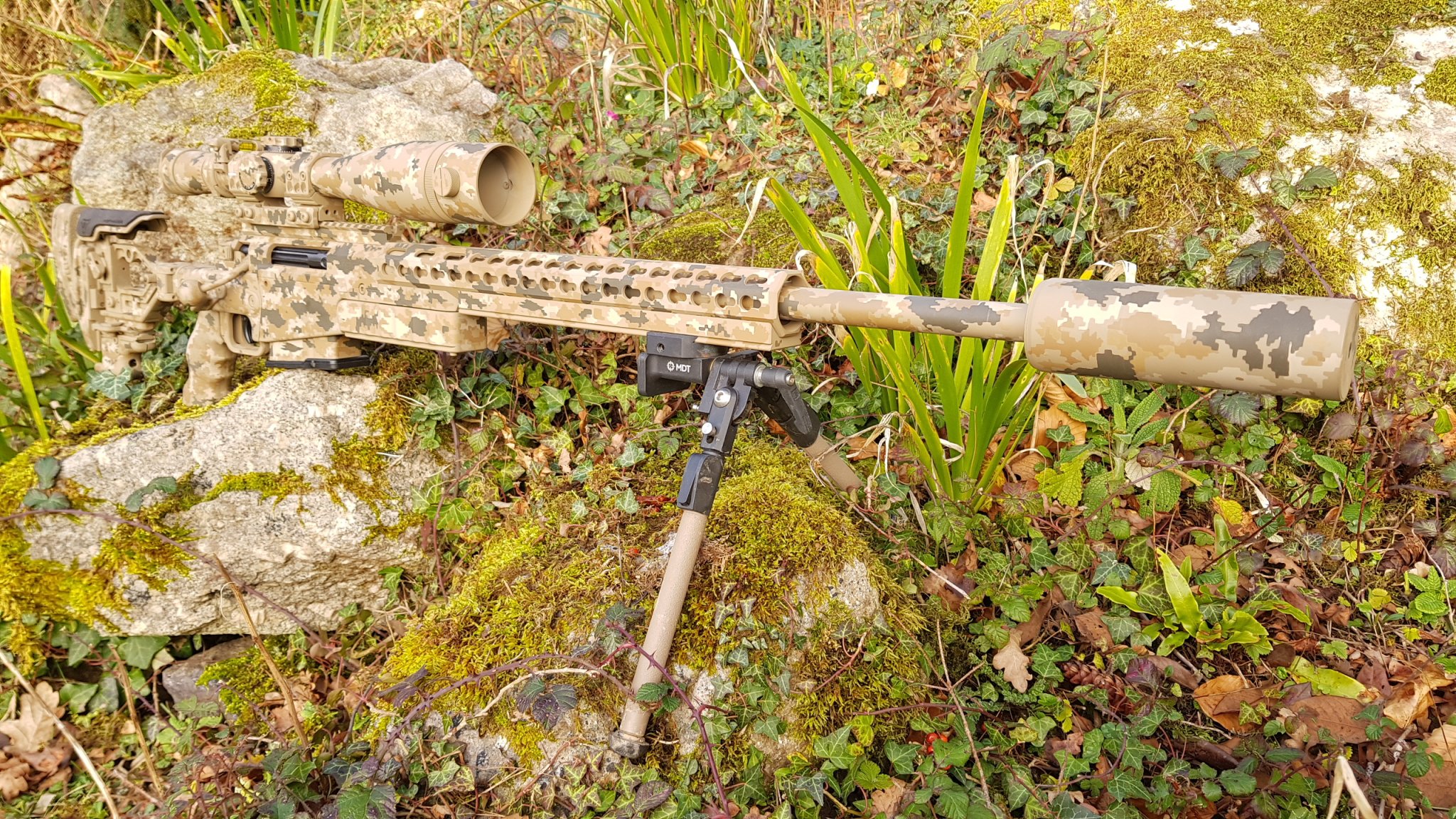

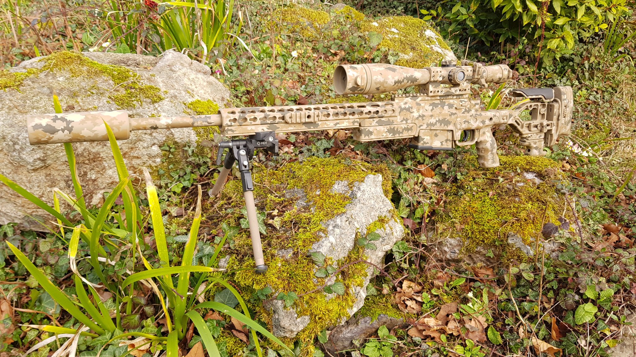

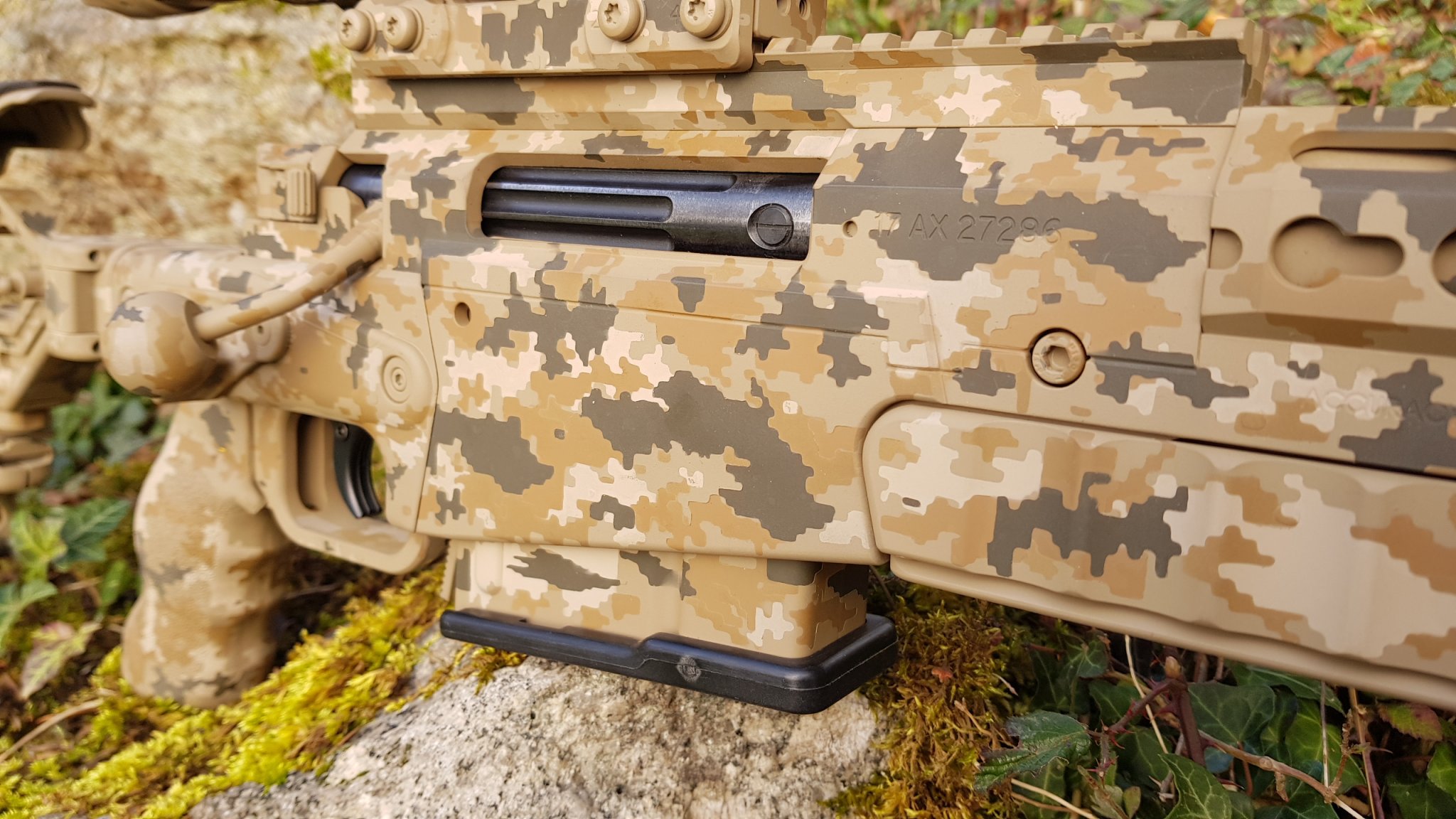

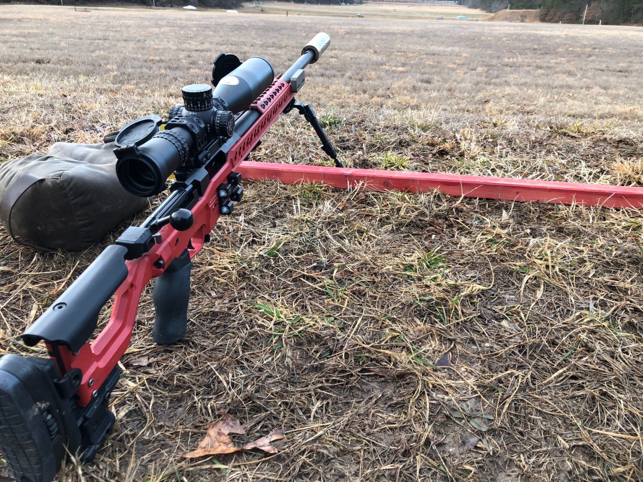

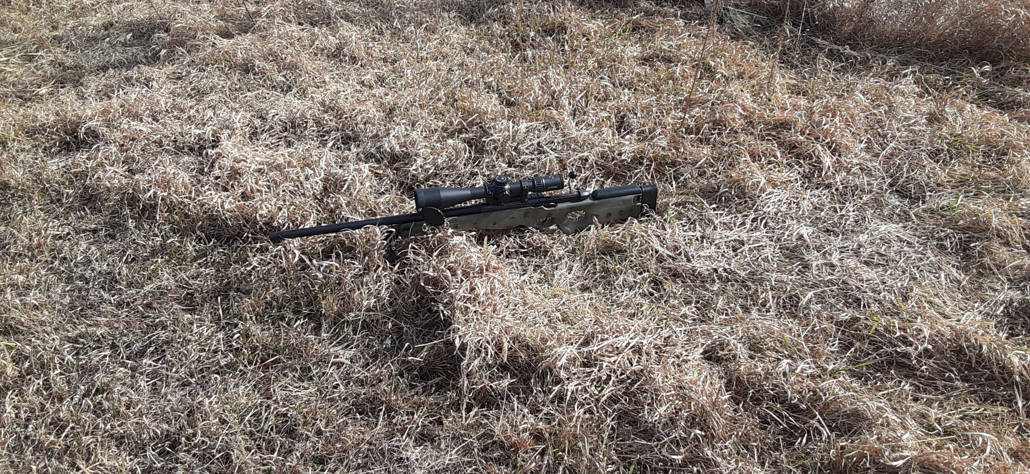

Well it was time for the yearly AI AXMC rifle colour change.
I thought something different, 5 colour Digital camo.
I did not think it would take 36 hours!
Full strip down, degrease, blast and then the layers of Cerakote H Series.
Over 1600, yes 1600 individual stencils applied, that alone took 3 hours.
2 hours to take them all off, then the reassemble.
The rifle, 3 barrels, 2 Moderators, Scope, Spur mount, Arca rails, 4 magazines and other bits.
Glad I only get bored once a year!
Glad I only get bored once a year!View attachment 7564681View attachment 7564683View attachment 7564685
Did you debond the action?

Wow, that really blends into that rock on the first photo. Great job!

No did not debond, we have done a few now and experimented with one ages ago, 100 degrees C and it did not melt the epoxy.
What's your normal temp then for doing the action with H cerakote I'm seriously considering having mine recoated but it hammers and dont want to debond her.
What temp did you run the plastics?
I do the AI actions at 95 degrees Celsius, Plastics at 70 degrees C, Scopes at 60 degrees C, Normal Metal at 120 degrees C.

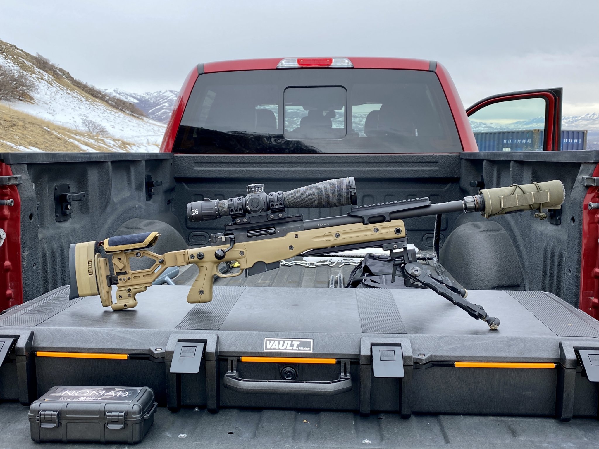

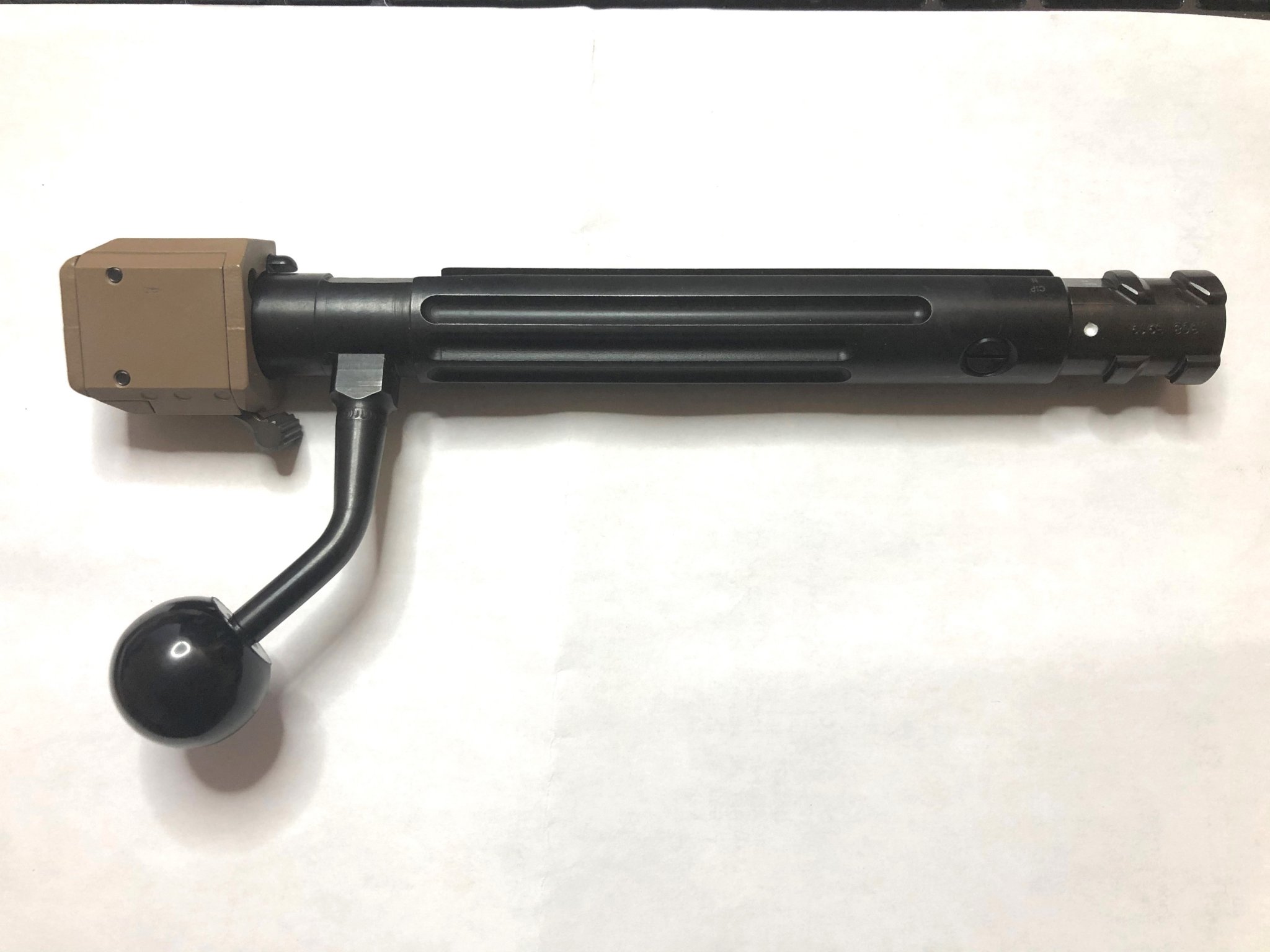

I found a "used" SFP AI AXMC .308 complete bolt assembly (in dark earth no less) at EO at a killer price and with mil discount. It arrived today and it's never seen a round. Sometimes you just luck into something. :)
Now I can ditch that adapter thing, thing, thing and the LFP 308 body!

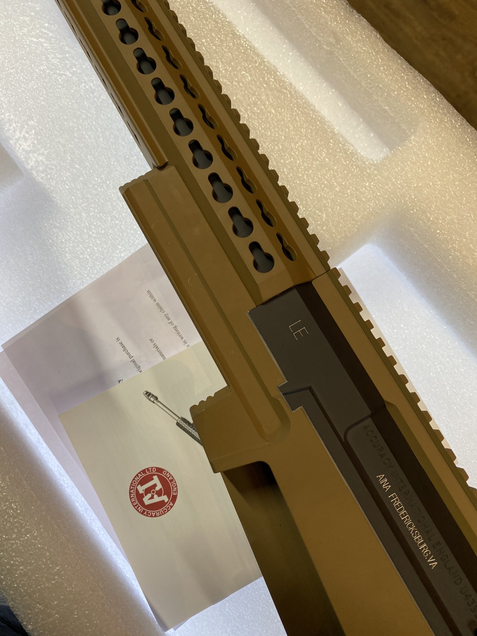

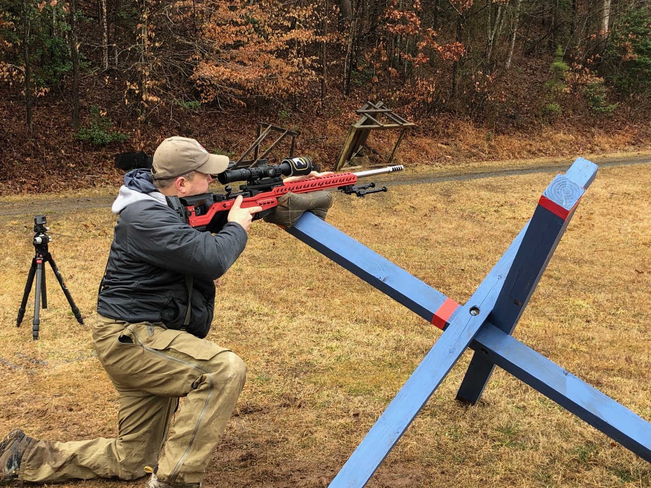

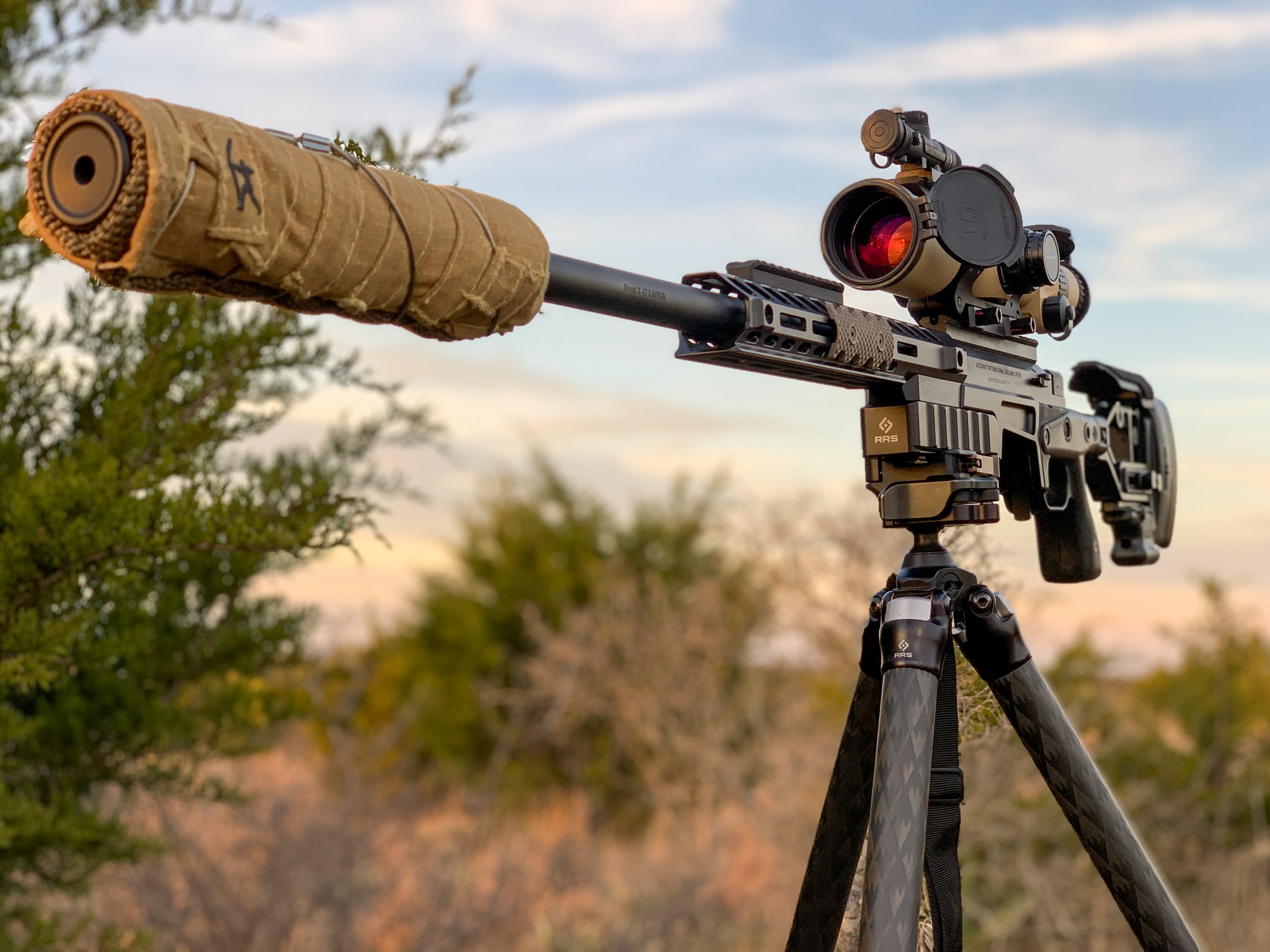

Humble addition.

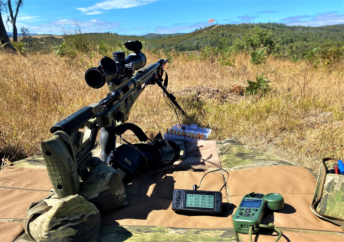

AI AE MKII in its natural habitat.

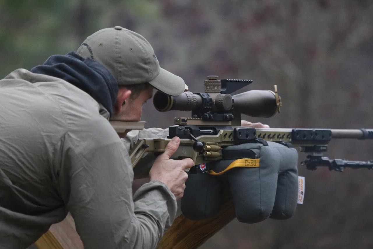

Ran an interesting drill. 200 yard run followed by a 1st round hit on a 2inch x 2 inch square. Time was 3 mins.
We got it in 1.5min.
Changes for next time will be must carry the rifle on the run part. And maybe add a barricade. We were shooting prone today

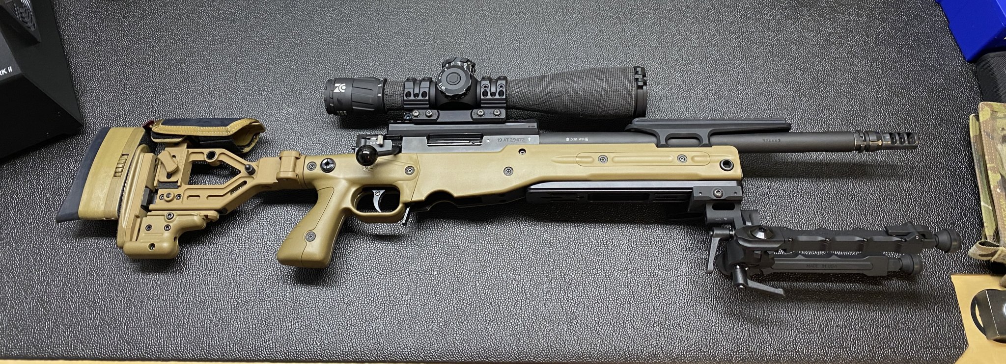

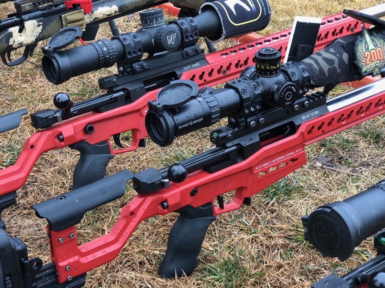

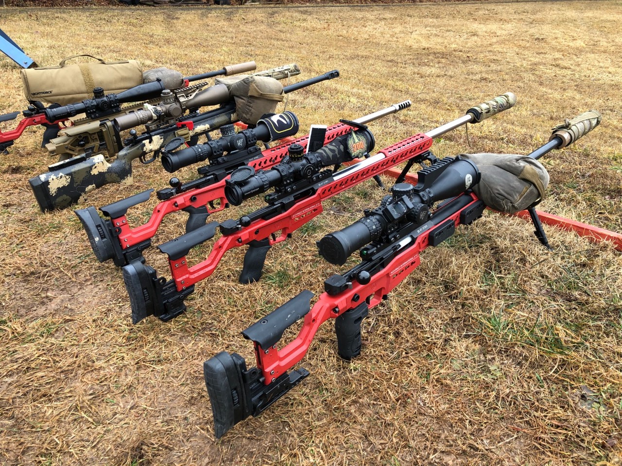

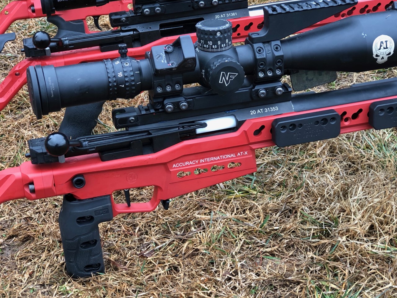

I'm going to venture into no man's land and comment FWIW as a non-competitor, but I've owned 2 ATs and have an AX. I had the chance to briefly shoot the AX in 6 Dasher at Quantico Saturday, it was incredibly smooth (as is any AI action), but it felt lighter to me when cycling. The 6 Dasher had very little recoil and I was easily able to stay on target and watch the trace, hits and misses at 756y. Ergo was fantastic, even though I was shooting the bosses setup and glass. I only shot a mag, but it's motivating me to get off my old ass and become a PRS competitor. :)
My understanding is the pre-order AXs will be in 6.5CM, so if you want to shoot, for example, a 6mm, you'll be putting more cash up for a barrel and mags inserts. The team were using delrin inserts and different springs and followers for the 6mm rounds in a regular AI mag. They did say they will release different caliber mags (akin to the AX mag recently released for the 308 bolt face), but for now, you may be limited to 6.5CM.
Pics of the AX I shot. Gratuitous video of the match winner also included.
