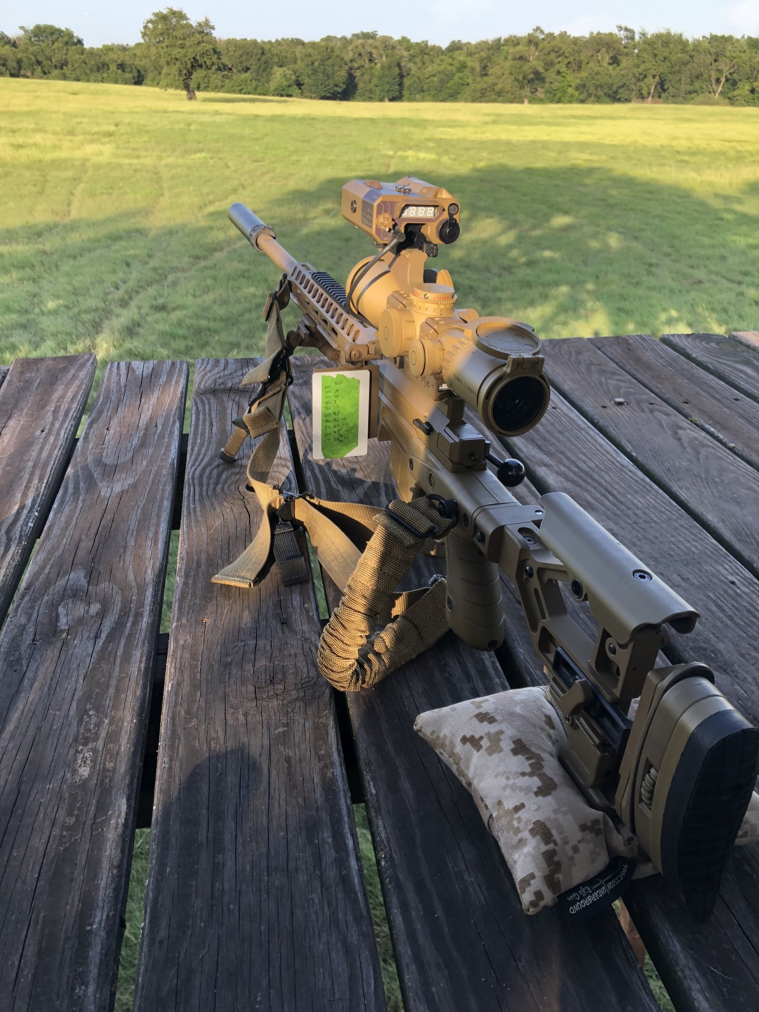

My son’s AI… forgot if I posted this here yet.
Does this count?
#BallinFruitSnacksAndShotCallinJuiceBoxes
#MOAAllDay
#ACrispHundoOnEvike
#GetRektedPoorz
#HesFiveSoThreeShotGroupsCountYouFucks
#ThisWeekendIsUrbanHideTrainingSoTheGestapoDontComeKnockin

Can you headshot the doll next time? :)
TLDR: Guy I helped gave it to me as a gift for solving his position and technique problems.
Okay, so I usually end up "mentoring" people at the range. No, I ain't no Frank, but I have a lot of spare time as shooting the PRC at 1,000 on a known distance, square range is like cheating. I was working off and on with a guy for a couple of weeks who was shooting handloads in 6.5 RPR, and not having any consistency; I finally told him, "it's not the gun." The next week I stayed with him for several hours and went through everything from bipod height, to eye box, natural point of aim, shoulder pocket, etc., etc. By the end of the session he had good DOPE and consecutive hits on target at 1,000, he was ecstatic. I then put him behind the PRC and he was blown away by the AI's form, fit and function. Anyways, a few weeks later he shows up with a new AI and he gave me the bag tag for being patient with him and helping (he's a Star Wars geek and saw my Mando mag), oh, and it ain't no doll ;). He has a NF on order, but apparently LE orders are 9 weeks out.
