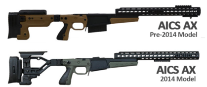

Could someone share a rundown on the differences between the pre and post 2014 AICS AX chassis? I’m about to purchase one for my Zeus and want to make sure I’m getting the 2 screw forend version (post 2014?).
Black is pre 14, tan is post 14

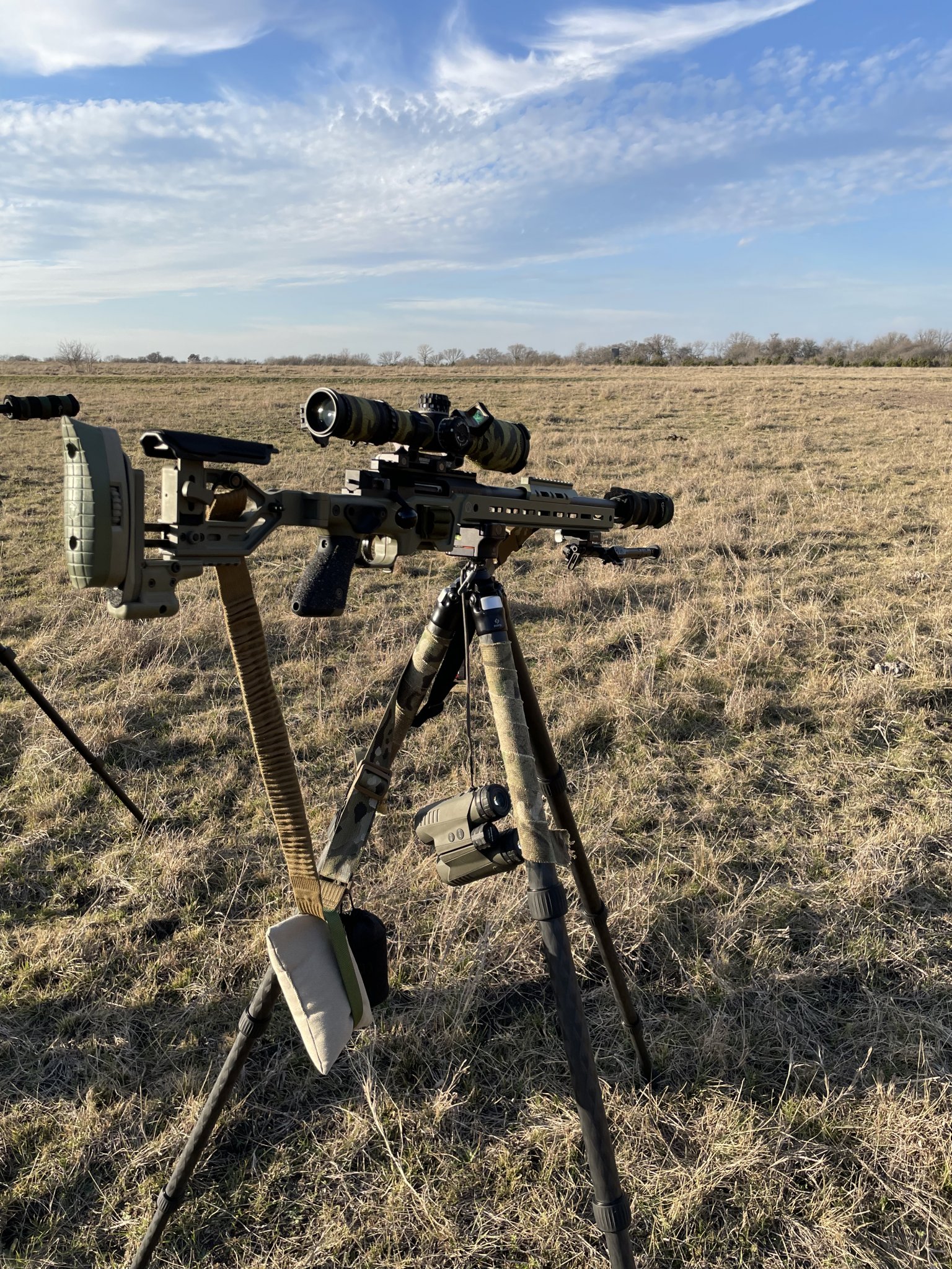

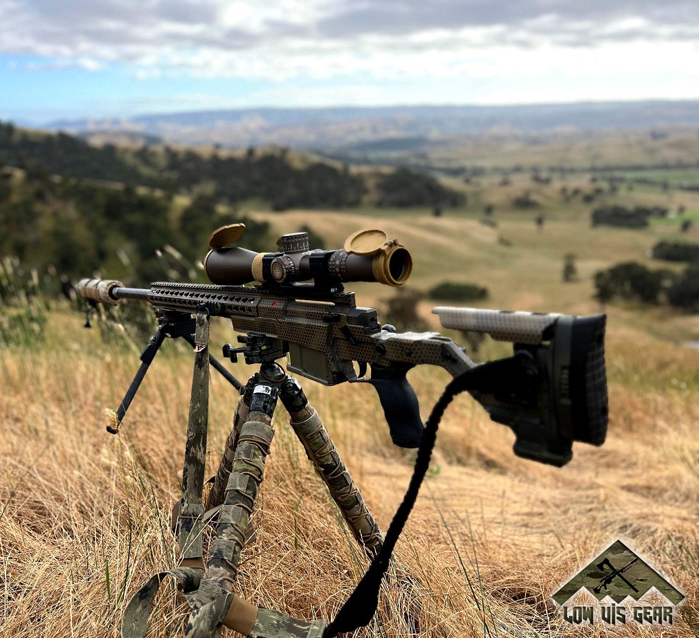

What tripod sling/cover is that?
Full length rail is on the way. Hoptics 2rnd holder and pad are here. Won’t be able to get home till mlk weekend tho 😭
96C’s products, exceptional quality gear made in Australia.

L96’s products, exceptional quality gear made in Australia.
Quality is an understatement, they are unreal. Even his hats are bloody durable, I have about 4 of them.
AICS AX Chassis
PRE 2014:
8 or 10 small screws hold the fore end rail to the receiver part of the chassis.
Rounder, plastic skinned rear stock section, same as the current AT rifle.
POST 2014:
Newer, throw lever style rear end, same as the AX / AXMC.
2 bolts holding the fore end rail to the rear half of the chassis
Can use the Victor Company Hammer fore end rail with inbuilt Arca.
Reactions: Screach and Sleeman

AICS AX Chassis
PRE 2014:
POST 2014:
Thank you much!

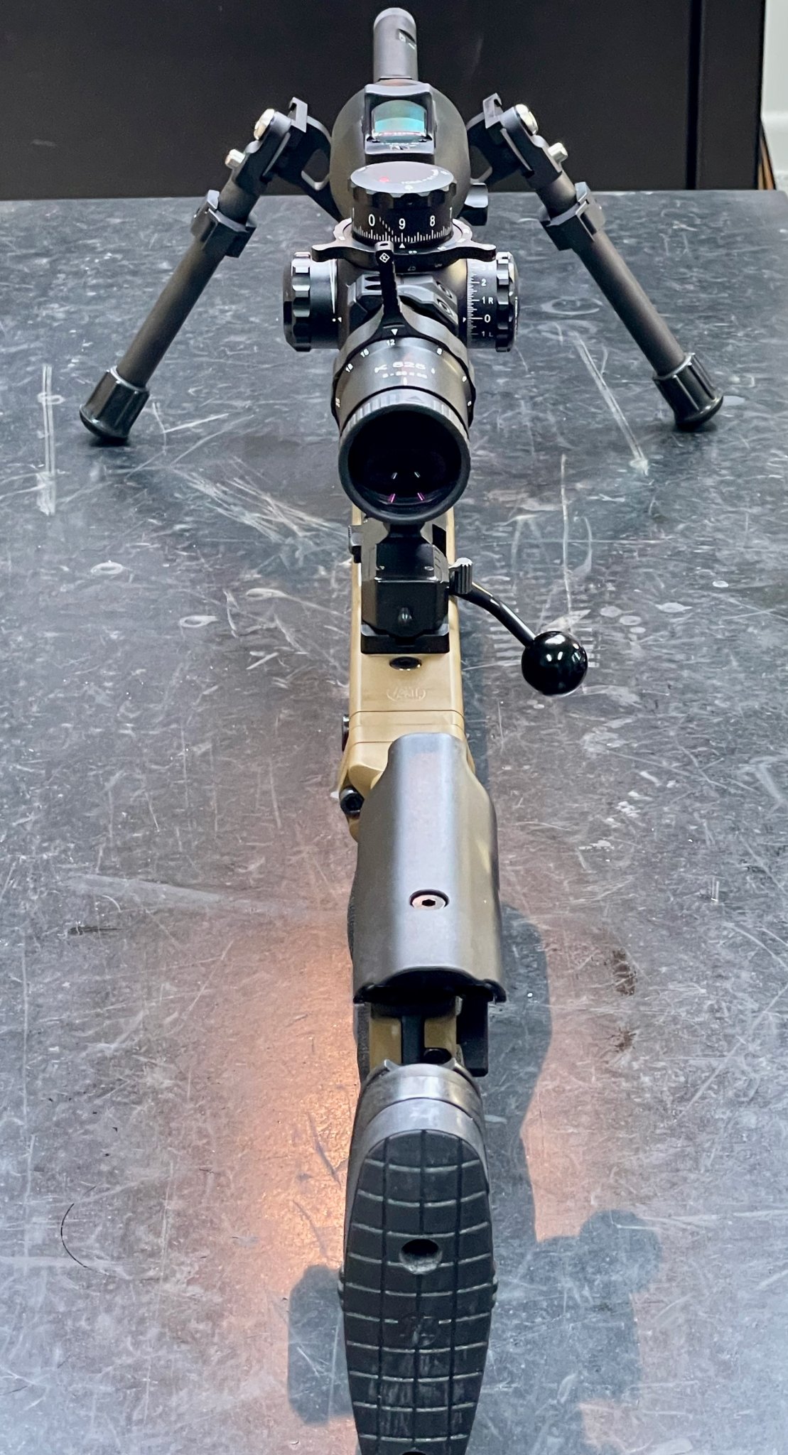

All put together. Including the Ultra 7 in 6.5, absolutely love that can.
Anyone know where I can get longer screws for the butt-spacers? It came with extra spacers but not with screws long enough to make use of them. I got long-ass arms and need one or two more spacers.
I gotta get better at talking pictures, my photo skills are not cutting it for this thread 😂.
View attachment 8041367View attachment 8041368
Ace hardware
