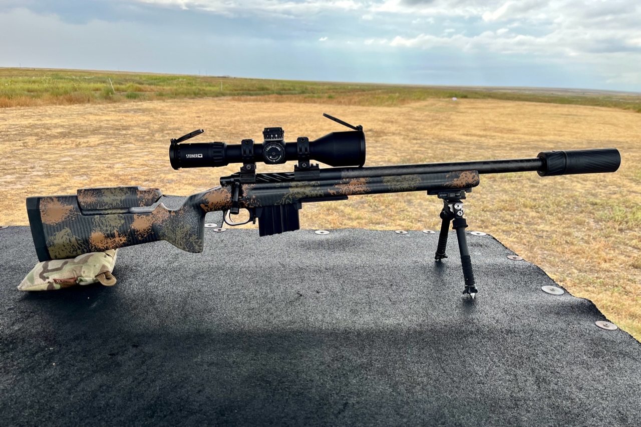

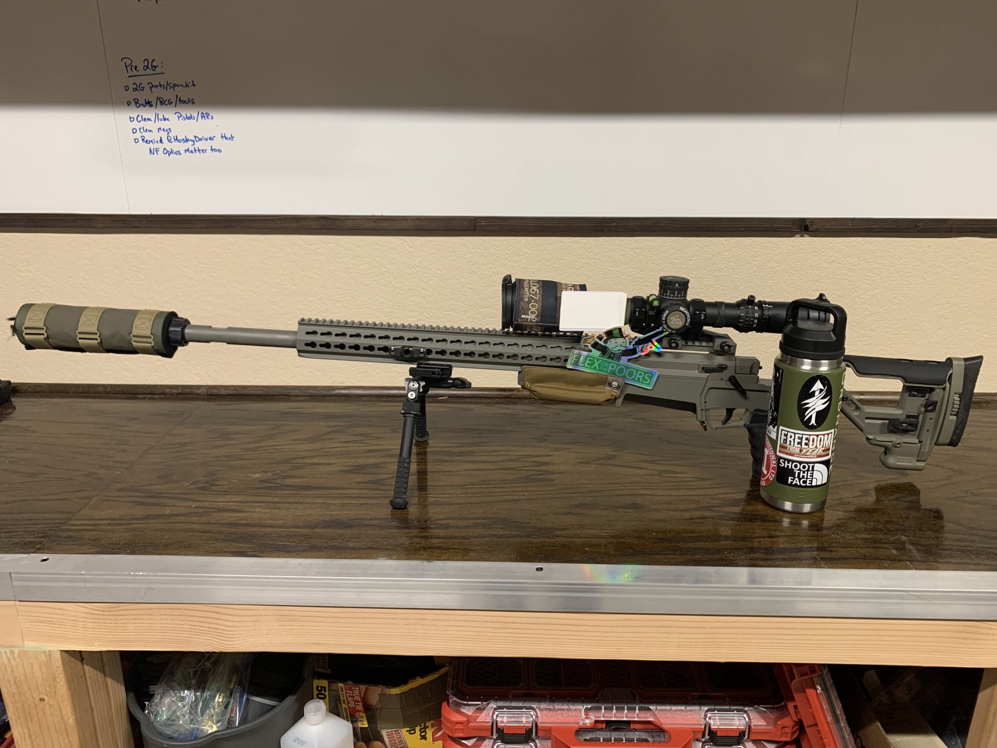

Some upgrades occurred:
No more Vortex. Now have a T6 Steiner in an MBRACE
Elite Iron spigot (they are awesome to deal with)
Atlas bipod
Armageddon sling
20” Bartlein (still have to add the brake for the can)

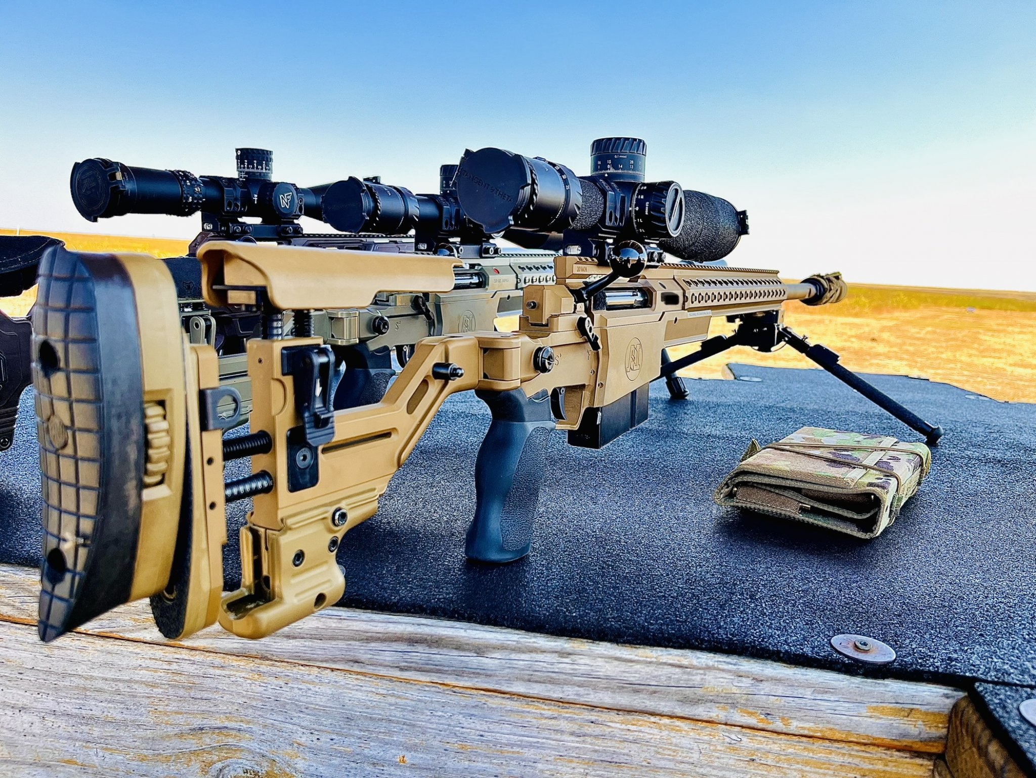

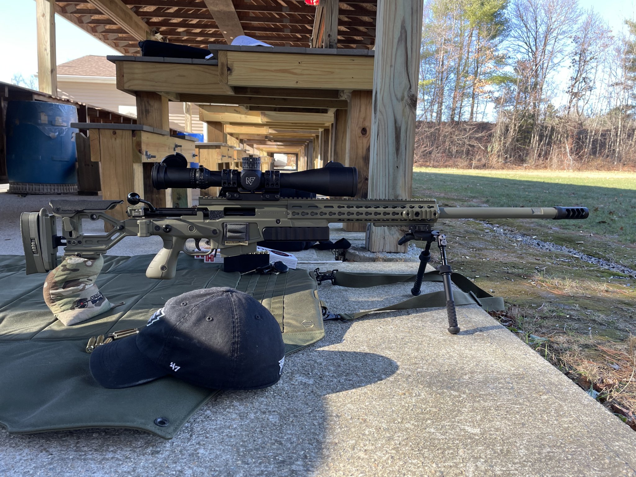

Have wanted an AI since I was a kid.
Finally just took the leap and sold my TL3/Manners setup and got one.
Got a 6.5 creed ATX, had Hunts Long Range chop the 6.5 barrel to 16" and spin a 26" Dasher up for it.
Only have 140rds or so down the 6.5 before the chop at a match, and excited to see how it performs compared to my old custom setup.
I was honestly really impressed with the new comp trigger, even coming from a Triggertech Diamond.

16” 6.5 looks awesome. Might have to chop my spare 6.5X47 barrel 😍

What bag rider is that?

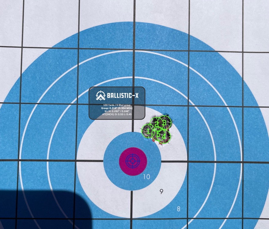

I was wondering if you all could give me opinions of accuracy expectations of 6.5.
I bought a 26” 6.5 Bartlein barrel for my AXSA from EuroOptic and it’s the most frustratingly inconsistent barrel. After 250 rounds of chasing different ammo types I’m lost.
I will say up front I do not reload. One of the reasons I bought the 6.5 was due to large ammount of factory match ammo available.
The gun hates anything that is not Hornady. 140 gr FGMM 1-2 moa, 130 gr bergers 2 moa at best. 140 gr bergers 1-1.5 moa.
With Hornady 140 eldms I will get one group that measures in the .2’s, and then I can’t get anything better than 1 moa. With 147’s I’m consistently under moa, but barely, but every once in a while it will give me a tight little group just to keep me chasing.
With Norma match sometimes it will group better than the hornady, but then some days it’s opens up.
Yes the scope is tight, yes the gun is good…with the 20” 308 barrel it’s a tack driver. Yes the barrel is tight and properly torqued. I was hoping for the same results out of the 6.5 as I get out of the 308 barrel, as it’s a little easier on the shoulder and a lotta more fun for everyone in my family to shoot it. The barrel does have a 419 hellfire match on the end.
Am I just getting what’s expected out of a 26” Bartlein in 6.5 with factory ammo, or should I call Bartlein and send it in for a look, I never thought an AI, in 6.5 would be one of the most frustrating rifles I would shoot.
Pics of the gun and groups. Again you will see a tight one, and then many of what is common.

Take the brake off and reshoot it. I highly doubt it's the barrel since at least one of the ammo you chose shoots well. For some reason or another some barrels and brake combos aren't compatible. My previous 6.5 barrel didn't like the APA Gen 2 brake. Took it off and put on a can and it shot lights out. My current 300NM barrel didn't like the Keymo mounting system and went direct thread with the suppressor and it shot fine. And oddly enough, it shoots lights out with a Gen 2 FatBastard. My friend had the same thing happen to him too with another brake and suppressor setup.

Pull that brake off
Been reports of that 419 causing accuracy issues on another AI barrel. Was in a recent post just don’t remember what one
The one thing I have not done is shot it without the brake.
I’ll give it a try. God damn frustrating…..

It is a head scratcher.
I assume that the barrel is a conventional 8 twist? Both my AT and MC use the same Area 419 brake on Bartlein barrels and shoot consistent 0.5 MOA 5 shot with the 140 ELD-M ammo from Hornady. I get even better performance with FGMM with the 130 grain Berger bullet.
I would check torque on the barrel clamp with a torque wrench to ensure it is correct. As others said, try it w/o the brake to see if it improves. I would also try the FGMM 130 and see if your results improve.
Reactions: Bacarrat
Correct 1:8 twist.
Tried the 130 grainers FGMM and it hated them, which sucks because that was the load I was hoping it was going to love.
Barrel clamp is torqued down, checked it with fix it sticks multiple times.
I’m going to pull the Brake and try it again. That’s the one thing I haven’t done.
I hope that’s all it is.
My 308 barrel has a 419 match, and like I said it drives tacks, so I figured the formula would work again on the 6.5…but from others mentioning that may not be the case.
Obviously something is wrong. But you know that
My AXMC 6.5 barrel was a 26” 8 twist. I only fired 15 rounds with 142 smk. 3 out of 4 (3 shot) groups were under 1/2 moa. Best being .26”. Those win tac Bartlein generally aren’t picky
After you remove the brake inspect the crown on the muzzle as well. There was a factory AXSR a while back that had a bad crown from factory
The cross bolt is another thing too that would cause weird issues. But as I have found out, it would be more of all the groups shot like shit with it not torqued down all the way. Wasted a whole range session because I forgot to tighten it down all the way. Also some guns like it at different torque. I think most people run it at the AI spec at 45 inch lb and there are others that run it at 55-60 inch lbs. My AXMC is in the ladder camp when my other friend with a ASR his liked it at 45. He learned that lesson too.
Reactions: Huskydriver
I’ve played with the cross bolt. Started at 49 in/lb per spec, and then went to 55 to try it out. It made no difference in consistency. After reading the other posts…I’m definitely leaning towards the brake is the issue…which sucks because I love it’s individual performance.
I run it at 62 inch pounds based on things I have read here
