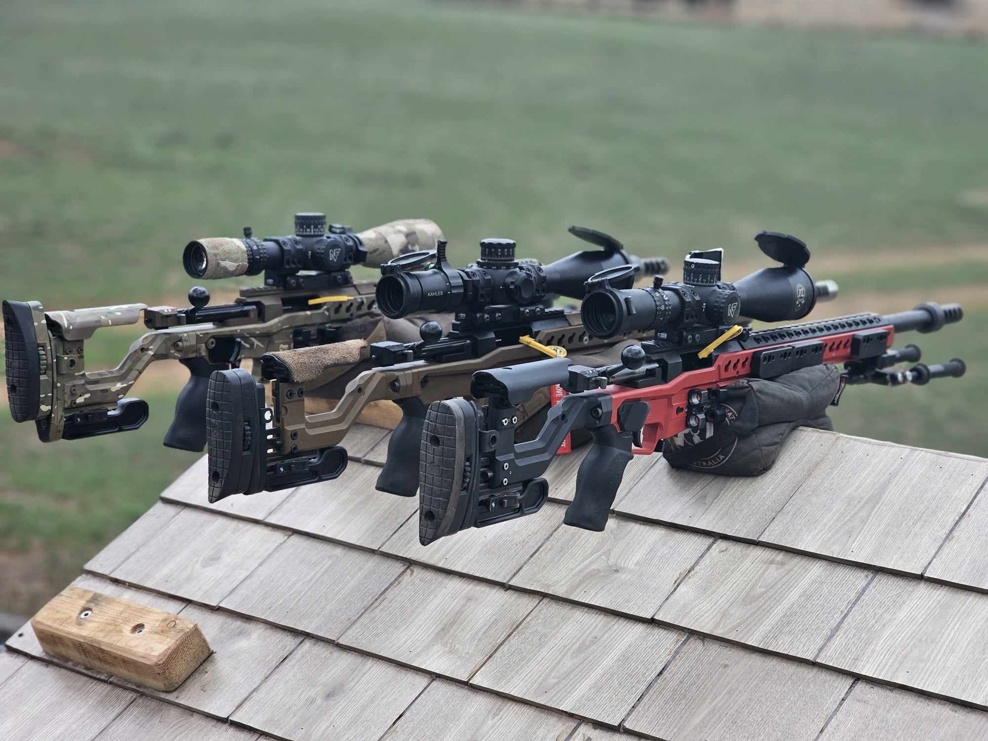

A decent showing of AT-X's in our club. Interestingly, all three of us finished the season in the top 10 with the owner of the red one actually winning the season.

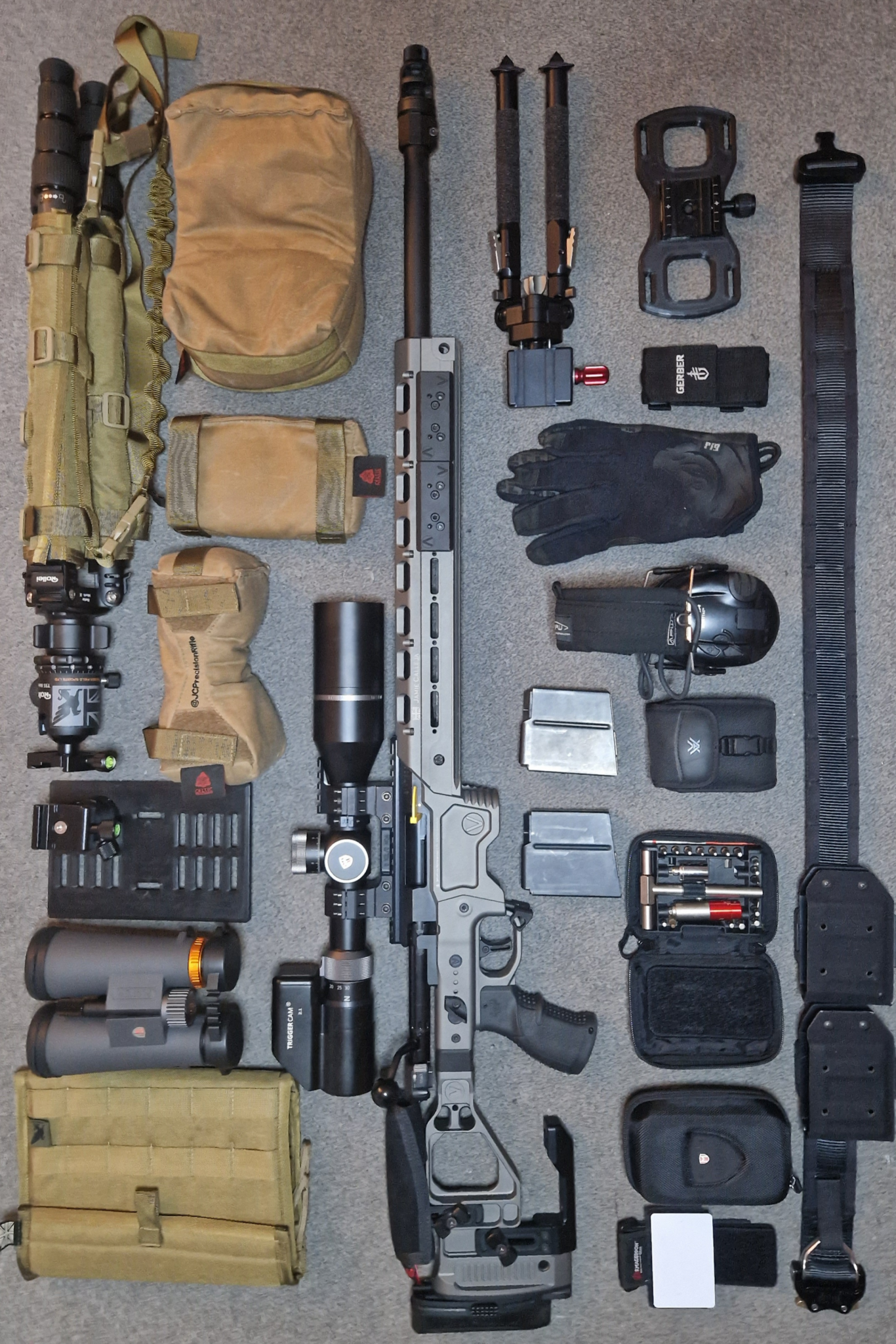

Getting my kit sorted for this weekends match. Will be my last of the year and I'm feeling like it's all going to come together![]()

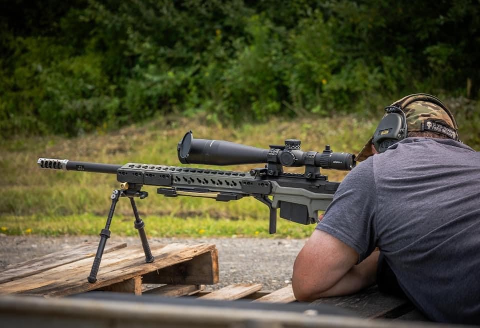

Curious to hear your thoughts on the ELR bipod vs the ATACView attachment 8284451

ELR is obviously more competition focused than the ATAC. It's good. Tightening enough to lock out all the cant can be difficult but not as bad as on the ATAC. Certainly a good option if you can justify the extra few hundred for a Ckyepod. I've got a Gen 1 ELR. I'm working on getting the newest Gen to try that.Curious to hear your thoughts on the ELR bipod vs the ATAC

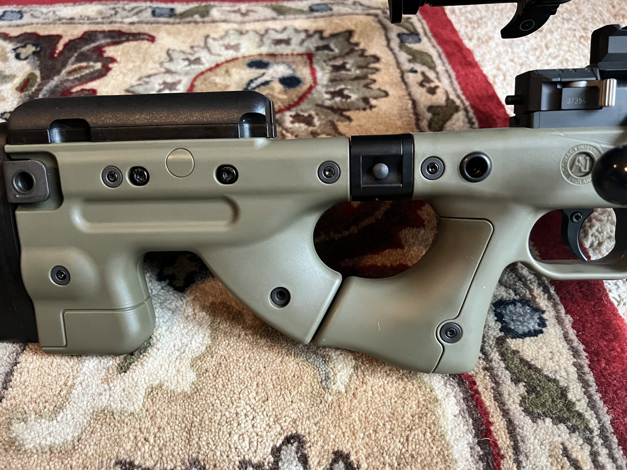

How do you like the plate? Been kicking around the idea of one for bag work, but the extra width doesn’t seem appealing. Then again, I double stacked ATX weights, so I’m already longitudinally compromised.I HAVE ONE IN 6.5 CREEDMOORE ATX
i use the plate a lot on barricades when i'm not using the bipod. the plate works great because i can attached my bag right to it.How do you like the plate? Been kicking around the idea of one for bag work, but the extra width doesn’t seem appealing. Then again, I double stacked ATX weights, so I’m already longitudinally compromised.
it has its places. Has always been appealing to me so got one after getting smoked on a bus stage. Otherwise I still prefer them separate under most circumstancesi use the plate a lot on barricades when i'm not using the bipod. the plate works great because i can attached my bag right to it.
i also got screwed up on a bus stage they had the windows partial closed . i shouldn't have used it or ditched it when i saw the windows. No one was allowed on the bus before the stage.it has its places. Has always been appealing to me so got one after getting smoked on a bus stage. Otherwise I still prefer them separate under most circumstances

I was curious because I had an ELR that, in messing with it, just didn't really jive with the way I use a bipod for PRS. I've sent it back and been considering an ATAC instead. Definitely appreciate the info!Never! Still a few things I "need"

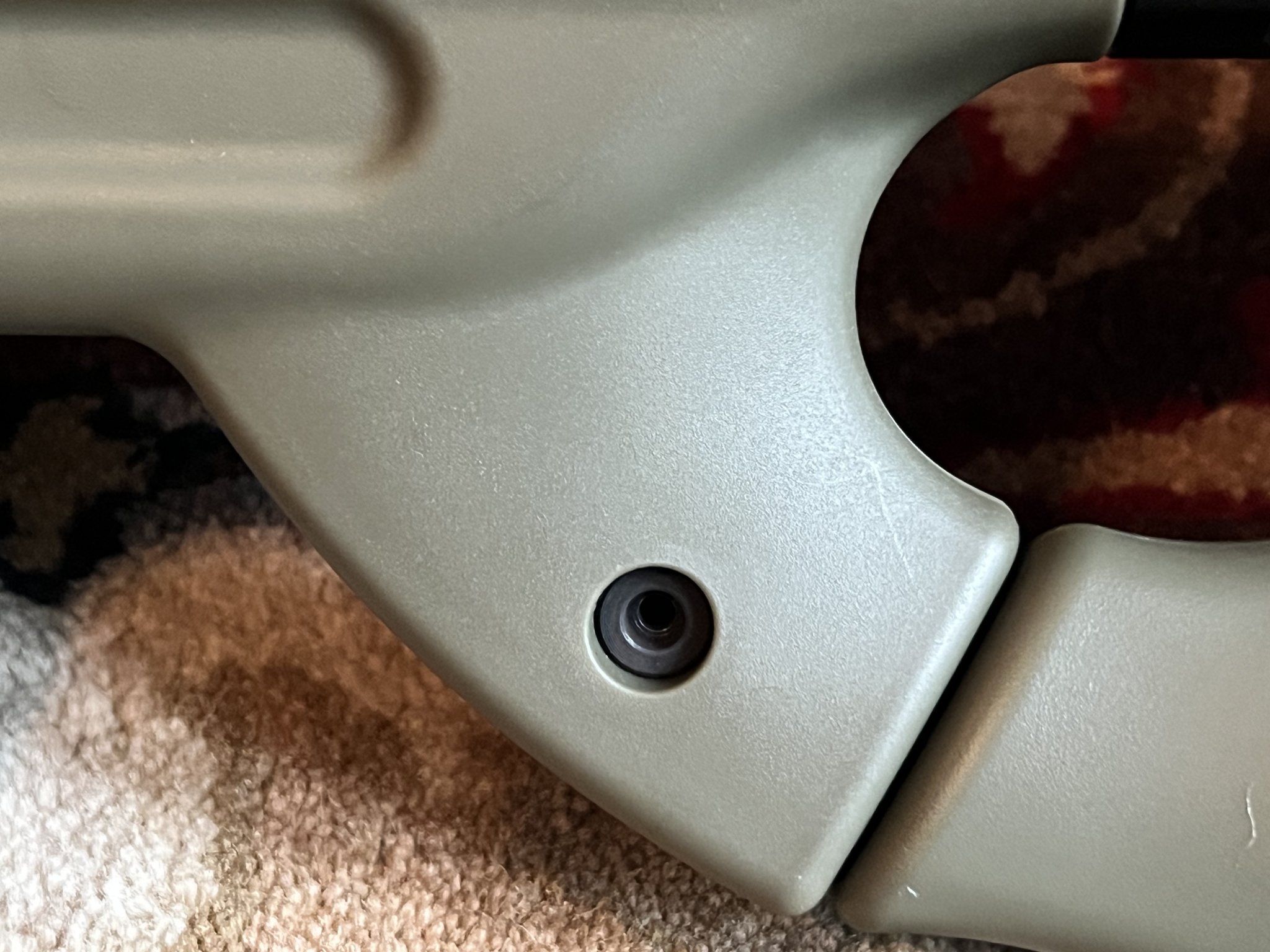

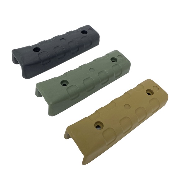

Call MileHighI was just putting together my new AI AT and I was installing the thumbhole stock and I think one of the screws is missing and maybe the washer. Does anyone know the specs on the screw and confirm that the washer is missing? I bought it from sporting services in the UK some years ago. Who would I need to contact for the screw and possible washer? Any help would be appreciated. Thank you
View attachment 8286556View attachment 8286558
As noted above. Call mile highAny one knows what's the spec of the forend grip screw of AX? I'm so dumb that I lost both of them in abyss during disassembly. Now I have to find a replacement for them. Did some search on the internet and no luck.
