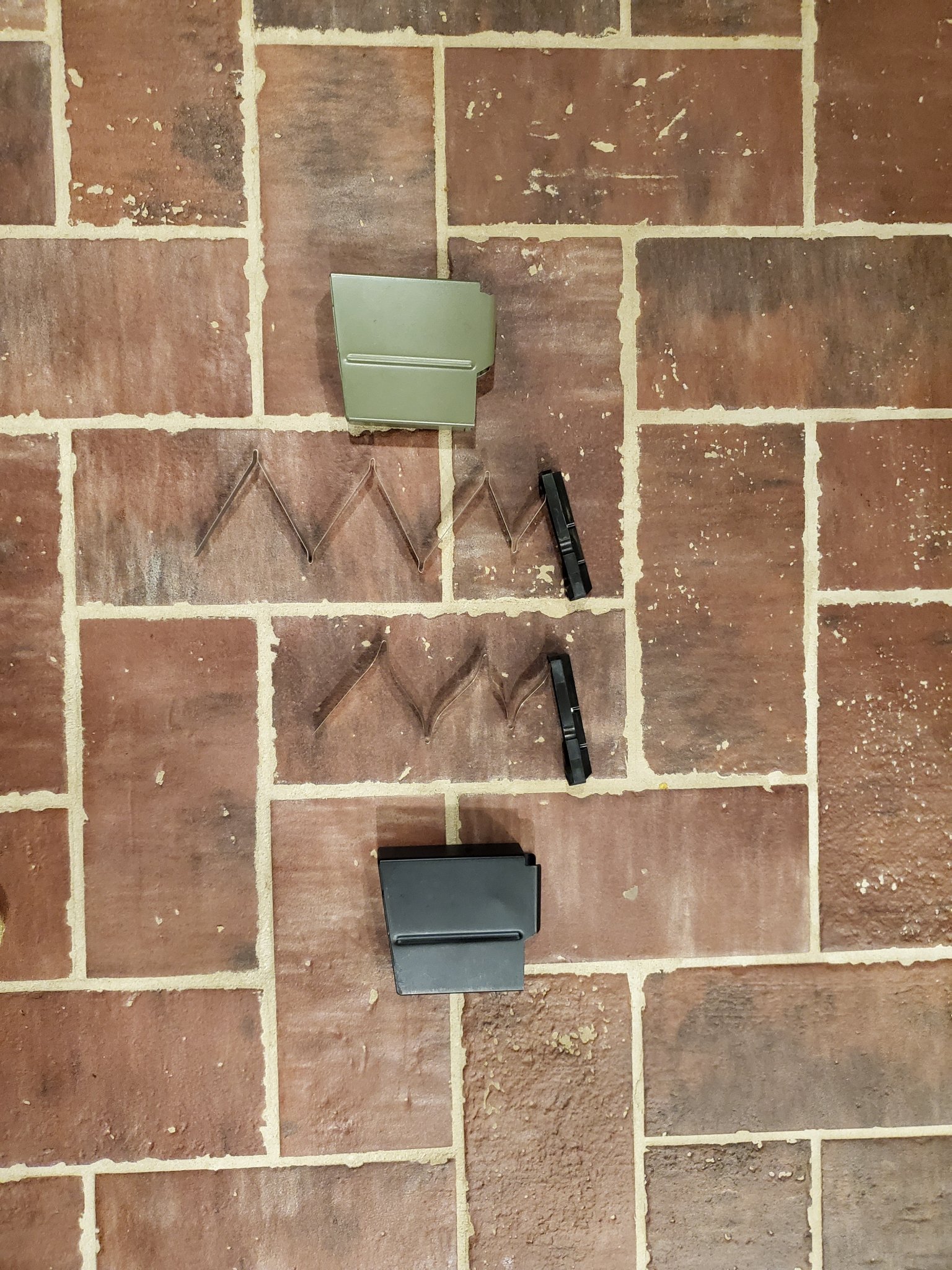

Has anyone seen a mag spring like the longer one shown here? Anyone know what the deal is?

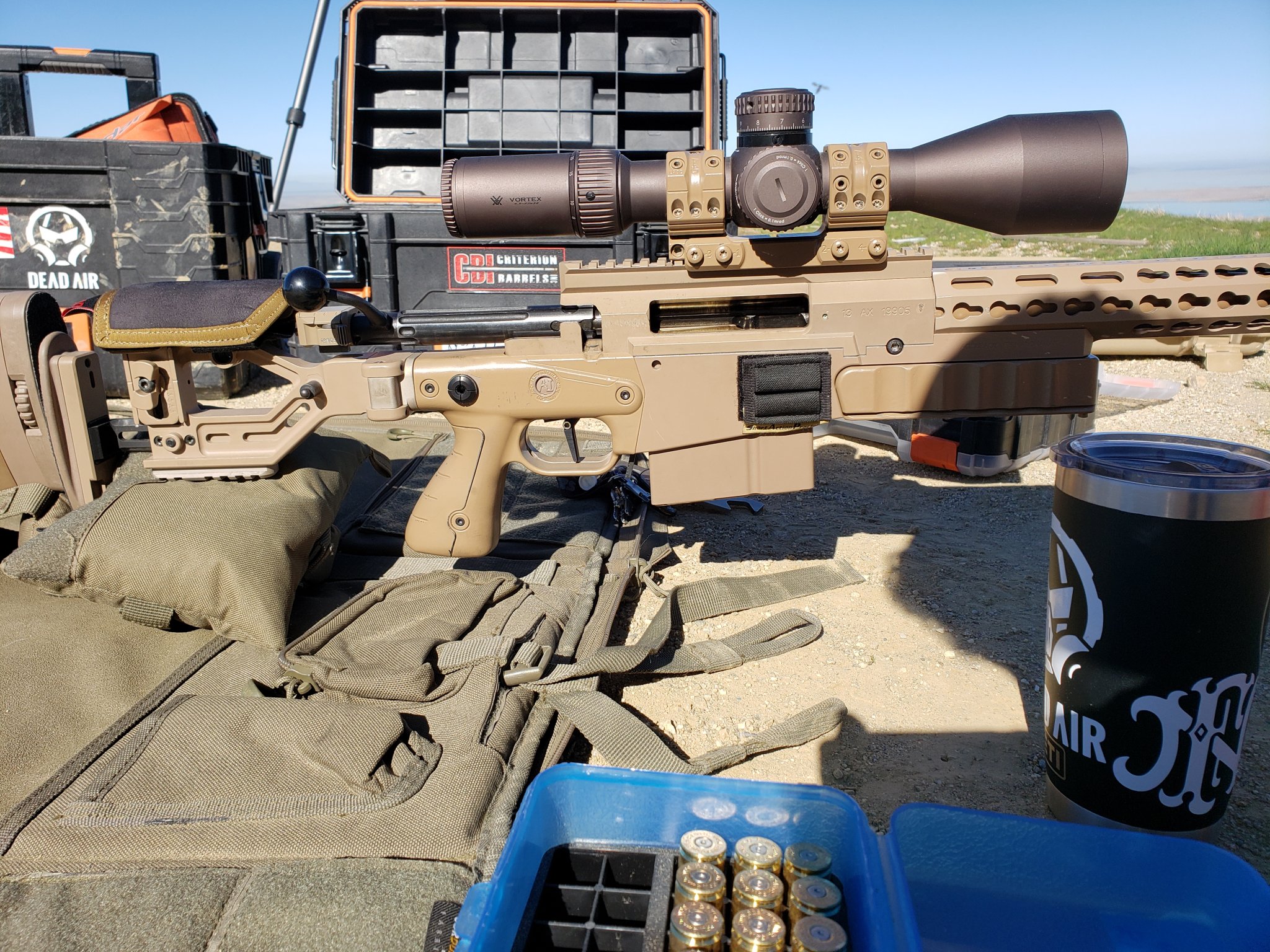

Picked up the EuroOptic Range demo from my dealer yesterday. My first AX is all but done. I have a few small things on order like a Sawtooth Rail, Hoptic Cheekpiece and quiver, but that should be about it. It’s going to be a long wait until I get to take her out on Monday. Sadly, I don’t think the AT is going to get much love anymore.
Specs:
AI 6.5CM 24” barrel
Silencerco Hybrid
Atlas Cal Gen2 w/ RRS BTC pro clamp
Tangent Theta 525p Gen2xr
Spuhr 4602
Accuracy First Level

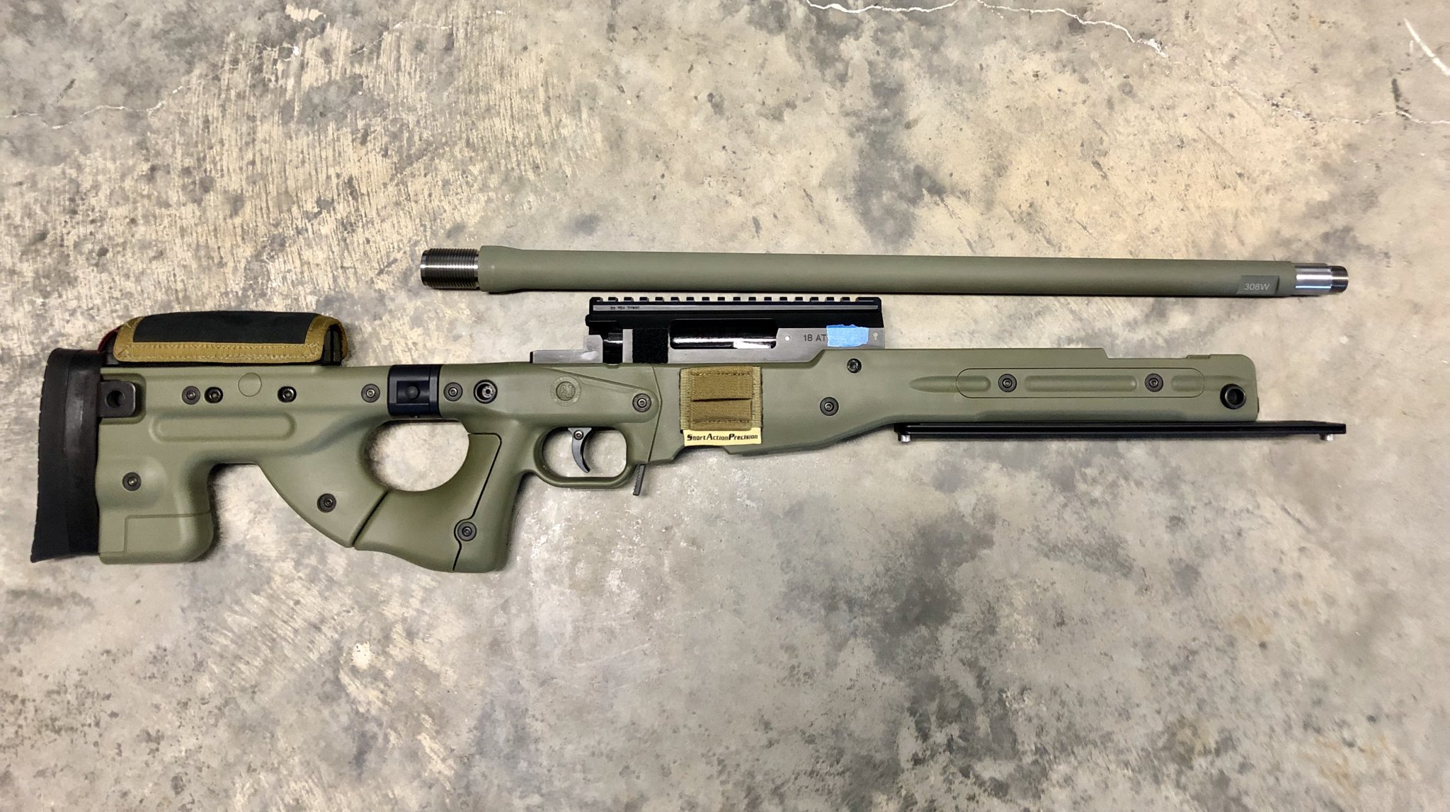

Question for you guys. I’m buying a 6.5 barrel at the end of the month. How close does this sage green colored AI barrels match the AT green side stocks? Worst case I can repaint it but I don’t want it looking blatantly different than the chassis.
Thanks!
Thanks!
7062551
The picture is deceiving, the sage green is a shade or 2 lighter
