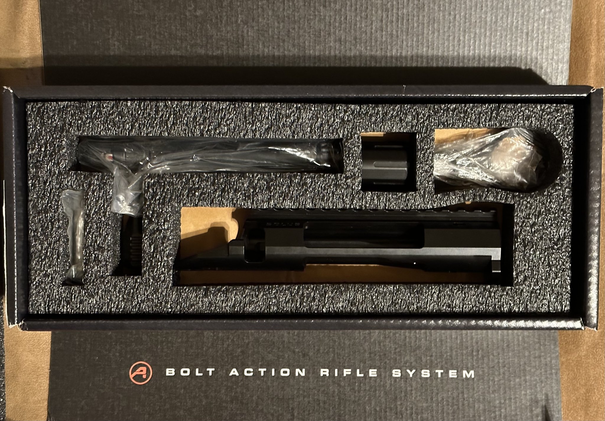

    I unboxed the Aero Precision Solus on the Live Stream yesterday, so I pulled that out for people to see.
    Oh the Solus is nicer than the APO, that was built off a Remington 700
    Plus right after APO upped and moved operations overseas that have nothing to do with what we are doing so they are barely there to do anything, it was sort of the rug pulled out on my me.
    But a 3 Lug, 60 deg action is always gonna be better, plus with the Chassis the AW mags will actually work right

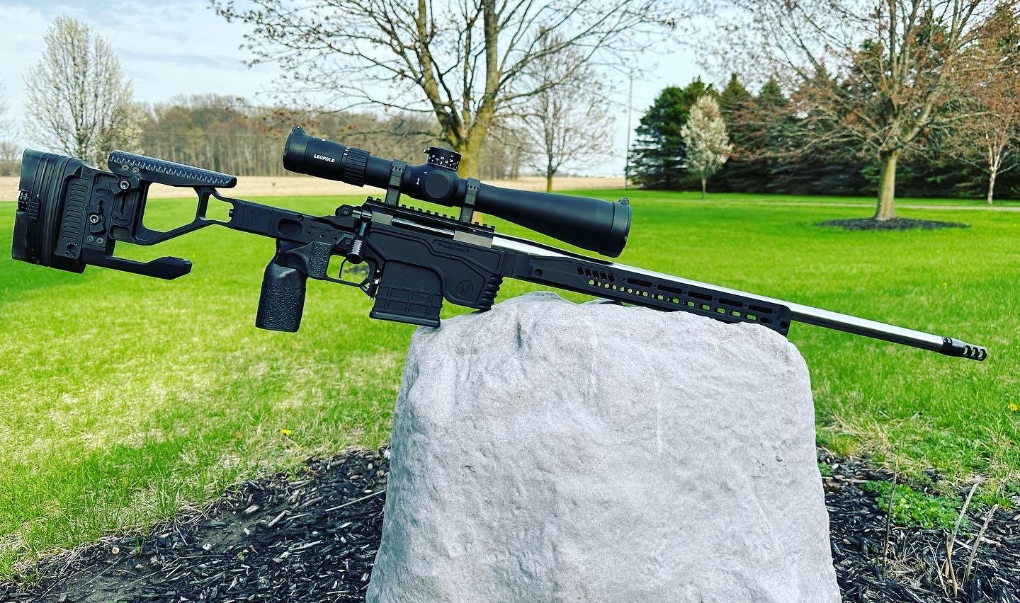

    I had a change of plans and I'm chambering it in 6.5x47 Lapua for a buddy. I just ordered two more actions for personal builds. I honestly can't see anything wrong. I threw a Savage pre-fit in .375 Raptor on there and everything was great. Smooth, the extraction was positive, the ejection was more than adequate and the bolt lift is typical for your 60 degree throw actions. Is it a Terminus Zeus? Nope, it doesn't have that refinement and glass like smoothness. Is it adequate for a match or hunting rifle? Hell ya. More than adequate, especially when you factor in the cost. I still plan on chambering the next one I get in .308Win and beating the absolute shit out of it. I have 800 some odd rounds of old 308 I need to burn through, so the Solus will see every bit of that.
    Nice action can’t really find any issues other than if you hold up on the bolt handle while cycling it seems do drag a little . The bolt may be dragging on the bolt stop but I really haven’t had time to really shoot it much .
    It looks so much cleaner without the barrel nut .

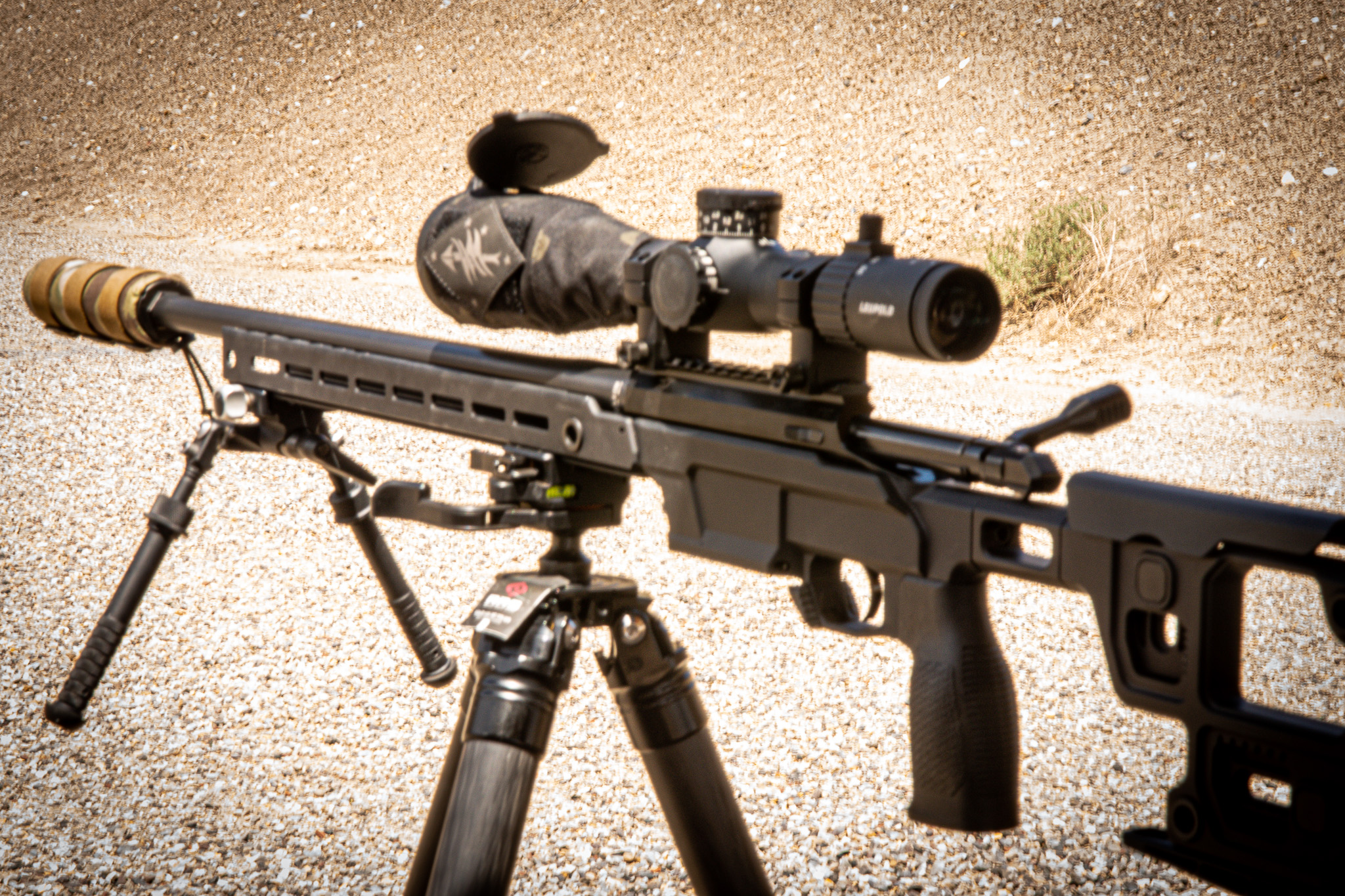

    My SOLUS action on the Aero 17" chassis. I really like the sleek features. Only one complaint...The butt pad assembly wobbles even when locked into place/ Will build up and file a little JB weld to stop stop that. Disregard. I found a tension screw under the bag rider to eliminate the butt pad wobble. It is a fine thread or even half thread turn to knock out the play before it isn't quick adjust tho. In hunt rig mode:

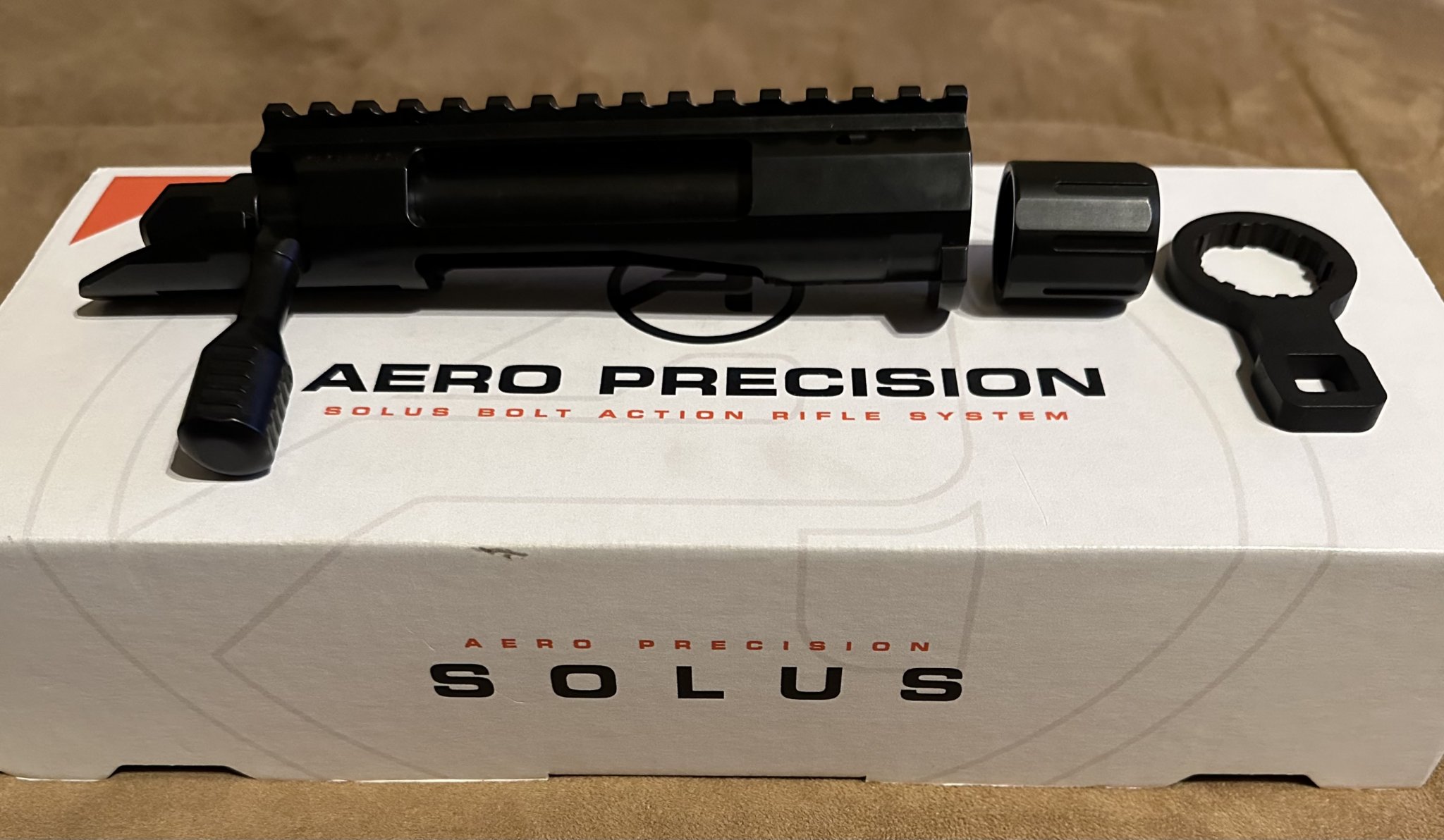

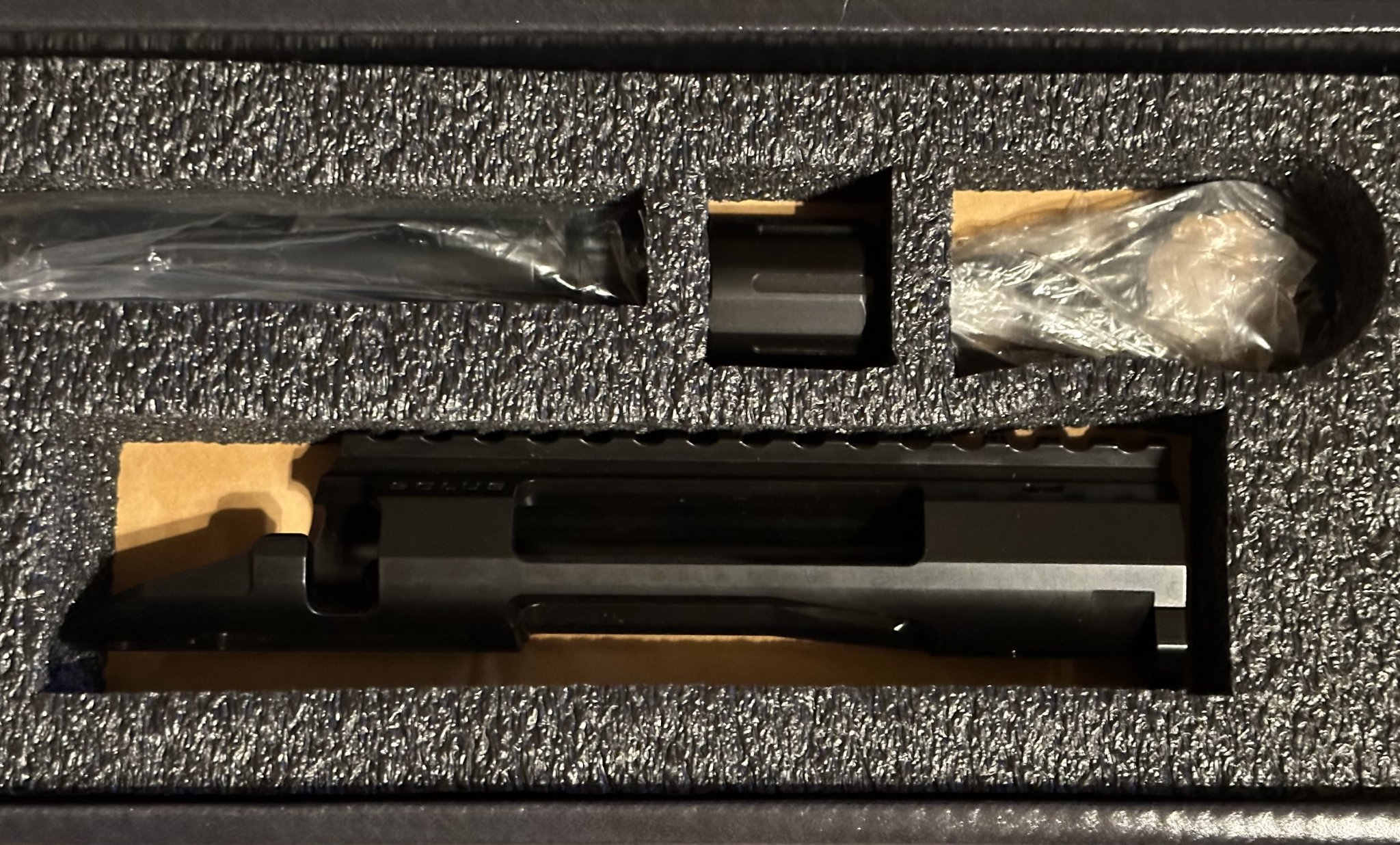

    The Solus action came in today. I’m pretty damn impressed for the price. They’re normally $899, but Primary Arms was running them on sale for $650 last week, so I couldn’t pass that up. You can’t even buy a cheap used 700 and have it blueprinted for that kind of money these days.
    Thought it was pretty cool it comes with the barrel nut and wrench, even though I won’t be needing them for this build. I plan on going with a shouldered pre-fit Zermatt Origin barrel.
    IMG_0327.jpegIMG_0329.jpegIMG_0331.jpegIMG_0332.jpegIMG_0334.jpegIMG_0335.jpegIMG_0338.jpeg

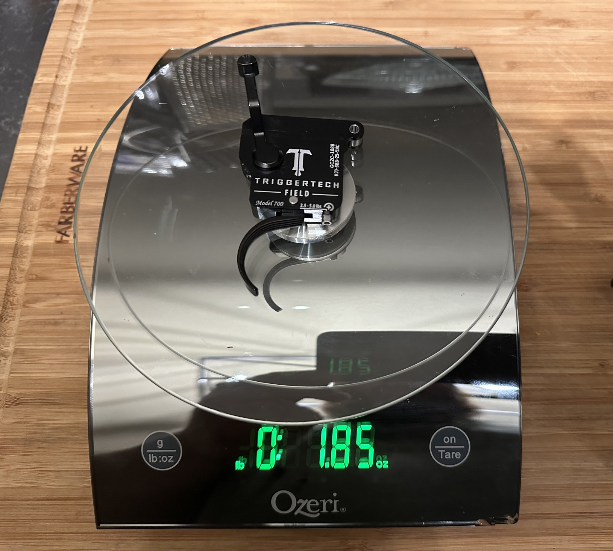

    I have a couple of spare TriggerTech Field triggers laying around that I pulled from factory Christensen rifles, so I stuck one in it for function testing, and then weighed the other bare so I have a good baseline how much it added to the action.
    The TriggerTech 700 Field trigger (700 Clone, no bolt release) weighs 1.85 oz.

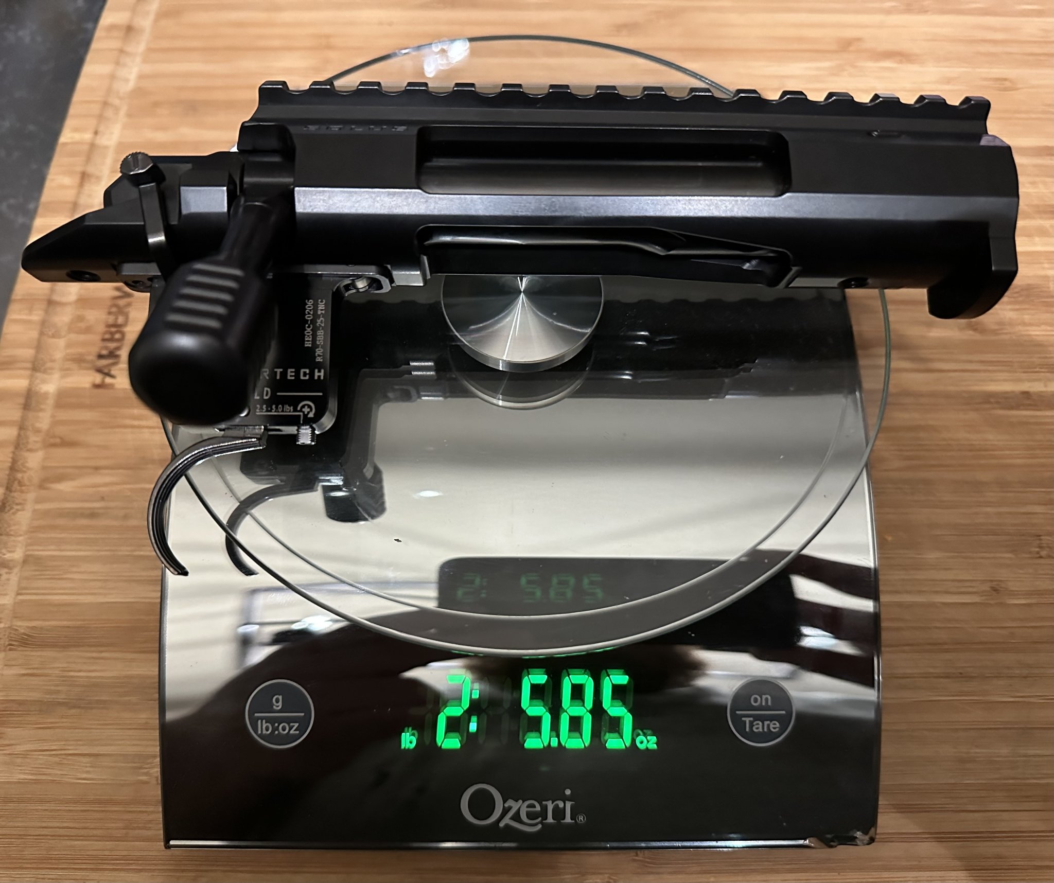

    The Solus action with a TriggerTech Field trigger in it weighs 2 lbs. 5.85 oz. So, that means the stripped Solus action weighs 2 lbs. 4 oz.
