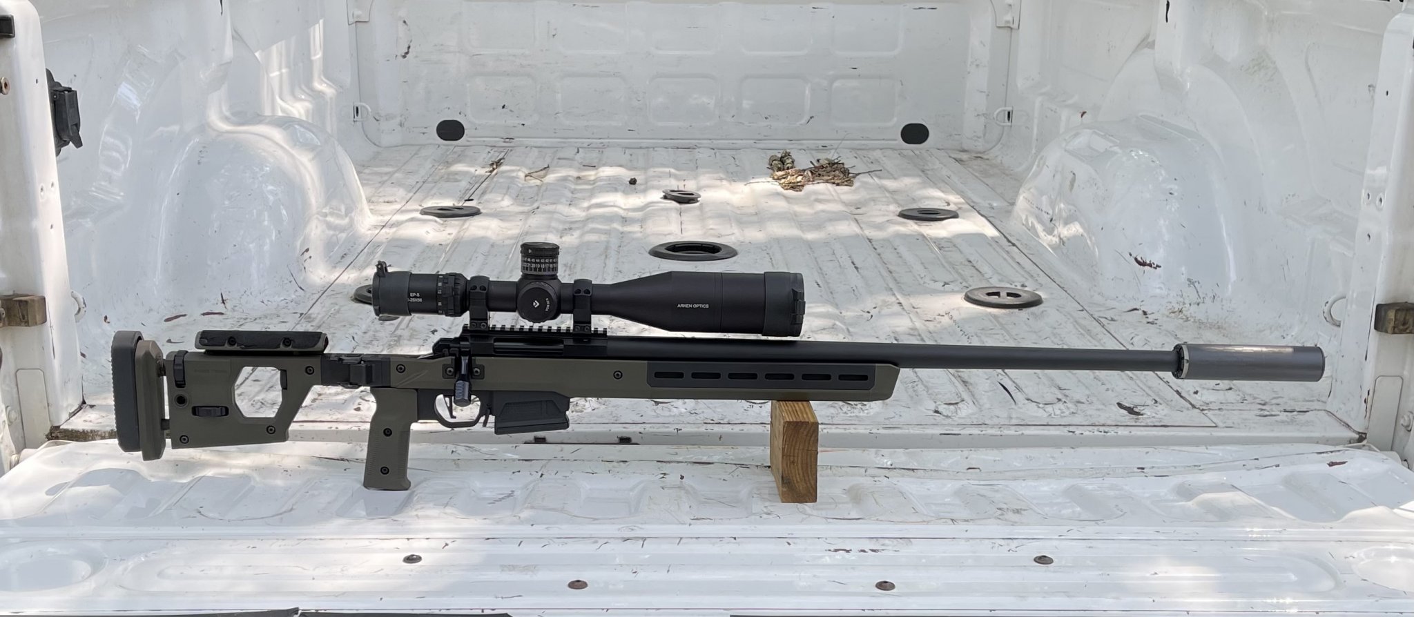

Aero Precision Solus Unboxing on the Live

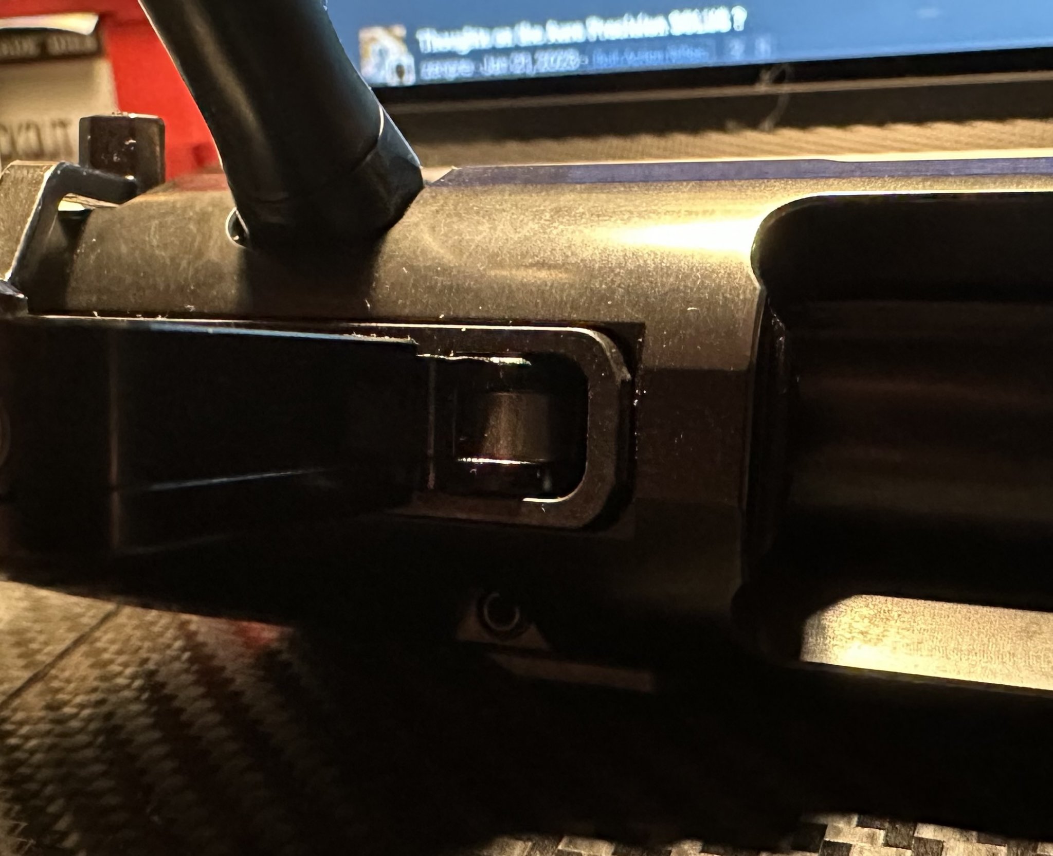

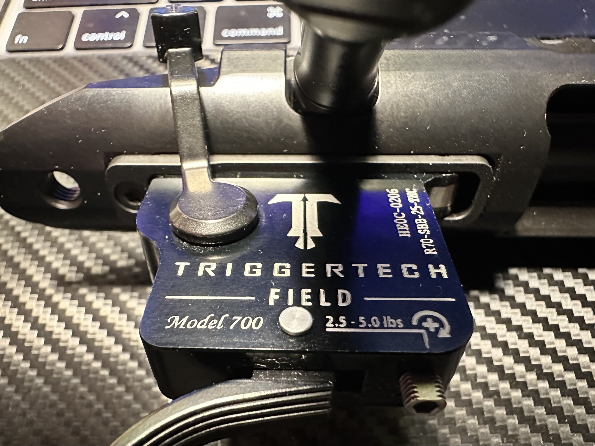

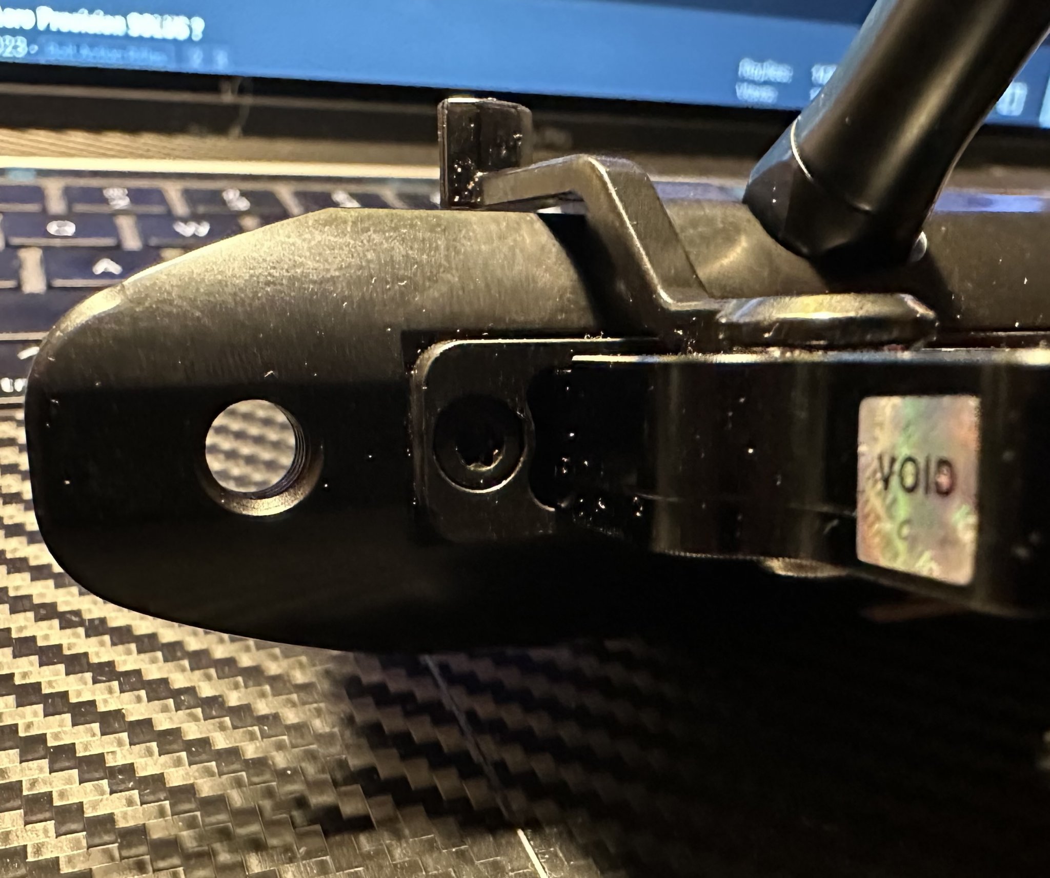

Oh, I also forgot to mention that I LOVE the trigger install design on this action... No more punches and hammers. It has a saddle system that fits down into the action and is held in place with a recessed T10 torx screw. And the 2 trigger pins are very short and held captive in the design, and fit flush with the saddle walls to hold them in place against the action walls when you push the saddle down into place, and there is ZERO play. You can push them in and out with your fingers.
They really thought out the design on these actions, and the machining is pretty damn precise. It's very tight. There's absolute minimal shaft play in the bolt when it's pulled all the way to the rear.
