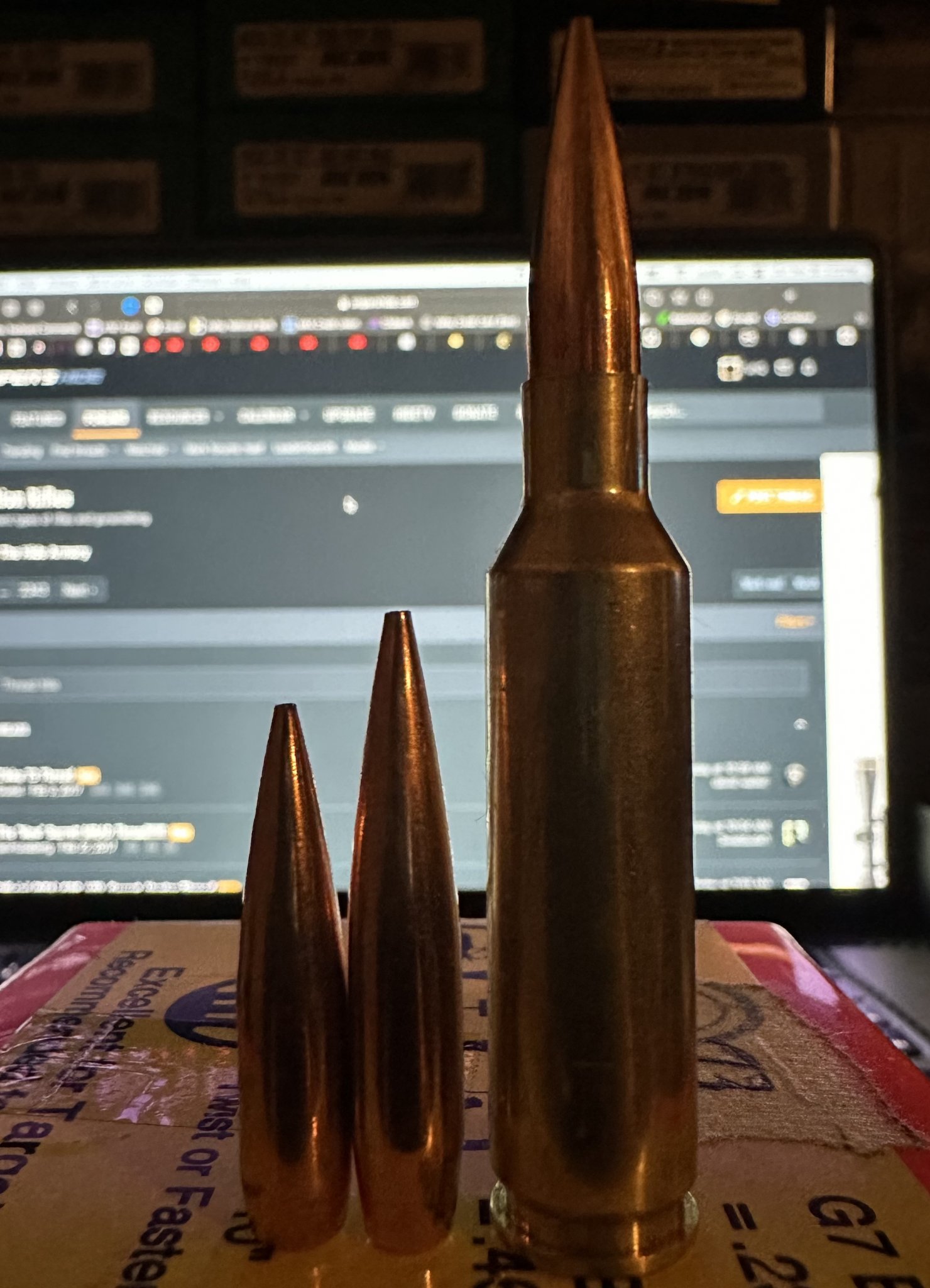

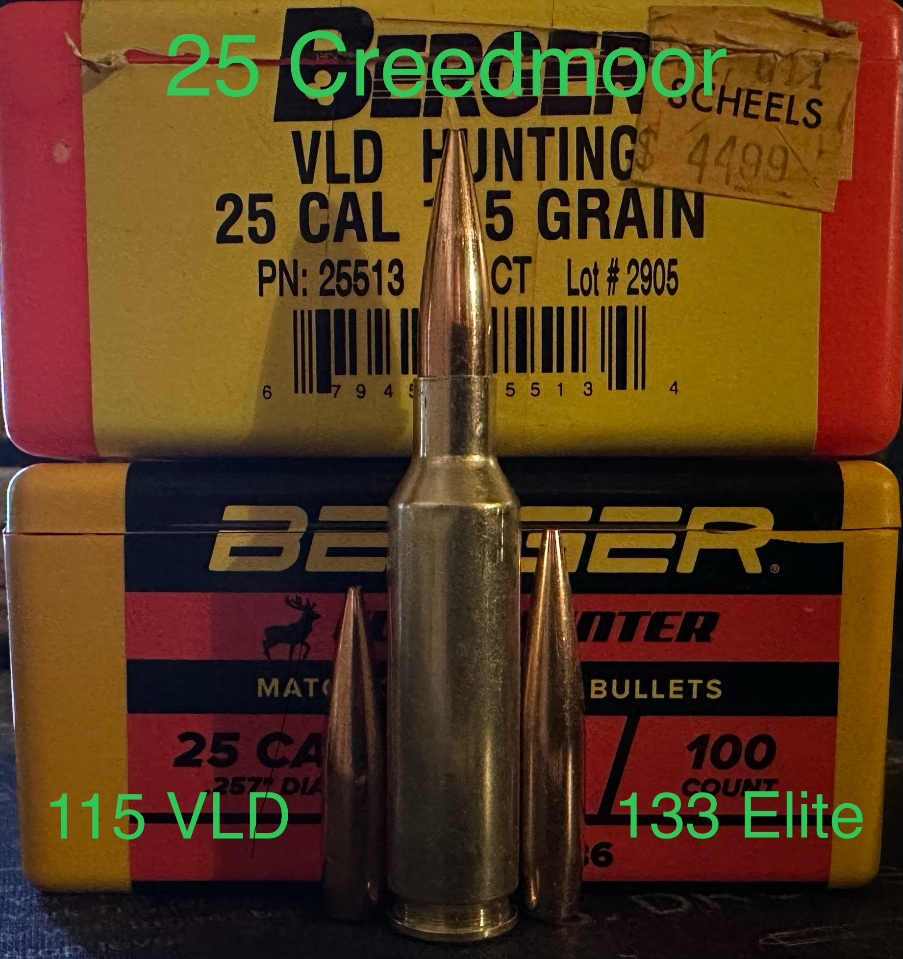

The Solus .25 Creedmoor build is complete…Minus a barrel…
It’s been ordered, reamer was ordered, just waiting for it to be built and shipped to me.

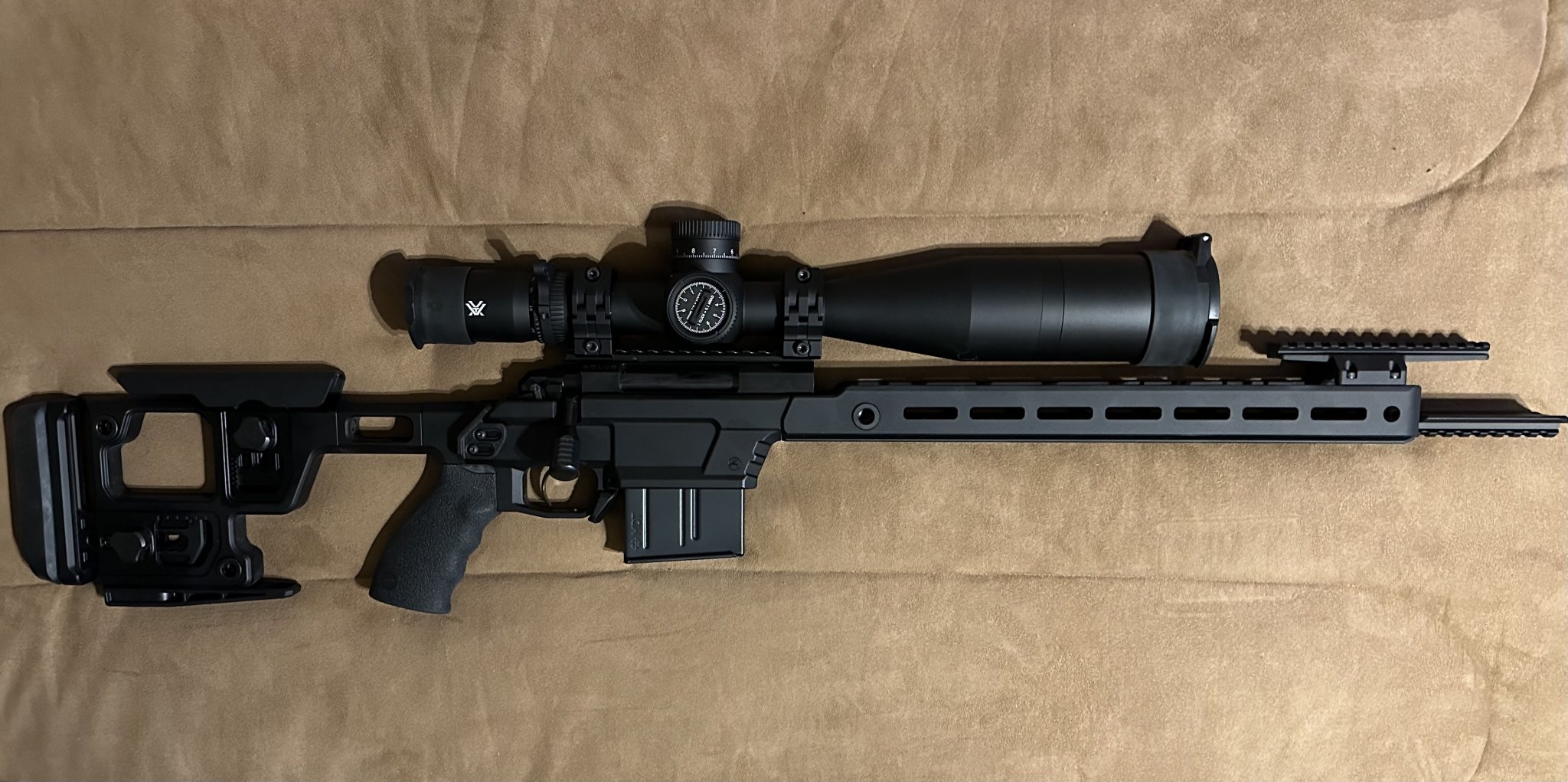

Dummy round made using an old piece of random range 6.5CM brass, and a spare Berger 115 VLD I had sitting around. The end of the bearing surface, where it meets the boat tail, is sitting exactly where the neck/shoulder junction is. So, the only thing dropping into the case, is the boat tail. I hope this will be the case with the 133 Elites with my Alpha reamer... But only time will tell. I won't know until I get my barrel and reamer back from CarbonSix.
Nice. Are you going to need higher rings? Looks like a tight fit.
Do you have a velocity goal in mind?

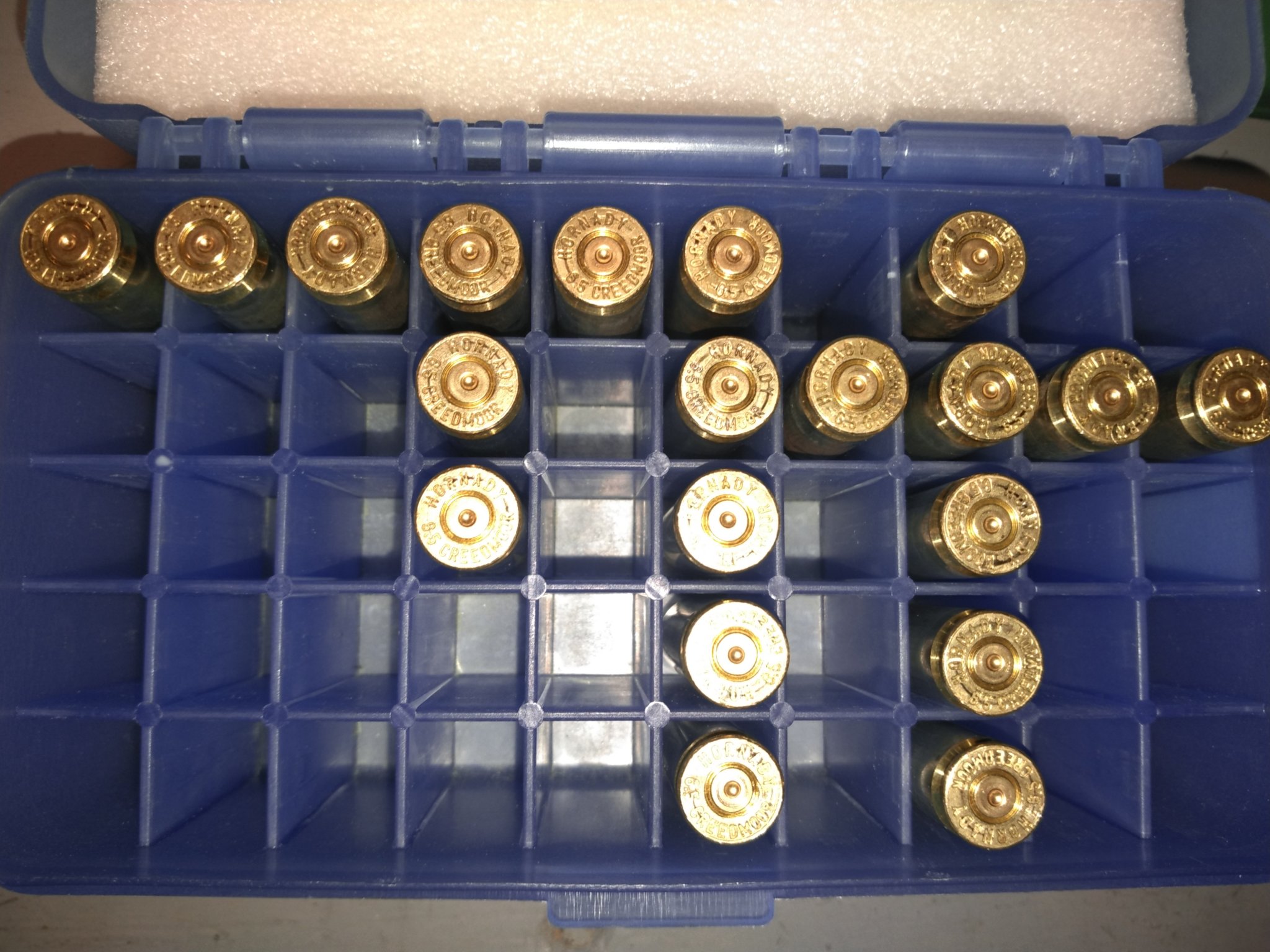

I just loaded up a pressure ladder for my 6.5 aero barrel. 140g eld 40-42.7g H4350. Hope to be closer to 2750 than 2700fps in the 22" barrel when it's all said and done.
It should clear, but like Ted Kennedy said... "We'll drive off that bridge when we get to it..."
Hoping with the 133's to be close to 3K from a 20" barrel, but I won't be disappointed in 2,850+. The 115's for fun should end up well over 3,000.

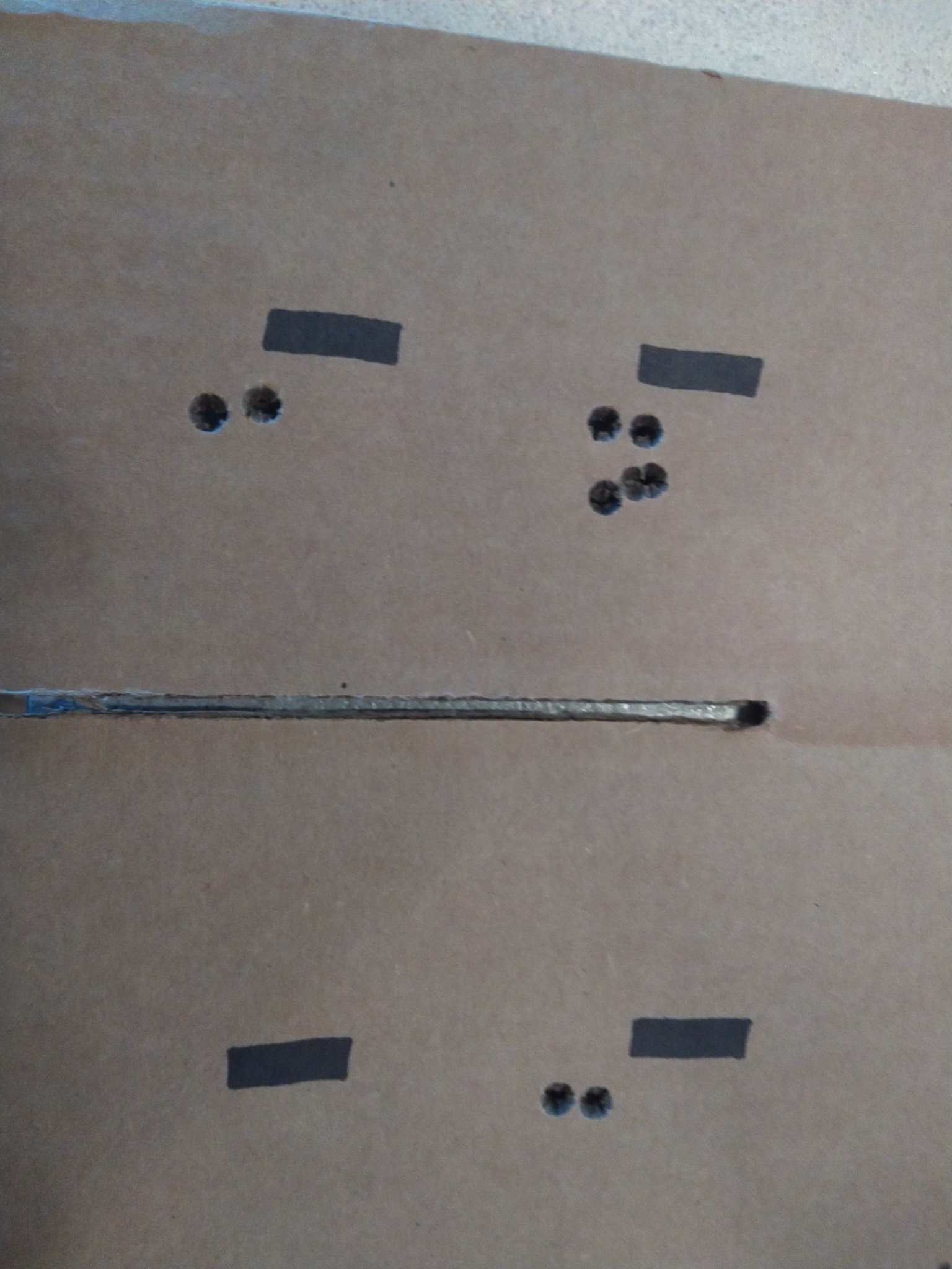

My Aero 22" has done better than I expected. Hornady factory 140g elds in the .5-.8moa range with one group in the .2s, .3 and .4 range. 2-2.5" at 396yds over the weekend. Started to see some of the Hornadys poor ES at that range.
Here is a pic of a 10rd pressure test. Didn't get the speed I wanted but it looks like any combination of the 140eld and H4350 will do well. I noticed once fired 2.513 with my comparator so I sized to 2.510-2.511. 2nd fired coming in at 2.515. Primers look good but I started to feel some resistance on my bolt lift at shot 7-10, only had a "heavy" lift with shot 10 and a nice shiney ejector circle. Maybe seeing some false pressure with a 5thou shoulder bump?

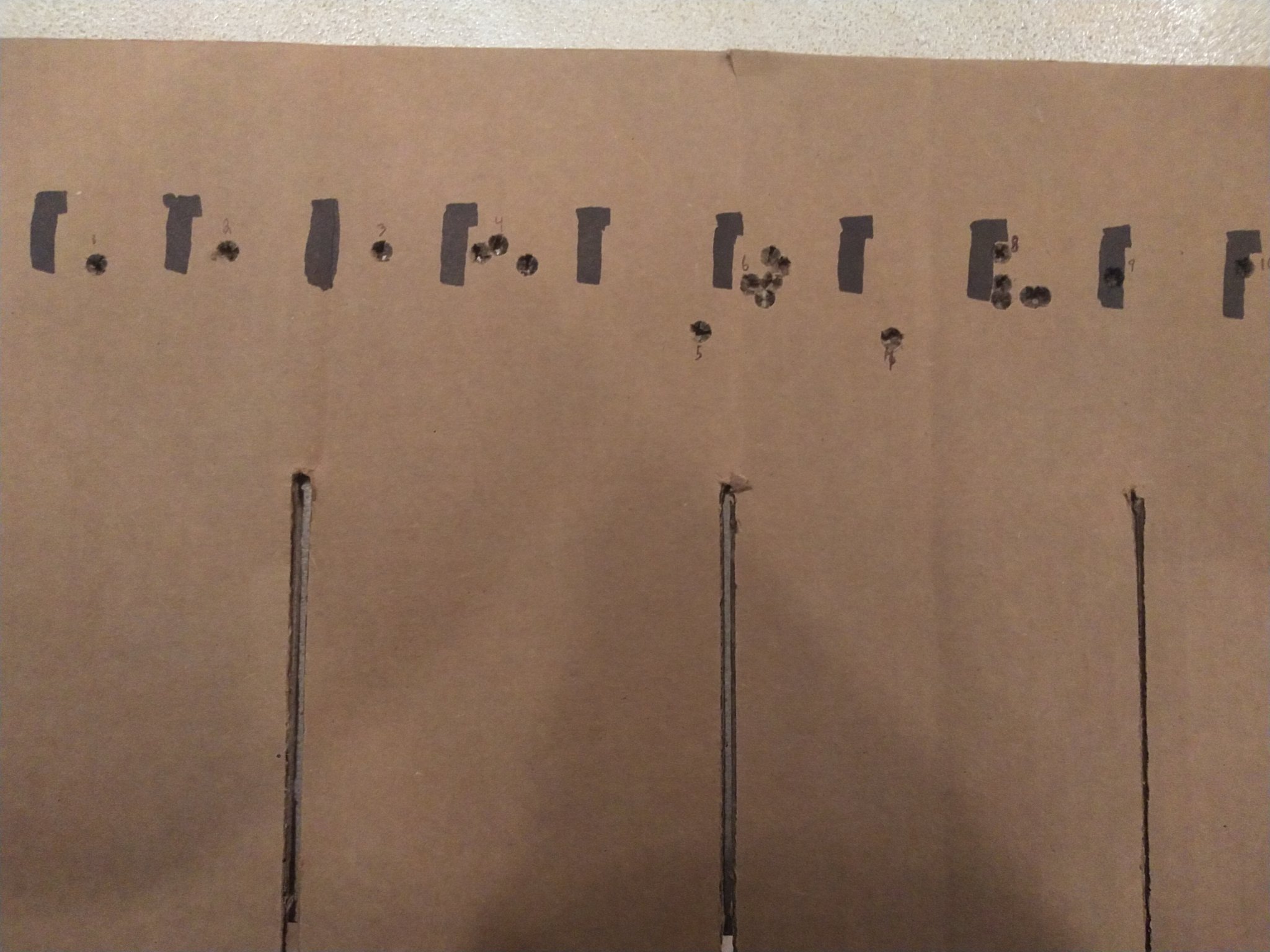

Loaded up some more 40.9(.48moa 3 shot), 41.5(.4moa 5 shot), and 42(.59moa 5 shot) 2 warm rounds and 2 outside temp of 35degrees for the higher charges. 41.2 and 41.8 had those shots way low and right from the rest of the 20 shots.
100m
I'll update with numbers and try to get a better pic of brass.

Cleaned barrel and did some more testing. Top group is the load that did well above, same bto as factory Hornady .080 off the lands. Then I loaded 2-.010 longer and 2-.020 longer. 41.5g H4350 for them all.

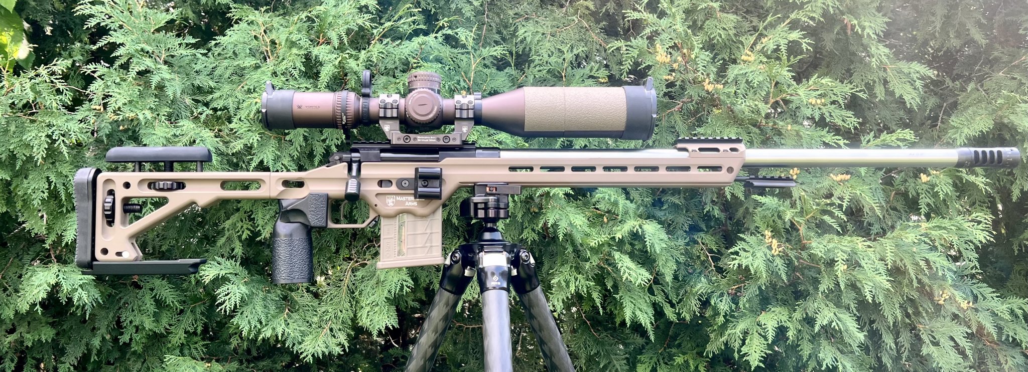

My Black Friday Special
Solus action and 17" Solus chassis
PVA 26" M40 1/7 Rock Creek in 6 Creed w/ an APA gen 2 Fat Bastard

My Black Friday/EE budget build:
Solus action
PVA 26” MTU sale prefit 22GT
MPA grenade chassis
EC tuner brake
TT diamond 2 stage
Razor G2 in MPA mount

It was bought separately. Action & chassis was direct from Aero and the barrel was new but bought out of the classifieds.

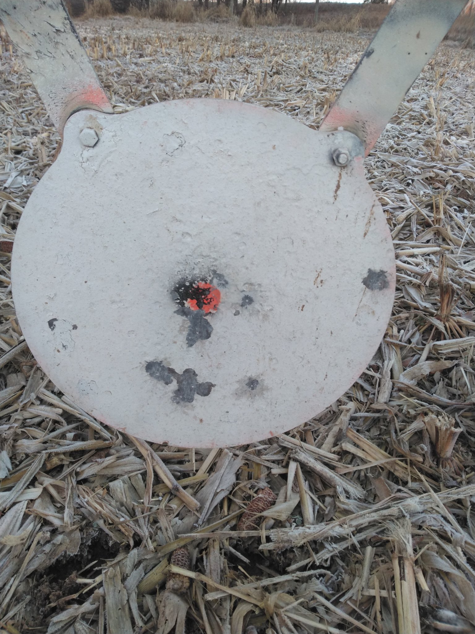

Little bit of a snow/ice storm I shot this in. Took me a few shots to find my windage. .8mil was on the right edge. Moved to .9 and fired 8 shots for the middle group. 1010yds
140g eld at 2677fps 9.4mil elevation so probably 9.5mil to center up the group.
