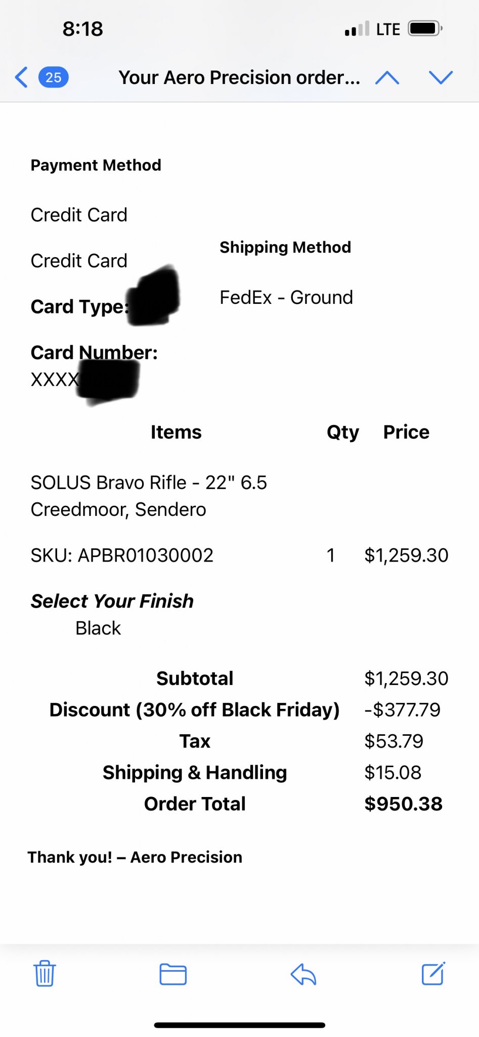

Probably a glitch though. 30off $2149 list is $1504 and 30off $1504 is $1053 which was my total before tax...
Damn,
You lucky bastards! That's like buying the action with a trigger and getting a decent stock, mag and bbl for free.
Can't even get a CTR for that cheap
Damn,
I'll make it up to them by singing its praises at the range though :LOL:. Always a lot of looky-loos with questions. If the rifle shoots as decent as I've seen with custom loads, I'll get them more sales.
