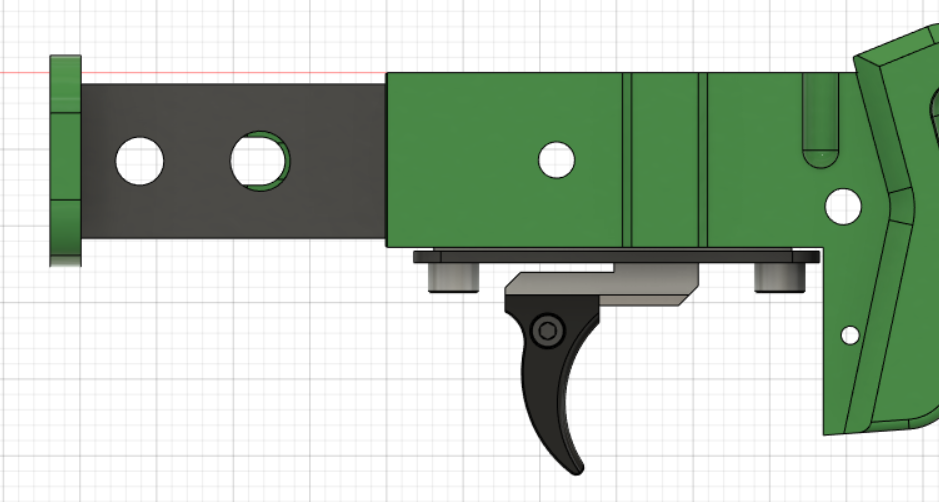

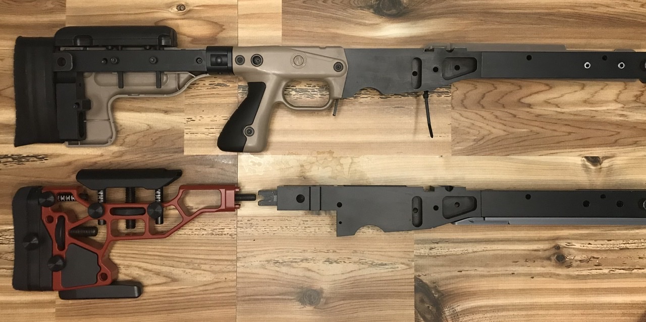

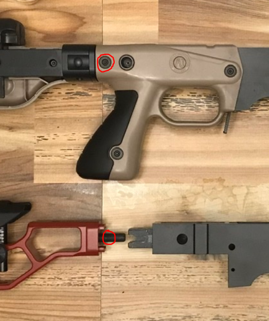

if you use their factory screw that mounts the stock to the chassis that is the case, I plan to use a shorter screw
It’s going to have to be really short
I don’t see the problem here, one half slips over the chassis and has the 2 screws that hold it on and the other end is threaded and the stock bolts to that. Based on your picture there is more than enough space for the bolt.
The rear-most grip panel screw goes all the way through the chassis...the MDT buttstock screw will directly interfere with it.
Not if you leave space for it, if the bolt in your picture is bottomed out I think it will work fine
You'll have to show me man, I honestly don't know what you're thinking to get this to work. In my picture I have the MDT buttstock spaced 2" rear of the main chassis to represent the "new" tube section that would have to be machined as an adapter to get this to work. But like I said, the rear grip panel screw is very close to the rear, so the large MDT screw would have about 1/4" of thread engagement unless you start moving it rearward and increasing the min LOP.
Is it as simple as leaving out the rear screw for the skins? It might case a little gapping....but I think there are enough other fasteners/the rear grip cap to keep them together fine...
I see what your saying now, what about threading the part the stock would connect to for the skins?
One side of the skins has the hole for the cap screw, and the other side of the skins is tapped. So if you did that, only one half of the skins would be able to be screwed down (unless you made a second custom metal insert for the other half of the skins ).
Actually would work fine for me with a LH rifle since the thumb rest on the left side screws the panel down tightly.
Ha, sorry. I encourage you to pursue it if you think you can get it to work. I do think with a longer LOP (i.e. making the tube adapter 2.5-3” long instead of 2”) it will work.
The pictures I added here were from over 6 months ago, I did spend some time on the idea. Ultimately I decided there were tons of things going against it for a production product:
- Long LOP to get it to work
- Folding ACC stock really isn’t that cheap
- Selling a product for cheap that still requires the customer to then buy an expensive buttstock from another company
- I personally like the AX buttstock way more than the MDT
Like anything, with enough time and money you can get it to work 😂

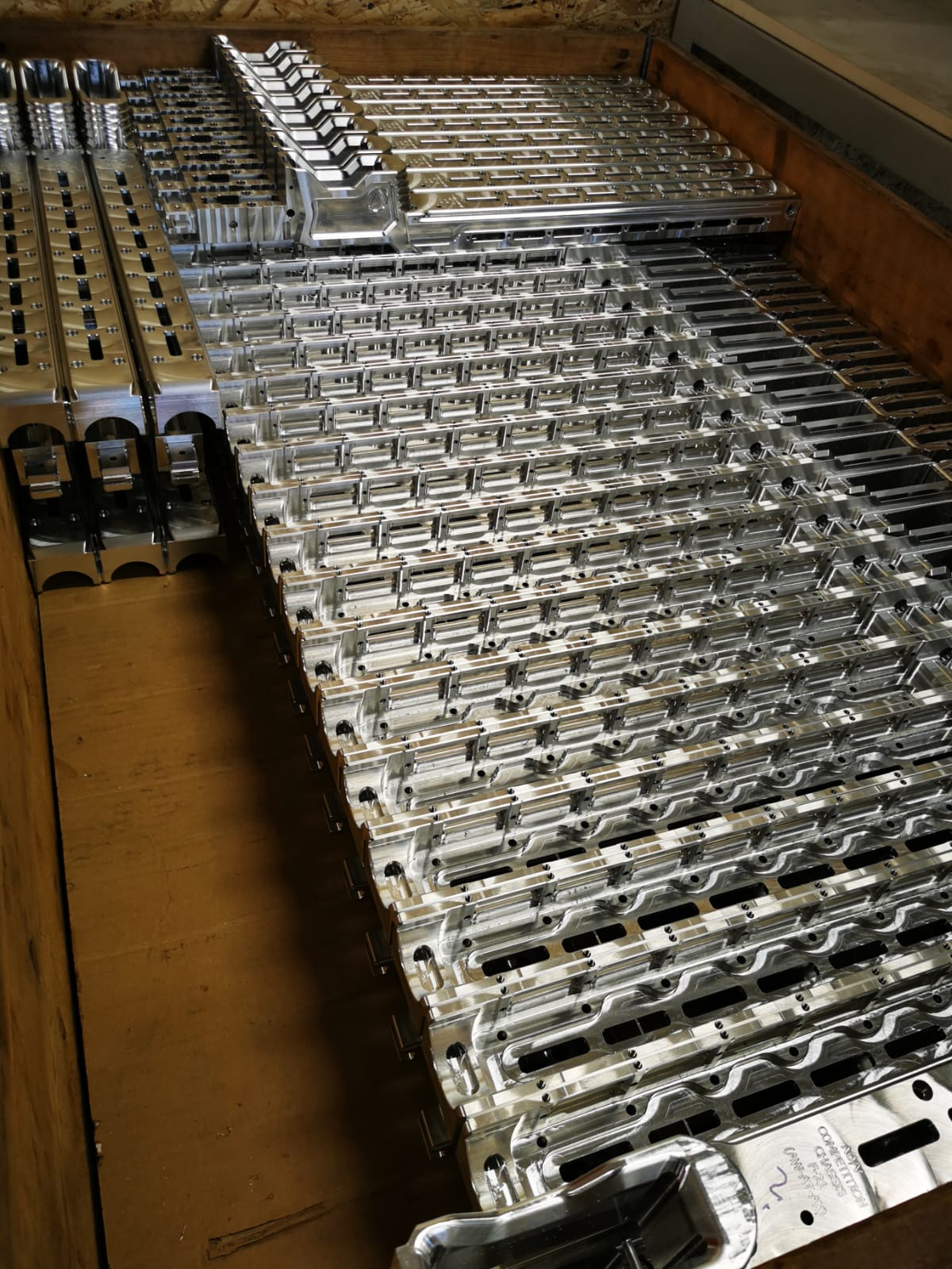

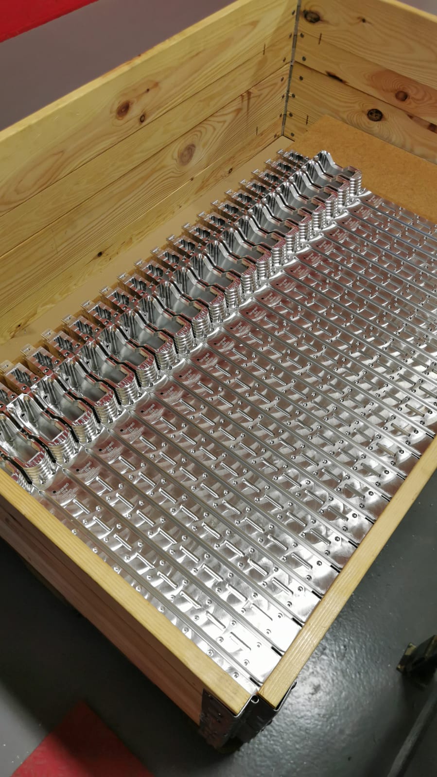

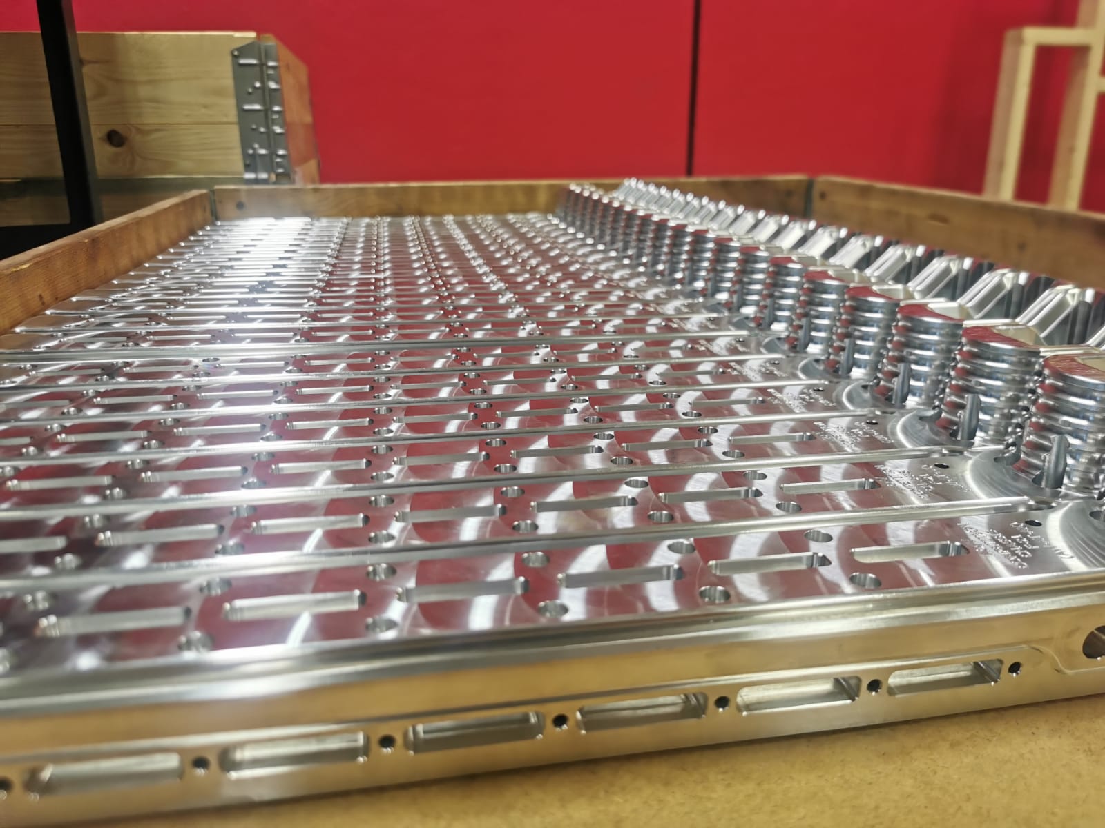

Thanks for the continued support and patience! The chassis’ are completely done with machining, just waiting on export paperwork from Norway.
