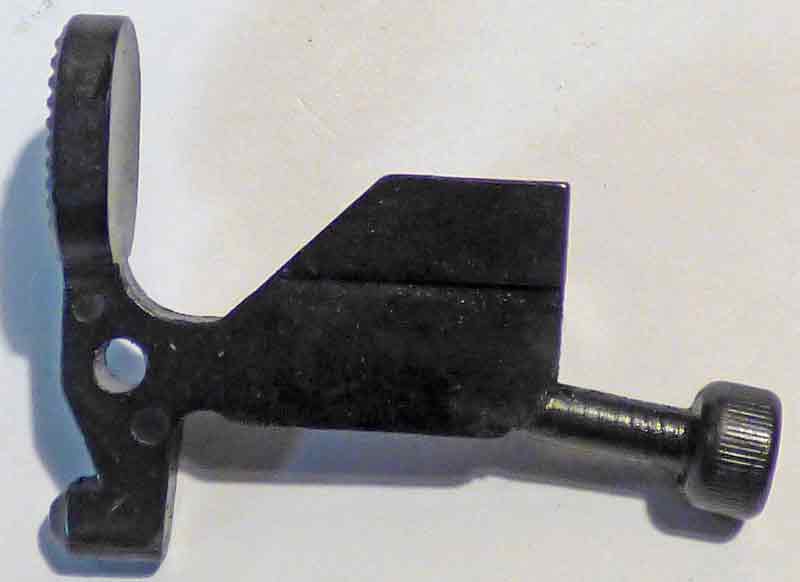

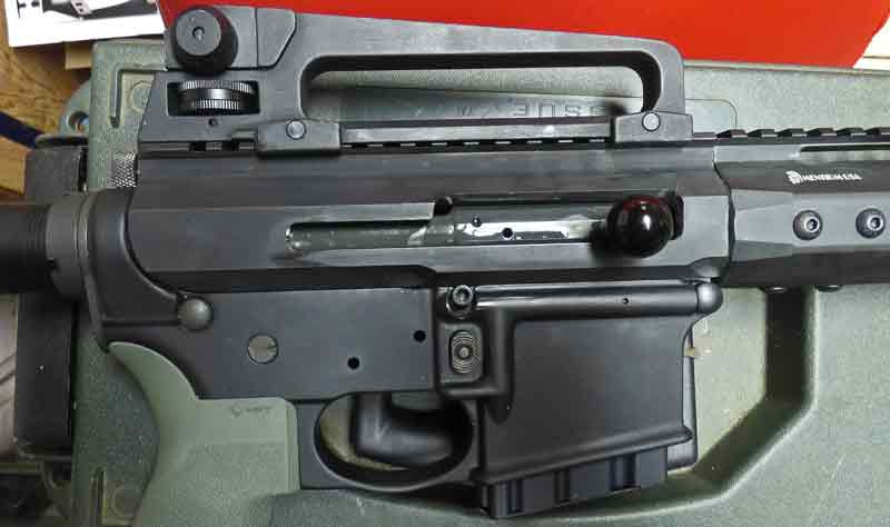

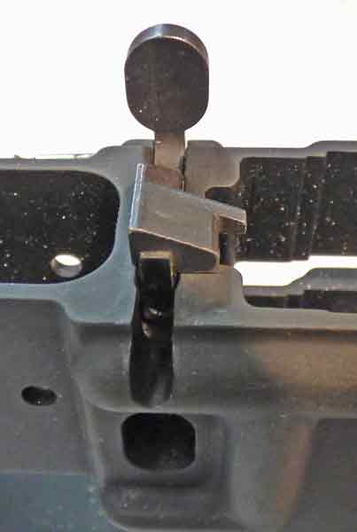

    Didn't really like the through-the-triggerguard ambi bolt release so I made my own.
    Requires modification to the lower and a bolt release and works best without a port cover (slick sided or side charger).
    I have started into F-class single load so my right hand is busy with putting rounds onto the sled anyway.
    I tried both a real steel and a powder steel bolt release and a carbide drill works.
    The 'Knob' is 8/32 cap screw turned down for a light press fit.
    Pictures might give you an idea of doing something similar.
