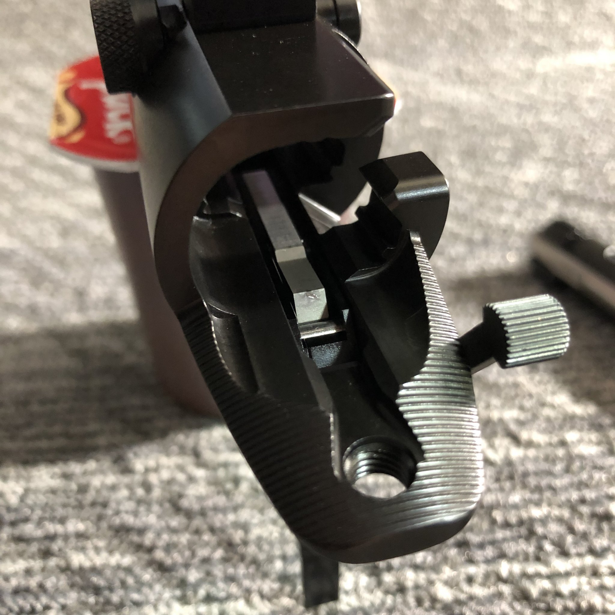

Does anyone else struggle w/ the bolt stop as much as i do? I thought I saw an iteration w/ a tear drop shaped actuator, but these "in the wild" photos dont have that. Now just wondering if i made that up, or if design was changed for some reason.
It's pretty stiff at 1st. open/close it for awhile and it'll loosen/smooth out. Still kinda tough when you have optics mount right above it (at least on my Nucleus), but if you can get the correct leverage on it, pretty easy to twist.
The original design had a "teardrop" look. But i think it was changed for production.
The original Nucleus prototypes had that but I think they interfered with rear scope rings or opened unintentionally due to inertia (kind of doubtful), so it was changed to a round knob.
The one on both of my Nukes was a bit tough to use at first. I took it apart and cleaned and lubed it and it's a whole different animal now. You could probably just clean it installed and be 98% as effective as taking it apart as well.

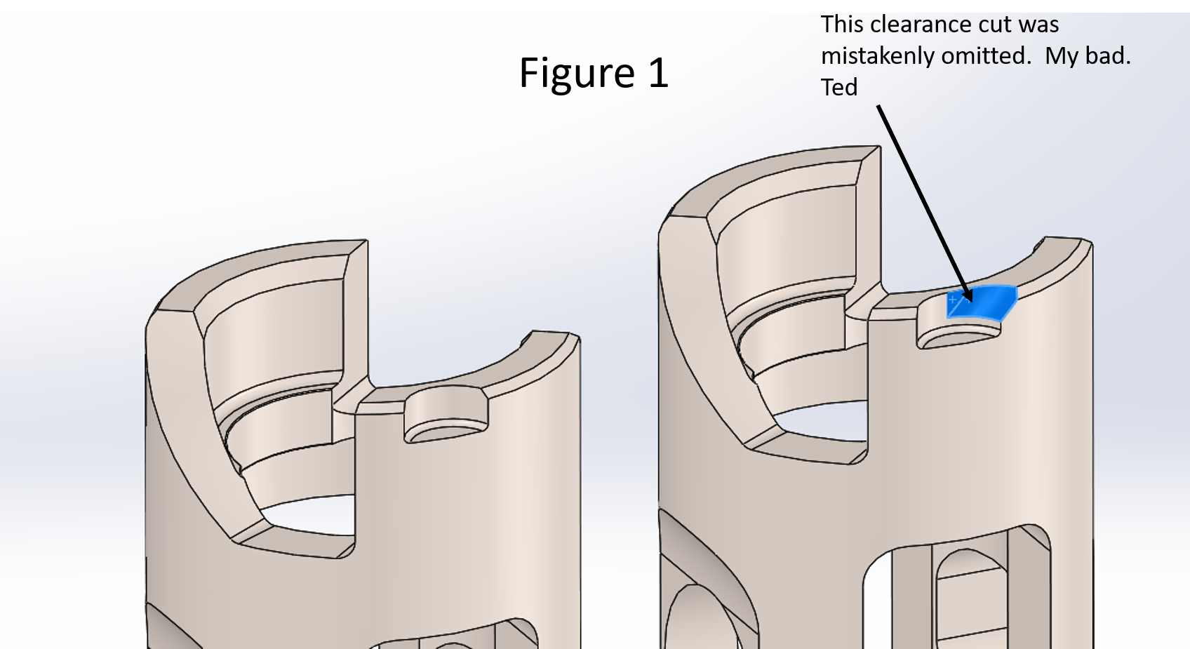

The bolt shroud locking pin is not disengaging the bolt body making it difficult to close the bolt. This is because the bolt body is missing a helical relief cut. See Figure 1. The Archimedes prototypes did not require this cut because they did not have closing cams machined into the forward end of the receiver. Since prototyping, we decided to incorporate 0.050” of forward camming to aid in closing the bolt over tight or slightly oversized brass. Unfortunately, we failed to include the helical relief cut that enables the bolt shroud to disengage the bolt before bolt rotation begins. The action will work without the relief cut but the effort required to make it work depends on the relationship between the cocking piece and the trigger assembly. A relationship that does not cock on close might seem to work fine but one that does cock on close will require a forceful push forward to close the bolt.
The fix is very straight forward, but it does require you to send your bolt to us so that we can replace it with one that has the relief cut. We will email a shipping label to you making the return process as painless as we can. You can also simply remove the bolt should locking pin and its spring, but we don’t recommend this because do so will allow the bolt should to easily rotate when the bolt is retracted. We really want you to send your bolt back to us so we can take care of this properly.

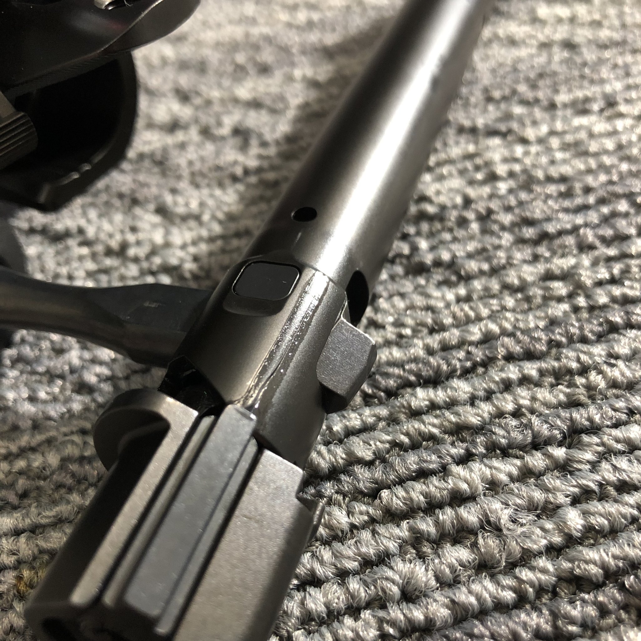

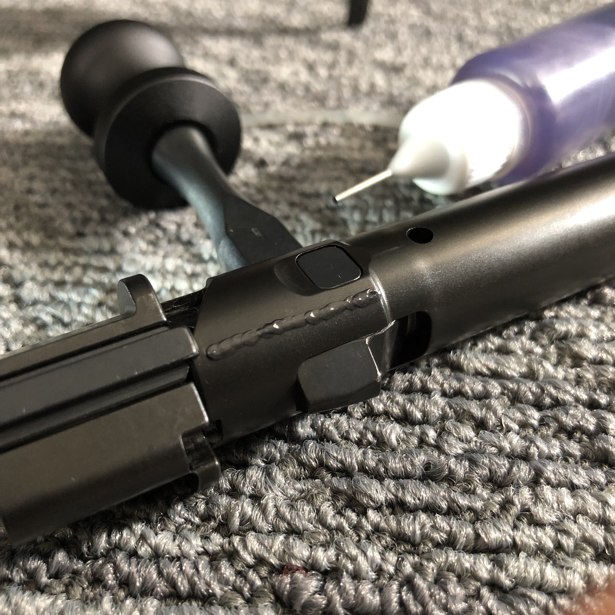

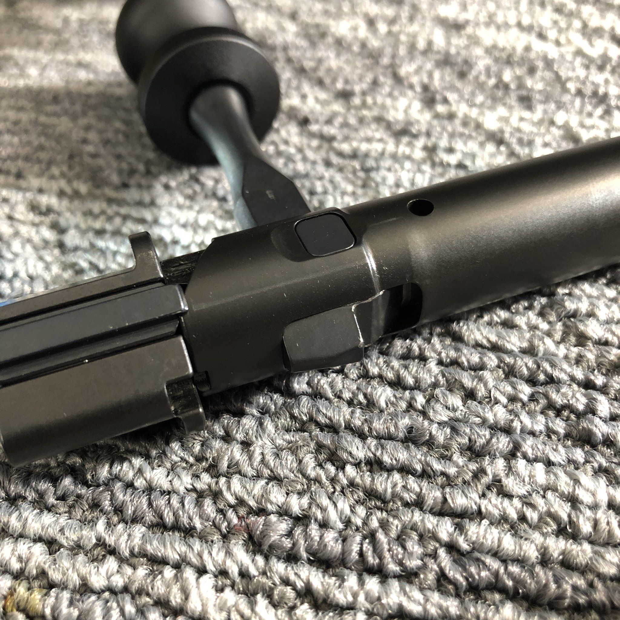

On my example, the TriggerTech Special sear contacts the large-diameter portion of the bolt body even when the action is cycled gently while inverted.
Clean the area:
View attachment 7150791 View attachment 7150792
Apply a very thin layer of grease:
And the results:
View attachment 7150794 View attachment 7150795

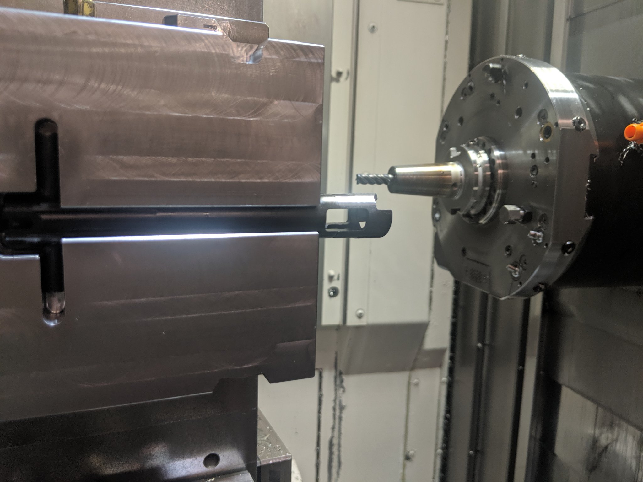

It seems like fixturing and milling a slot/flat would take less time than truing and turning the OD of the bolt body. Or rather, just swapping bolt bodies and cocking pieces with parts with the work already incorporated.
I don't have an action right in front of me but with a removable bolt handle and bolt head, it might be as simple as putting the bolt body in a collet closing lathe and using a tool post grinder to cut through the nitride.
Pretty easy if that is the case. Milling a flat would probably need a jig to line it up with some other feature. Still simple but possibly a bit more work.

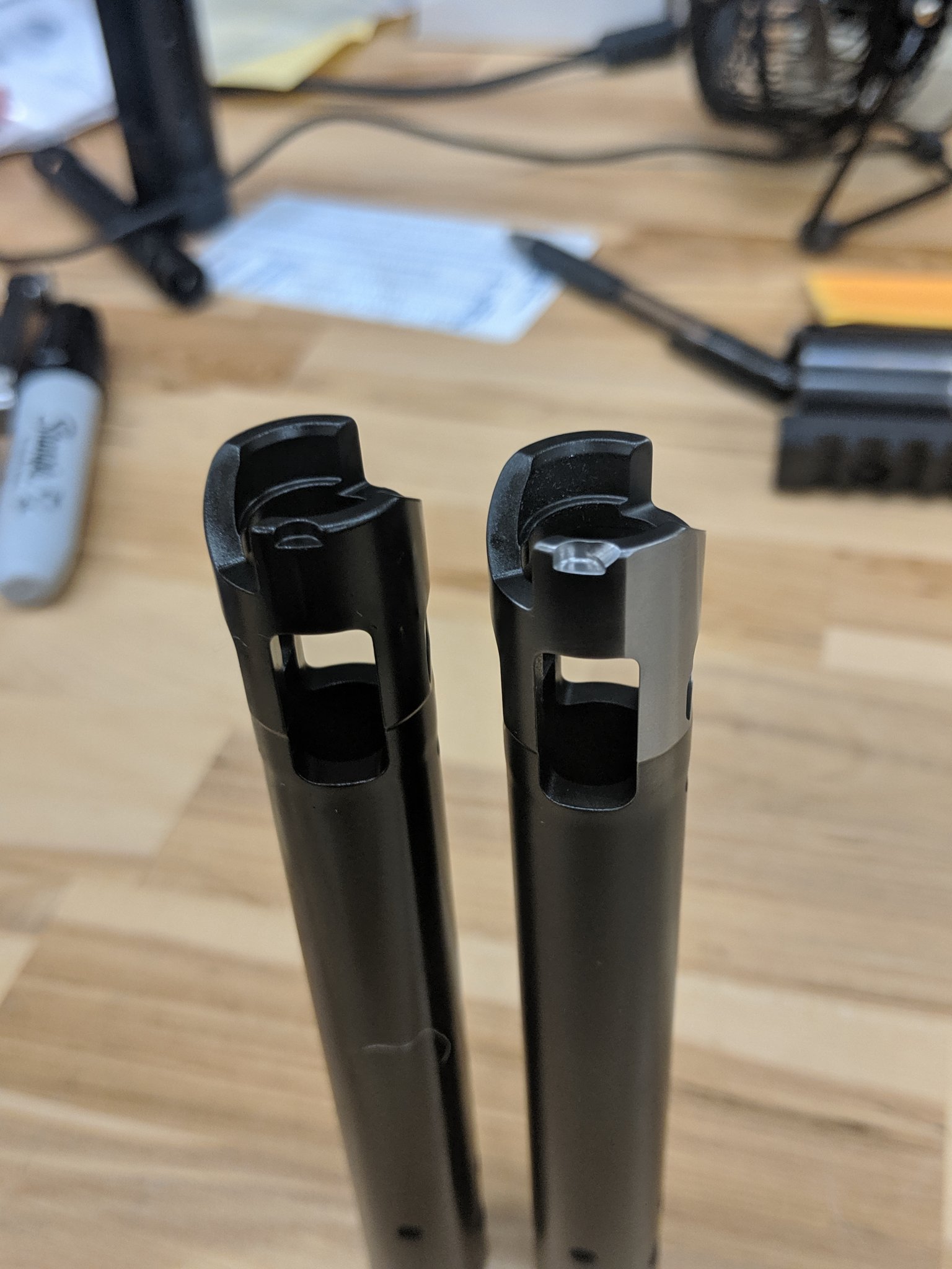

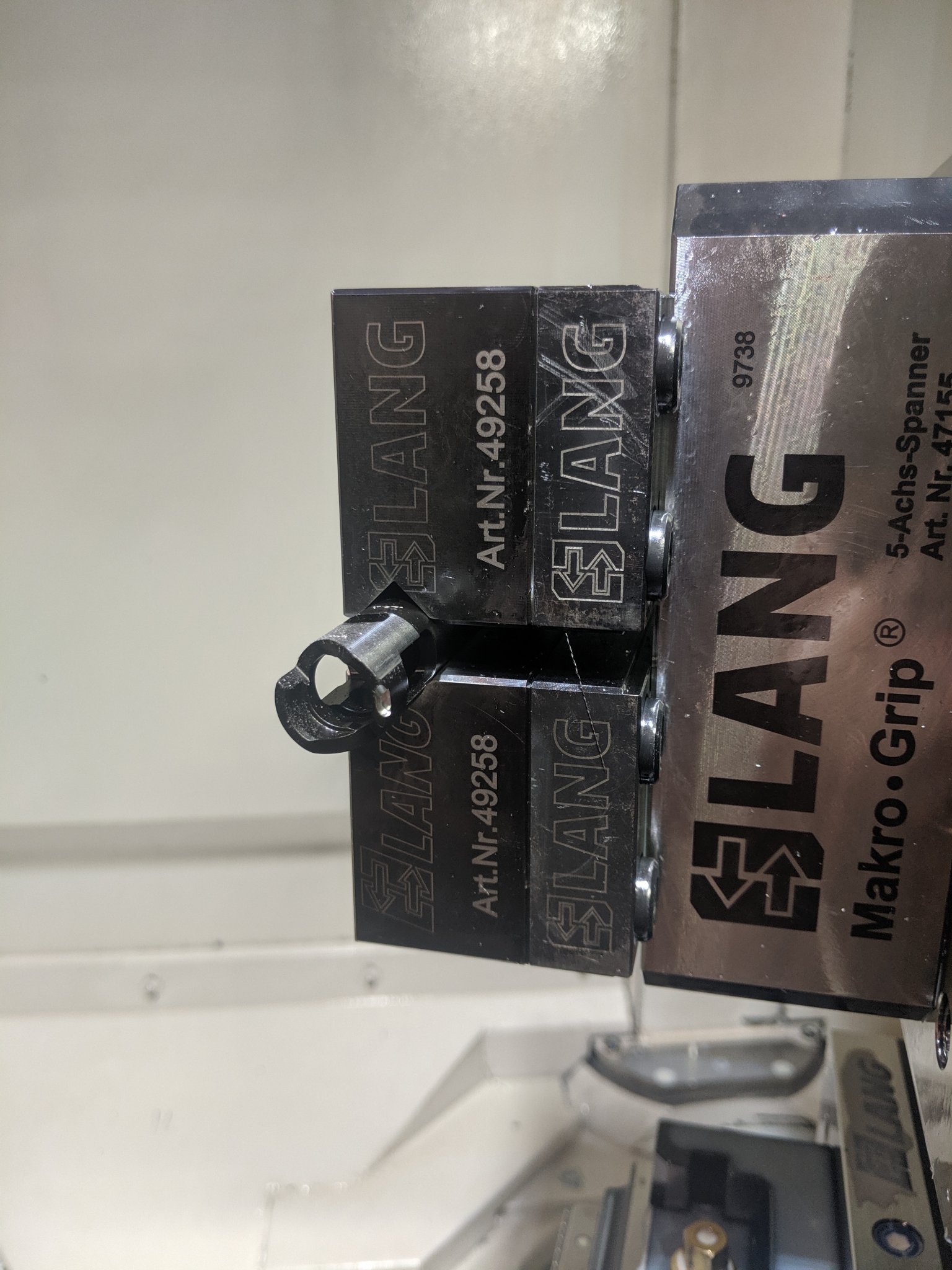

Here is a before and after photo of the rework as well as a couple of photos of the setup for the curious among you. Premium carbide endmills get through the nitriding without any trouble. We'll probably go through two or three of them to get this done but we're used to spending money on cutting edges. Someday I'd like to buy an endmill dispenser (Walter CNC grinder) but it will take much greater volume to justify the $400,000+ investment for one of those, unless of course we get into the chamber reamer business, or maybe even the end mill business. Imagine buying premium carbide directly from the factory using an awesome website like McMaster-Carr. Opportunity is knocking folks.
Anyway, the rework is going well. We should be able to send parts out for finishing tomorrow via UPS next day and have them back here by Wednesday in which case we'll resume shipping on Thursday. I hope things go well and that happens.
Ted
