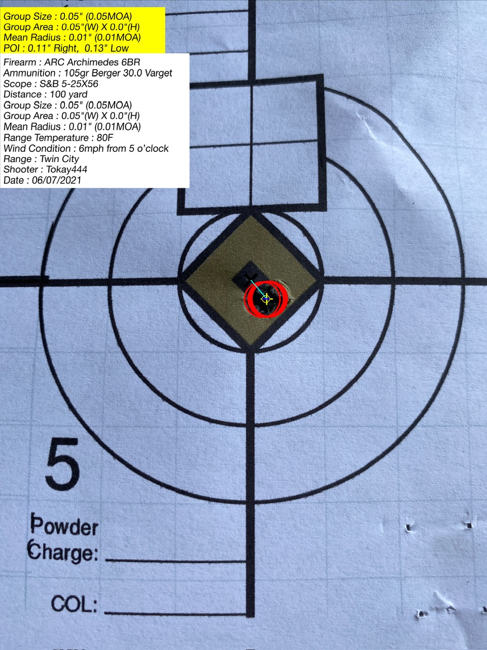

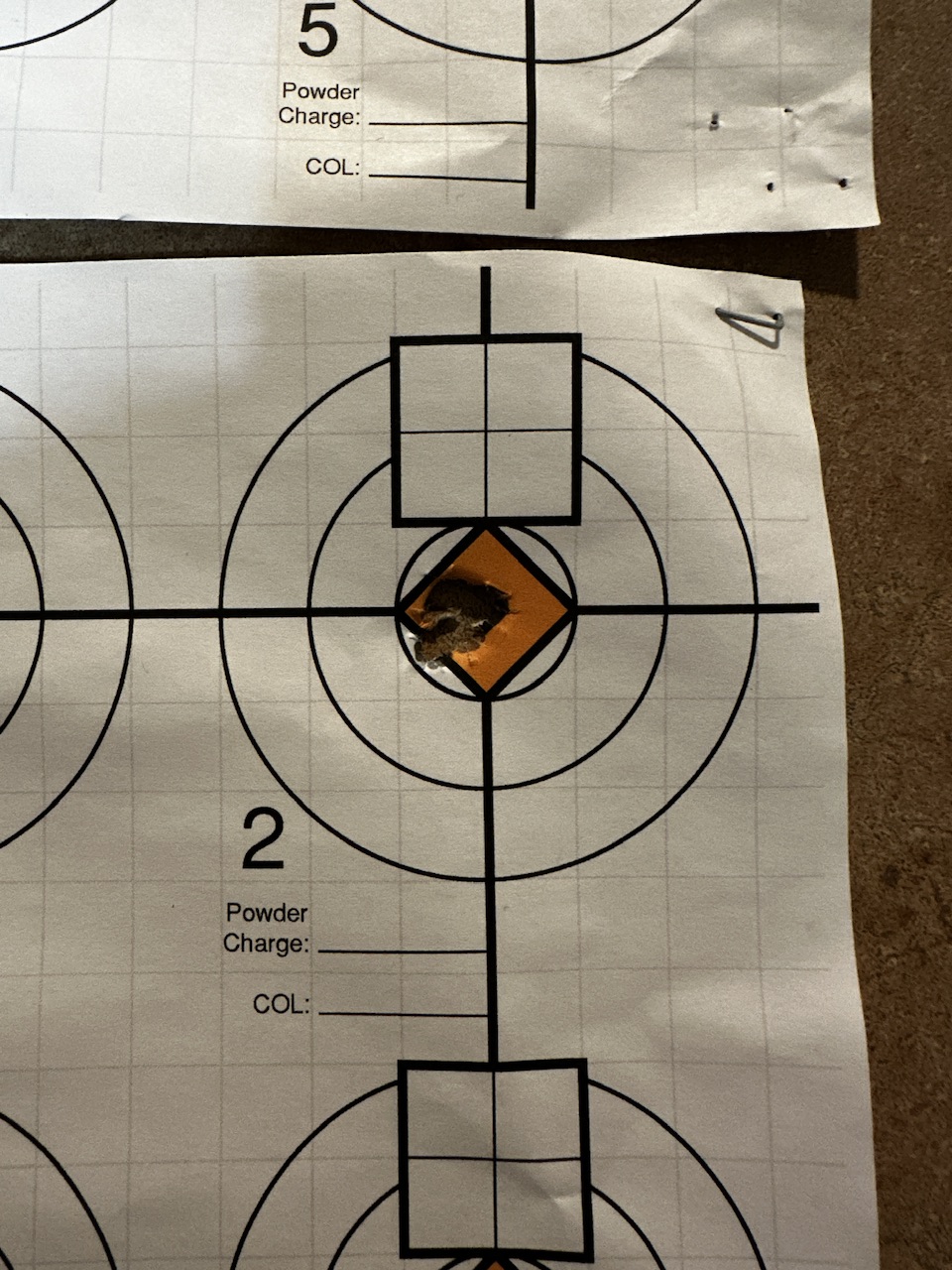

Here’s an actual group, but I’ve only been, “allowed” to have gun for “five years”, so clearly I don’t know what I’m doing.
I’ve been around firearms my whole life.
That comment probably wasn’t towards you then. we’re all shooting single hole groups at 100 yards on our best day. It means nothing to compare a single group on paper that’s why we’re talking sd and es

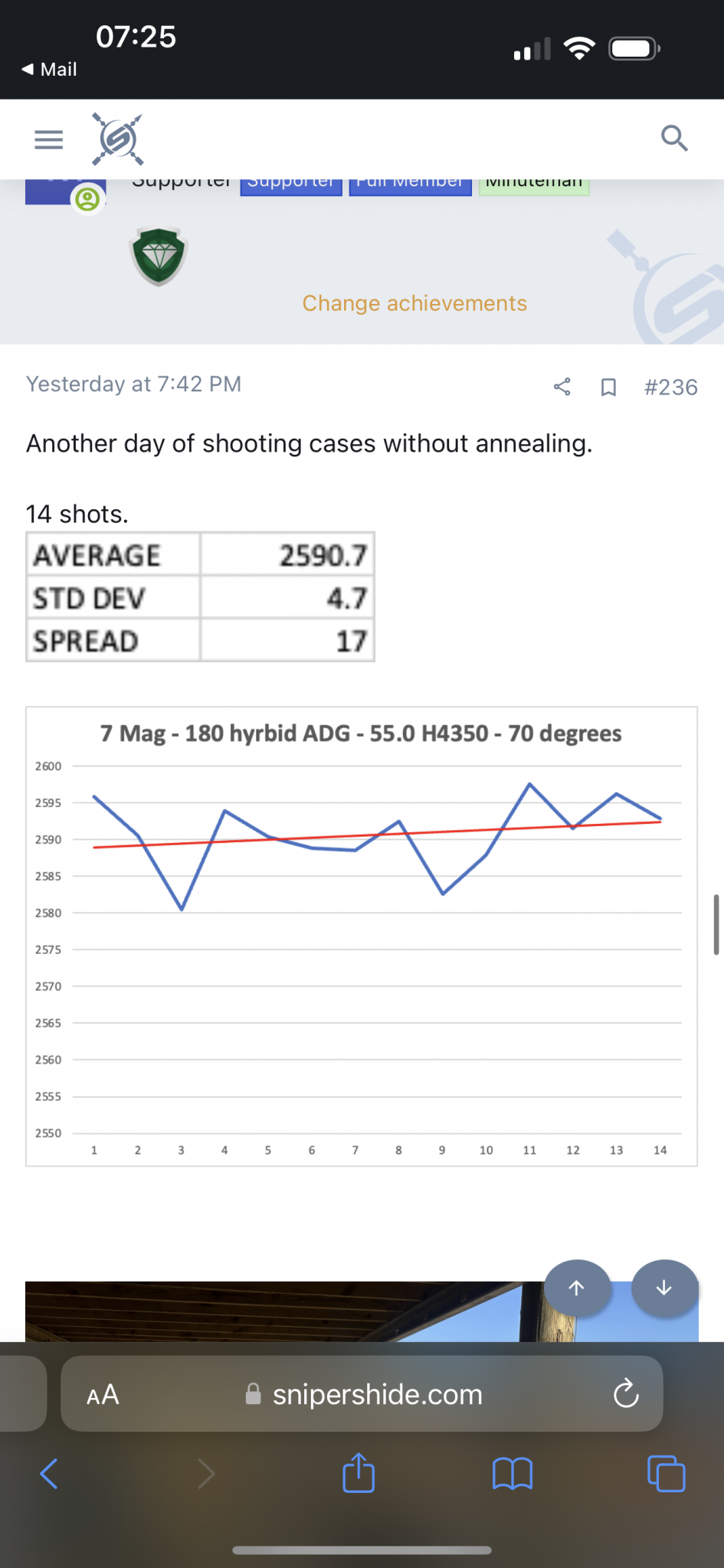

If I don’t anneal I find 5-7 reloads is all I get at full power before the brass is not ductile enough to maintain the same neck tension. That’s the whole point of annealling. I don’t know how shooters do 10-20 reloads on the same case without hardening the brass. Lapua brass isn’t cheap enough to throw away after a half dozen firings if it can be consistent for many more.
Reactions: Tokay444

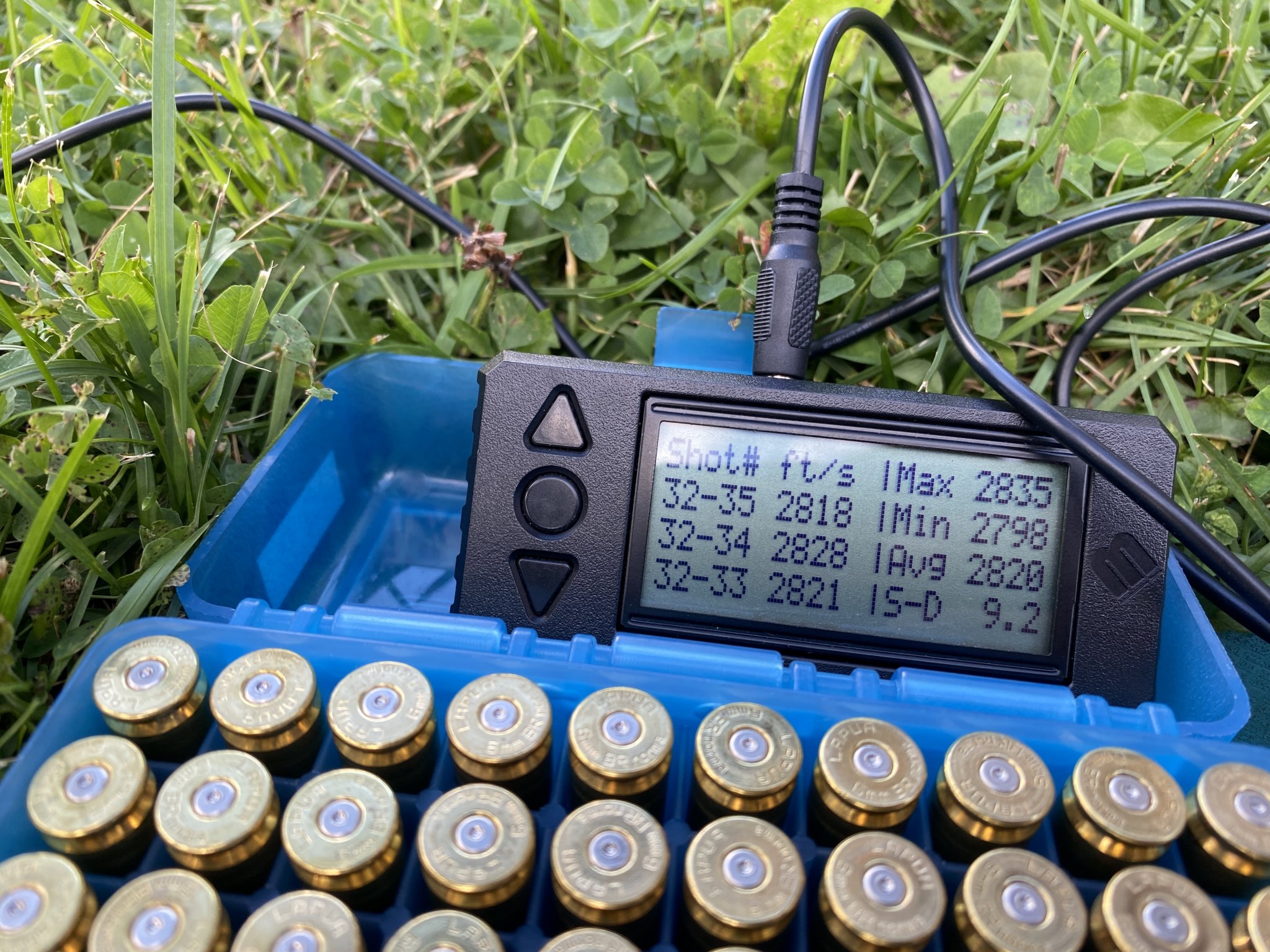

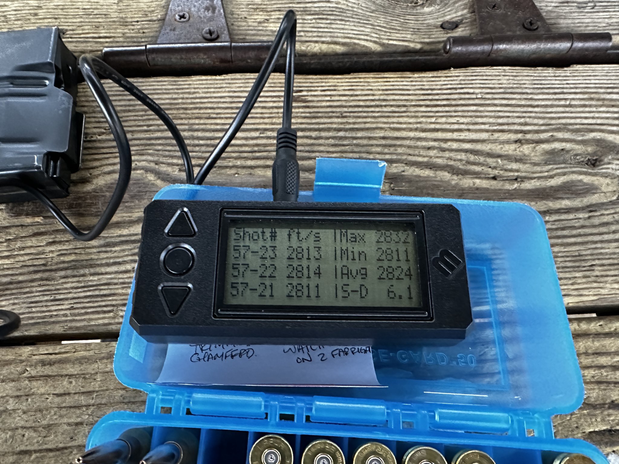

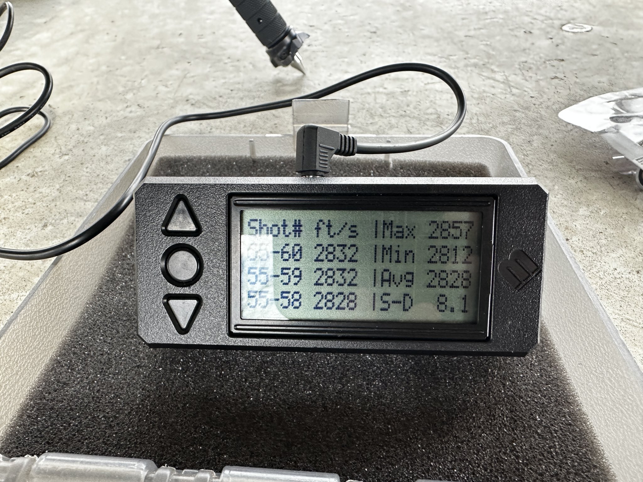

I’m getting under 7sd with 5-6x fired brass through a supressor. I think the neck tension is okay. Just checked the brass I sized and 15/15 are at .335 the exact size of my whidden bushing. Never annealed - if there was a ductility issue, we would expect it to have more spring-back to the original size?
I think it is somewhat well-established you can easily get 10+ firing from Lapua without any issues? the amp testing at least did that without issue. I buy enough brass for 10 firings on a barrel then I throw the barrel and brass away - won't your primer pockets give out at some point around 15-20 anyways? is hardening the neck really that good if you continue to the point you have inconsistent ignition, believing the brass is? fine? at some point you need to toss the brass before it opens up.
I would love to see someone anyone shoot 10 five shot groups in a row and count every shot, not well I pulled that one or that is a flier I won't count that one and see what they average. I would be willing to bet most could not average under a MOA and yet there are so many all over the internet posting tiny benchrest type groups they shot off a bi pod and rear squeeze bag LOL.

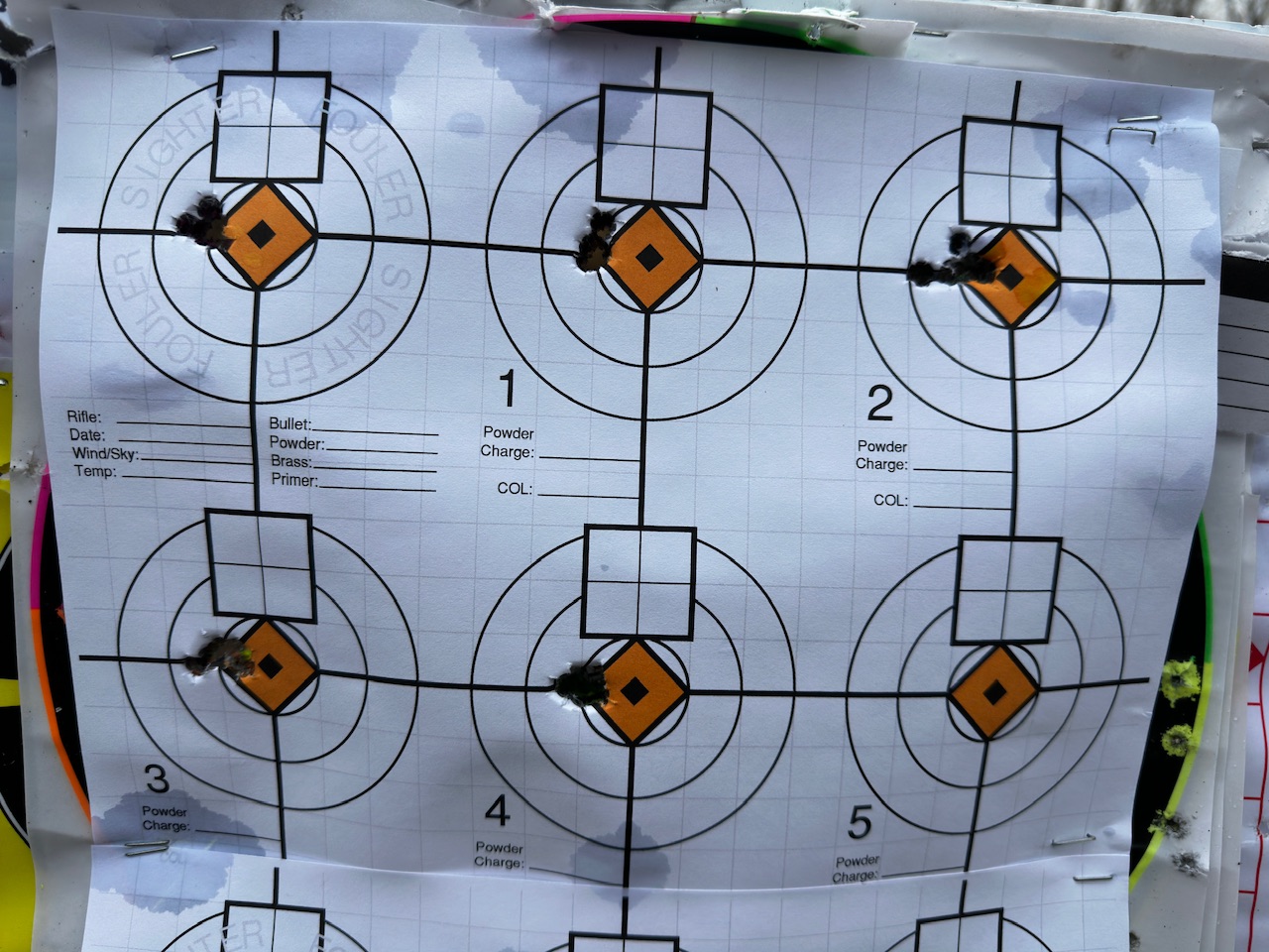

Here’s 4x5 shots and a 10 shot on the last target, as I’m moving seating depth from .025” jam to .010” jam, and then reshooting 10 shots at .025” jam, with freezing cold hands.
And then this is a second confirmation group of 10 shots.

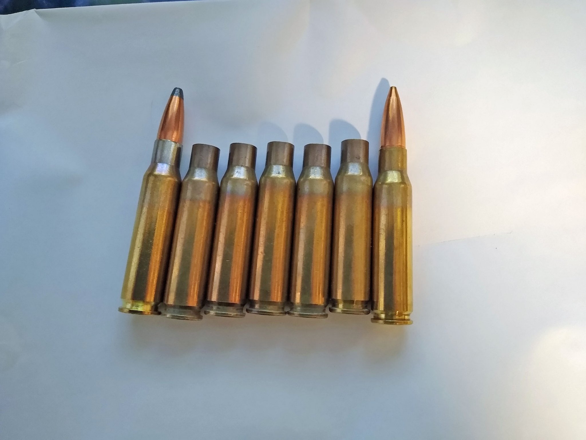

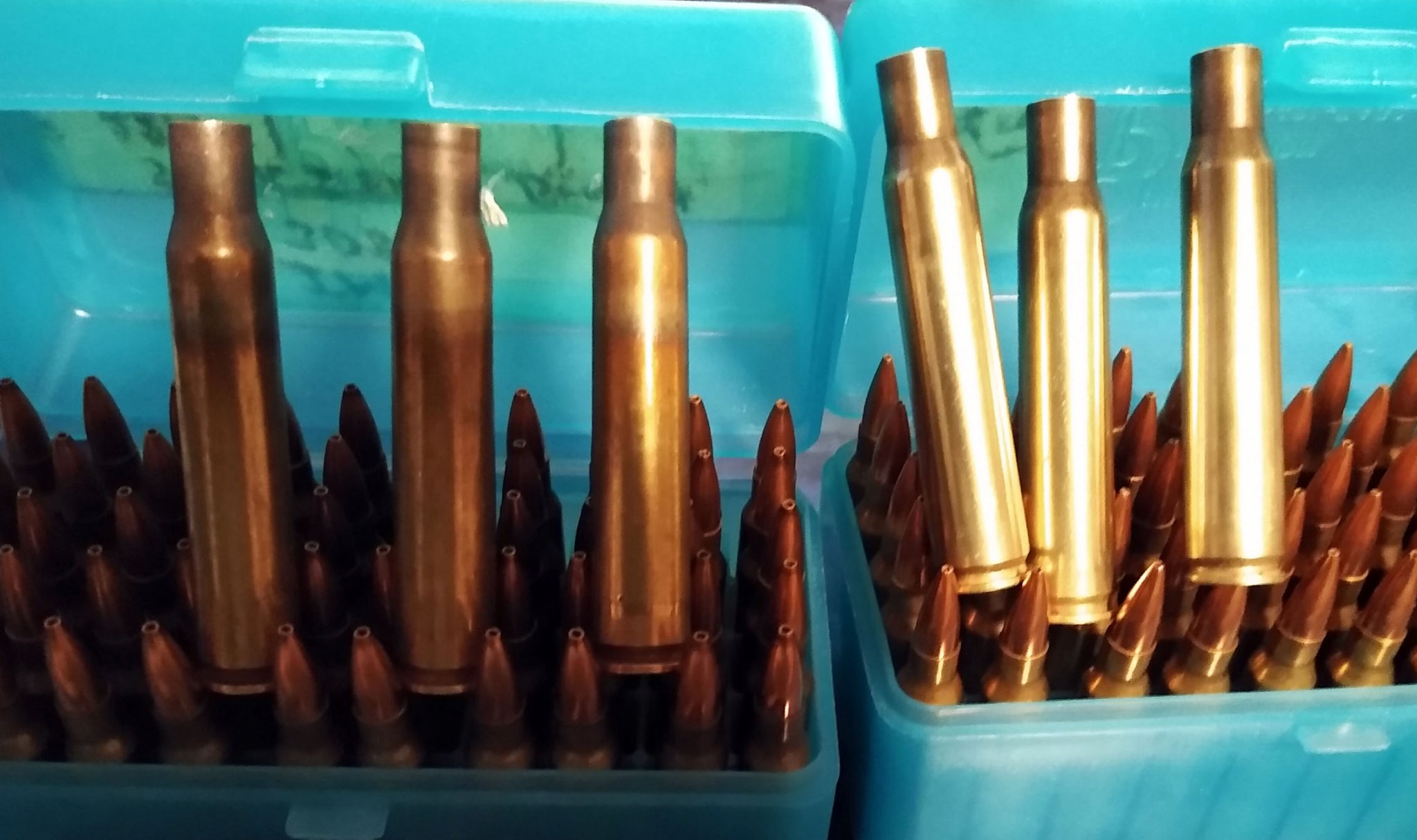

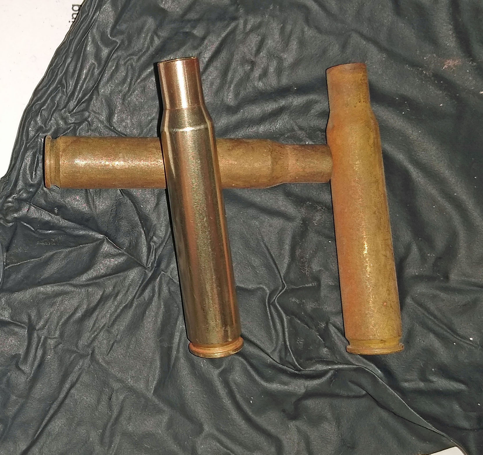

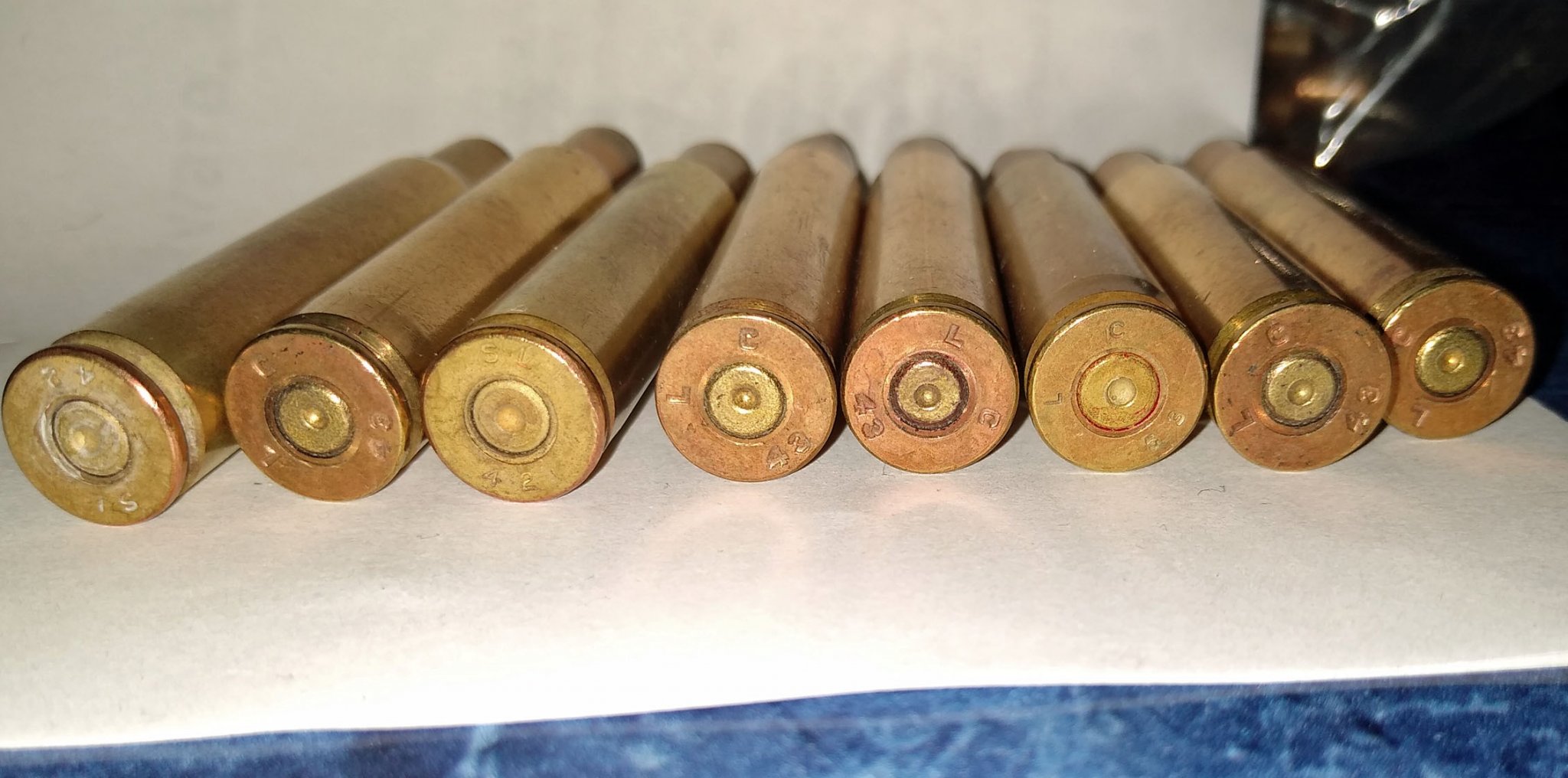

I've gotten #28 near full power reloads on 1942-43 original .30 Cal M2 once fired cases ,that I cleaned and induced neck shoulder ductility too and haven't lost a single case . Not even a torn rim and I'm still reloading those cases and hopefully will for another #20 reloads .
I've gotten #48 reloads out of MY 7.62X51mm LC match cases and retired them as I found #2 were thinner than I liked . I run most of MY Old cases through My M1 Garands and M14's . I do run additional AR10 style DPMS 7.62X51mm as well as 6.5 CM along with several AR-15 platform semi's and keep ammo separated ,as chambers are Not same .
Whatever works for any of you is OK by Me ,one simply can't pull the wool over this old Wolf's hide ; I've been in far to many herds ;)
