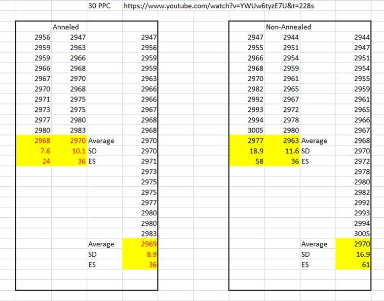

Yup, his results are similar to what I got on paper doing the same kind of test out of my .308, though I did mine outdoors where environment was not so controlled . . . and, I flame annealed. In addition to the difference I got on paper, I also got the very similar difference in velocities.
See his numbers below (shots not in his order taken so to get ES):
While Lou obviously knows what he's doing when testing, unfortunately these four 10 shot groups really don't tell an extremely convincing. For example, let's say you have a load that has an average velocity of 2970 fps and a 10sd. As in, your actual SD is 10fps.
You can run a sim of 3000 shots and break those into 30 ten shot groups....and about 10% of the groups would have an SD of 13 or higher. Up to around 17 or more fps for an SD. If you run a 95% confidence interval for 20 shots and a 9 and 17sd, they do have some overlap.
So, his test definitely points to and suggests that annealing made a difference, it's highly likely the difference isn't as large as almost twice the benefit on muzzle velocity.

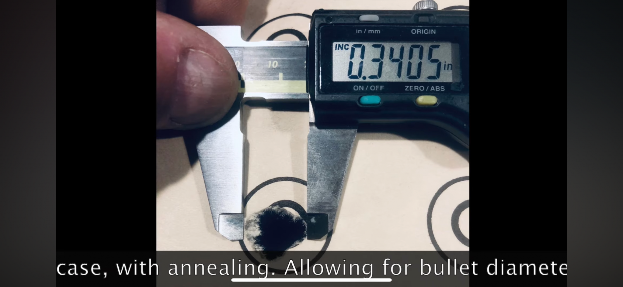

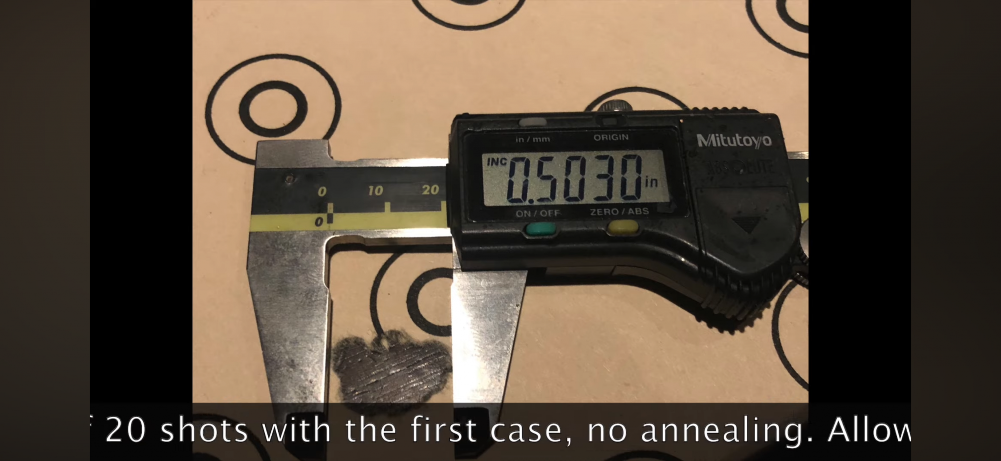

Some thoughts from watching some of their YouTube videos.
1. Lou got 20 firings with non-annealed lapua (cuts against longetivity argument)
2. The “testing” lou appears to all be based on 100 yard group size and no Doppler or chrono
3. Lou is using moly on every case (I’m not familiar with anyone still using moly?, did he moly the non-annealed?)
4. The group size difference was all in horizontal dispersion not vertical (I would be looking for vertical if consistent seating force was the expected outcome - pics attached)

If it were repeated over a large sample I might give it merit but I’m not attributing that horizontal dispersion to annealing based on 40 shots.
He also used two different actions for the testing and although he may be an extremely talented shooter there’s still room for some human interference when you’re looking at groups this small you can’t assume things based on 2 small samples.
That said the book did arrive so maybe there will be additional testing
Reactions: Haney

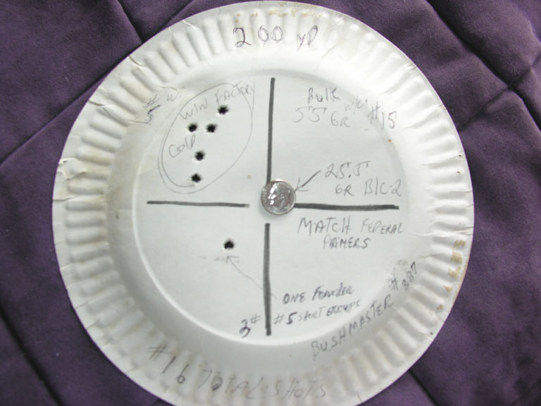

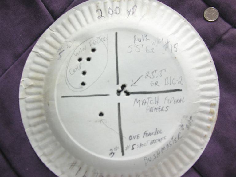

IF what YOU say is true , WHY do #2 of MY Bushmasters ( #5 serial numbers apart ) prefer Different loads as well as Powder ?. Same barrels twist length made same day by same guys and air gauge superbly consistent and are accurate in their own right .
Because they’re shit guns.
My Bushmasters are circa 1993 and again 1999 . Bulk 55 gr. using BL-C2 25.5 gr. Shot Win factory strung up left quadrant . One of MY re loads as a fouler lower left quadrant aimed purposely . Then #15 into a ragged hole a dime will cover at 200 yd. leaving change . With Nikon scope . :cool:
That's Minute of Dead at 600 800 or 1000 yd. in MY book :)
