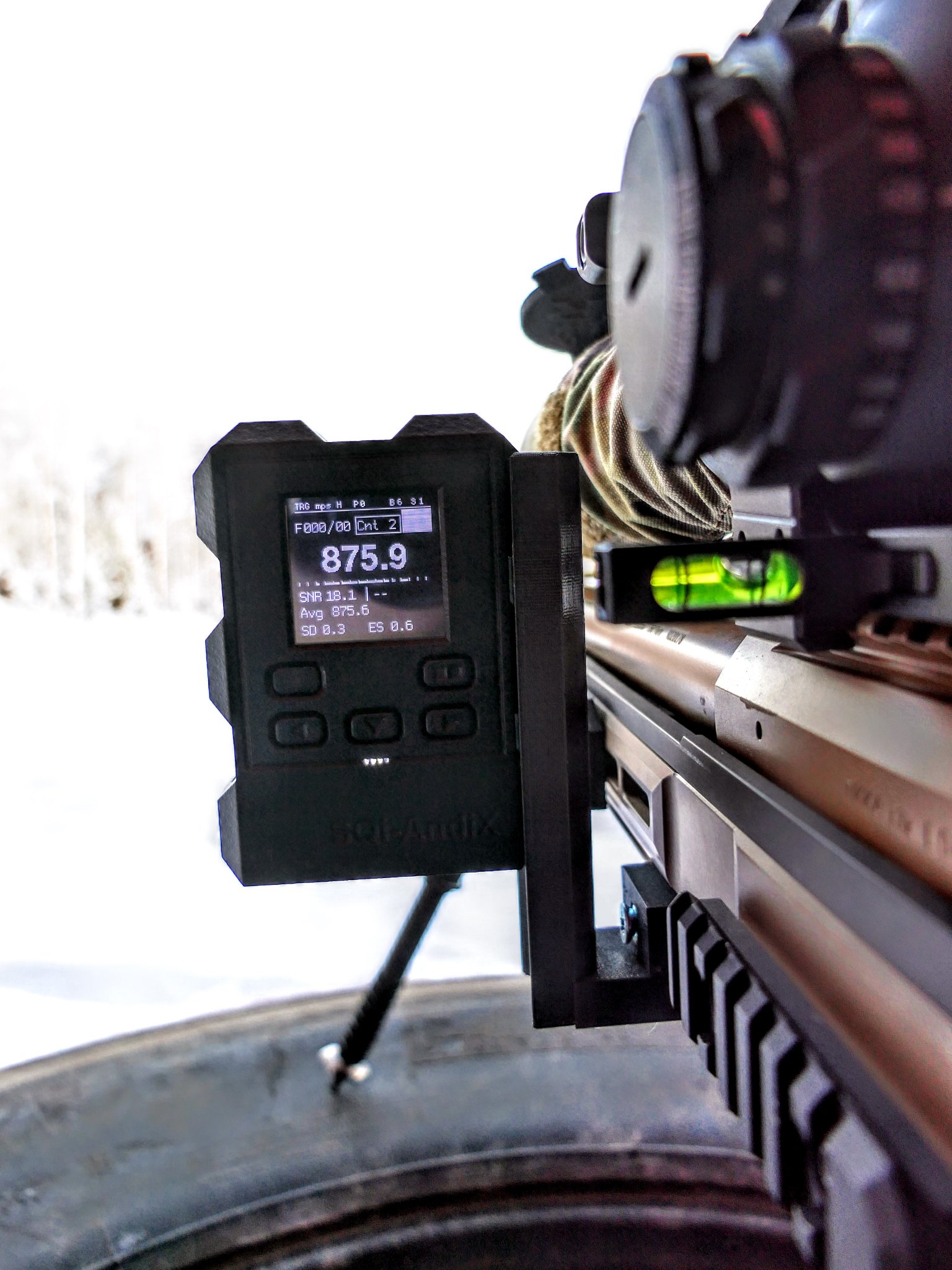

AndiScan and Bulletseeker Doppler
Cleaned my 6.5 Creedmoor barrel, and it did slowdonw quite a bit.
You can use Andiscan in many type of research in guns&stuff.
Tested my Krieger SS barrels yeasterday with 136 Scenar-L bullets.
AndiScan took the readings.
I am having the new FX True Ballistic radar on test too later on this week.
And my friend has my old LR, if hi got´s time, it would be nice to have these 3 on the range at the same time.

Andix SQI new SW
features and mentioning the that it is Mark-ii major upgrade and the
beta testing is running.
here is the list of new features:
A2/Mark-ii - A2.5.33C/A2.4.33C [beta-2]
(0) FW Compatibility
- US_A2.5.33+ requires TXR_A2.4.33+
- When upgrading from previous versions, both US and TXR must be
upgraded at once.
- Compatible with all HW A2.2. All A2ii features are implemented as SW
upgrade compatible with all A2.2 HW (all production units manufactured
after 7/2022). All current AndiScan A2 users can easily upgrade to
A2/Mark-ii.
(1) Triggering by Signal detection
- A2ii can now trigger by direct signal detection as an alternative to
standard acoustic pressure triggering.
- Configuration screen C2 allows to set either standard acoustic
pressure trigger (ACST) or signal detection trigger (SIG), both in 10
levels of sensitivity.
The highest level 10 is extremely sensitive and is intended only for
very special conditions.
- When signal detection trigger is selected, the measurement screen
shows two SNR (signal-to-noise ratio) values. The first shows the
standard measurement SNR the second shows the signal detection SNR. The
higher both values the better. Values above 20 mean high signal quality.
(2) Series data autosaving and current series editing
- A2ii autosaves the series data to SD card after each shot or after you
edit (delete) shots. At the end, it is finalised by a manual save
[Next_Long] which also opens the new series for recording.
- Autosaving slightly increases processing time after the shot by about
20-40% (depending on number of shots in series, type of SD card and
state of its buffer). It also creates and occupies new folder even if
the series is not finalised by explicit saving or all shots are deleted
from series (it will create file with 0 shot count). Autosaving can be
switched off in C8 configuration screen.
- Active series measurement can be browsed directly in the measurement
screen by [Back/Next] buttons. This browsing mode is indicated by
showing the shot number (No) in contrast with showing total count (Cnt)
when the screen shows the last measurement.
- Arbitrary shot (either the last one or any previous when in browsing
mode) can be deleted by [Back_Long] press.
- The series is finalised (no further editable) to SD card by
[Next_Long] press.
(3) Extended H measurement range
- The signal processing in H (High) measurement range now allows for
speeds up to 1500 mps.
(4) User interface improvements
- Main measurement screen is simplified and has much larger fonts for
easier reading. The original one can be chosen as an option in C8
- All configuration screens now have more intuitive editing. Pressing
[Enter] in the given configuration screen activates editing mode and the
current edited fields lights up. [Back/Next] change the parameter value.
Another [Enter] press either leaves the editing mode or activates
another field.
(5) Factory defaults reset
- A selected configuration profile can be reset to factory defaults (by
erasing its CONFIG file) in ConfigProfile selection screen (accessible
by keeping [Enter] pressed during Welcome screen).
(6) Expert mode
- Expert mode is now needed only for selecting L (Low) measurement range
and for Manual (MAN) measurement mode. All other configurations are
available in Standard mode.
(7*) [will be in beta-3 release] Bluetooth (BLE) connectivity
- The A2ii can be connected to external device (any of iOS, Android,
mac, win) by BLE interface. It allows to fully remote control the device
and access the data stored on the device.
