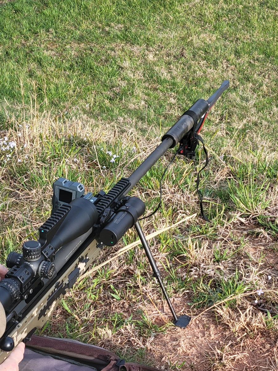

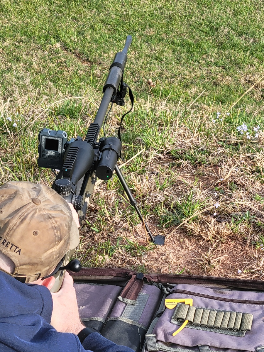

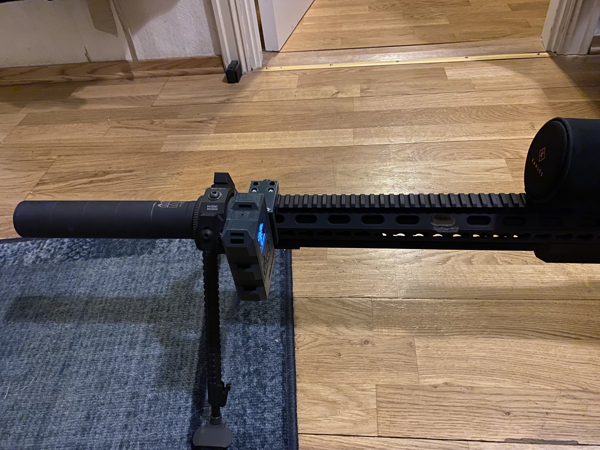

Got my Andiscan a few weeks ago and got around to trying it recently. Before purchasing it I had been worried about having issues with both the Elite Iron bipod and the suppressor would make positioning on the rifle to get a reading difficult.
The first position I tried as in the picture provided a reading as well as a strong SNR value from the first shot. I have only run through 20 shots with the Andiscan rifle mounted, but it got good readings on all and no dropped shots. So my first impression is very positive.

I got my Andiscan sitting behind an Area419 Hellfire Match brake and a Fortmeier Bipod - both of which are a nightmare for radar to get behind. With the exception of 1 shot (the guy on the lane next to me fired like a fraction of a second before me) it picked up every single shot.

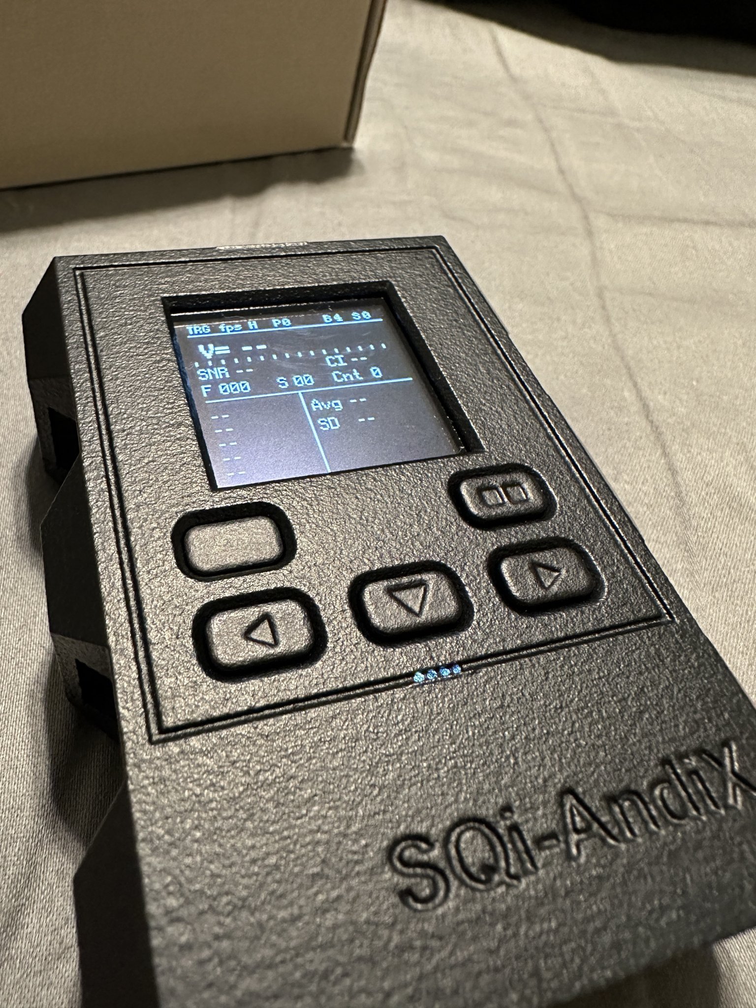

I have the andi Sqi and I really like it . It was a bit over whelming at first but once I went through it a few times it’s not bad . I had a few problems with it not triggering a response when other people at the range fired at the same time so I emailed Jan and he had it updated and running great . its a small company and the owner will do what ever necessary to get it working and make you happy . But my only complaint is I hate the 3d printed thing especially the mounts . I want to order a few extra mounts since they’re so flimsy and it $110 euros shipping plus $ 60 for the mounts . Dose anyone make better mounts out of metal or even have 3d printing file so I can have them made state side for a fraction the cost ? Wish I was more handy there a market for better mounts

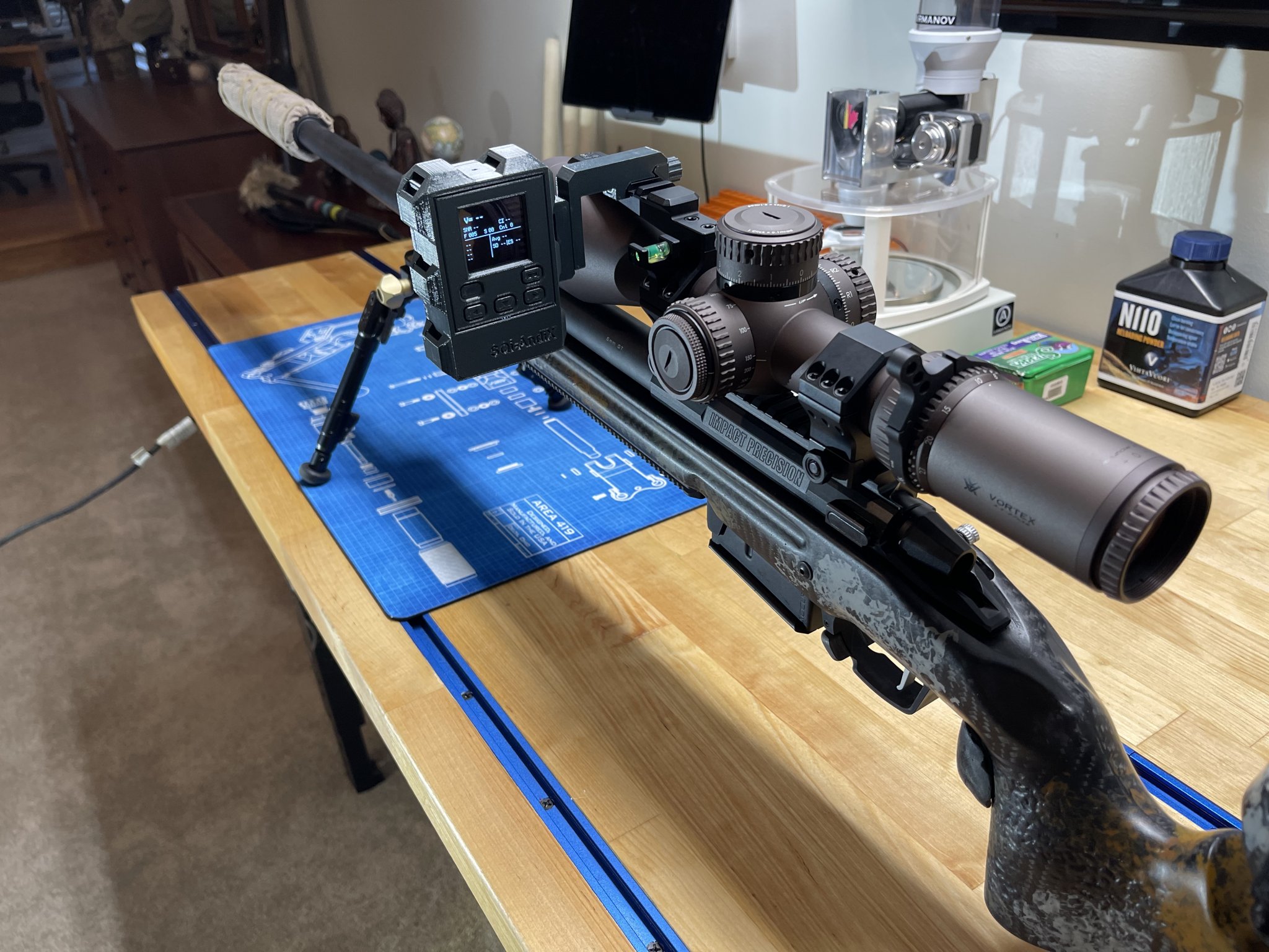

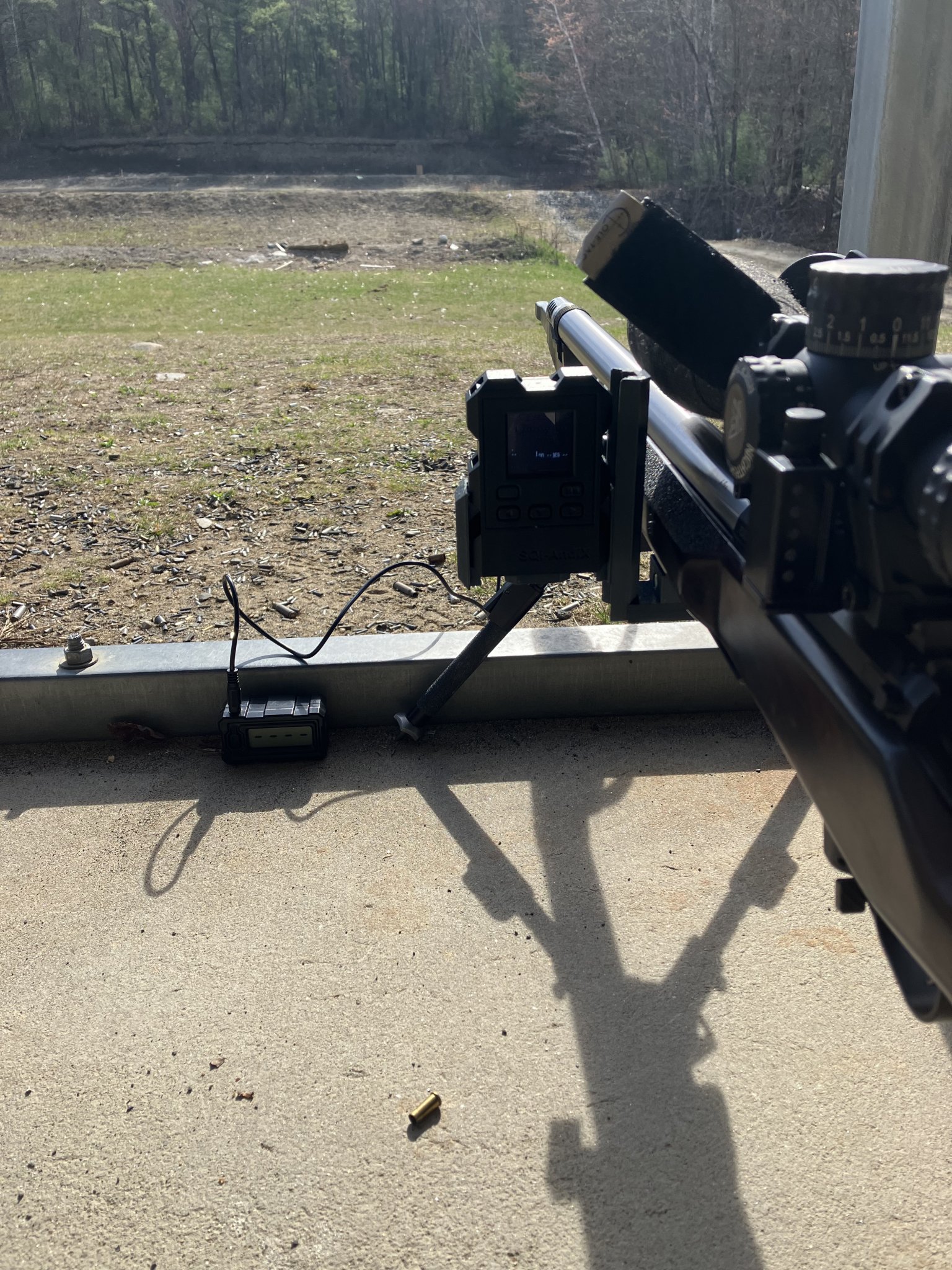

Took it out for first time this past weekend and at first I ran it alongside my magneto. all shots fired were within 2 fps of each other.
After initially placing it alongside my scope and missing a few shots I moved it all the way towards the end of my arca rail and it didn’t skip a beat.
I was also happy to see that the newest generation has a much nicer housing versus the grey 3d printed ones I’ve seen.

I was also happy to see that the newest generation has a much nicer housing versus the grey 3d printed ones I’ve seen. View attachment 8122401
You have the newest firmware then (2.5.0/2.4.0).
The new case is definitely nicer than the former. My buddy also got the newer ones and it's definitely an upgrade. Almost tempted to hit up Jan and see if an upgrade is available, but shipping may not be worth it. 😆

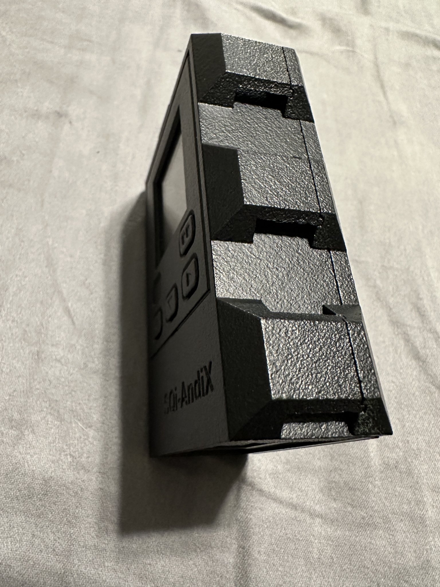

I didn't like the printed mounts either. I took my printed mounts to a hobby machinist and he made me some out of aluminum for $100.
When I talked to Jan about using metal mounts (which I was going to make) he said the plastic mounts are designed to break before the case. If the case breaks it's more difficult to repair vs the plastic mounts.
Reactions: Spuzzcat
Parshal, thanks for the info. Maybe I will stay with the plastic mounts.
