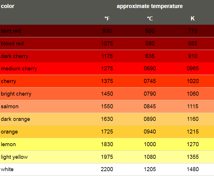

Maybe show us on the chart what temp your brass is glowing like a light bulb filament at. ITs not light bulb filament because that is about 4600 F.
At least salmon & higher. Metal glow colour is an estimate but, all I'm after is that the brass reaches at least 800 C.

Held by hand, you are maintaining 1400F on a piece of brass for 15 seconds by holding the torch a certain distance from the brass. :ROFLMAO: :LOL: :ROFLMAO:
Are you holding your hand held thermometer with the other hand? Salmon is 1500, light filament is 4600F. The second video 10 seconds is cherry 1200-1350 about. Everything past that had zero seating pressure. Salmon zero seating pressure. He also didn't shoot them.

At 1000 F the brass is barely beginning to recrystallize. I know you're feeling the heat but, brass can & does take far higher annealing temps during industrial forming processes. Where do think I'm getting the information from?

A while back testing brass using a salt bath I ran the salt at 1040 F and immersed test brass cases
for 30 seconds and I believe 45 seconds. I used 750 F tempilaq on the case head to check if enough
heat migrated to the head to cause it to anneal.
With my setup the case heads did not reach 750F. I loaded and fired the cases and there was no loss in accuracy.
I annealed thousands of cases at 1040 F @ around 10-15 seconds and have never had a failure of any kind.
One particular batch of 6.5 creed was loaded and annealed 36 times using this process.
Now as far as heating them to 1400 F I am not so sure that is a good idea, especially with a flame as you have
no idea what temperature the brass is reaching as the water is drawing off the heat.

I did a similar experiment, but used 450 tempilaq - I didn't see enough heat migration in normal anneal times to reach the case head either. I didn't shoot the brass after though, so I cannot speak to accuracy.

What are you using to heat the case @ 1400 F for 15 seconds? I think if you are here to change the annealing game, maybe you should start your own thread rather loud mouthing this old thing.

Anyone who wants know..... Heat one up until it "glows like a light bulb filament." Heat it up to salmon color. Then smash it with your fingers. Take some good brass and a good load heat it up cherry red and go shoot it. I have done both of these things. 918v is pretty much right on the money, as far as what happened to my accuracy, and I bet he told you that because he either did the same thing, or helped someone who did.
Just out of interest, you have maintained that brass is ruined if it gets to much over 1000F. So you're stating here that, in spite of your diligent belief, you chose to heat a case to salmon colour & crush it between your fingers then, heat another to cherry red, load & test fire it?
Tell me, when you took the case to cherry red colour, did you do so with the case head in water or, did you just wing it?

If you are lighting up your cases like you say, then they are trash. MAP gas is what I use to trash a piece of brass to make case length gages, and I don’t even heat them up for that long! I do that to over soften the necks so it doesn’t have as tight of neck tension. If I took a normally annealed piece vs one that I’ve trashed, the case length gage is noticeably more difficult to remove.
