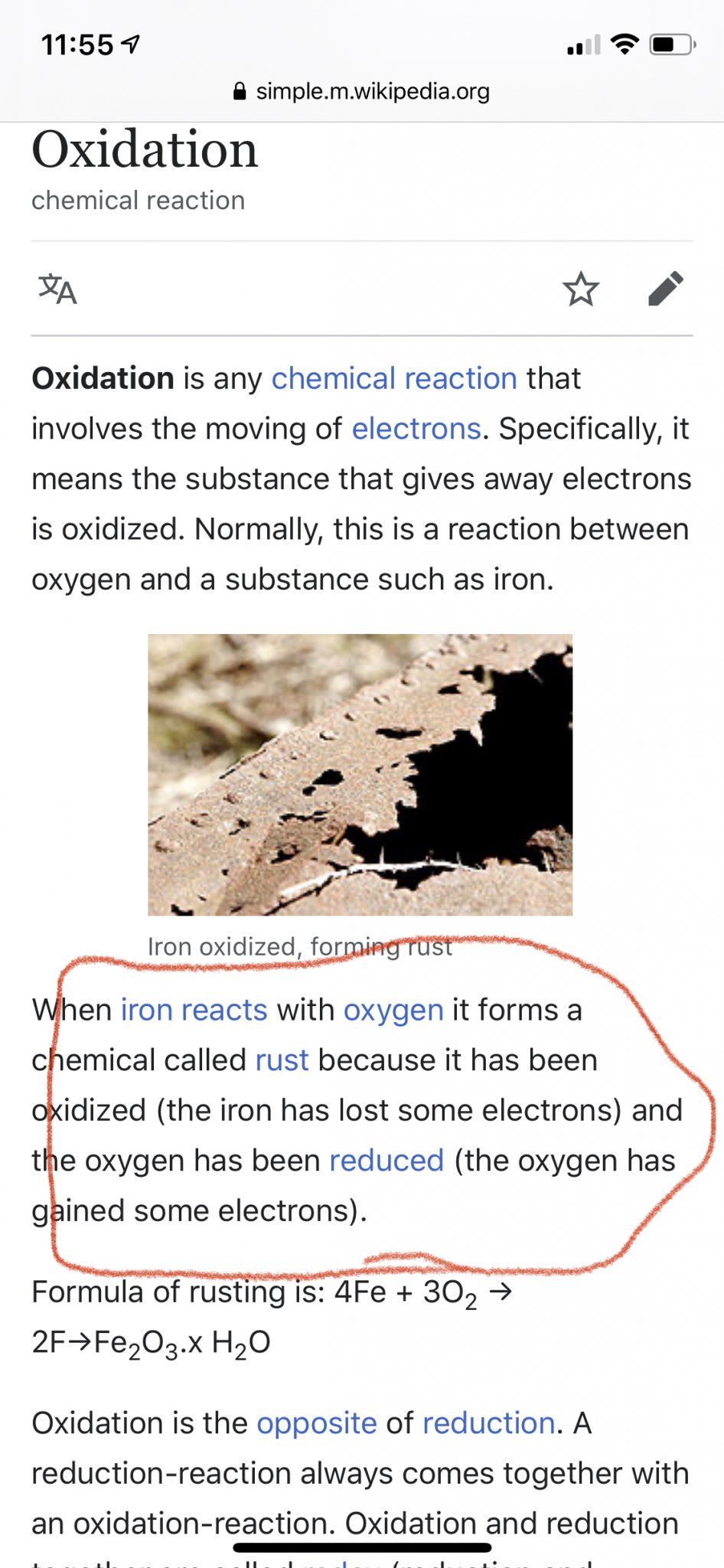

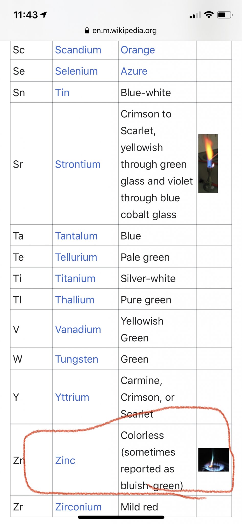

Re: burning away elements in brass - What is burning away in the brass? I thought the flame color change is usually from the brass oxidizing - removing the oxy from the flame mix.
High temperatures can produce toxic metallic and/or metal oxide fumes (mostly Cu2O & ZnO).
From MSDS.
Oxidation is the loss of material.

The link i provided is about oxidation not rust. Here are some more. You can go as deep as you want
We can mince words and say oxidation doesn't remove material, Ok oxidation does not remove the material. Wiping the oxidation off removes the material.
Oxidation is degradation.
No oxidation is the process of loosing electrons, rust is the product when it happens to iron.
I don't think what you are seeing on the case after the orange flame up is oxidation. Some one please support their hypothesis. I can't find anything to support the hypotheses that what you are wiping off and calling oxidation is oxidation.
Since I said it first - I don't have any proof. I offered it as an alternative to the original proposition that the flame was somehow 'burning away material' or 'producing oxide fumes.' Since only about 5% of oxide fumes come from the piece being welded, and the vast majority of welding fumes come from processing the welding consumables, I don't find it a satisfactory explanation. I propose it's similar to forge scale - which we see when there is incomplete oxygen burn happening next to hot metal. Copper 2 oxide is produced by heating copper, which produces black oxide. It was an easy logical leap to make.
Makes me wonder though, If we pushed more o2 to the flame would it still turn orange mid way through the 20s burn? And if it does stay blue, is there also a decrease of black coloration on the case? @Barelstroker , want to run that oxy acetylene torch with a large excess of oxy?
That would be more plausible as well as being being supported visually by what we see on the case after the flame up. I set up my time by brass color. Generally that flame up is around the dull glow I would look for. I don't think there are too many people shooting the difference between annealed, and not. I think a lot of people are probably loosing primer pockets before their brass needs annealed.
