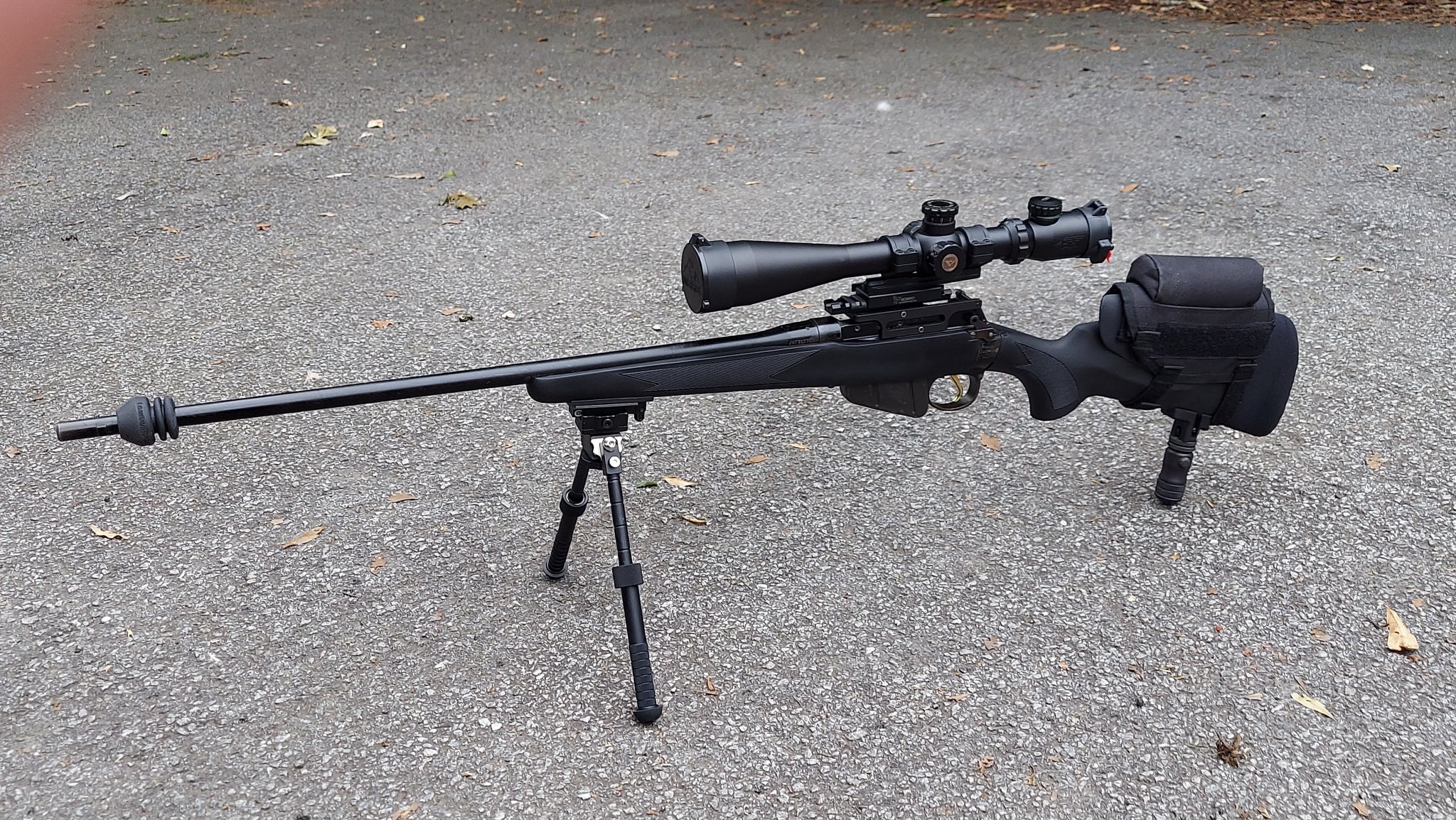

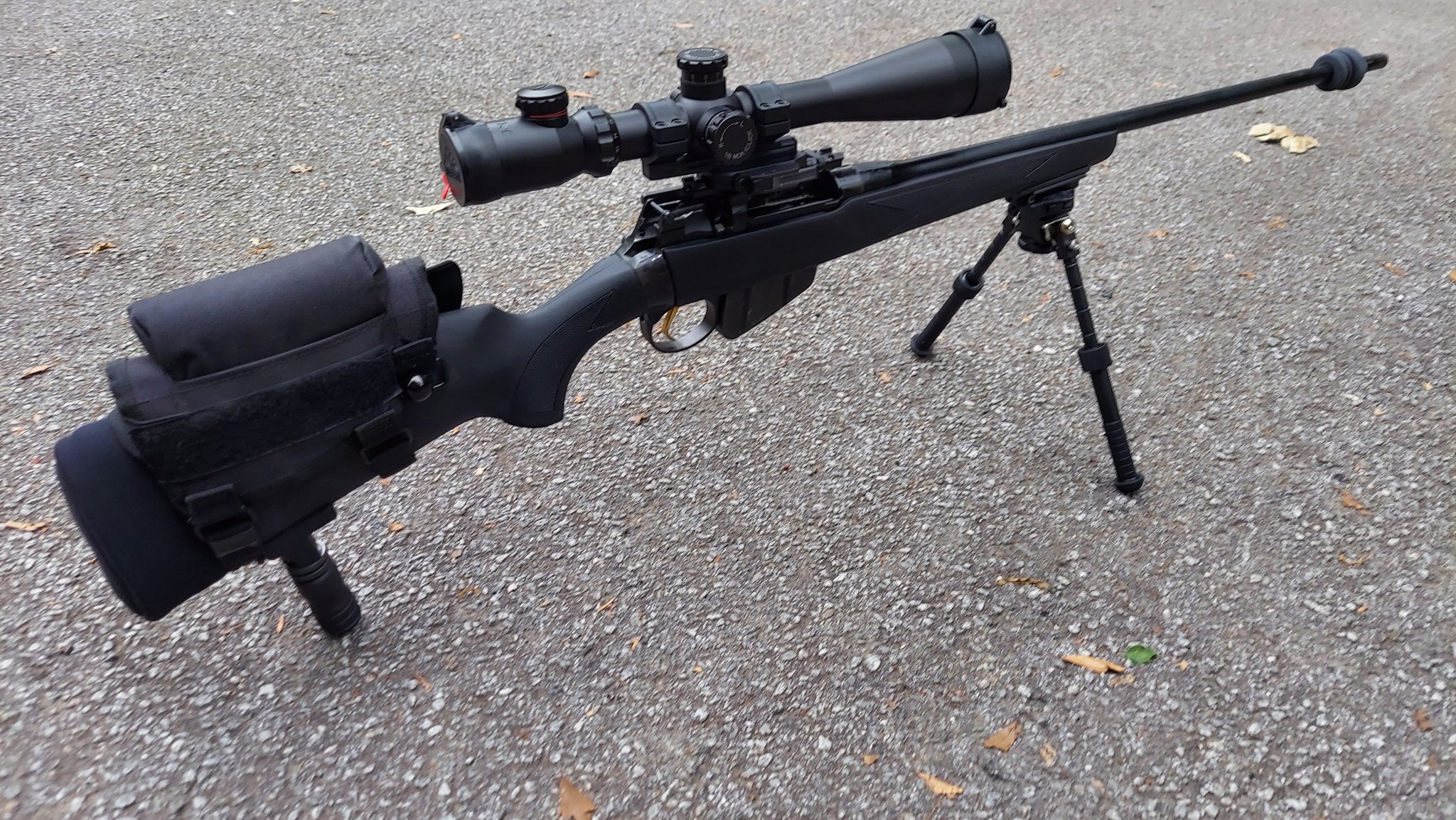

Hmm. I have a few ideas about this rifle, @Secret SQL .
1. Barrel doodad's affecting the way the barrel acts after the rifle's fired.
2. The stock's not properly set up for the barrel or it's misaligned with the action. Maybe warped or otherwise out of shape.
3. The height of the scope's just not comfortable and you're feeling an impulse that wouldn't be felt if it was lower and you had a better cheek weld.
4. The bag/cheekrest isn't secure enough on the stock and it slips when the rifle's fired.
Without all the wood and the extra metal from the barrel bands and foresight, it's probably somewhat lighter. Bit of extra kick combined with any of those factors might give you a problem. I'm also wondering if the barrel's the original one or not. For some reason it seems a little too long to me, but it might just be my imagination.

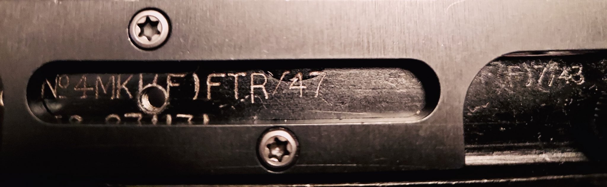

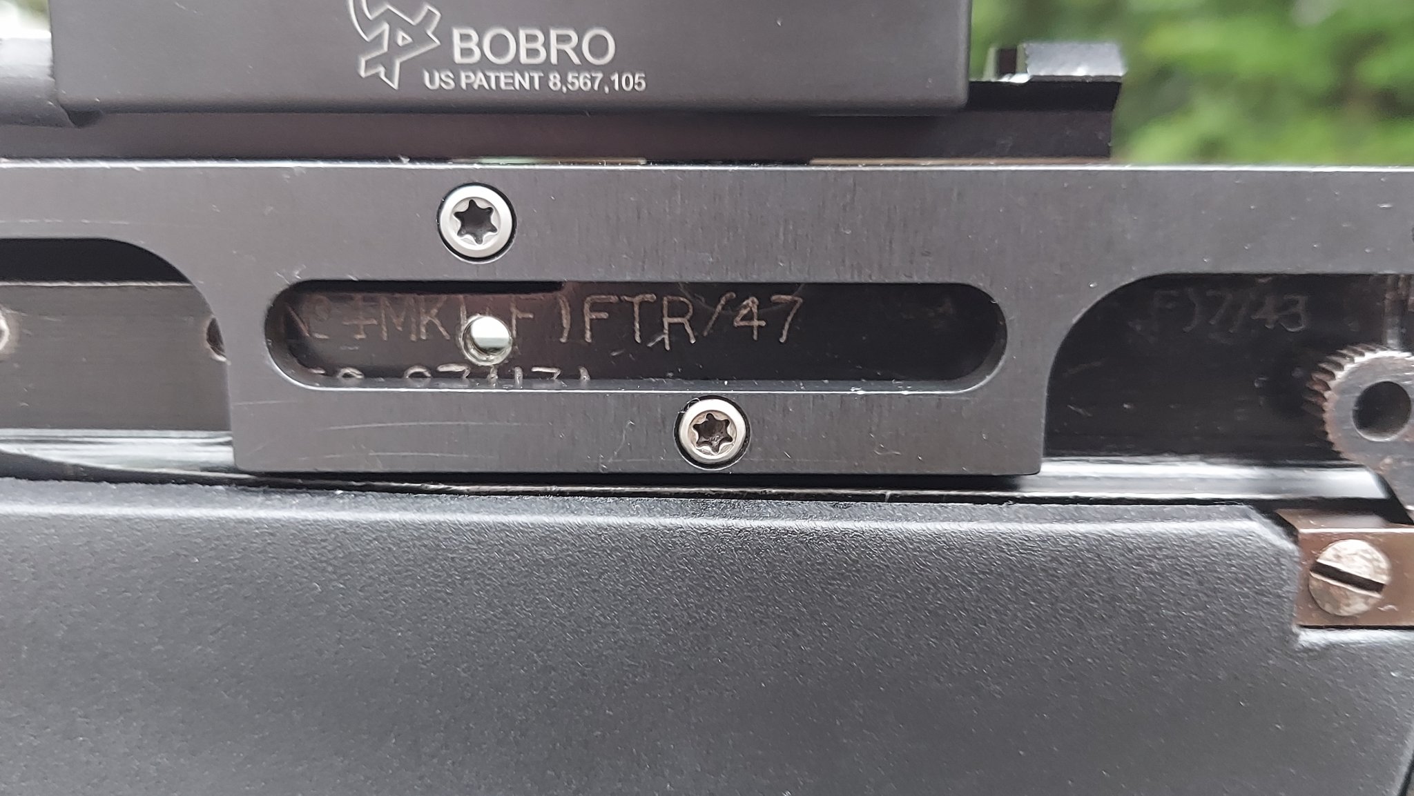

You have a No.4 Mk.1 made by ROF(F), ( Royal Ordnance Factory- Fazakerly) in July 1943 that was FTR'd, ( Factory Through Repair= means it was completely rebuilt at the factory) in 1947 by Fazakerly.

OK. I see it now. Not the MKII, but a MK1/F. Eyes ain't what they use to be, hence the gigantic frigging scope.

SQL, I'm gonna be brutally honest here...
Your rifle looks like a mall ninja fantasy piece with all that extra crap hanging to it. Get rid of it and start over.
E
Exactly correct. Although, I haven't got it tuned yet. It's a new addition. Trying to get the barrel whip under control.
That silly tuner ain't gonna do nothing but make the problem worse.

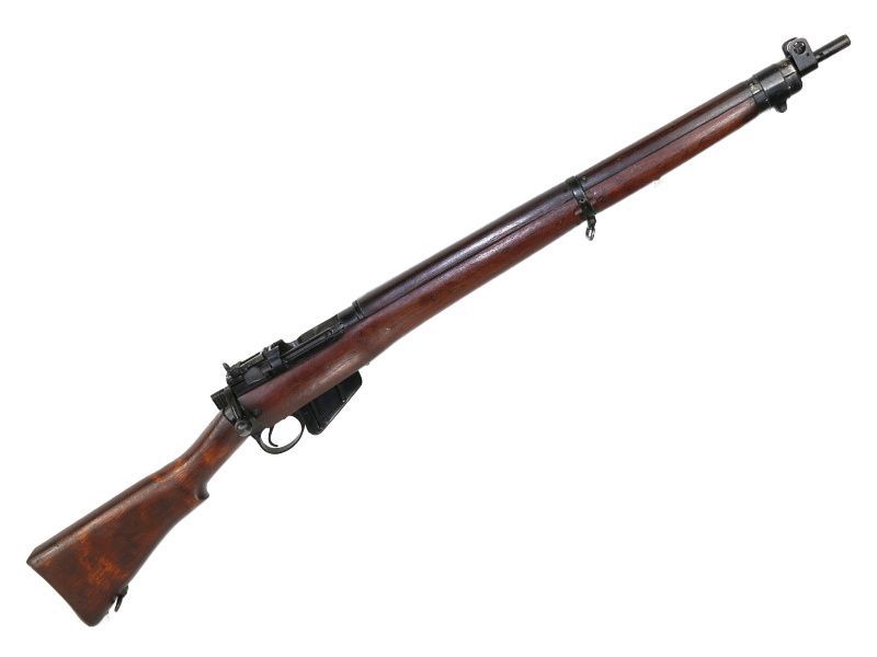

A LE No.4 forend when properly fitted to MoD spec makes light contact on the bottom of the Knox form to keep the barrels weight from stressing the action body and puts light up pressure on the barrel about 4 inches from the muzzle to keep barrel vibrations consistent.
Until you put your rifle back to the way it is supposed to be it will never shoot to it's TRUE potential.
All sorts of mods were tried by MoD REME's over the years to improve the accuracy of the No.4 but nothing was ever found to be as good as the original forend bedding method.
The No.4T sniper variant stayed in frontline service until the late 70's and there was never a relaxation in standards in the way they were set up.
