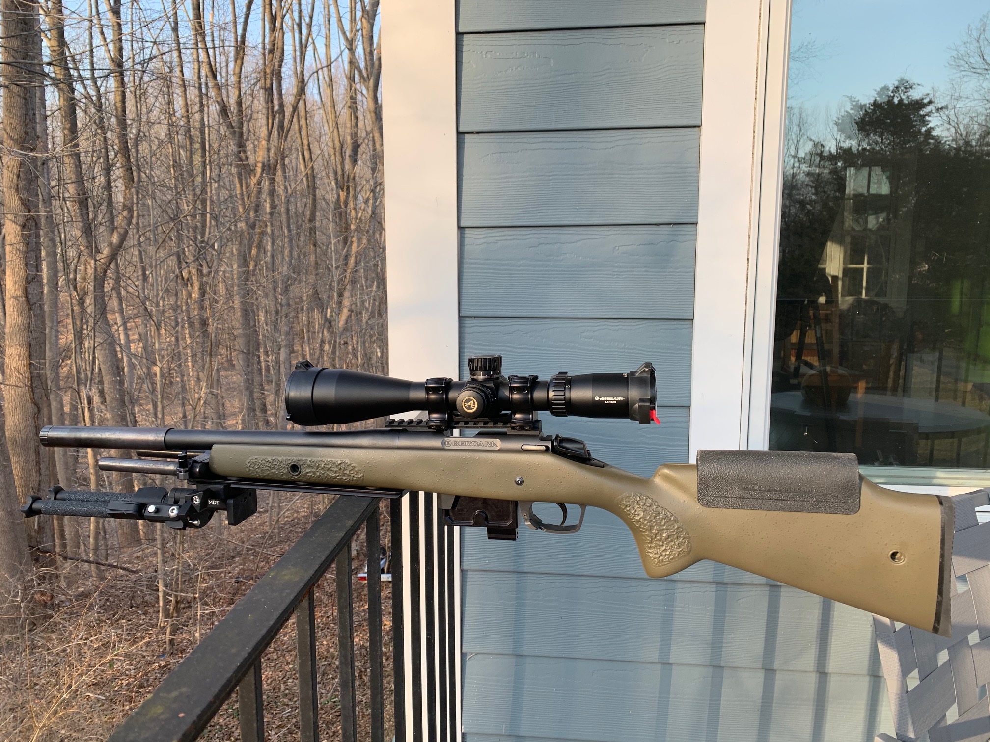

Got my cheek riser on & finished my experimental dampener (jury's still out on the dampener). Only shot to 100 yesterday cause the wind was terrible. I doubt I could have hit much a 200. Also tried a 6x5. That was humbling. Managed max CTC .505 or .964 moa @50 yards avg for the 6 x 5
The only Ammo I've tried so far is SK match. Anyone have an opinion on what these B14's like best?

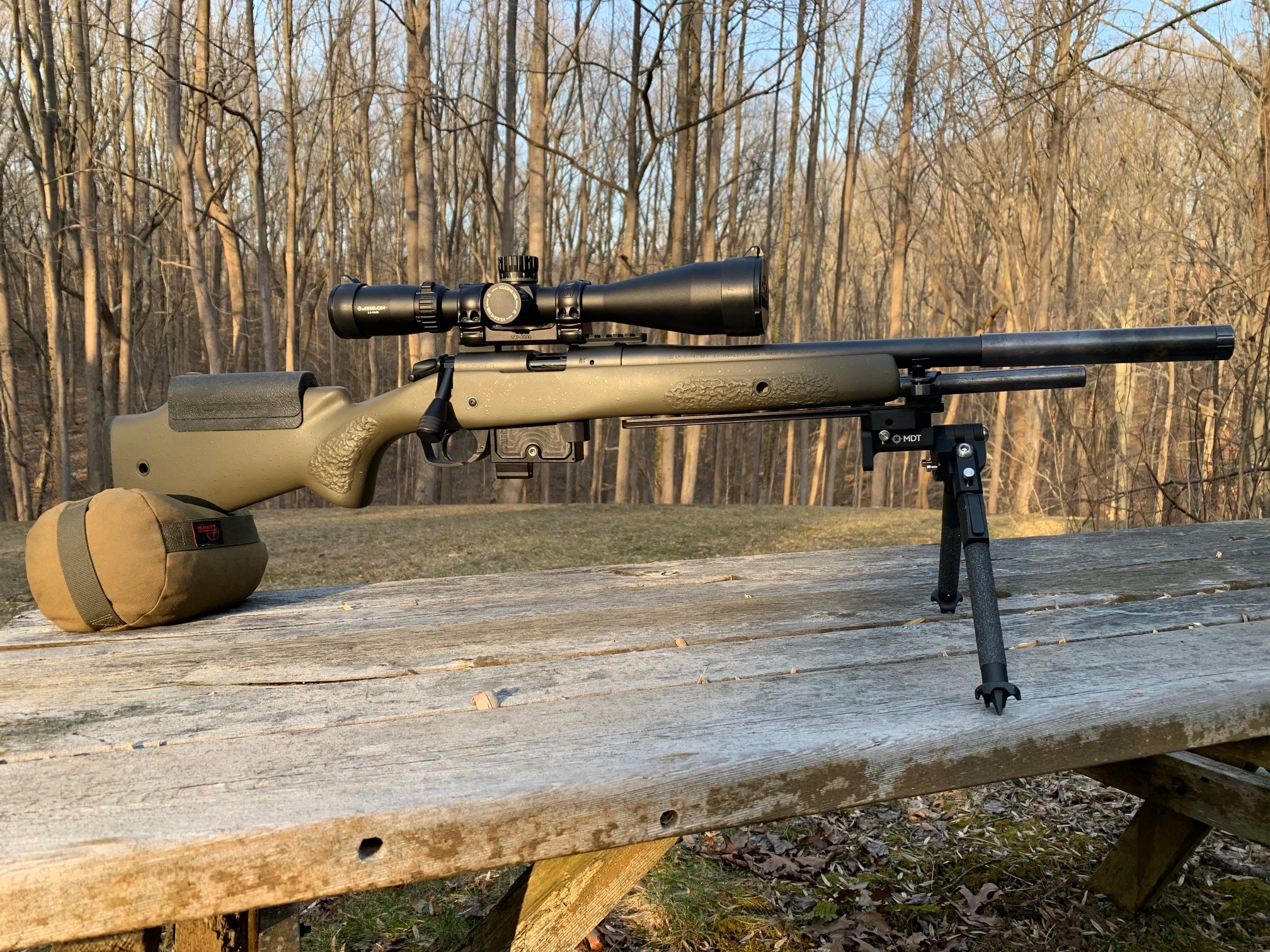

I'm sure I'd have been happy with a complete B14R, but I love to tinker & I love how this build came out.
If I did my job well, then it looks simple. I've always thought anything well engineered looks subtle when finished.
Lot more going on then what jumps out with this though.

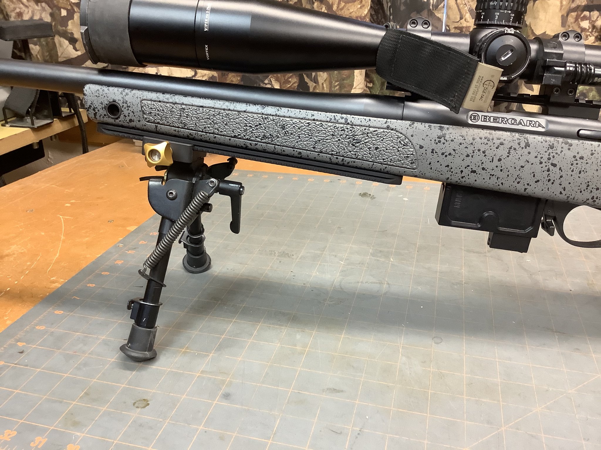

Here is mine with the 14" rail. It has been posted a lot. Works very well.
I am waiting for my Bregara to arrive and have been ordering stuff, can you tell me how far past the stock your Arca rail is ? I see you got the 14” and wondering if the 12” doesn’t extend past the end or if I would have to go down to the 10”

The 12" extends just a Tick past the end of the stock. The 14" is just over 2" past the end. There is no problem with it extending past. I liked the built in barricade stop on the 14" was the primary reason I purchased it.

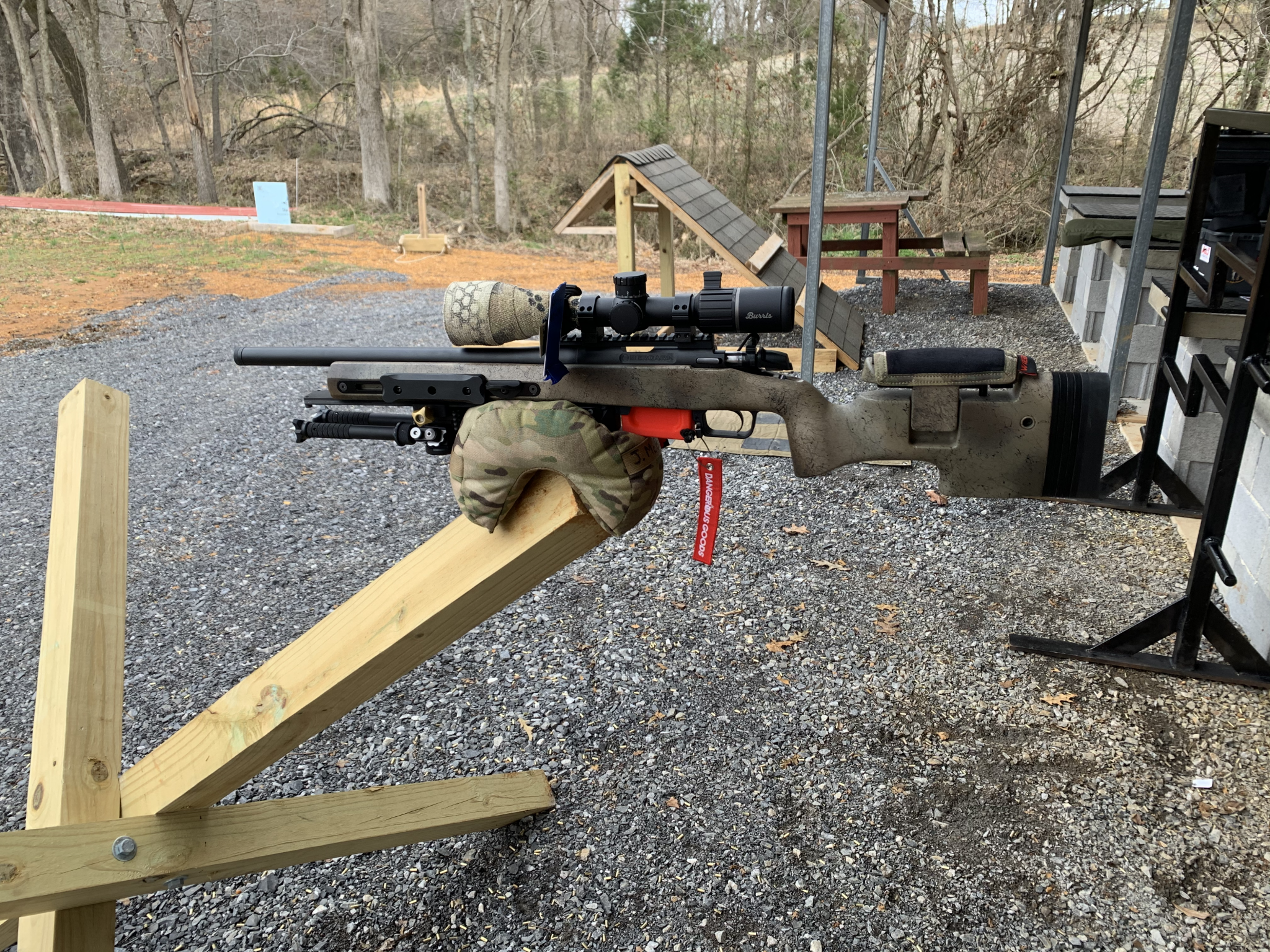

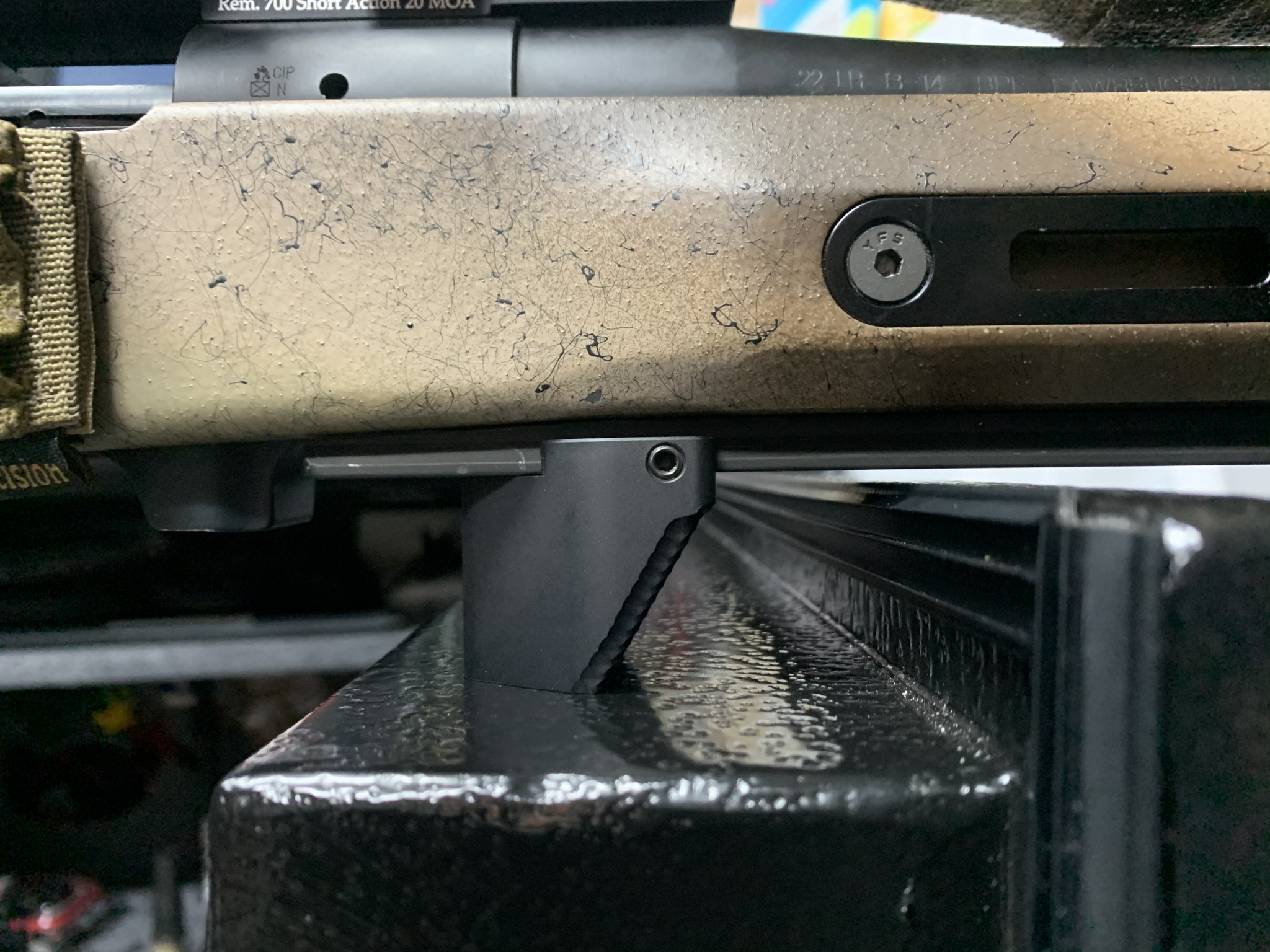

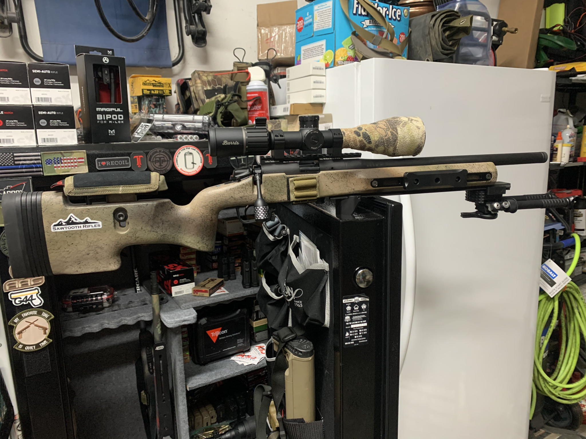

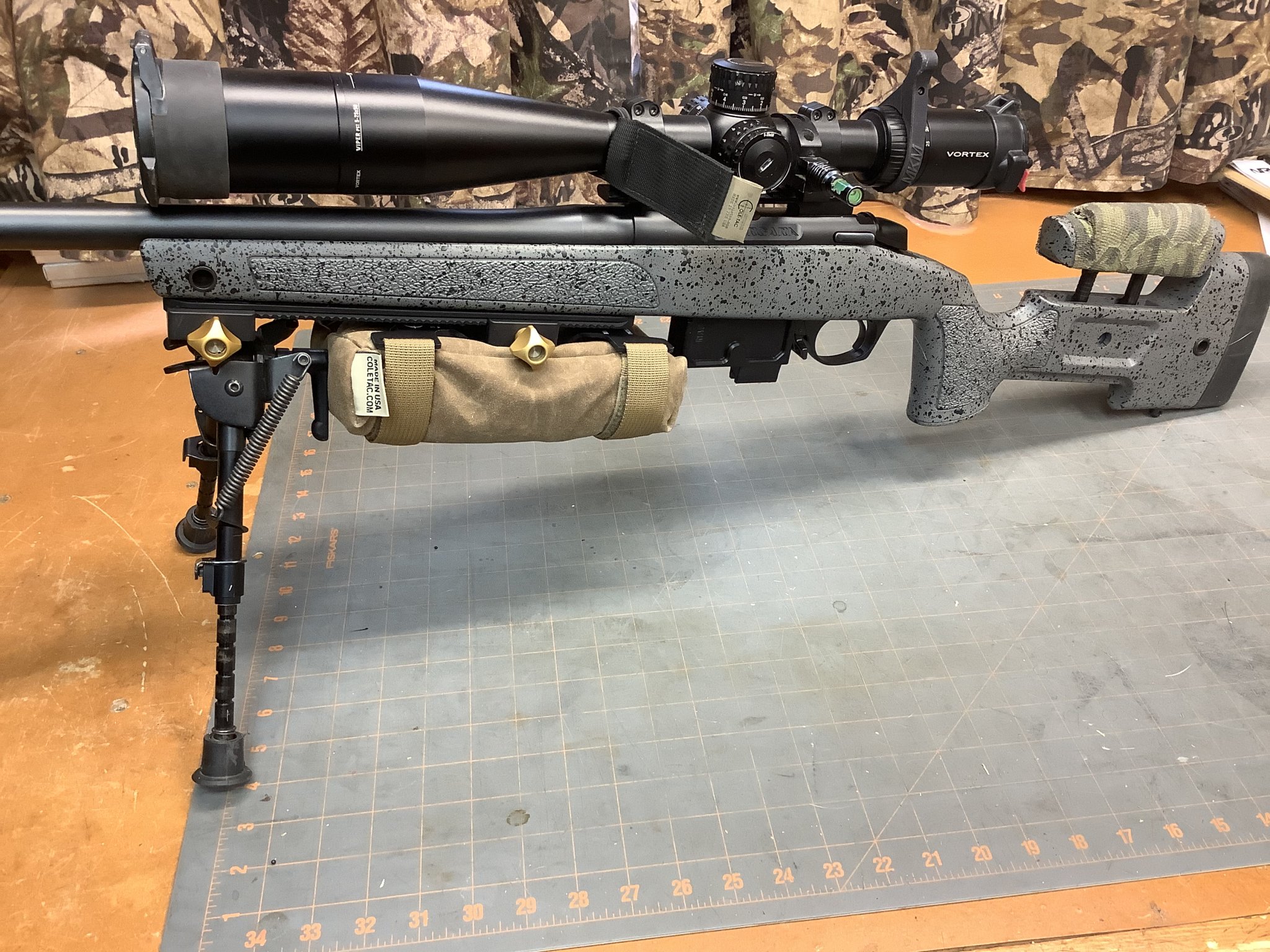

So I was messing around last night with my 308 and removed the stock to see how the B14r fit and functioned. I got the balance right with 2 large GreyOps weights. It has a Sawtooth Rifles ARCA Rail on it and Area 419 Barricade stop. It did cycle rounds without issues. Plan to shoot it some this afternoon to fully test and function check. Might just leave it this way for a while.

I put a 10” Area 419 rail on mine - like it so far. The swivel conversion for the Harris bipod was a snap.

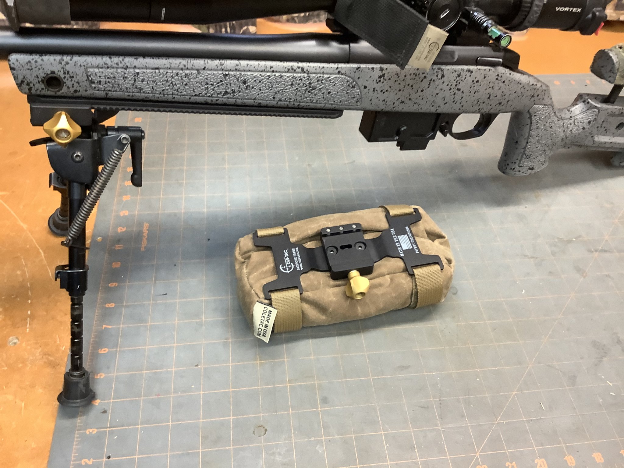

Good on the Mack Bros. Mag only used a couple of times, but with practice the changes should be smooth and quick.

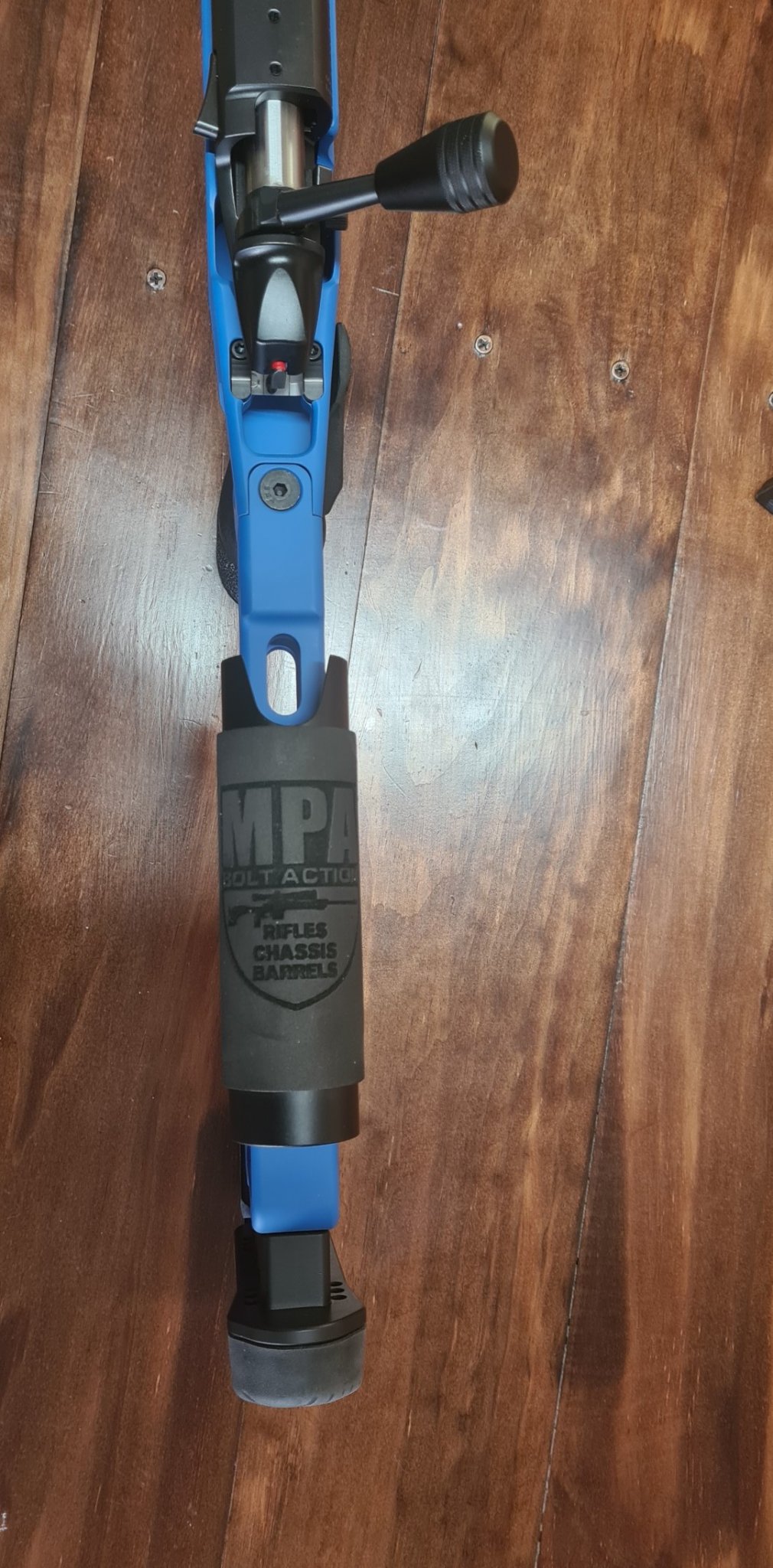

I stripped the Greyboe Stock off of my 308 to see how I liked it on the Bergara???? I can officially say I love it. I have the GreyOps large weights on the side. I have the small on order and should deliver today. I have 2 of these Greyboe Ridgeback stocks and a 3 on the way with the Vudoo. I am using the Sawtooth Rifles ARCA Rail as it replaces the factory Mlok rails and is an AWESOME fit. I will shoot my first NRL22 match in this configuration on Sunday. It felt super solid yesterday when shooting 3 different stages for March. I also added the GreyOps thumb shelf and it allowed me to stabilize the front in and take more of my given wobble out of play.

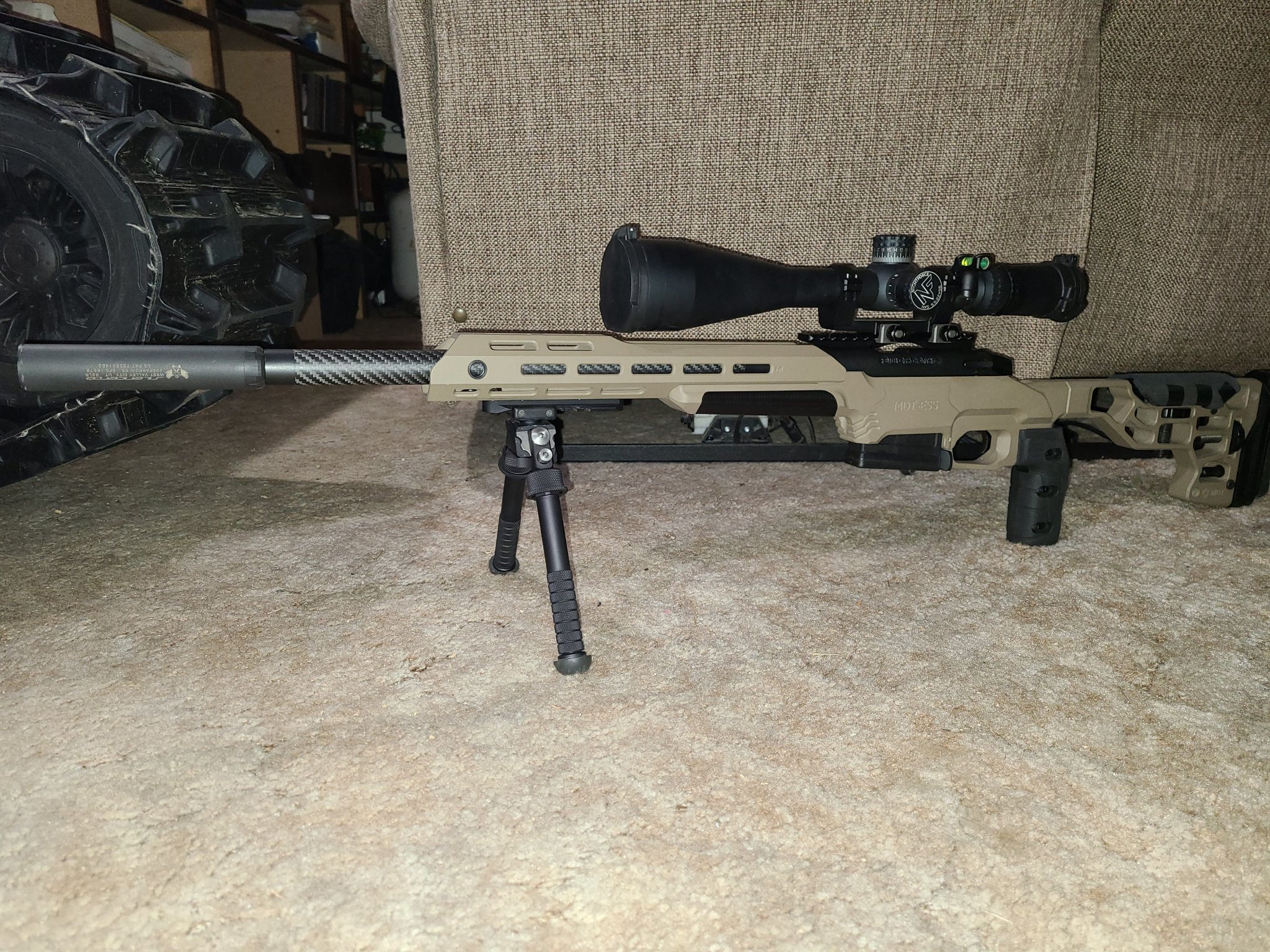

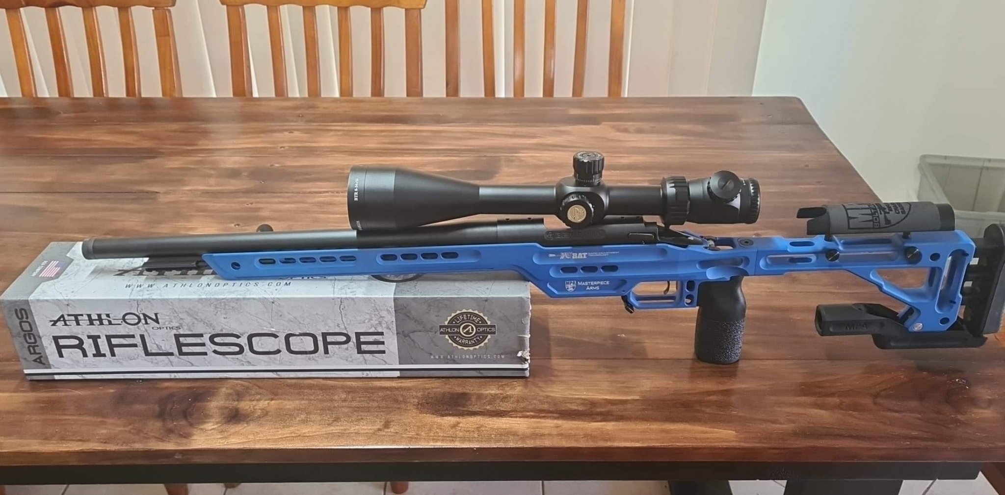

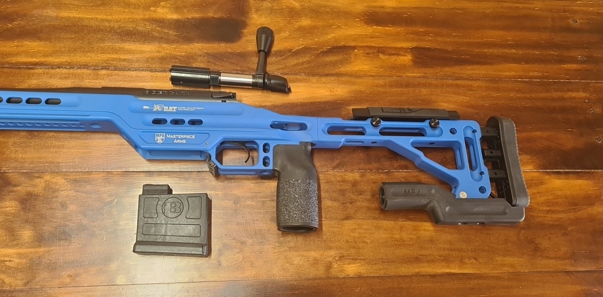

Just to keep this thread active here is my b14r in mpa hybrid chassis with athlon argos 8-34 scope.
it's been in storage at the local gun shop for a few months as my living arrangements changed and I didn't want my ex claiming I threatened her with my guns and having to them taken away.
should get a chance to shoot it next week, maybe the week after.
If it shoots as good as it looks I reckon I'm onto a winner.
