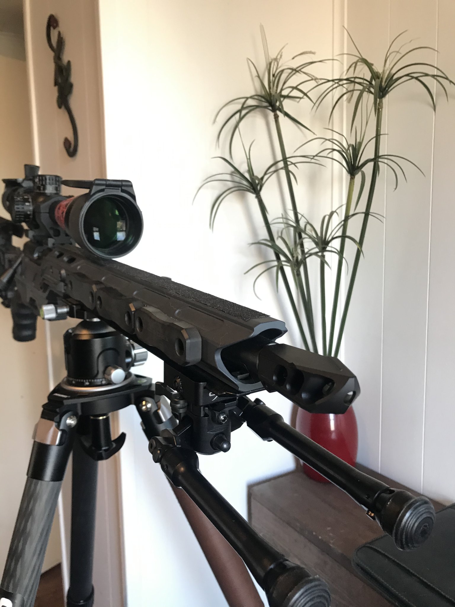

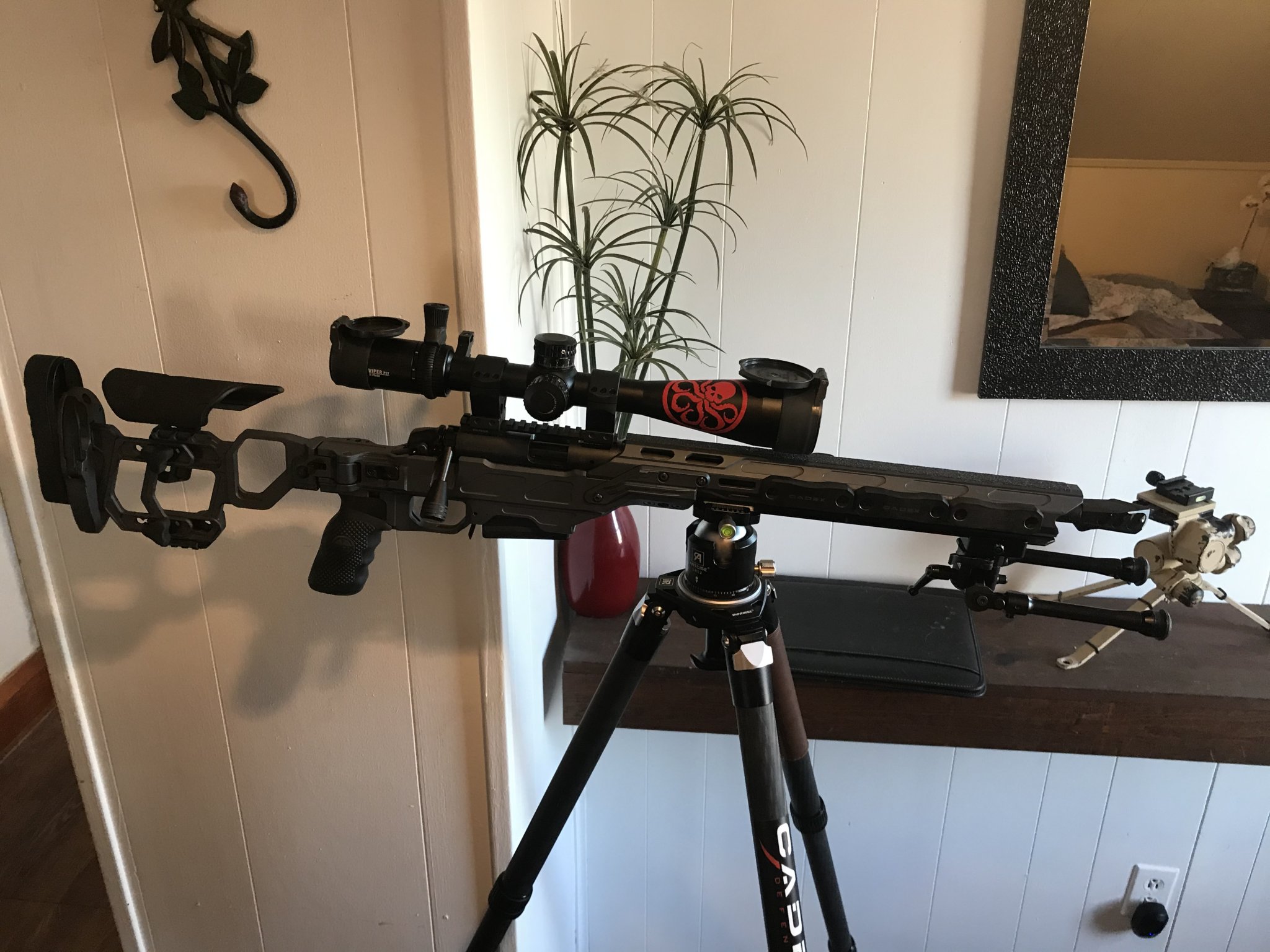

My bergar b14r in my Cadex LCP chassis and Falcon lite single pivot

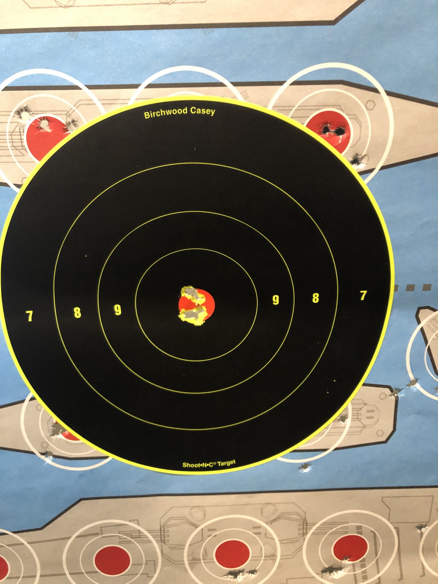

I don't have a can but a fellow shooter put his can on mine last Sunday. We were only shooting at 25 yards using SK Magazine and it made a tiny ragged hole, just like without the suppressor.

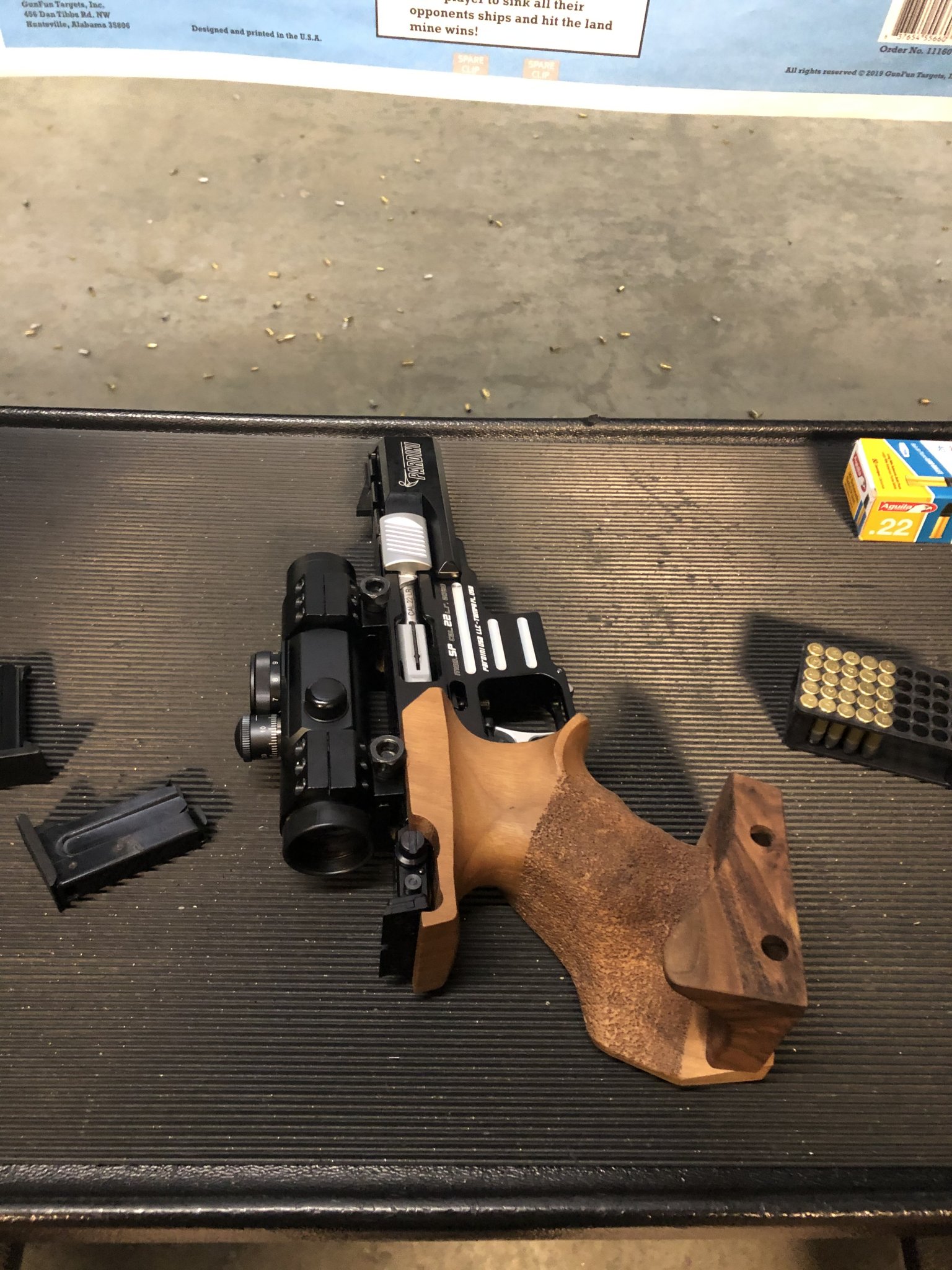

I don’t think ES with velocity is going to show up at 25 yards. This is a 5 shot group with this pistol at 15 yards You should be able to do a ragged hole at 25 yards with just about any rifle at that distance. You can make out some of my other groups in the target and some of those are at 25 yards and others at 15. This is with a 5” barrel. If I were competing and I would Chrono my shots with and without a suppressor with your best ammo for your gun and go with whatever produced the least ES. That

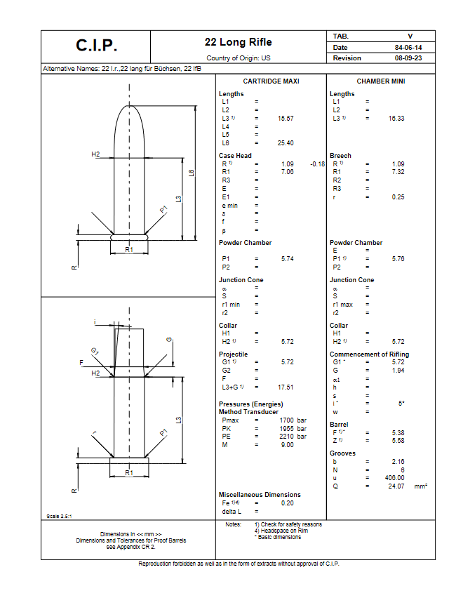

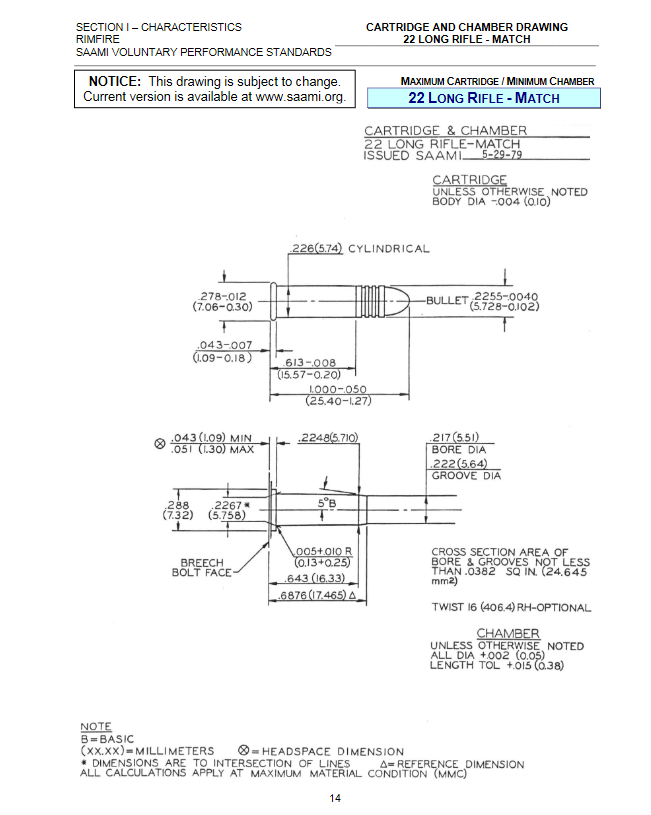

There was one pretty in depth article I read about the B14R that said it was a Saami Match chamber.
CIP is very close to Saami Match. It appears to be throated a little longer, but that is miss-leading since (F = .2118") & therefore G measures longer.

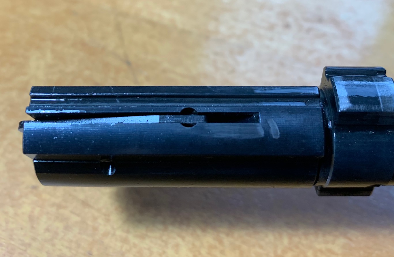

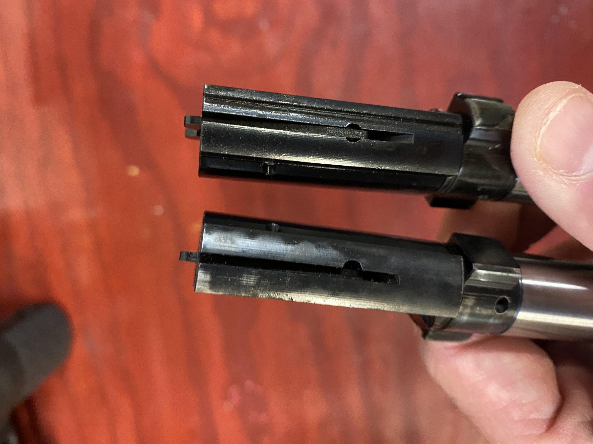

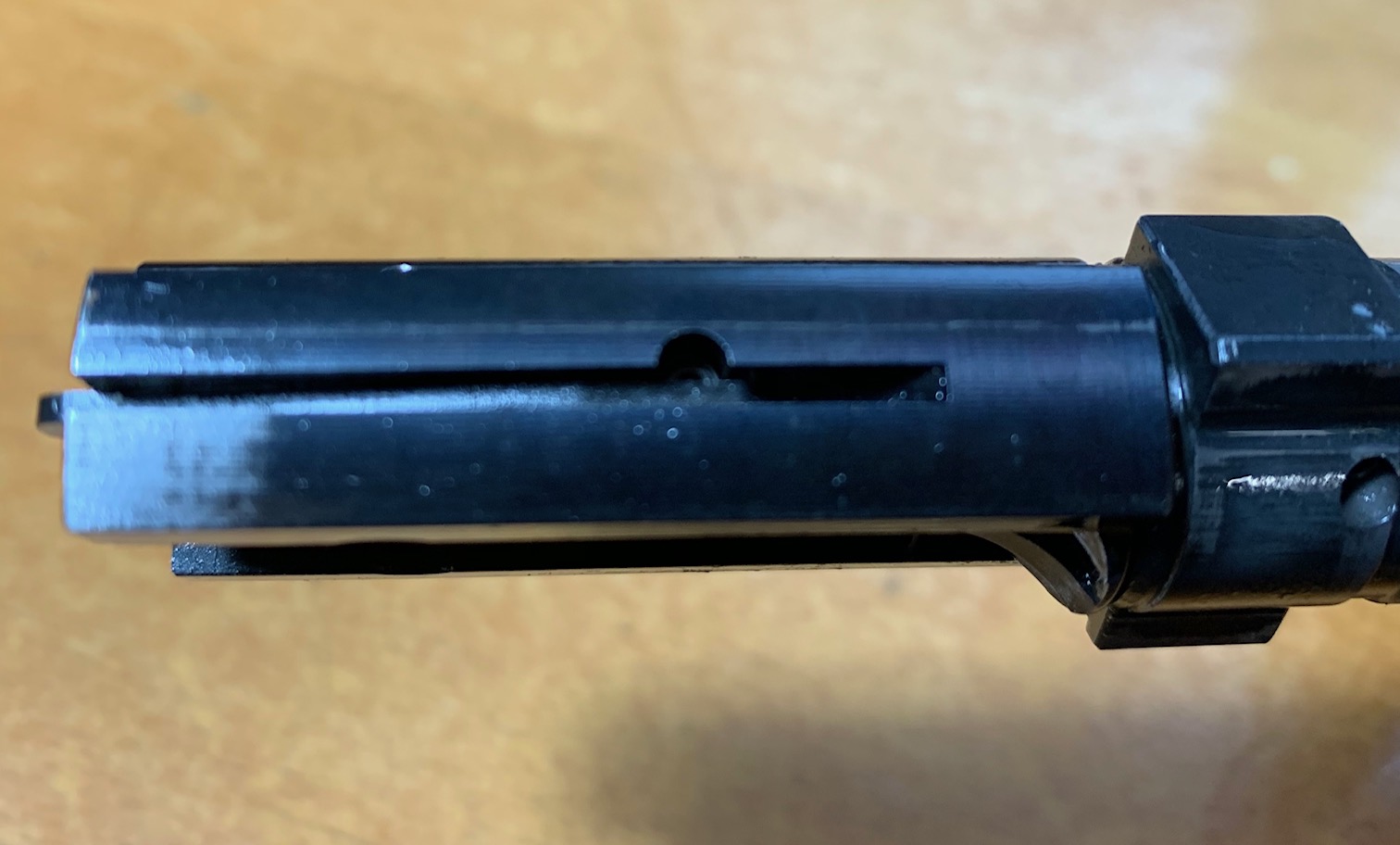

I am posting a picture of two bolts for a Bergara B14R. The top one is from a B14R that was purchased back in October. The other is a replacement bolt Bergara sent for a bad bolt that looked like the top one. Did Bergara enter a design change for their bolts at some point? Which bolt is the more recent design? Thanks.
I am posting a picture of two bolts for a Bergara B14R. The top one is from a B14R that was purchased back in October. The other is a replacement bolt Bergara sent for a bad bolt that looked like the top one. Did Bergara enter a design change for their bolts at some point? Which bolt is the more recent design? Thanks.View attachment 7617320
No there was not a design change.
The bolt pictured on top is showing the ejector side of the bolt.
The picture on bottom is showing the opposite/tensioner side of the other bolt.
Flip either one of them over and they will look the same!
Ejector side.
Tensioner side
Reactions: Doctorwho1138
Ejector side.
Tensioner side
Ok thanks. I don’t have them with me so I couldn’t even check that. They just looked like they were positioned the same. Thanks for clarifying for me.
