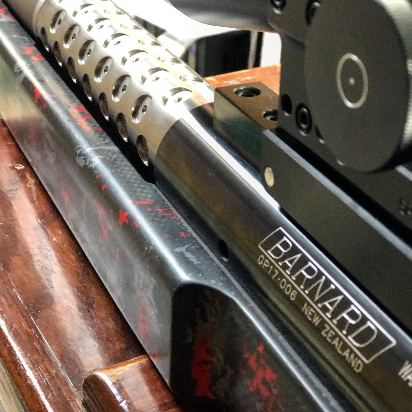

im all for innovation (actually more than most) but the machine gun part is a little far fetched
we not talking water cooling like a WWI maxim
you could slide base board heating fins over a M240 barrel and your not going to gain any measurable cooling after some long bursts at bad guys
heat sinks can only do so much without active fans or liquid being moved, thats why all computers have heatsinks and fans
rifle barrels arent like a car radiator with a water pump
its all just surface area, material, and temp differential
the lewis gun tried it 100 years ago with the fins in a shroud...then came the quick change barrel
Overall I agree with you Brian- add enough energy and most things are not going to be to happy.
That is specifically why this is a first gen barrel. The next series are all about heat and throat life. We also expect them to be even "stiffer" harmonically. Key word "stiffer"... simple word for the action to be controlled.
Reactions: 1moaoff and brianf
Only a matter of time before somone is wrapping a fluid cooled copper heatsink around the barrel and a tucking a fan cooled heat exchanger in the forend of the chassis.
There’s already fireforming rigs that have a shroud around barrel. Use a pump and cooler full of ice water. Not the same as your example, but it’s being done.
The tarac systems alone are a big deal.

That they are, nobody has said anything negative about them.
Prism and barrels are completely different beasts :)
Shit, we can look at the HTI manual from 20 years ago where it was listed that a prism scope would be needed in order for optics to keep up with the ELR progression.

In regards to cooling systems.....BR guys 25 years ago had tubes they would stick down their barrels and flow rubbing alcohol through to cool barrels off between strings. Then that transitioned to wrapping those tubes around the exterior of the barrel while firing. (that concept lasted for about 5 minutes because external cooling did not do anything for the barrel internal temperatures during actual firing.
Sincerely,
Theis
The question still remains....what does that have anything to do with the throat area that sees a 3300+ Deg F burn rate since the barrel temp will not ever raise higher than that flash temperature?
little to nothing.....thats generally why pencil barrels last about as long as bull barrels.
Reactions: THEIS
